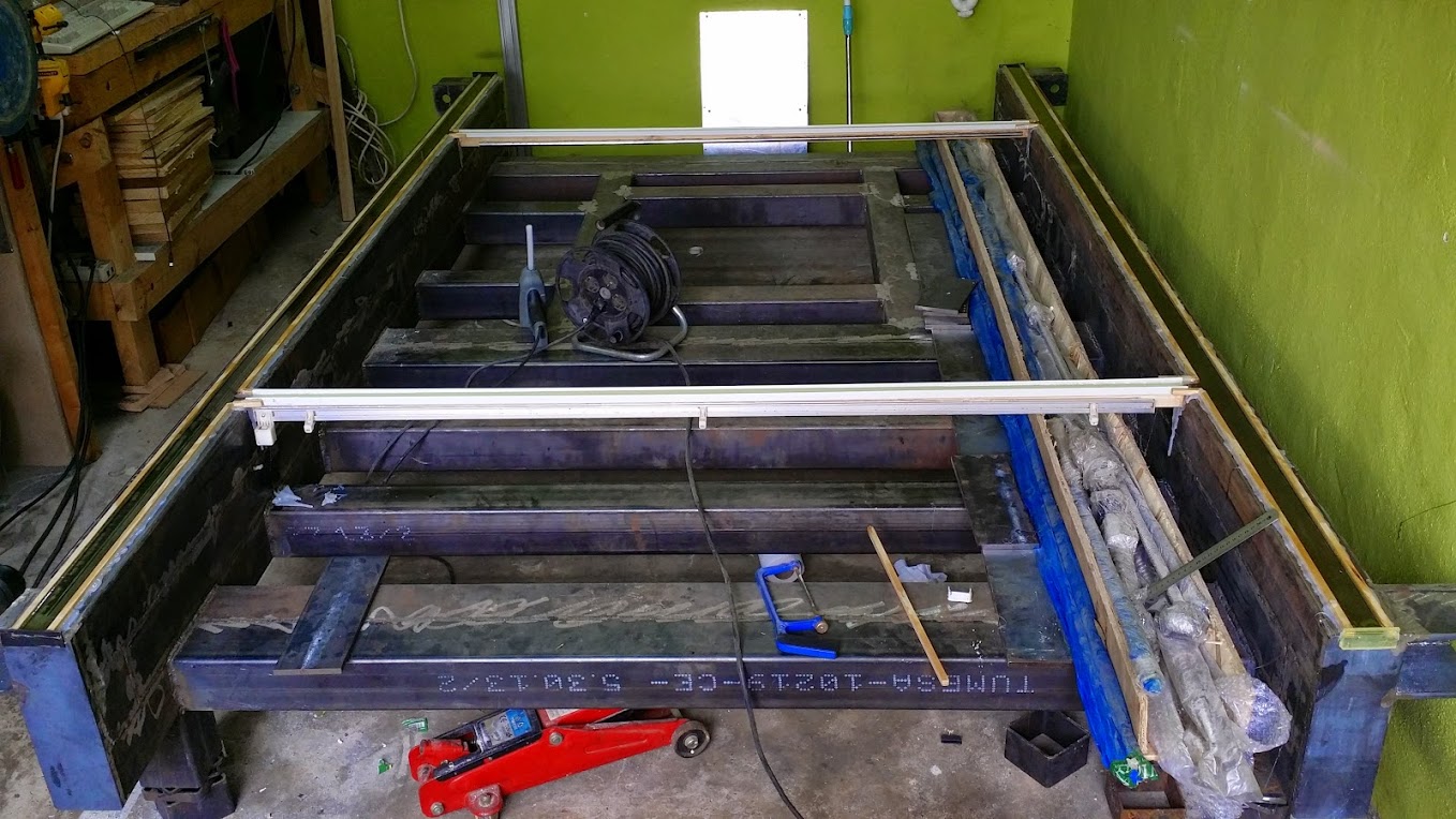

The build is going on but i am stuck with epoxy problems. Mean BIG problems :beaten:.
Second time casting epoxy on the long sides and same problem. The area near the connecting bridges is sunk checked against straight edge. about 250mm wide visible inclination, not measured cause still not perfectly hardened but say 0.1-0.3mm . Each pour cost me 100euro :topsy_turvy: 2.5kg of WS epoxy mix.
Now for a woodworking machine this will not matter, but spending so much money on it i would like to be as Perfect as possible. Hell, at least 0.05 precision or better, real life, not exaggerated. I was striving to something like the first machine i made 0.01mm, knowing that on such a big scale it would be difficult but worth to try.
So to achieve this i depended too much on the epoxy.
Whats the f---g problem then? Everything is perfectly prepared. 21C in the garage, 45mm wide dams, 10min careful epoxy mix, all by the letter. First time i thought the dam was flimsy and contracted at certain points. Not so the second time, everything is reinforced with steel/the bridges/ and hot glue / the 10x10mm dams.
I gave it a lot of thoughts and the conclusion is : the 1600mm long bridges are the culprit. The epoxy contracts , so the bridge epoxy contracts and takes away epoxy from the rails at the exact moment when its solidifying. cause i looked 100 times after 1 hour of pour, 2, 3 hours of pour -it was ok. It happens on hour 4 to 6. Or maybe it was my mistake that the connecting bridges had to be both ends, so when all contracts , contracts equally, like a ring i mean. No money though for further experiments . I believe though that even if ring is formed the right angle between them is the culprit.
So yes, there is a problem with 3000mm rails and 1600mm distance between them. Inherent problem i mean. Not reported by any body till now but hey, did anybody who made such a big machine take care to measure it against DIN 874 straight edge? Possibly no.
I blamed the air trapped, blamed the supports, blamed this and that, but on a smaller scale i did not have any problem before, +fixed all possible doubts. So yes its inherent, until somebody prove me wrong.
I see only 2 possibilities from here on.
1. Will wait to dry for 3-4 days and mount the rails using the straight edge/ 1m/ and shim. Then will have to buy the 2000mm straight edge to continue with the build and check the rails against each other. But if there is a twist , 2000mm straight edge will not be enough or at least would be very difficult to straighten things up. To the precision i would like, i mean.
2. I knew it when pouring second time, but was not sure.:tan: . So may be third pour from scratch or half pour over this one. And on minute 45 / 21C/ cut the bridges simultaneously by some previously prepared method. Say a sliding plate or similar. The way in actual water channels the water flow is cut. Cause at this moment everything is perfectly leveled .

Mine are 30mm wide. On the small machine they were 10mm and it worked. Maybe at such lengths should have been 45mm also, same as the rails channels.
If i had 3000mm straight edge i would have told you exactly what happened. Checking with the 1000mm one says the area near the cross channels is down.
Just measured it at the deepest spot 0.15mm difference.
I am starting to doubt if i should have semi filled the epoxy with something. It would have helped. And yes, WS 105+209 shrinks like crazy on 3000mm length. Visibly. You know that last time i fixed 5mm magnets to check levels. So it covered the magnets and when dried, one magnet was half out, so on 5mm thick/high all went down 0.5mm at least which is more than 10% if you know what i mean. The good thing is that it shrank equally wide wise. Not like the cheaper epoxy. But still 5kg pack
200euro...
PS. and no, it did not went down in between cause it was done so that it couldn't do it, so that's not the problem

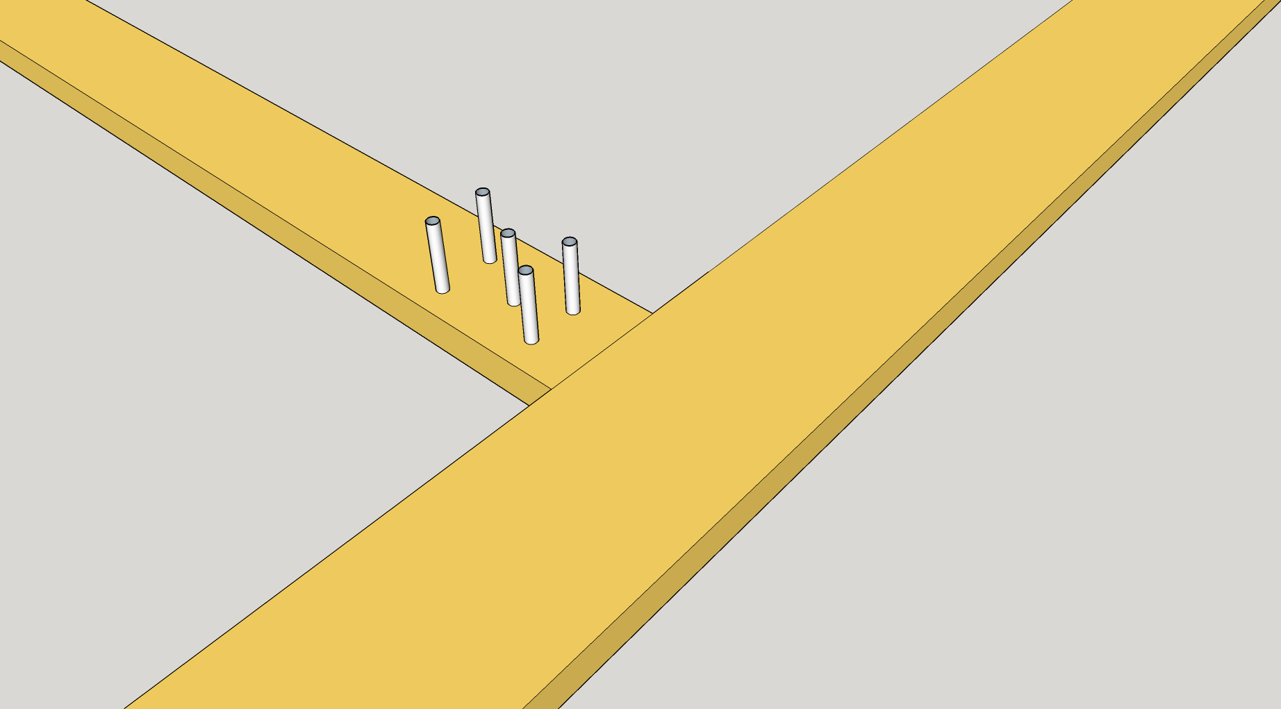

What about adding some nails/pins to the bridge before the pore? Could this maybe help the situation?
Attachment 13615
Jim
Not enough bridges IMO. I've only ever done one machine near that size with epoxy and I had 5 bridges with 2 people pouring epoxy.

Are the bridge deeper than the side pools? If they are the same depth then the shrinkage should not cause flow, but if the bridge pools are deeper, then they will get inflow like you experienced because they will slump more.
Narrow deep bridges will suck less from the rails than wide deep bridges. So narrower would seem a good choice.
And all this assumes vertical walls.

Do you remember depth and width of channels and bridges, especially length of the bridges and if all checked well against straight edge?
Vertical walls. Same depth, i was very cautious after the first attempt. I agree that narrow bridges will suck less. I am almost sold on my variant 3 from the previous post, where the rails will suck from the bridges.
Considering all this, the very small gap and the time and effort, i just broke everything so will prepare for another pour

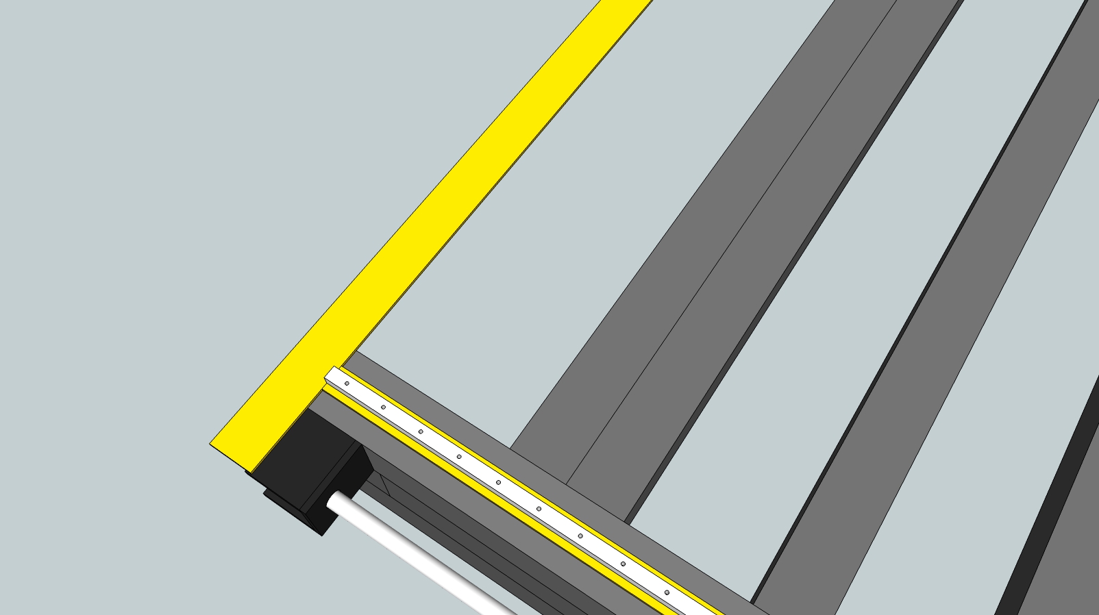

What i came till now is very simple. Extend both rails both sides 30cm each, then bridge them. When dry cut the extra 30cm each side and hope for the best in the center :-). Have to contemplate it further but i feel that this will work. And apart from this i will know for sure if i can build one day 5x10 foot CNC :-) with epoxy. Or not.
