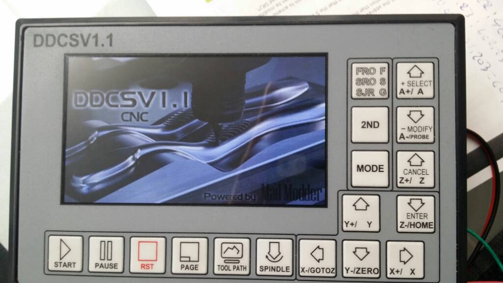

What about this one guys? Soon this controller will have a new look and setup!! (this is just a quick screen to try the colorsAttachment 19624
Sended by my tapatalk
You've replaced a graphic with an alternative graphic?
That's "Modding" alright!
I would call this "customization", as i have no words to describe the original boot screen!!!
But i'm working on a very good graphic, so it will make sense then. This was just a trial.
A big thank to Benedikt for his contribution about the firmware, we hope to make this one "open source" soon.
Mmmhhh, don't know , maybe not yet, in the meantime this is the better one, Benedict is going to include the design as default if possible, let's see how is going on in the next few days...
Cheers 🍻 Attachment 19627

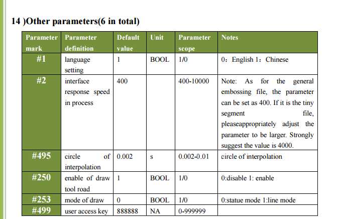

I discovered that i have a problem with small carvings and very fine details. I tried 2 times to carve a stamp from aluminum ~30mm diameter, X and Y started slowly to loose position. Lowered the acceleration from 3000 to 1000, did a dry run also.
Same problem persists. :grumpy:.
Now the question is: the controller??? or the servos need further tuning??? or i have to slow further things down, which i dont believe is the case. I remember i bumped up servos quite much to be responsive via software and even 3000 accelerations and more than 10000 mm/m speeds on objects like 200x200cm there was no problem at all. Checked initially the machine, does not seem to have sth loose.
Any ideas??? Could that be the small lines? Exported v carving file as arcs also, same again. Thinking about it it looses both X and Y and moves slowly in diagonal on every step down of the Z is visible. At the end of tool path controller shows same machine coordinates as on start 0.
Should i try to find the look ahead in the controller and make it bigger, i was thinking of disabling drawing the tool paths?
i don know what exactly to do now except bump more the servo response and see what happens
In the controller, in the last part of the machine parameter you can fond the "interpolation period", set it up at 0,005 and try it, change even the "screen refresh" at not less than 4000, otherwise the screen will slow the cpu, as it not equipped with a graphic card.(you don't need to watch the screen, watch the machine).
Find even the "operating acceleration" parameter and set it up at 500mm is the diagonal interpolated acceleration try it and find a reasonable one for your machine.
Is just a bit of thing to try, maybe it won't help you, but it worth try.....

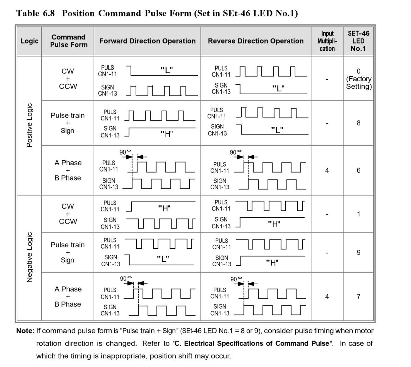

First i took a look at my drive and motor timing specs and compared with the timing of the controller. Results that this controller is really high spec and the servos must not have any problem with the default setting:
Attachment 19635Attachment 19637
So far so good. I include the above line of thoughts just for the sake if somebody needs to understand whats happening with his setup.

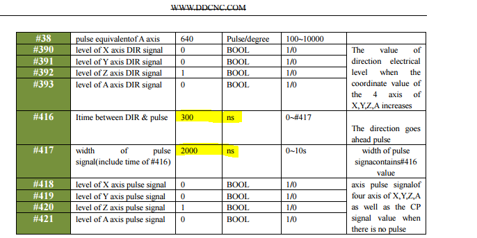

Again back to what Dean said, about the pulse. looking at the table below it seemed i should not have had a problem as both in the controller and drives was set to high / step pulse/ . Changed the controller pulse to low and now its working fine. Thanks Dean!
Attachment 19636
Though i still not get why on controller Z is set differently than X and Y as default? No i have to think of a way to check the correctness of Z . Problem seems to be as till now i had done files where Z has no more than 5 steps, so may be thats why i had not seen the problem. I dont know if it counts that the CAM makes the Z oscillate on the toolpath, i think that counts a a change, so it seems better not touch anything for now.
Your Welcome and it catches lots of people out. Seen people replace drives and motors because of it.
The problem I've encountered often is that while the Manual says one thing the switches on the drives are set opposite and this is probably the case here.?
Not quite understanding what your saying here Boyan.? If your menaing to check pulse edge (polarity) then it's easy.

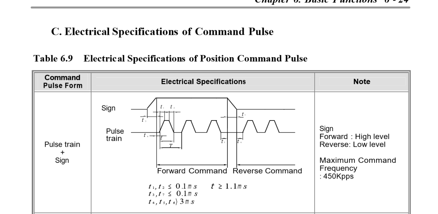

Make up G-code file of short back n forth moves ending with move back to Zero. Mark the start position and when done should be back at same place.
Boyan - I can't quite read the small writing on the "command pulse" timing diagram but I think that it might say that you need a minimum of 3msec between direction change and step pulse. However, in the controller settings, this seems to be set to a lower value (300nsec, 0.3msec). As I say, I might have misread the diagram but it might be worth a quick check to make sure that the timings are OK. Apologies if I am wrong and you have already checked this.
Neale, i think you are right to note that.
I think they are talking microsecond in manual, not miliseconds, its marked "m" like handwriting. As it makes more sense to me looking at the numbers.
If i am right about that, then:
it says T3 , T7 <0.1ms which in controller is set by default Itime between DIR & pulse 300 ns where 300 ns=0.3ms, so this one seems ok
T4, T5, T6>3ms which in controller is width of pulsesignal(include time of #416)2000 ns where 2000ns=2ms , seems i have to raise that a bit , though somewhere the manual of the controller says: if you dont know better leave default :joker:

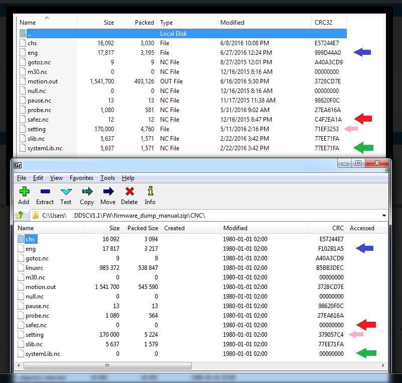

Dean, did you check the Rattm controller if software and firmware is the same? If you have time and spare motors / i am sure you have/ could you try what does that mean for the A axis , choose A or B. maybe even if it says degrees it is mm, who knows.
Not exactly sure where to find firmware version. I can see on main screen it says whats below which presume is software version. Can't see any ref to Firmware only this.
Normal Mod
Ver:2016-06-29-81NOR

By the way i forgot to tell that all this time the 3 axis controller was loaded with the latest 4 axis software and apart from 4rth not showing on DRO, everything works fine as you know. I dont know if the 4rth will work actually but just is good to know. Anyway the 4rth axis version and the 3 axis version share same hardware.
Thanks for the update, where did you get the 4 axis software?
Sent by my tapatalk
I have 2. The one on the controller i got from Joules, i have one also directly from the manufacturer/ ok, from the agent who contacted the manufacturer for me/. If it can help i will send it to you. That was obtained 2-3 weeks ago.
Attachment 19696
Hi Boyan, thanks for the file information. It seems that your 4 axis files (most likely located in the /mnt/nand1_1 folder) seem to differ slightly from the ones I've found on MadModder member Benedikt M's firmware dump collection. Especially the files "safez.nc" and "systemLib.nc" seem to have some content in them, in the dumps I've seen these files are empty. Also the translation file "eng" and the "setting" file seem to have a different content, based on the different CRC checksum.
