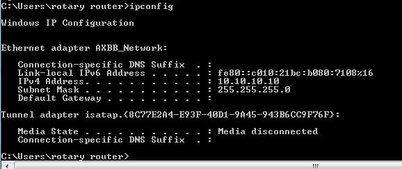

Re: Losing steps/position, again
Two PCs, starting to sound more like a AXBB issue - but that's a very very premature conclusion.
Can you post the results of "ipconfig" from a dos prompt? And are you familiar with Wireshark? - it would be useful to know if the comms to the board is bring routed onto the correct interface... but it's not something that you can pick up in 2 minutes.

Doddy
I'm hesitant but thinking I could pull my UC300ETH so that you can test your PC against that as a known quantity - just for consistent comms.
Attachment 27942
I disabled the onboard ethernet.
Okay, nothing sinister from the ipconfig, and you've already said that you've rebooted both PC and AXBB. And different cables, and different PCs. I, for one, am running out of ideas.
