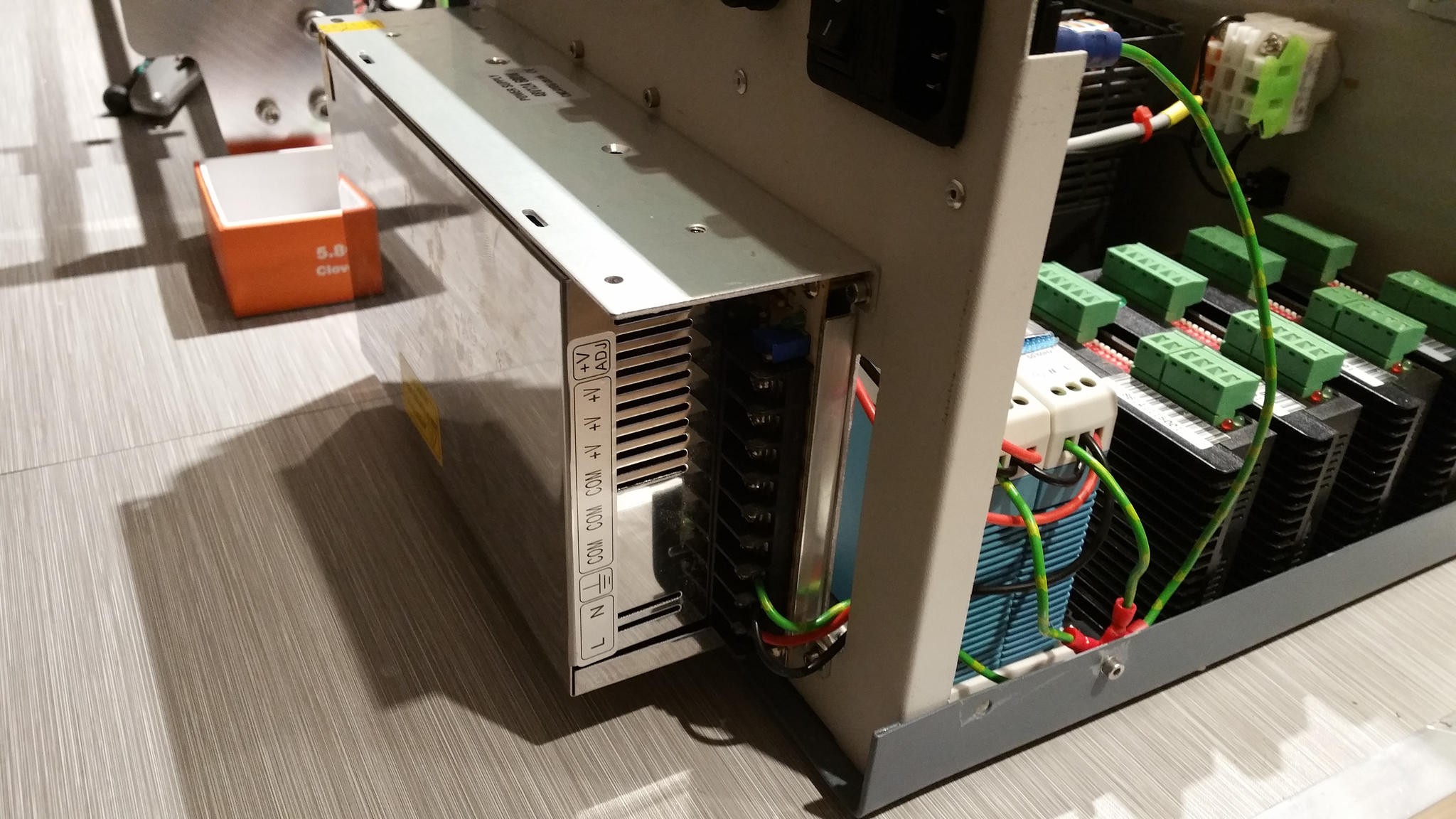

It only bloody works. Managed to get the 24v psu powered up today along with the relay to prove your latching circuit Jazz. It worked and nothing blew up!
Top shout thank you!
I was able to power up the 48v PSU via the relay and then when pressing the Estop the relay would switch and the 48v PSU would power down. After releasing the Estop, pressing the momentary would then fire the 48V PSU back up again.
Great idea!
Here are some pics of my wiring. I used a 2 Amp fuse for the 24v / 5v PSU's and a 10Amp fuse for the 48V PSU. Hope that's right. Does everything look ok to you ?
Attachment 16775Attachment 16774Attachment 16778Attachment 16779Attachment 16777
Here is the shelf that will carry the UC300 / KK01.
Attachment 16776
Right onto the 48v Stuff now. Leaving the VFD out of the equation for now.
Thanks again.
Martin

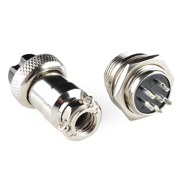

3. Any problem with using the outside metal part of these as a way of passing the shield ground from stepper wiring into the box and on to the star ground?
My plugs only have 4 pins.
Attachment 16806

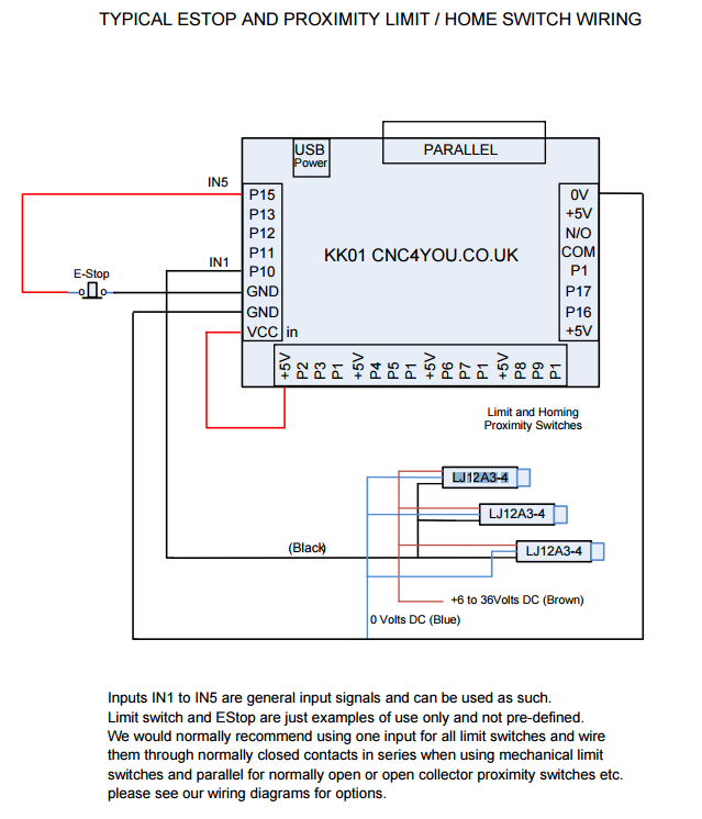

Having problems wiring my 3 wire (blue) prox sensors as per this diagram.
Problem is it dosen't work. There seems to be a light on the Prox sensor, but this does not come on and Mach3 stop is not triggered.
Everything is setup correctly in Mach3...
I am feeding +24 into the brown wire from my 24v PSU.
The blue wire goes to GND on my KK01 BOB.
The black wire goes to pin13 on my KK01 BOB (signal).
I'm guessing that either the blue GND wire need to go to the negative side of the 24 PSU instead of the GND on the BOB ?
Or...
I need to connect the GND on bob to the negative side of the 24v PSU ?
Any help much appreciated.
Cheers Chaps.
Attachment 16893
Re: Electronics for New Machine + Chinese Spindle + VFD
I guessed and won.
The ground on the BOB needed to be wired to the 24v negative side. I might actually be learning something here.
mturneruk
I guessed and won.
Classic mistake a lot make. So you are defiantly learning.:applause:
