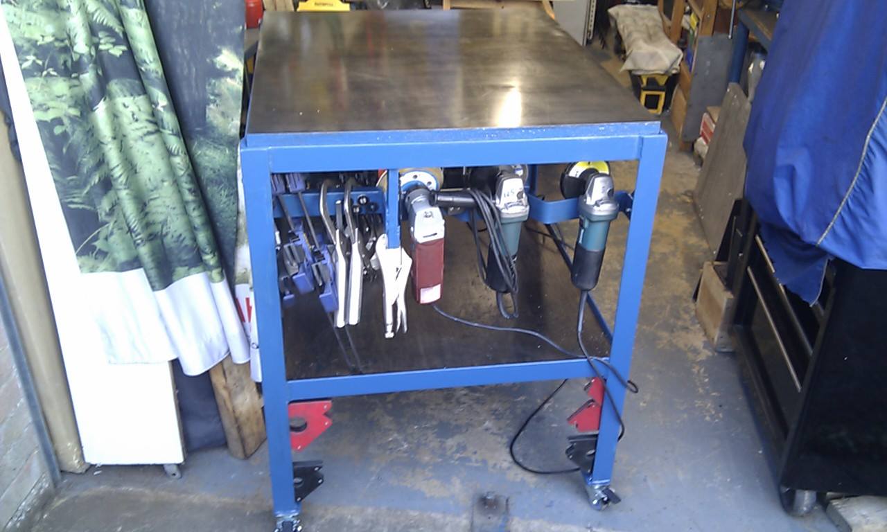

I have cast iron one 275kg. This help me a lot with my weldingAttachment 20114
Re: Thor, or should that be Zeus?

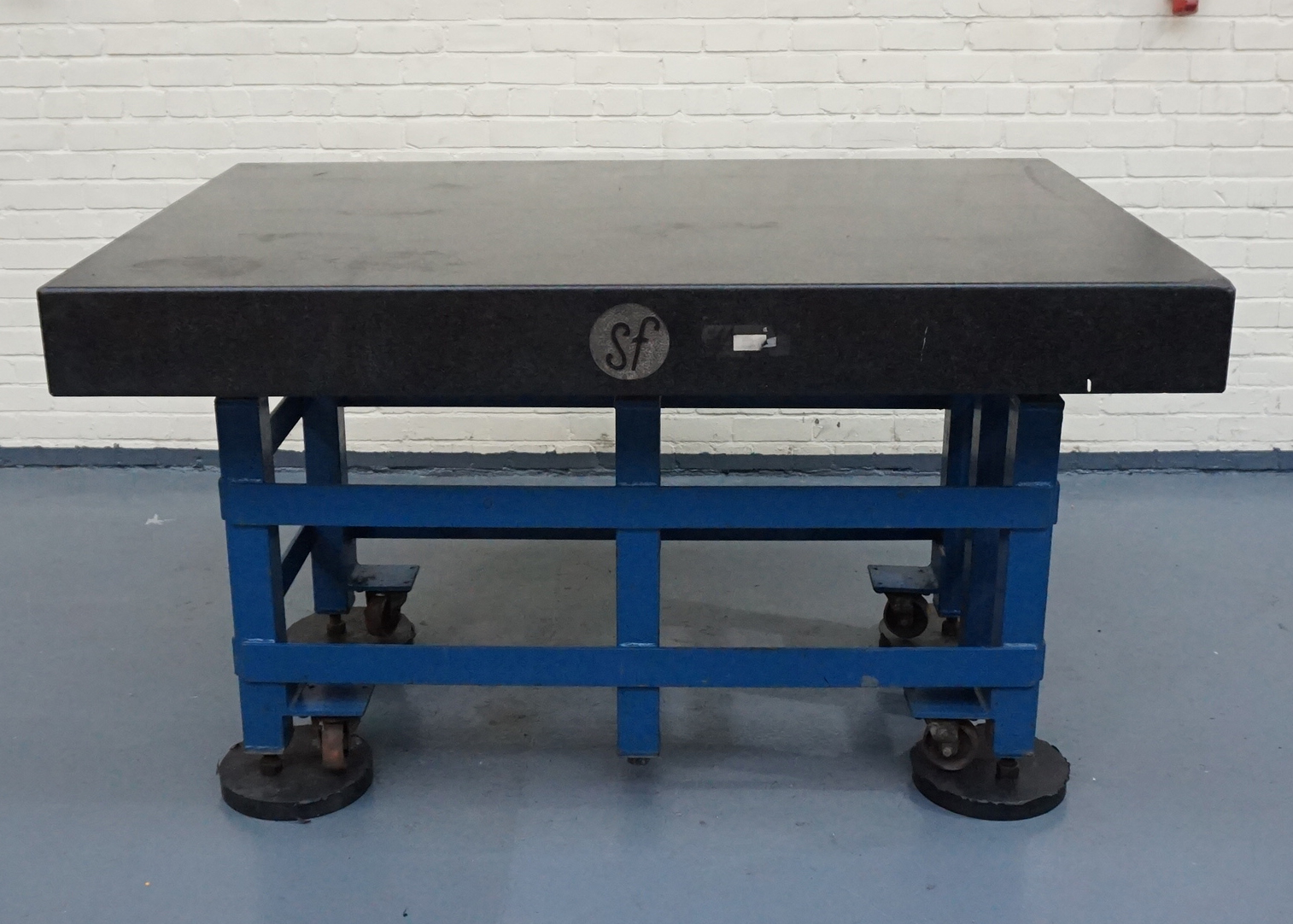

These lovely welding benches :)
How do you keep spatter off of them?
Dave the one I linked to is 150mm granite so the splatter does not stick:cower:
