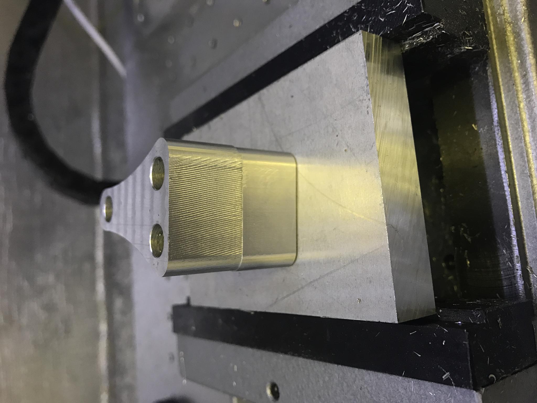

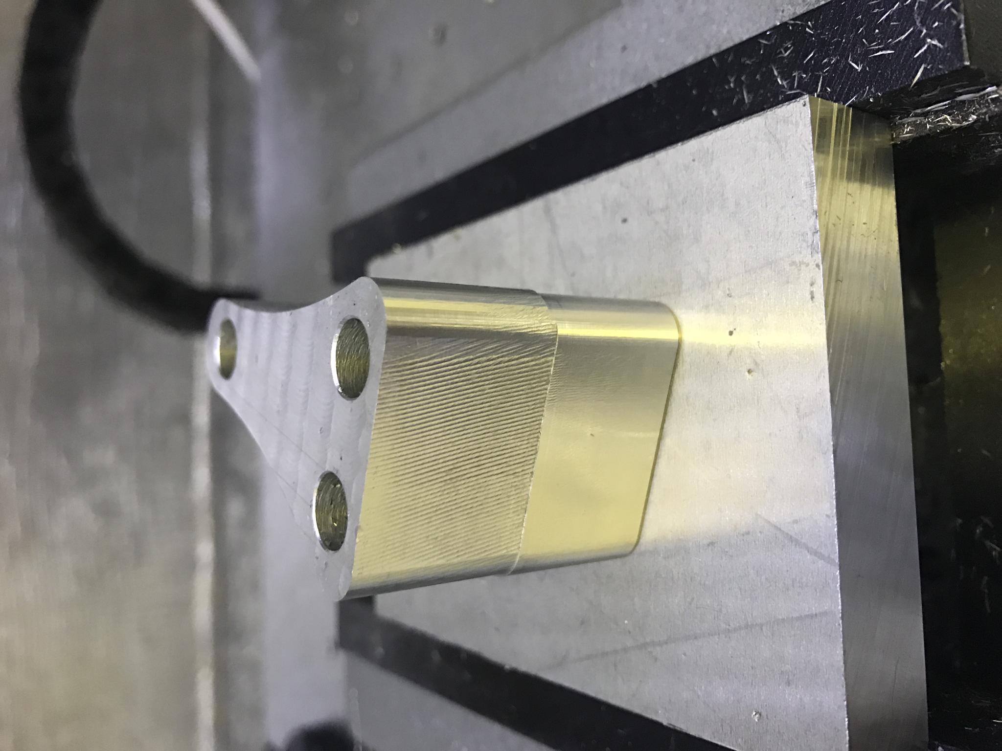

2 Attachment(s)
Re: Newbie looking at 6040 (China CNC) for polypropylene 15mm sheet
Here's two pics from different angles. Again this was the same tool in the same collet in the same nut running the same g-code file. Only difference being on the top half (first op) I forgot to clean everything when changing the tool. For the lower half I took the tool out and cleaned everything up.
Quite a difference!!
Attachment 23075Attachment 23074

In other news, Y keeps getting off by a few 0.1s of mm.
X has been fine. This was after 4 hours of roughing out.
Can see on the walls of these two cases that one is thicker than the other.
https://s1.postimg.cc/59idb6qtcv/IM..._190434827.jpg

So I am having much better luck today.
The probe is 0.1-0.2mm out on both X and Y but I think I am starting to see a pattern so should be able to just offset it next round.
Did end up with 0.2mm out on the Y with these cases but they are not being sold.
https://s1.postimg.cc/2atq3uqmen/IM..._153244374.jpg
I keep getting this bump on the Y face. It is only a hair deep but you can visually see it and feel it.
It is where the operation starts and ends so I am guessing it is something to do with that, not having enough overlap to smooth it out if the bit is coming off the part too quickly?
https://s1.postimg.cc/74ikzza8wv/IM...449825_HDR.jpg
https://s1.postimg.cc/2w3dq5i2of/IM..._163624223.jpg
Nice you're getting there now. For that bump on the Y that's your lead in for your contour, change it so that it sweeps into the cut instead of just moving directly into position.
