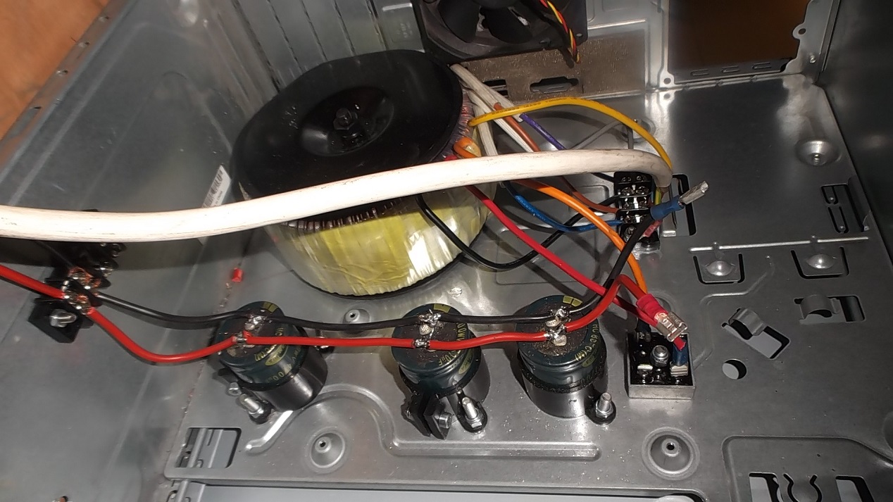

At least the PSU works ;)
Attachment 23132
Re: New build with recycled parts on a ridiculous budget 120cm*60cm work area
Desertboy
Nice!
Must feel great :D
Skickat från min SM-N910C via Tapatalk
Nr1madman
Nice!
Must feel great :D
Relieved ;) I tested it without the capacitors but since I put it together properly I hadn't tested it will try to remember to test the output voltage tomorrow.
I have no resistor on the output of the PSU so the capacitors remain charged at moment what's the best way to discharge them or should I just shield them so you can't touch the easily instead?
I'm going to wire a 32amp socket to the wall and then from that to the junction box, from there to the PSU, VFD and to a double wall socket.
The PSU and spindle will be fed through a 13amp switch first so I can turn them on/off with a single flip.
For now though it's wired to a 13 amp plug, I don't think it's wise though to run the machine, PC and vacuum cleaner on a 13 amp socket.

Problems my PSU stopped working (Possibly unrelated but one of my AM882 had a solid red light the other 3 flashing green, I wonder if this had something to do with it or if I have a bad AM882).
99% certain it can be traced to a short I caused at weekend when electrician set my ameter up wrong and I shorted across my PSU output never realised it'd done this damage.
Attachment 23164 They were plugged into the left connectors I just cut the wiring put new terminals and tried it in the terminals next door to see if I had gotten lucky but I hadn;t.
There was a pop/bang and spark from roughly where the capacitors are.
I've ordered 3 new capacitors and a new rectifier (Sure this is fine but £1 so just did it) and replacement barrier terminals.
What's the best way to test the transformers to make sure it's ok? I was thinking unplug the capacitors and then test the voltage going into the rectifier in AC mode to see what I'm getting and then test the output of the rectifier in DC mode to see if that's working does this sound like a plan?
Do you think I might have damaged my AM882's (I really hope not can't afford to replace this side of xmas)? And if I have a bad AM882 will be fun trying to sort with the Chinese (Bought 2nd hand) and will have to put a temp cheap driver to get going whilst I source a replacement.
I can afford to replace one Am882 but not 4.
How do I discharge the capacitors before I unsolder them to replace them and also how do I test which one(s) blown?
I just realised I have a picture of my AM882 that was always red and it was green last week!
Since I have AM882h could I not ditch the rectifier and capacitors altogether and just connect the output of the transformer (50v) to the drivers?
The pic shows a block with the red wires connected but to my eyes the black wires are not connected as one of them appears to be in the wrong connector.
shorting the output of the PS with an amp meter would probably wreck the meter.
I doubt you have blown the caps or the rectifier. If you want to discharge them put a small value resister across the caps temporally like 220 ohms or a mains light bulb across them.
put your meter on the AC range and check the voltage on the input and output of the transformer.
Have you checked the fuse on the input?
Lets see a good pic of the PS

I thought that too but i think its just an illusion lol

Right going back to check it out in a minute, will get some pics.
The probe on my meter was black and the spark was large it was only a £5 meter as well and still seems to work fine. I have the PSU wire to a junction box I tested the power at the junction box a steady 247 volts.
Not good, I pulled the PSU out tested the capacitors they read 45v I discharged them with a light bulb setup. Then tested unplugged the capacitors from the recitifer and turned it back on and tested the output of the transformer diddly squat. There's 240v going in but nothing coming out.
I tripled checked the soldering whilst not neat there's no shorts and it's all on very tightly no possibility of loose connection.
Tomorrow I will test each coil individually but I have no hope.
My AM882's turned on with the 24v but one of them is still permanently red led so I think that will need replacing.

Attachment 23165
Not sure why it went bang which puts me off buying another one and if it had anything to do with malfunctioning AM882.
The only way I'm going to get this cutting before January is if I buy a cheap stepper driver to replace the AM882 for now no way I can afford both the AM882 and transformer before Xmas.
Can't see there being much warranty on the transformer and looking at the listing for the AM882 I might as well forget it.
I did have the wires going to the output on terminals but cut them off just make sure was good connection hence the bare wires going in now.
Well that shows the caps are OK.
Now check to see if you have continuity between each winding pair on the transformer after you have disconnected it fro the rectifier
I doubt the AM882 has blown the transformer. Did you have it working at one time or is this the first time you powered it up
Hi, right I have continuity on only 3 of the 4 coils one of the primaries has no continuity I assume this means thhe thermal fuse blew and I'm pretty screwed. Going to get another multimeter to test it with to be sure but not looking good.
