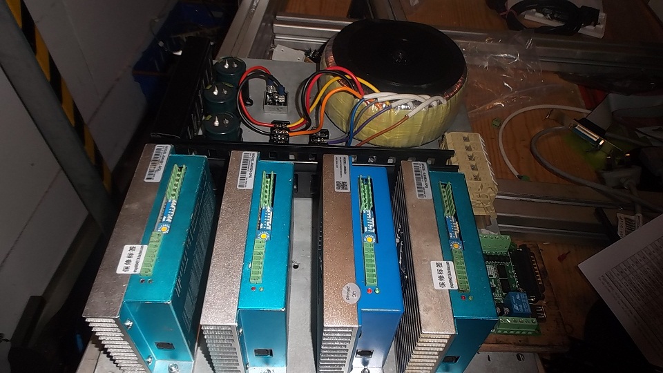

I had it wired blue and brown to mains 240v, grey and violet joined on the input side. On the output side orange and red to the rectifier, yellow and black joined. This was a dual 25v output core.
This time with the 1kva transformer I'm going to wire the input the same (it's a dual core 115v input). The output I will join the orange and black and then wire to rectifier, join the yellow and red and to rectifier. (Dual core 50v output, I want 50v out to feed into the rectifier so I get my 68-70v out for my drivers.)

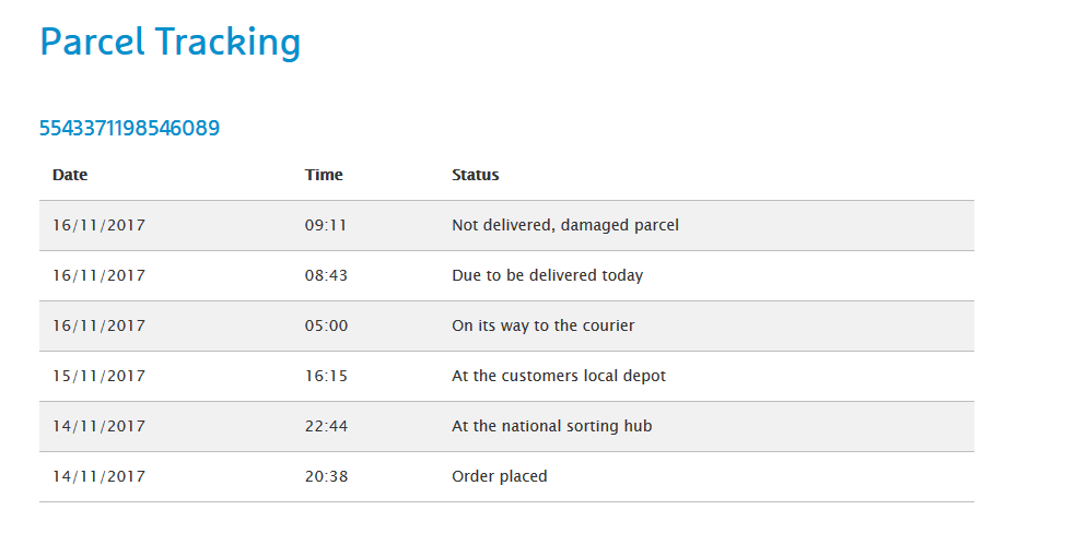

Came today but missing the top metal plate! I think the one on my old transformer will work fine but still poor maplins I do have both rubber protectors.
I was hoping it would straight swap but not so sure it will I might just get away with it and a hammer ;)
Attachment 23184
Not going to wire it up until I have an MCB, replacing the rectifier as well, going to leave the caps in place.
Think I traced the problem to a poor crimp causing the initial problems and we think my friend reconnected the bridge rectifier backwards on the output but no one can be sure.

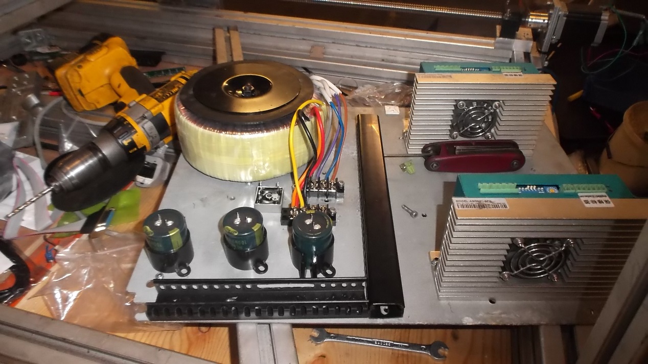

4 Attachment(s)
Re: New build with recycled parts on a ridiculous budget 120cm*60cm work area

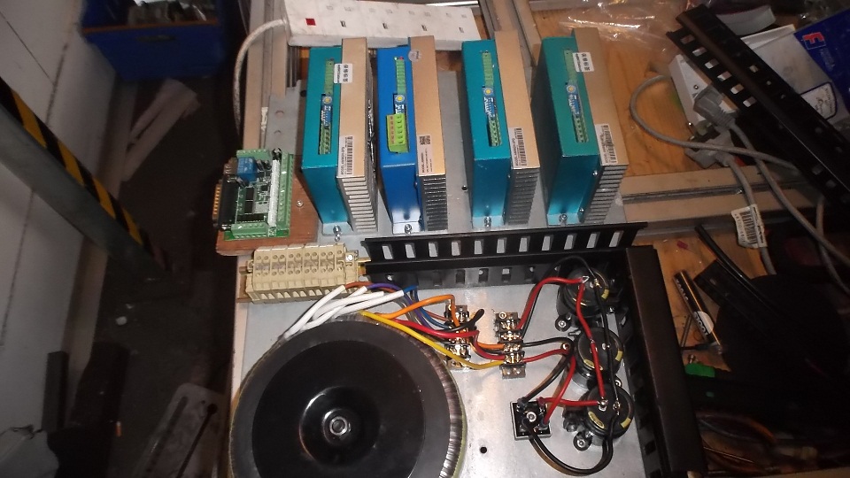

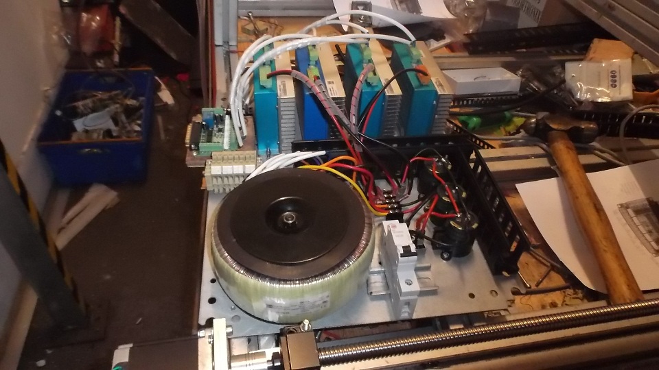

Right wired up properly and tested 78.2v out so a little high what's the best way to reduce this voltage my AM882's 80v is max input.
Attachment 23190
I daren't plug it in to the AM882's.
Got it wired to a 13 amp switch finally so I can turn it on/off without killing power to pc.
Attachment 23189
Got a free enclosure some damage to the front but better than what I have, will transfer the AM88's and BOB's across PSU will stay in PC case.
Attachment 23191
Attachment 23192
Desertboy
If it were my supply i might unwind a couple of turns off the transformer secondary, but thats just me ;)
Not too many ways to fine tune the voltage really.
Maybe also look at an autotransformer in the primary circuit - a multi-tapped primary only transformer with the input going to the normal 240v tap and then take an output from the neutral and a tapping a little lower like 220v.
https://en.wikipedia.org/wiki/Autotransformer
Just an idea though. ;)

Assuming input voltage is at rated 230V, your output voltage open circuit is going to be at 52VAC (rated output voltage plus the regulation rating of 4%).
Multiply that by root 2, gives 73.5V peak voltage.
Now if your input voltage is at 250, which puts it around 8% above the rated voltage, so your output voltage will be proportionally higher, at 79.4V peak.
Now all you need is a sudden deceleration on a couple axes, and the energy dump back into the DC side can potentially push everything overvoltage.
If you search for my Triac retrofit thread, there's a big post there explaining all this.

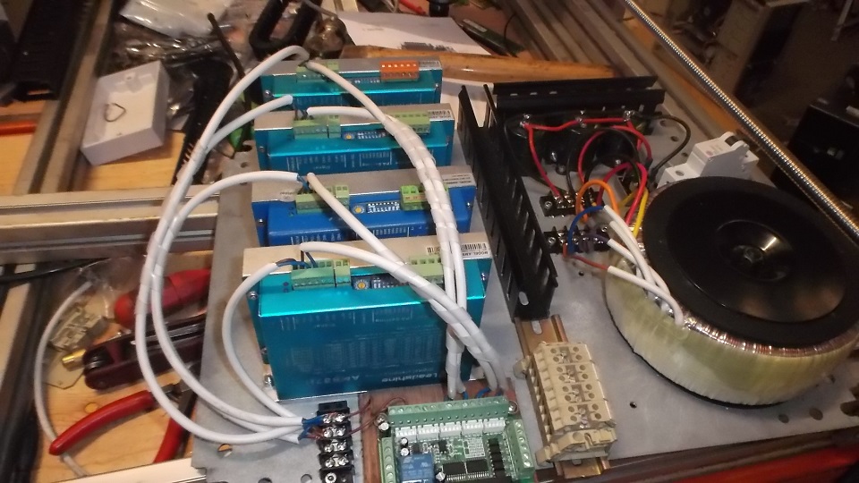

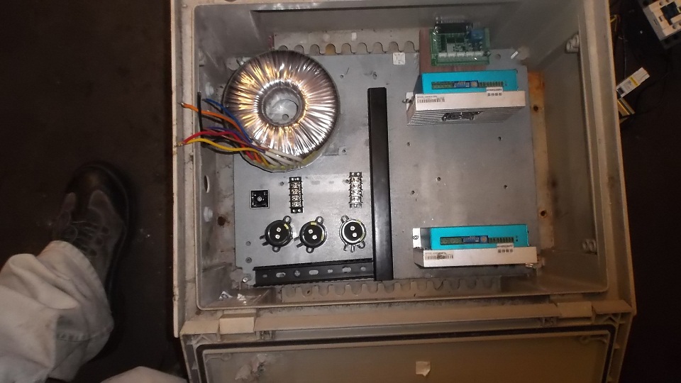

3 Attachment(s)

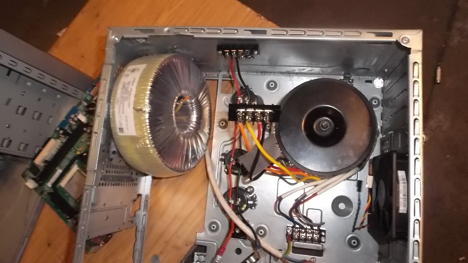

Have ordered a 45v 1kva which will solve the problem whilst I'm waiting I took the time to start stripping out the box and recovered some nicer wiring conduits. Also fitted a proper stop switch to it.
Friend is going to fibreglass repair the damage for me I might even paint it ;)
Attachment 23193
Attachment 23194
Attachment 23195
There's loads of space in here should I put the transformer in here as well and fit a 4 120mm pc fans two blowing in across the am882's and two sucking out the side of the transformer and leave a nice gap so the air can flow, I want to make sure the caps get good air flow over them.
It would be good to fit the transformer at the top of the box but it weighs 8kg making the box top heavy so it'll go at the bottom if i do fit I think the key will be good air flow and lots of it. I have a better on/off switch which is rated to 2hp (I think might be 3) ac3 so I think should be ok for the PSU.
Desertboy
Attachment 23193
Attachment 23194
Attachment 23195
If you can cancel the order and reorder a 625Va as it should suite you better 45V is a good choice
None of my CNC modules get hot, i would think one fan would be ok, filtered inlet then fan with a vent at other side of cabinet.
Caps will/should not get hot or even warm.

Looks like I'm going to have wait at least another day the AM882 will come from China quicker lol
Attachment 23211
Been on phone will either be redelivered tomorrow (If it's ok which it will be of course, things are like house bricks) or new one sent out for Monday
My Hermes claimed they tried to deliver it today although I was there with the roller shutter door open so they are lying bastards, have to wait till Monday, would have been quicker to order from China lol.
Using the 50v transformer as a pattern (the 45v will be identical) so started to think about kitting out the box, anyone see any issues having the transformer under the stepper driver? I am going to fit 2 pc fans one sucking in and 1 extracting.
Attachment 23218
Going to use new capacitors as I have them and am going to need to fit everything a bit tighter.
You can just see the breakout board in the corner on a bit of ply will fit it roughly there and chop a hole with a cutting disc for the parallel port and USB to stick through.
Not sure I will fit the other BOB as I really don't need extra the input pins, good to have a spare though.

Transformer came finally! didn't get round to soldering it but will have it up and running tomorrow ;)
Attachment 23225
Damn just realised I wired this up wrong lol but turned it on yet. The orange and black should be joined as well as the red &yellow.
Was tired this evening only just come home from work glad i decided to leave it till morning.

Almost there, got some connectors on a din rail for sorting out the wiring to the BOB, still need to solder the capacitors but will get that done tonight. Looking for my holesaw set at moment so I can make the fan holes in the enclosure.
Attachment 23226
The non working AM882 isn't bolted down just there for reference.
I have got a current inrush thermistor which hopefully is the right one if it cause problems I'll ditch it but it was £2 so I thought worth a punt. Hopefully with one fitted I can then use a type B mcb which I can just fit in the box ;)
I now feel it's starting to look like cnc electronics ;)

Got the capacitors soldered on a 2nd time, ready to test output voltage, need to get my mate tonight and borrow his hole saw so I can fit the fans and he's helping mount the box and the wires can be connected ;)
Attachment 23227
Now I need the new AM882 was quoted 10 working days delivery tomorrow is the 10th day :(
Ordered

Attachment 23229
A little bit closer, ready to mount the box and start running the motor's and home switches. Need to mount the VFD as well so I can run the wiring 12v adapter won't be here till Monday.
Need holesaw for the fans mate has my cheapo set so going to see him tonight little bastard keeps forgetting it.

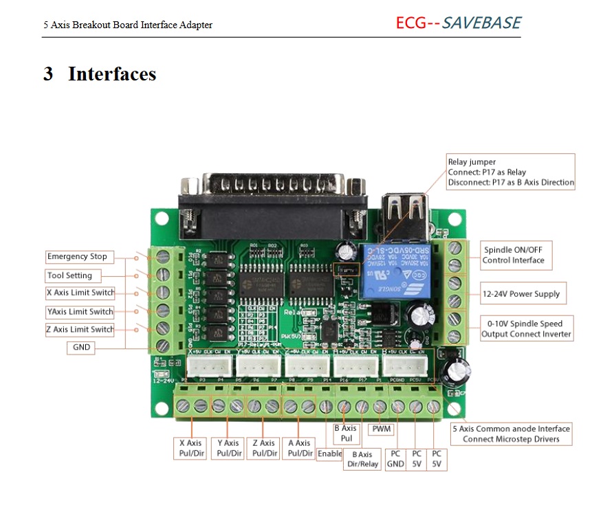

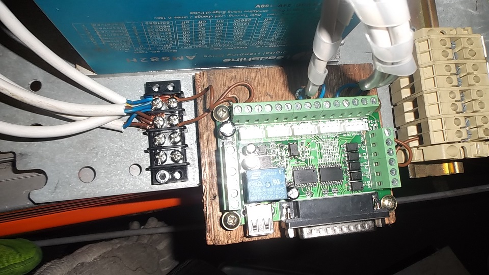

Does this look correct it's the pulse and dir +'s connected to BOB pc 5v
Attachment 23237
Attachment 23238
Attachment 23239
