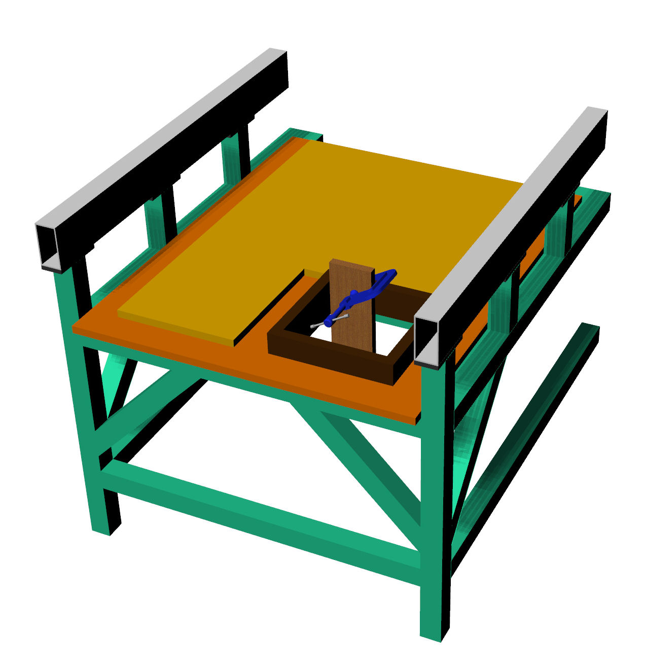

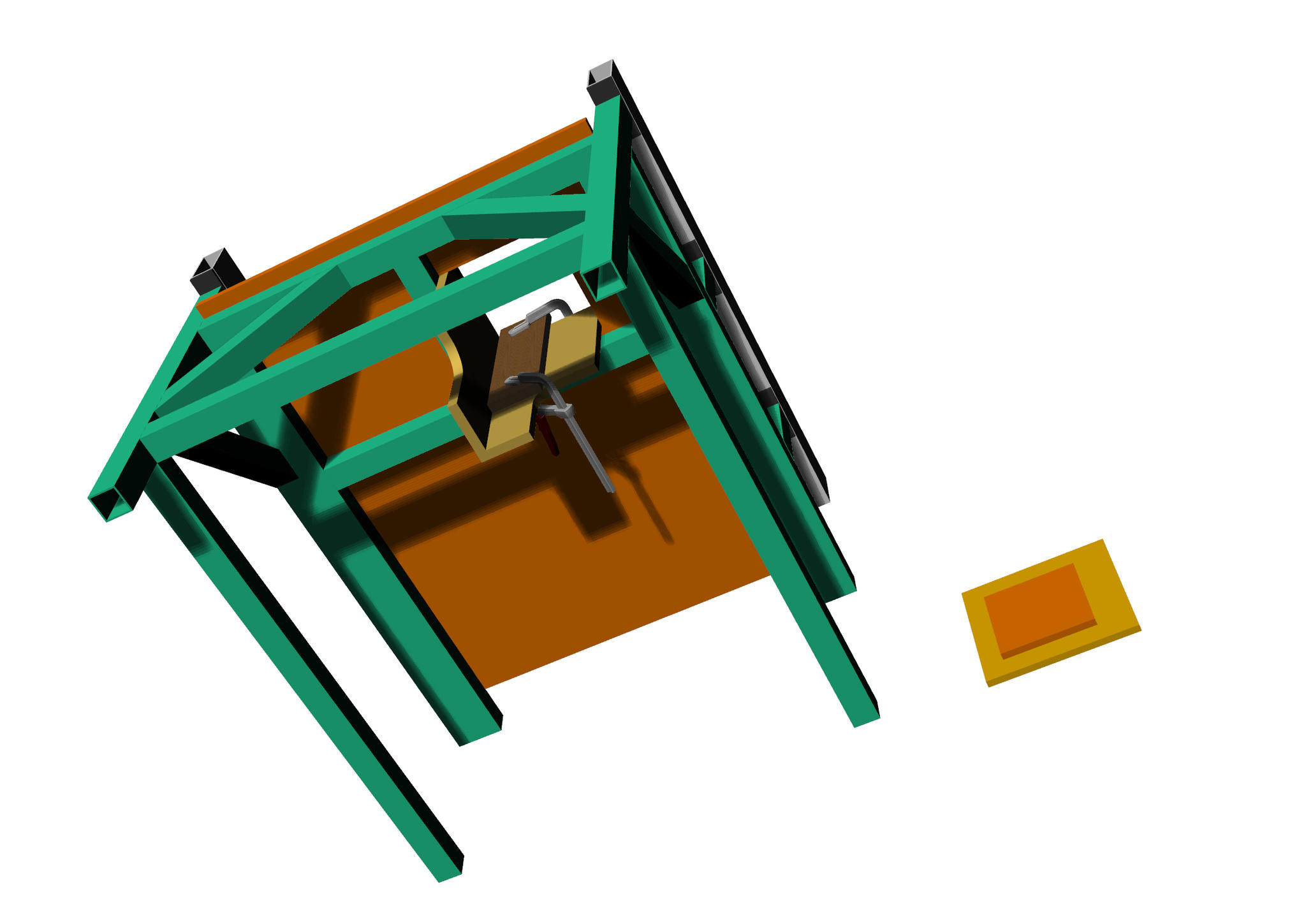

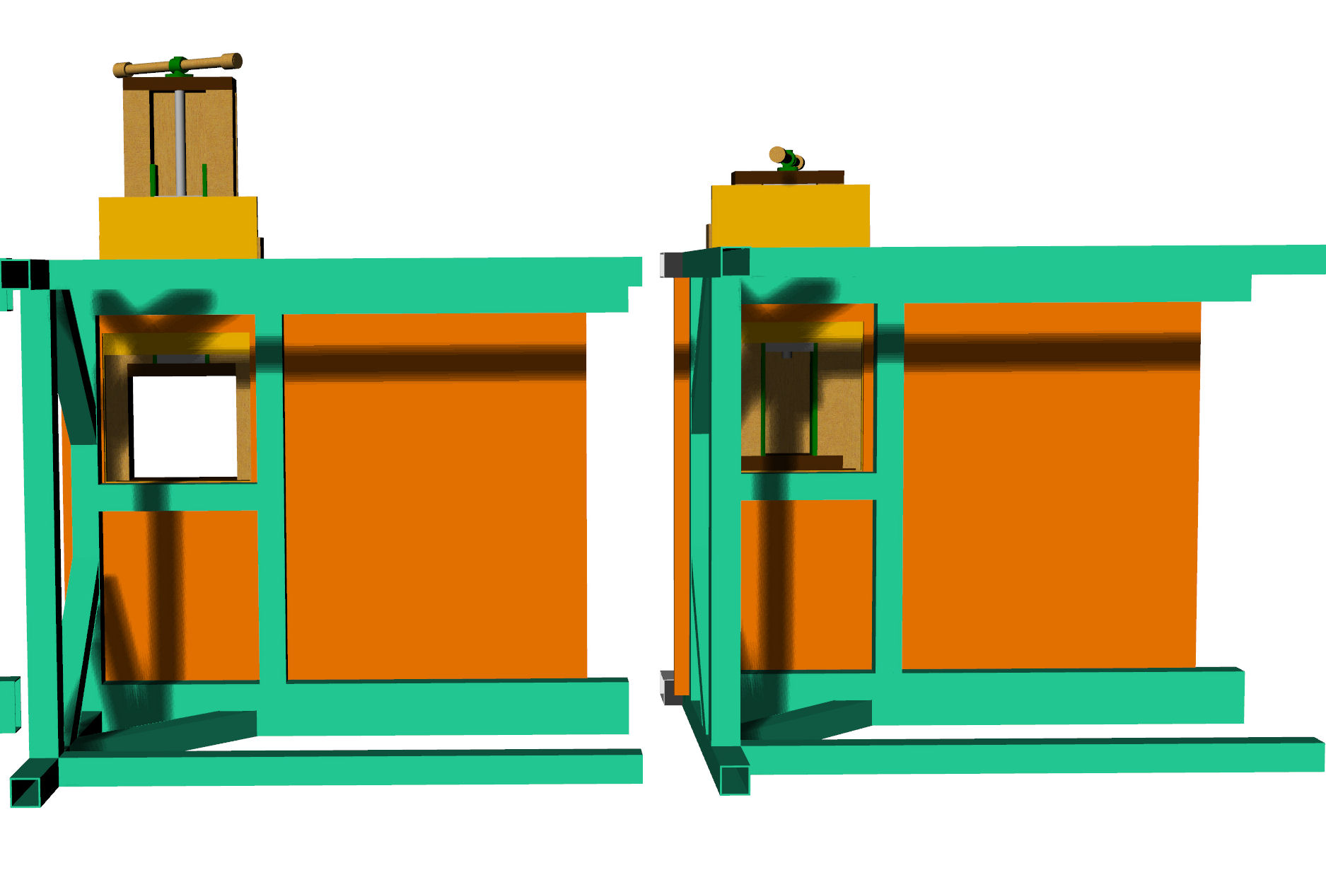

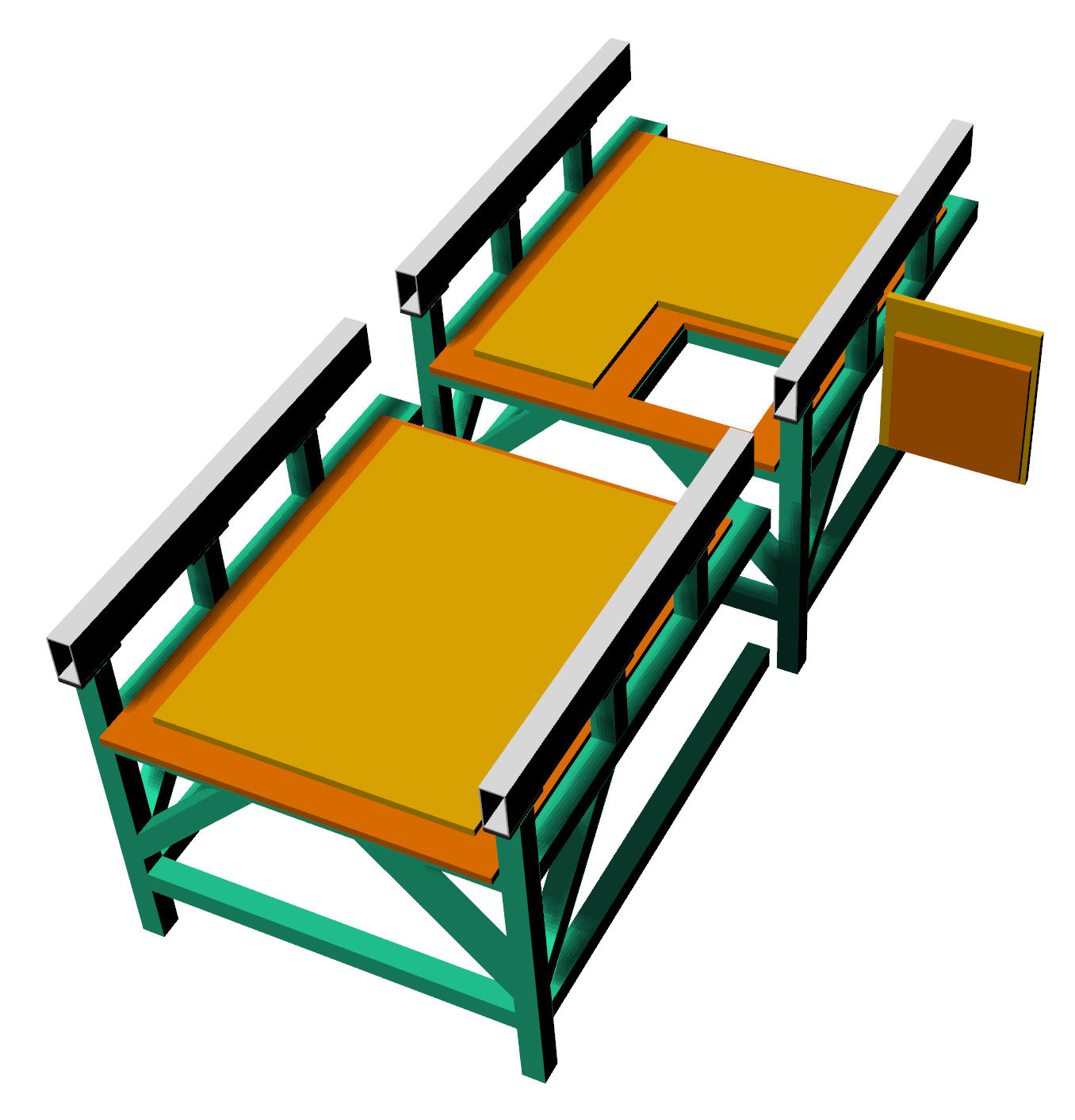

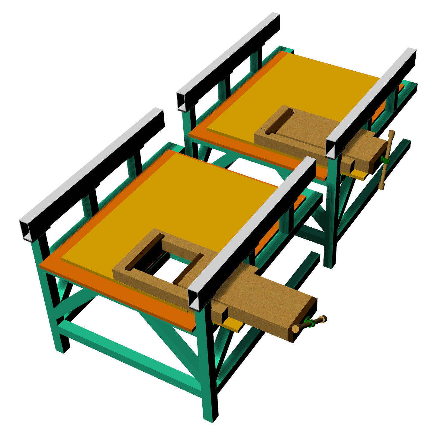

Proposed modifications !
This is to allow joints to be cut in the ends of wood, it provides a 'hole' of roughly 200mm square so the wood can be placed in the X or Y planes.
It's based on using this vice guts; http://www.canadiantools.co.uk/tools...19.html#SID=50, the rest is made from various types of wood (normal for this type of vice :eagerness:)
Made so it's removable with a replaceable insert to put the bed back to normal.
Pictures show how it looks with vice fully open and fully closed.
Attachment 13996Attachment 13997Attachment 13998
I can't have the vice sticking out at the front so the only thing to confirm is whether I can hold a piece of wood in the jaws while tightening the vice.
There's more than enough room above for the spindle and tooling.
Edit:

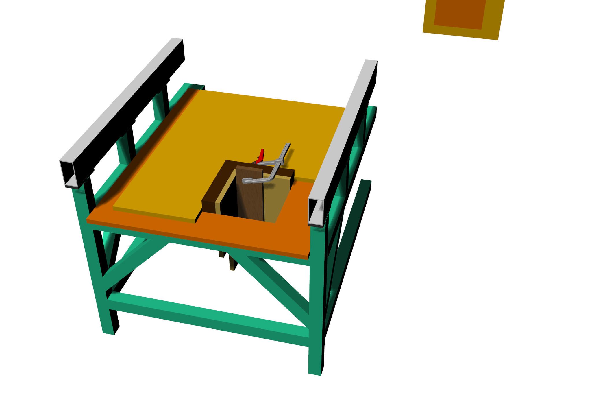

Would this do instead ?
Attachment 13999
Interesting idea and a good price for that vice if memory serves. I can't help feeling that while I think this will work it's going to be a lot of hassle to set up for the benefit it brings unless you are intending to make a run of identical components. For the joint to be any good you'll need to get the wood bang on parallel with the cutter (in the vertical direction) which will be difficult without a fence which would have to stick down though the table.
I think I'd invest my time in buying a Festool Domino (amazing bit of kit) and if I wanted dovetails a dovetailing jig.
Thanks for feedback.
The corner innermost to the machine will be made very accurate so that any wood placed up against it will be vertical in both planes. The whole assembly would be securely fastened to the bed using location points to give repeatable positioning.
Domino's too big for my purpose and also too expensive. Need more joints than just dovetails, the vice would allow wood to be angled at 45 deg. for example.
Now commited to current idea having ordered 2 of these; http://www.oxfordweldingsuppliesltd....sey-clamp-gh20
This will be accurate, repeatable, easy to work with, the corner being perpendicular to or at right angles to X,Y,Z planes.
Attachment 14013Attachment 14014

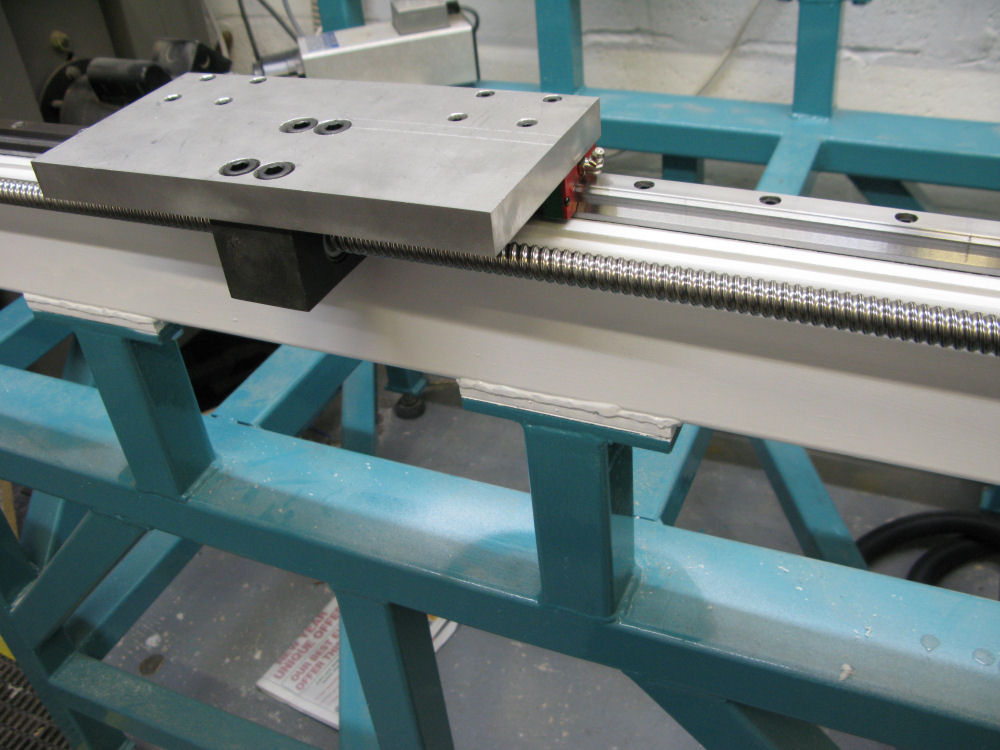

Hi Joe, if you remember i explained it here #151 in detail how i did it, if its of any help.
But basically in following order gravity and epoxy did the job in one plane for long rails/y/, gantry legs and using square between them, then for gantry rails/x/. Then 1 gantry rail was mounted and using hardstop/precision cut squared piece of sth/ fixed at same distance to gantry legs plane. Then using dial indicator or hard stop next rail was mounted in parallel.
Now the gantry rails were mounted in parallel to each other and square to legs, was time to square long rails. One rail was mounted within millimeter square to frame. It was straightened using straight edge while tightening. So result was first rail straight and on place. Then crossing with the long straight edge and 2 precision squares, checking every 25cm second rail was mounted. That was the most exhausting job as in my case distance was 1800 between them so very difficult to judge square or not. I started scraping the square against straight edge and unsquaring it left and right, so i wanted to get the feeling when in perfect center/square. Once i felt how it feels i used that feeling to square all.
Then gantry was mounted. Then time for Z. First gantry was squared to long rails. Then using clamps clamped on place. Again the long straight edge cross the long rails below in front of gantry. Using squares between it and z rails, ...
All ball screws were mounted 1 by 1 more or less, screw not tight just to hold a little , so when moved to end they will slide on place. Axis moved by hand to one end. ball screw slides on its place, tighten screws, then repeat at other end. That ensured ball screw alignment to be parallel to rails
Thanks Boyan, and yes that description was useful. My issue like yours is a lack of specialist kit. I was asking eddy as he has built in aluminium. I am ok where the aluminium is being mounted in such a way as to make the most of the cast sides as these are nice and flat. But the edges are not and neither are they square. Also the ends of the extrusion I have is not quite flat/square so it makes squaring the x and y to each other hard to achieve. I think I have resigned myself to needing a surface plate and some blue and just scrape the parts square. It's the only way I can think of doing it without a mill... Getting the long axis rails parallel scares the crap out of me!
Joe,
I thought this explained it, http://www.mycncuk.com/threads/6565-...5217#post55217
For the first X rail I used a straight edge to mount it. For the second X rail I used a measurement from the first X rail but in the end I used the Hiwin bearings to line it up.
By moving the gantry back and forth it was easy to find the position of least resistance and the second X rail was tightened down in that position.
