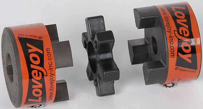

One thing I'd definitely would change in that order is the flexible couplings. Those are not suitable in my opinion. Get the lovejoy type, much better. It demands better alignment but offer also better accuracy, less vibration and better speed response. Not a very high cost and easily can be changed to at a later stage if you want to try what's included in your order, but considering the overall costs, I think it is better to do it now, and not waiting.

I would not use direct coupling Motor/Ballscrew use belt and pully, Dean always recommends this setup to reduce resonance.

I have no idea who Dean is, but if you mean rigid coupling then I agree, that should not be used, but the lovejoy couplers are not rigid.
Attachment 19192
They offer some flexibility, but not as much as the crappy Chinese sold as flexible couplers. These are the ones I mean should be avoided because they generate vibrations and can snap off any time.
Attachment 19193
On the other hand, these require less installation accuracy, so if you are sloppy, or not good at adjusting and aligning then the lovejoy type isn't the one for you.
