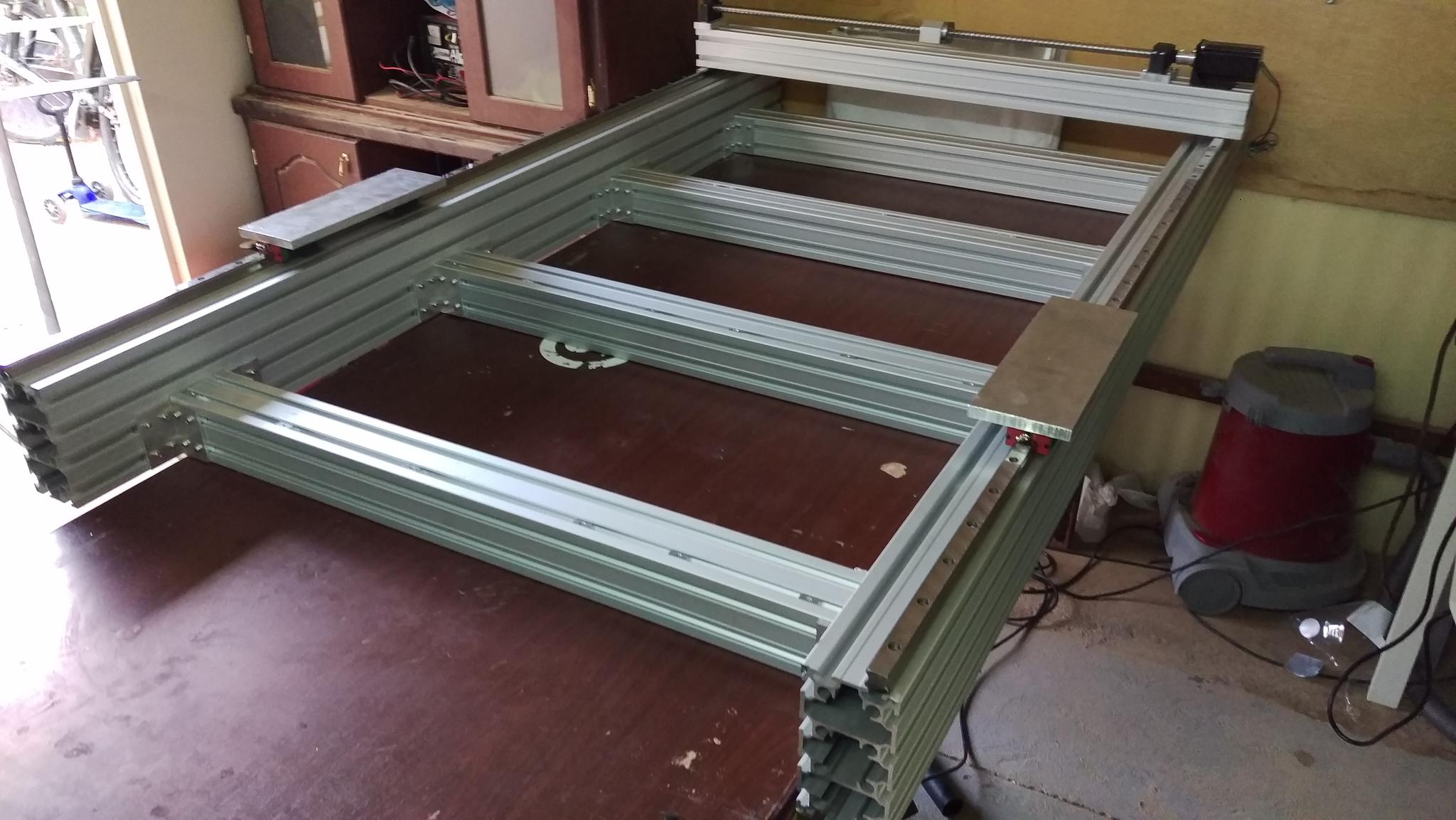

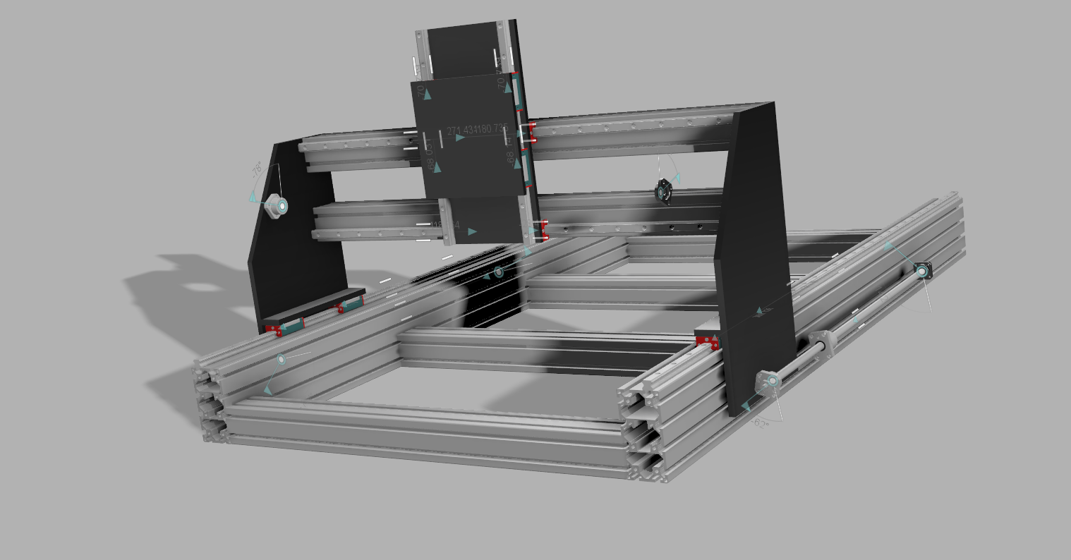

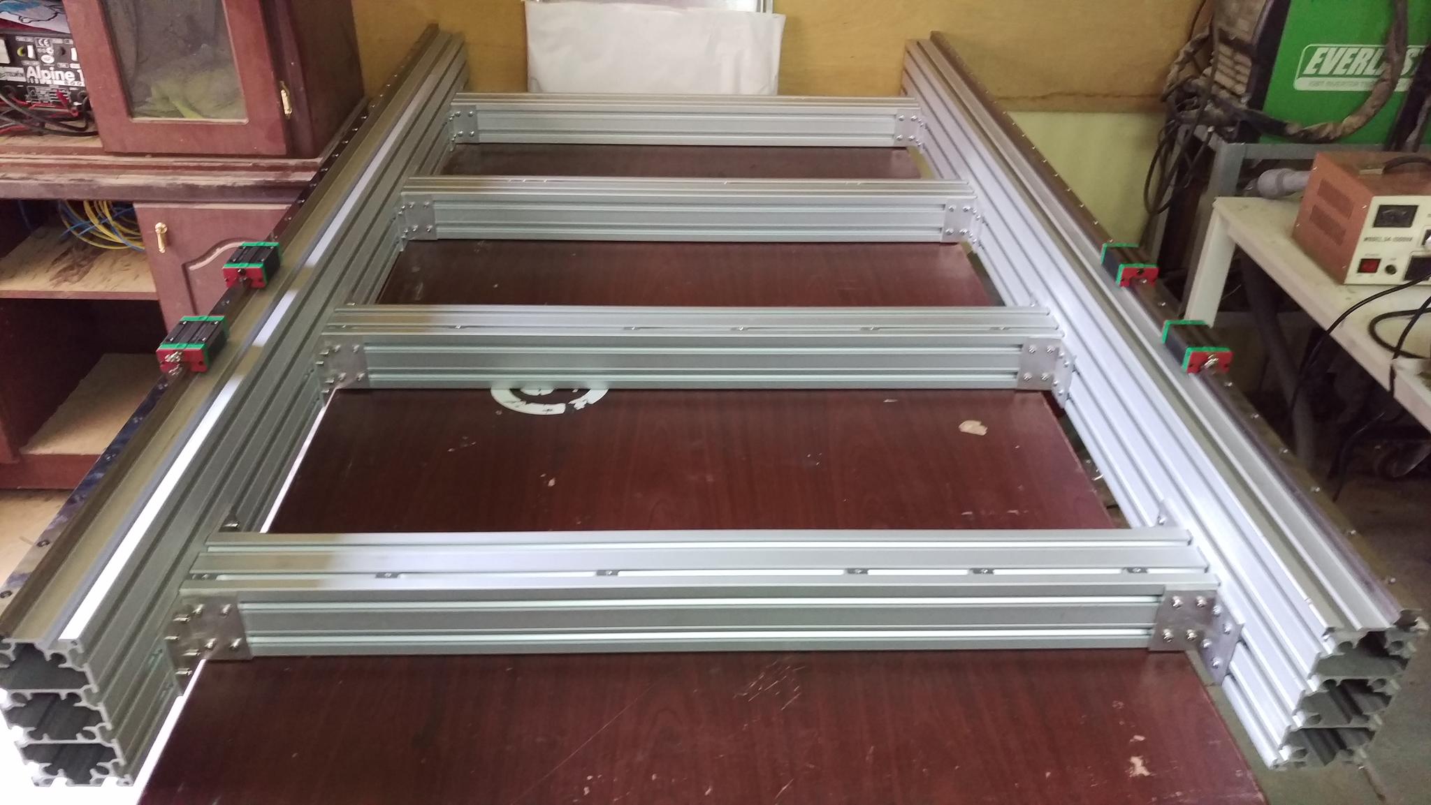

Here is the basic design.
The Y extrusion is quite big, 80x160, and the others are all 80/80 profile.
This is the rough plan
Attachment 19820
This is where I'm up to
Attachment 19821Attachment 19822
To be used for 3d Printing, Composite 3d milling, wood, and possibly aluminum

Somewhere on the forum there is a bending moment calculator which will sort this for you, however I'd say minimum of 15mm for the plates, and for the difference in cost go 20mm, and I'd strongly consider putting a plate across your two 80*80 Z axis extrusions to stiffen up the gantry.
for the Z axis I'd put thicker plates on as those don't look that thick and I'd put the rails on the front plate not back to stiffen it up. I'd also consider connecting your motors to the ballscrews via belts and pulleys rather than directly, this helps take out any resonance (from cutting) and stops it being fed back to the stepper motors.
If you're using the ballnut housing that's in picture 2 how are you going to connect it to your Y axis plates, you'll not get to the screws behind it to tighten it?

I build similair design and depending on the Gantry side heights either 15 or 20mm will work. The Red machine uses 15mm sides but as lower sides. White one uses 20mm.
Like wise the Red machines uses Z axis with Rails on the front plates like has been suggested. However the White one is the other way around.?
Reason for this is down to usage. The red machine was designed just to cut thinner material upto 75mm. It will happily cut upto aluminium.
The white machine had requirement to cut deep material with long tools in Clay model board which isn't very hard material. This required the spindle lifting higher to allow for long tool hence rails on back plate.
Both machines will happily cut aluminium with light cuts, infact the very first Job the customer cut was 4 x aluminium plates for where the machine fastens to the base frame which you can just see on one of pics where machine meets frame.(I only supplied the machine)
Me personaly I would use 20mm every where, even Z axis. Also with Z axis if don't need long tools or deep cuts then would always go with rails on front plate.
Regards the frame and gantry then I'd consider a few bracing plates like been suggested. . . . Hey maybe even cut them in triangle shape.!!
With little bit of bracing then this design will easily do everything you asked about. Aluminium work will require lighter DOC cuts but will still handle it no problem.
Good luck and keep it up.

I'm glad I waited for the design sketches as I mis-understood your question in the first post, now it is clearer.
Gantry end plates at least 15mm, more like 20mm to give yourself a chance with the aluminium machining. 1500x800mm is a large machine and stiffness drops considerably as you go bigger. Really I would recommend raised X axis designs for aluminium but you here now so need to recover what you can.
Long axis (I would call it X) end plates are to stop the machine ploughing off the end of the rails but you'd be surprised how powerful the steppers as when driven through the force multiplying effect of the ballscrew. You could sit on the gantry for example and it would move you around without a problem.
I would not go for 6mm end plates, but 10-15mm as a guide. Final decision would most likely be decided on if you can cut them out of an offcut plate used elsewhere as they would be quite small. The other thing to consider is they normally double up as stepper motor mounts for the X ballscrews so that will also drive the thickness.
Z axis and Y axis plates would go for 20mm personally.

here I used 80 x 40 heavy gauge extrusions ( 4kgm+) with 15mm 6082 T6 plates either end. The gantry sides are 20mm 6082 T6 water jet cut with heavy gauge 80 x 40 extrusion for the (short) y-axis. I am very pleased with the overall rigidity but will reserve judgement until I do my first cuts on metal. It might appear over engineered but I took the advice offered on the forum and I'm confident the machine will deliver the levels of accuracy I need. The use case for my machine is cutting balsa, hardwoods and aluminium at reasonable speeds, hence the robustness of the construction for the most difficult use case (cutting aluminium).
Hope this helps
Mike
Thanks mike - 1 question,
Your gantry sides are 20mm - these are the largest plate connecting the Y and X axis, where did you use the 15mm plate for?
Any did you use plate for the Z / X axis.
I have also used high grade extrusion, the bare weight of the aluminium along for me was 76 kg. I think the Y axis was 9 kg/m, and the X axis around 5-6.

Ok guys - here is my final design
20mm thick
May put gussets over the ballscrew attachment, but Ill wait and see how rigid it is without
Nick
Attachment 19987
Attachment 19988

I'm planning on using up to 200 mm z height, so really needed a design that maximizes this, when I put the first plate with back to back bearing blocks, it becomes hard to do them up ( I have to offset them , in gives less stiffness, down I loose z clearance, and up I have a greater z overhang for the same clearance. I can always bolt angle onto the spindle plate sides if on the future there is some play going on.
My plan is for the rails to be mounted flat on the back plate, I will add 15 mm spacers between the bearing block and the spindle plate to get the extra clearance as at the moment making a rail spacer, or counter sinking is far more work.

10 Attachment(s)
Re: Gantry Aluminium thickness guidance
Nick
I would not use anything less than 20mm, 25mm for Z plate and at least 20mm for spindle if braced by spindle bracket or other form.
If you are not limited with machining process and time than do not cut the corners - do it properly.
See how I keep changing design
Attachment 20152Attachment 20153Attachment 20154Attachment 20155Attachment 20156
Attachment 20157Attachment 20158Attachment 20159Attachment 20160Attachment 20161
after 2 days of scratching my head - still not happpy
All those changes were made to short the overhang by less than 50mm - is it worth it?
Lots of drilling and tapping yesterday,
And I had an accident and slid a bearing cart off the linear rail - then 10 bearings fell out..took ages to pack them back in there, but much easier than repacking ballscrews !
Slides well, next to attach the Y axis ballscrews, and machine the Z axis plate :)
Nick
