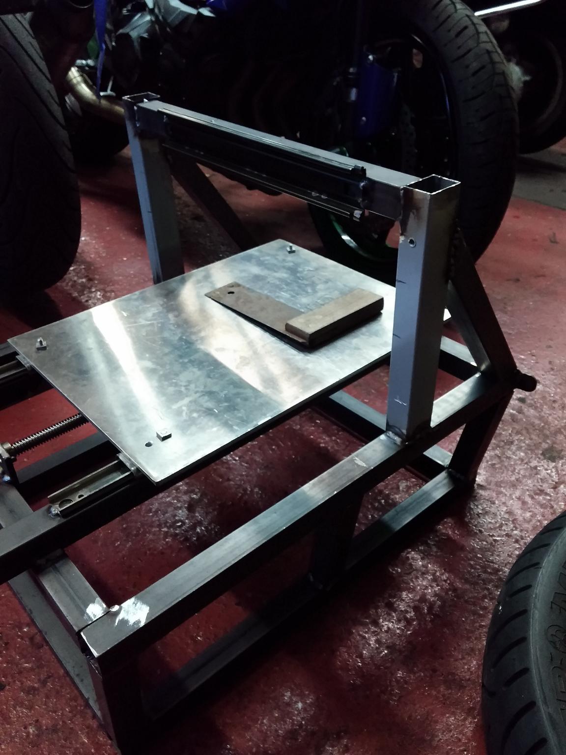

Steel framed fixed gantry draw slide build super cheap
I saw the lack of decent draw slide builds on you tube prompted me to make one better than whats currently on offer on you tube so here it is... unfinished of course !!!
cutting area should be 260mm x 350mm once finished
Attachment 20659Attachment 20660Attachment 20652Attachment 20654Attachment 20655Attachment 20661Attachment 20662Attachment 20663Attachment 20658Attachment 20657

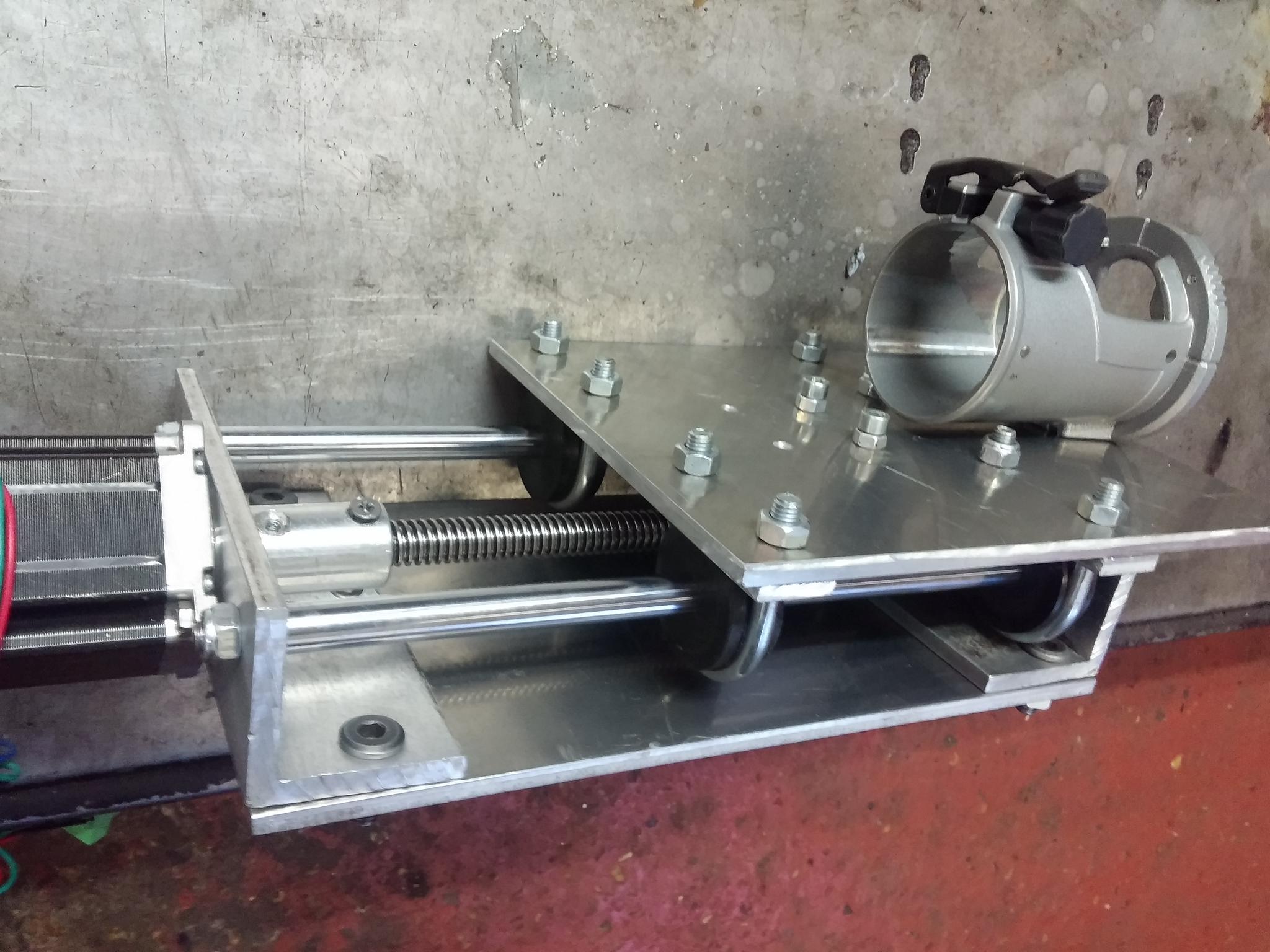

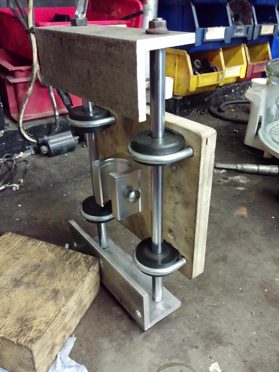

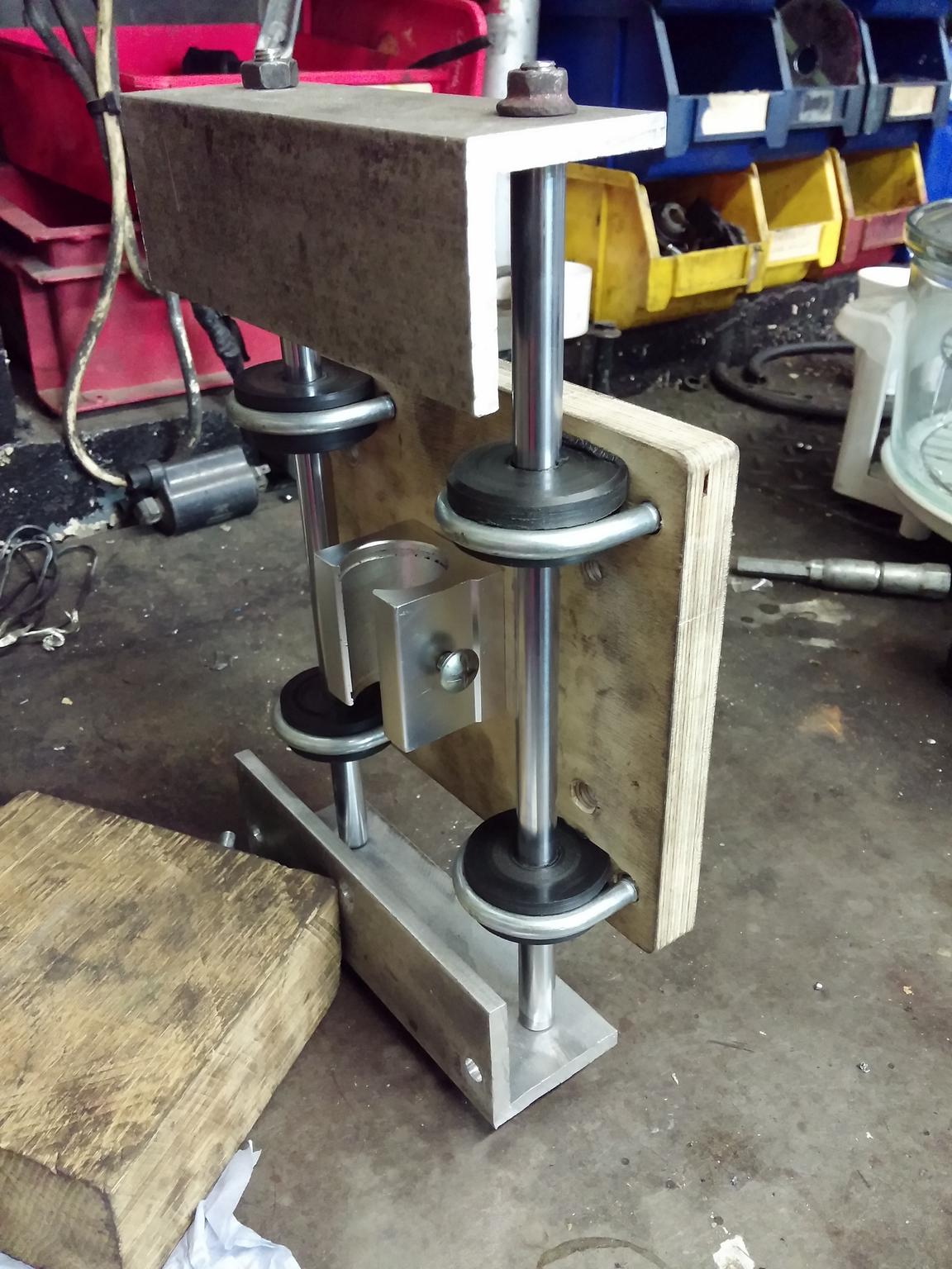

3 Attachment(s)
Re: Steel framed fixed gantry draw slide build super cheap

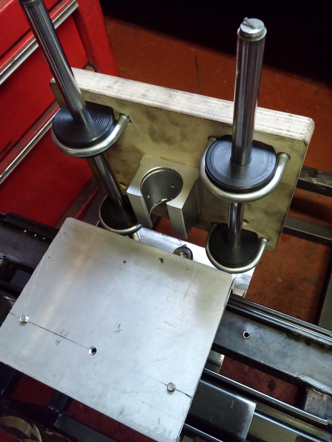

Attachment 20792Attachment 20793Attachment 20794

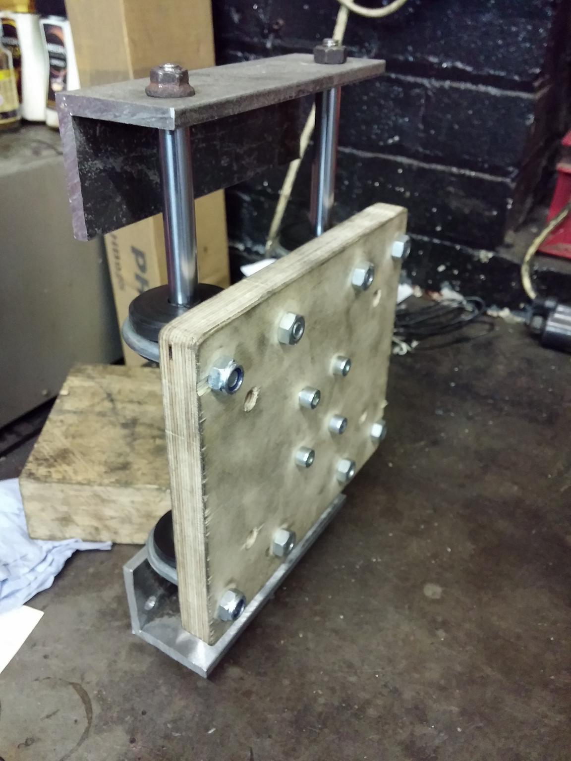

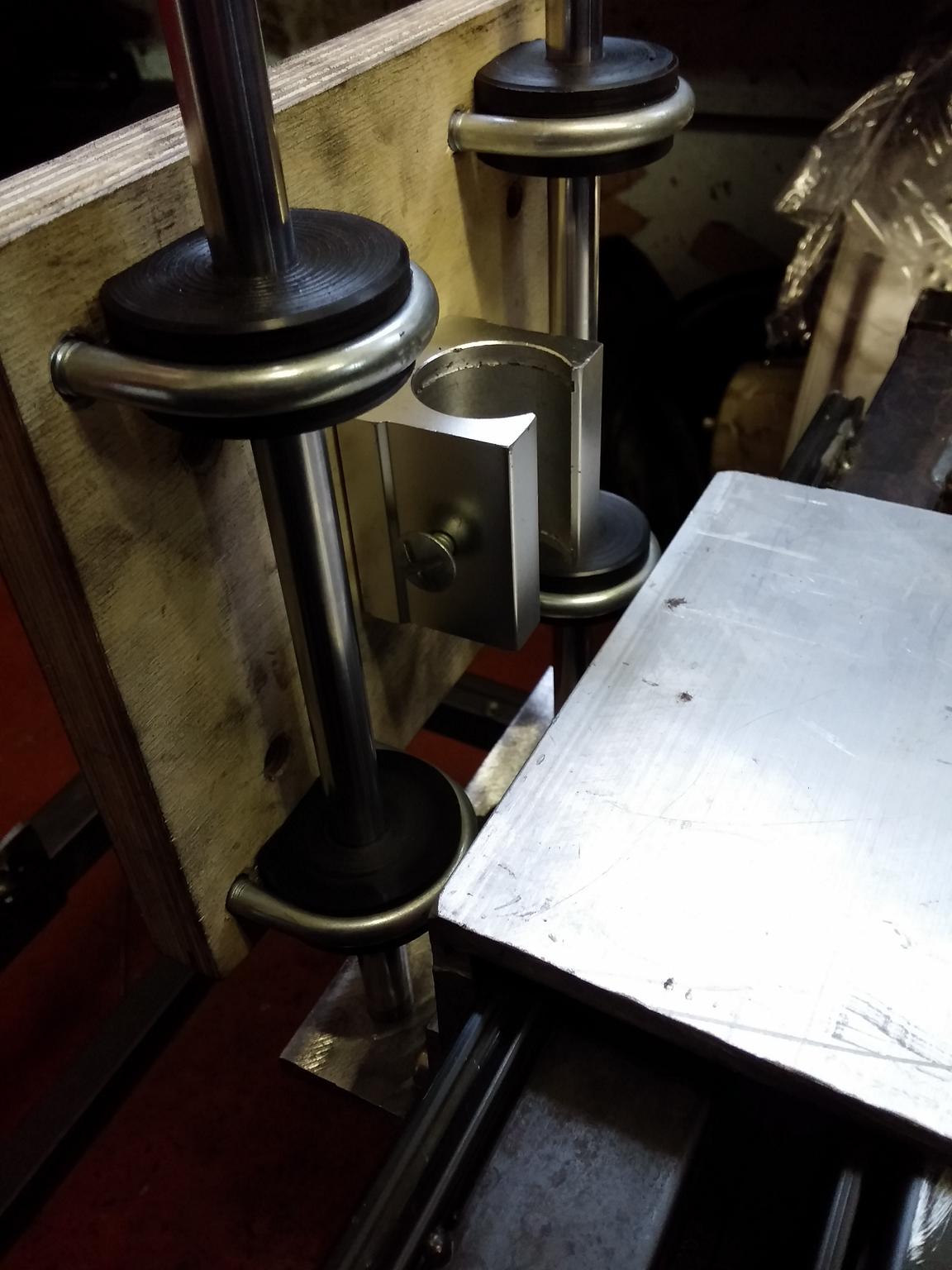

Just a few photos of the z axis, shafts are 12 from some old rear shocks from a car, bushes are nylon diy held down with u bolts

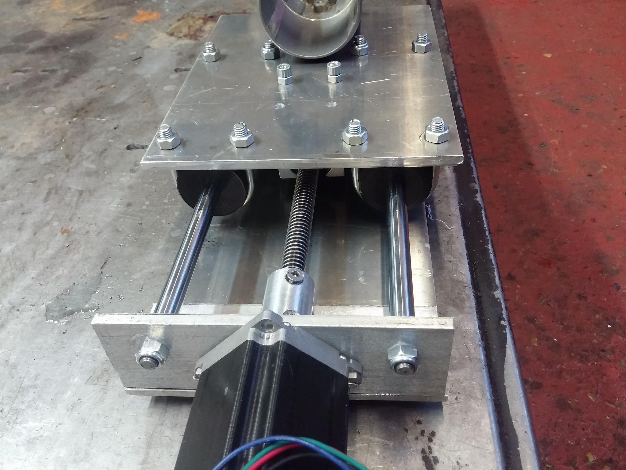

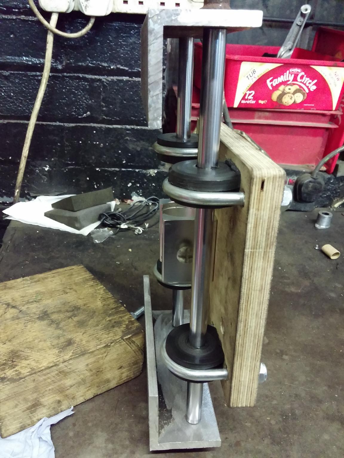

3 Attachment(s)

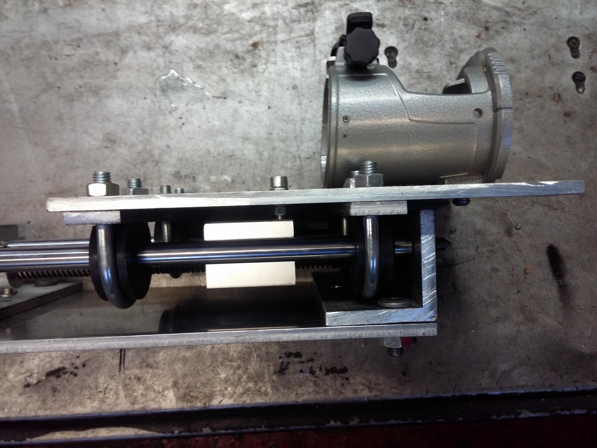

Just a few more photos of the z axis, i will fit the lead screw tomorrow if all goes well.
Attachment 20833Attachment 20834Attachment 20835
finished off the z axis today, i finally gave up on having supported bearings on the lead screw and mounted it directly to the motor as ill only be using this machine for wood/plastics it wont be a problem

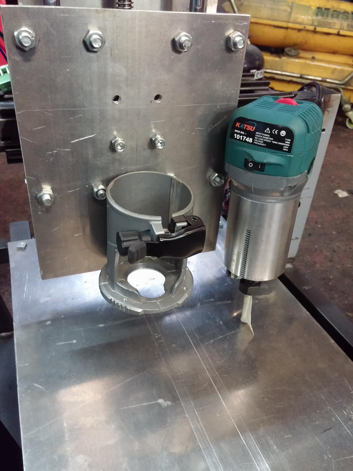

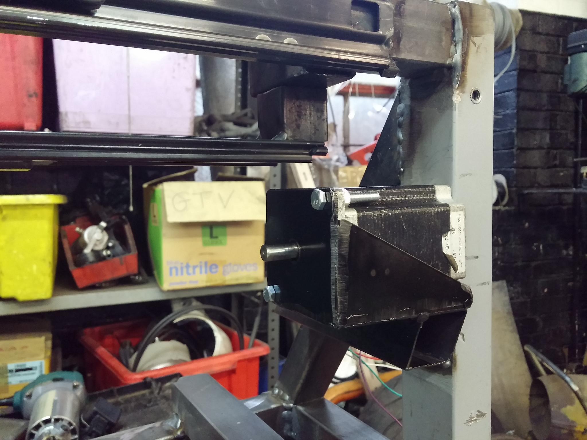

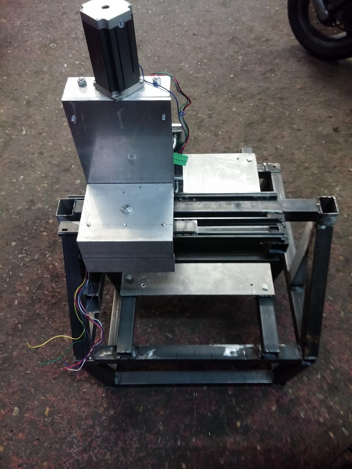

11 Attachment(s)

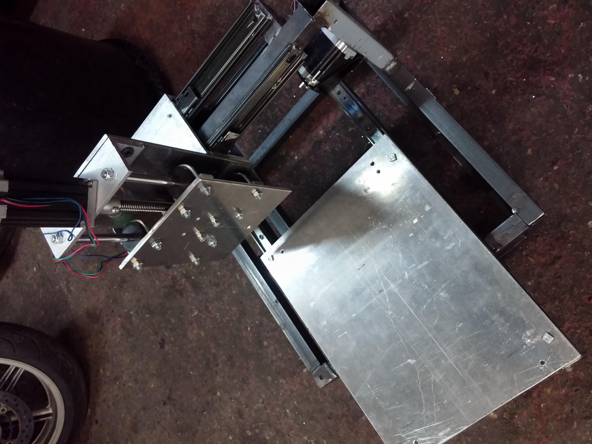

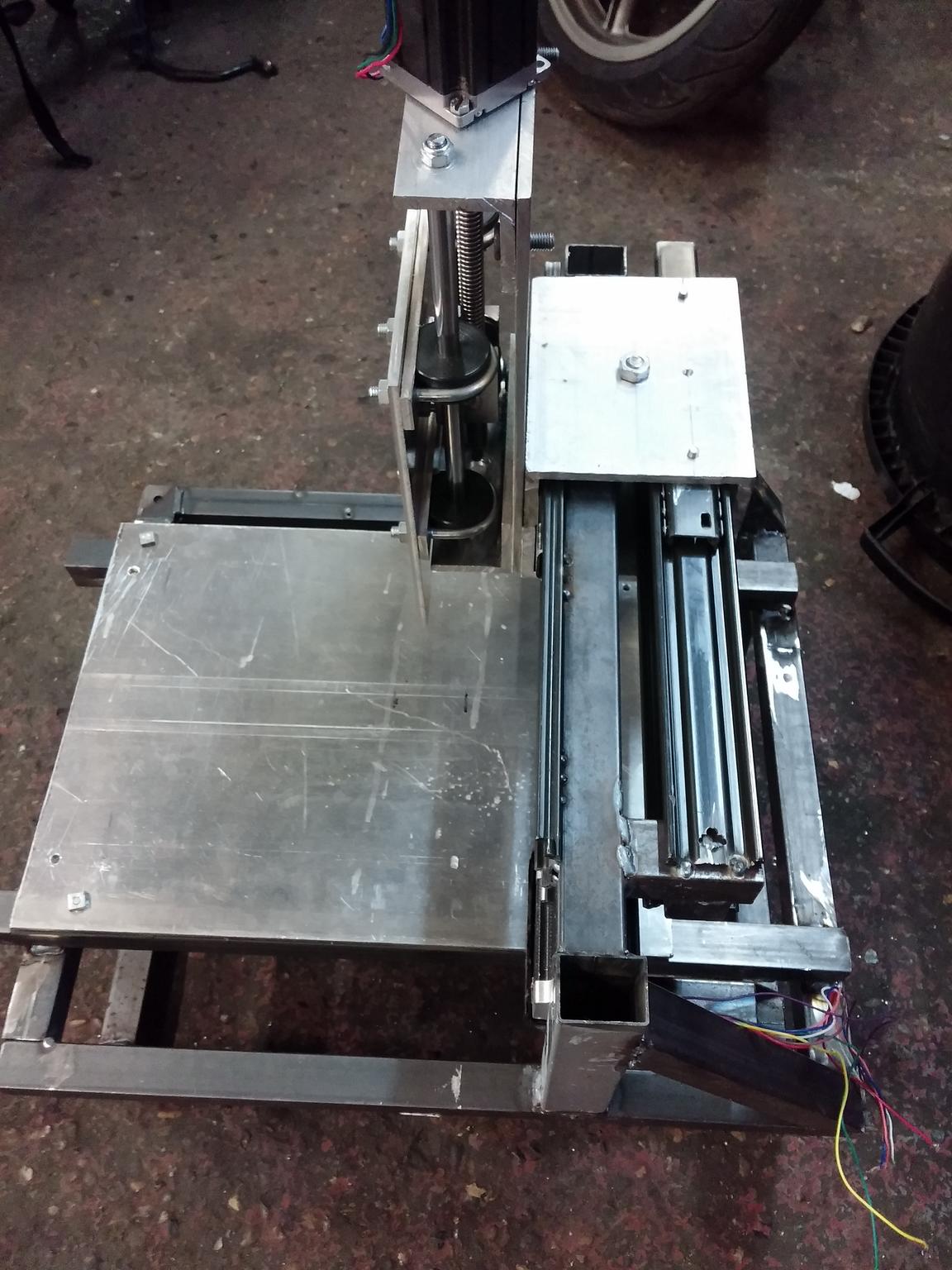

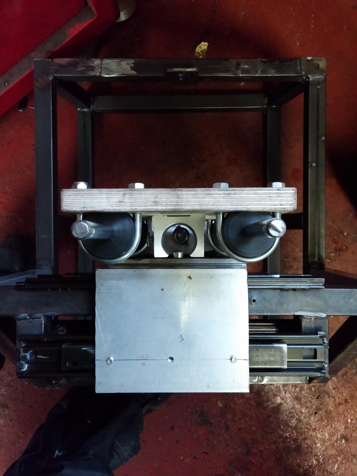

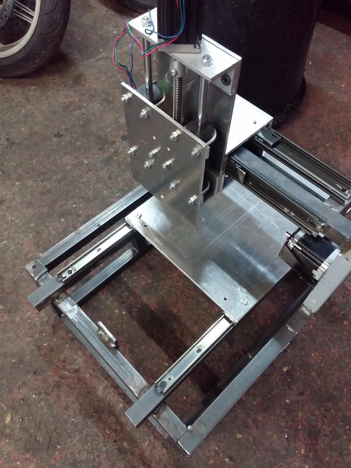

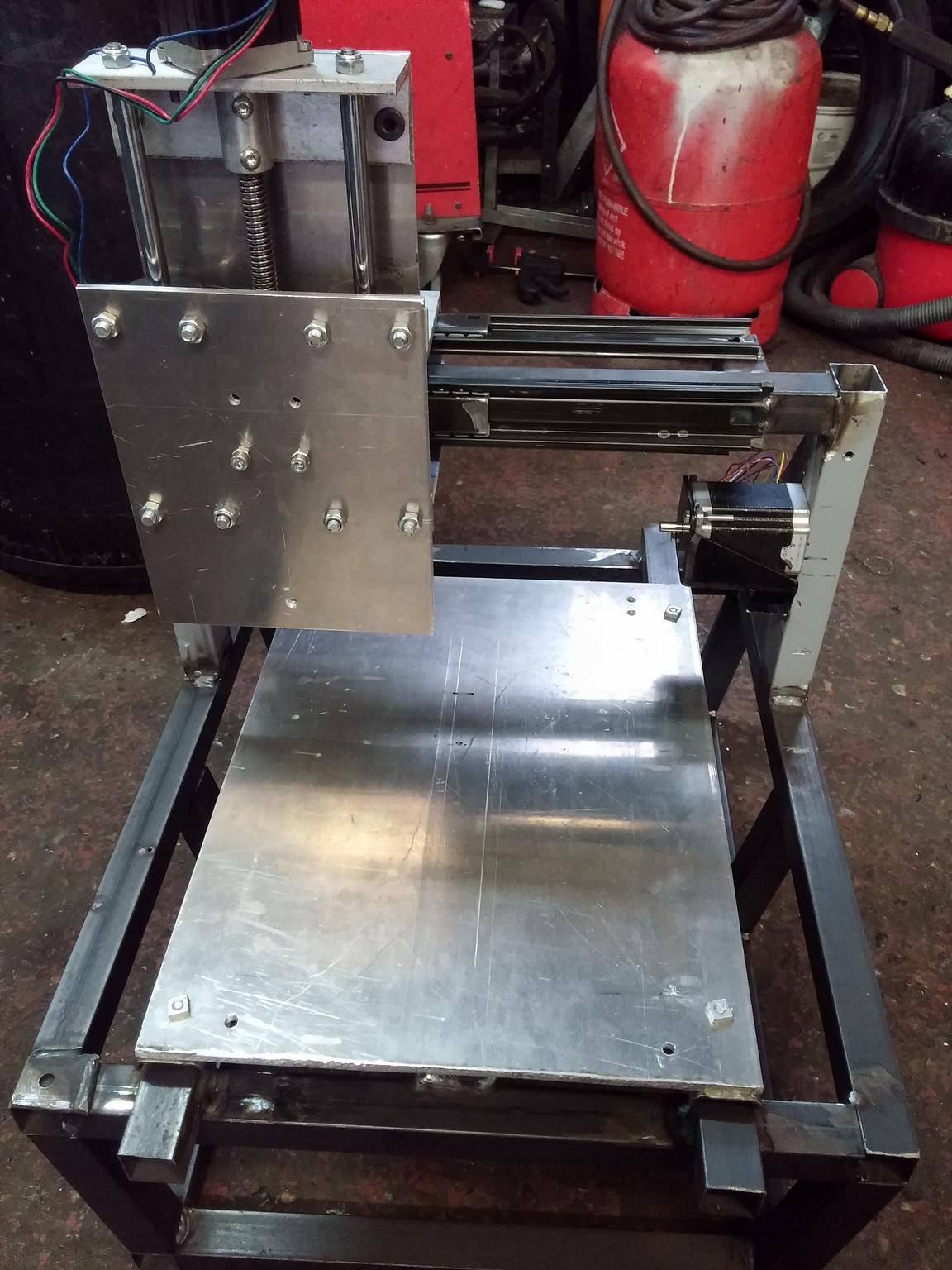

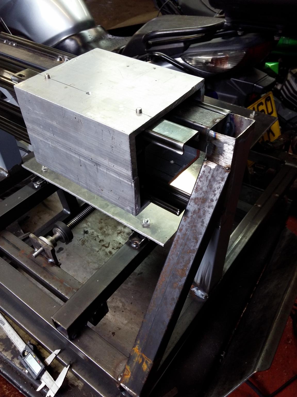

So today I made some progress...
I mounted x axis to the base
I updated z axis face plate to alloy insted of ply
I decided I didn't want the y axis motor sticking out the side so
I mounted it inboard
Im using my cheap ebay router

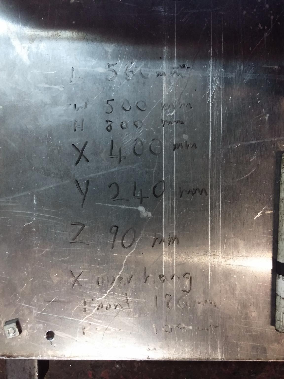

overall Dimensions are as follows...
Length of base 550mm
Width of base 500mm
Height overall 800mm
cutting area...
X 400mm
Y 260mm
Z 90mm
Attachment 20902Attachment 20903Attachment 20904Attachment 20894Attachment 20895Attachment 20896Attachment 20897Attachment 20898Attachment 20899Attachment 20900Attachment 20901
Sorry to sound negative, but you will kill that Z stepper very fast if you start using the machine. The screw seems to be hanging on the motor axis, which is a VERY bad idea, since the motor and the motor bearings are not designed for that heavy job. Same on all the other axes as well, but the Z is probably the most critical, and at least one end of the screw must be fixed. I also don't understand why use drawer slides. Those have just too much play and are not fit for the purpose. But OK, if learning is the purpose then fine, but considering the time you must spend on this, I am sure that real parts are better investment than parts which later on must be replaced, especially considering that replacing and squaring will be very difficult since you have welded everything possible to weld.
Don't be sorry the world is full of negative people !!! the stepper bearings will cope no problem,I am using heavy duty draw slides as i wanted to build a machine that uses alternative components as much as i can

What has been pointed out is entirely correct.
If you are just looking for a cheap machine to mill e.g. foam or something then this probably works fine, as pointed out though the bearings on steppers are radial bearings designed for radial loads. They will be experiencing axial loads when trying to drive the screws which is something radial bearings aren't particularly great at... That will result in excessive play, premature wear and eventually failure.
Given that the drawer slides won't allow you to machine anything hard anyway, you will probably be ok on the X and Y (although they will still wear out and develop slop more quickly, and are more difficult to replace than in a separate fixed bearing block for the screw), but given the weight of the router being pulled up repeatedly the Z-axis will probably suffer more.
It also means you are relying on a rigid coupling between the motor shaft and screw, which translates vibrations and resonance into the motor, which again isn't great news. With direct drive really the idea is to have a jaw type coupling with a rubber/flexible insert that provides some protection to the motor. You can't do that however unless the screw is supported by its own bearing set.

It's no that simple. To calculate accurately you need to know the bearing type and arrangment. Also just saying pine isn't enough as there are many species of pine so each will cut differently and be different Density/Dryness.
However I wouldn't worry about the bearings failing, which they will sooner rather than later, because this will be the least of your troubles. Between resonance and the shity engineering they'll hardly be working much.

Axial force from the plunge is I would say largely irrelevant in the materials you are using and is probably the least of your worries. The weight of the router/mount and travelling parts of the Z-axis are probably higher than the force required from the motor as long as you aren't plunging crazy fast.
Typical max axial rated load for a double bearing nema23 is in the region of 1.5kg-f (e.g. see data sheet here, last page at the bottom specifically) https://www.anaheimautomation.com/ma...ec%20Sheet.pdf
So your biggest problem (in terms of Z-axis axial load, I think Jazz would probably contend that it's not your biggest problem lol) is that unless your screw, nut, router, router mount, and all "hung" mass of the mounting plate is less than 1.5kg, you are already exceeding the axial load before you even start moving.
Let's say you are using a small router that weighs about 3kg, add the weight of the screw, router mount, etc etc and what, maybe 5kg? Simply hanging there before taking into account any dynamic acceleration loads during retracts you are exceeding the rating by over 3 times.
You could bodge your way around it by counterweighting the Z-axis, but you'd still be subjecting it to axial loads when it does actually hit the material by doing it that way, and it would also be more complicated than just giving it a proper bearing setup which would be superior in every way.
edit - actually are you using a nema17 there? in that case it'll be more like 1kg-f axial load rating which would change the equation to being 5 times over load just hanging there.
double edit - I'm not sure why you think a steel framed build like this is innovative or indeed preferable to any of the other extrusion or wood based drawer slide builds? Indeed the only point I can see of doing a drawer slide build is that it's cheap and easy to build without access to any special equipment, which you kind of ruin the point of when you start talking about welding a steel frame. The components you are using don't have the accuracy or rigidity to benefit from the more sturdy steel frame, so it actually seems to be slightly defeating the point of these designs in the first place.

I just looked at the z axis on my 3020T and the lead screw is supported with one bearing on the top plate and either a bearing or sleeve on the bottom plate and the motor is connected with a flexi coupler so those bearings are being used to support axial loads even though there radial bearings. I cant see the difference by using the stepper bearings to replace that type of set up. Im using a 420oz nema 23 fitted with 6000z bearings.
I think i will make a stand to hold a nema 23 to replicate a z axis position with a 10kg weight mounted to a shaft hanging from the motor shaft to replicate what my setup and run the motor till the motor bearings fail !!
Again the point is to build this machine using using draw slides, I have a new set of 20mm supported rails with ball screws but i dont want to make a mid end machine. If it works great if it doesn't then ill make changes but for now ill do it how i wanted to do it and see how it turns out
Yes, Nema 23 max axial load is 15 N. This means -

Ok so maybe ill try this setup ? this is not the finished setup but you can get the idea.
Attachment 20985
That's a just a set of 2 thrust bearings I assume? Which end are we talking there?
Zeeflyboy
Top end, i think ill put a radial bearing in the middle to keep the shaft centered plus some sort of aluminum cap on both thrust bearings so i can bolt everything to the plate.
