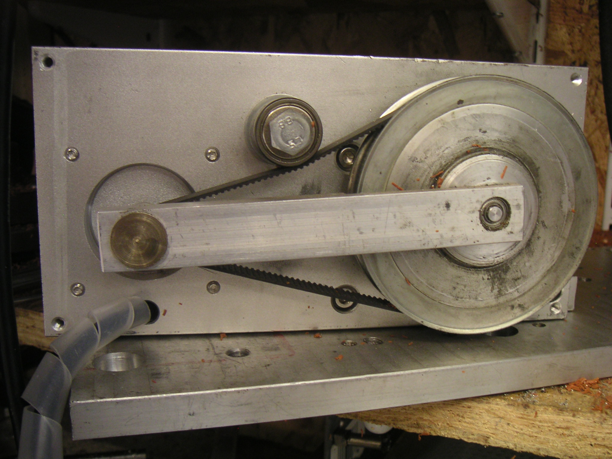

I have an early pic of the "proof of concept" I knocked up with what I had lying around,
Attachment 22607
I've subsequently re-worked the spacer support with alternate bearings to reinstate the through capacity of the spindle, it does what I need in brass, bronze, aluminium and steel.
I don't think it would have been up to much without the tensioner to remove backlash, without the support the stepper shaft bends if you tension the belt,

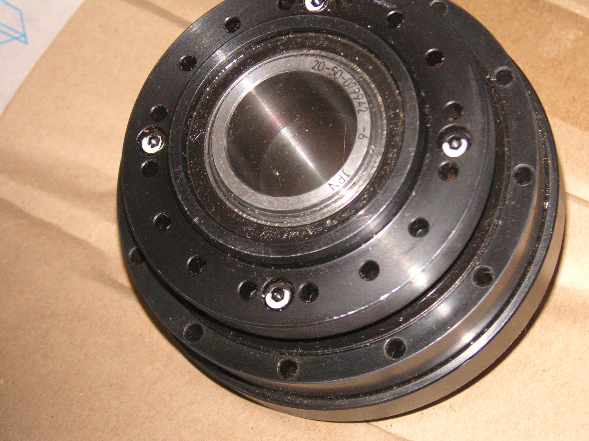

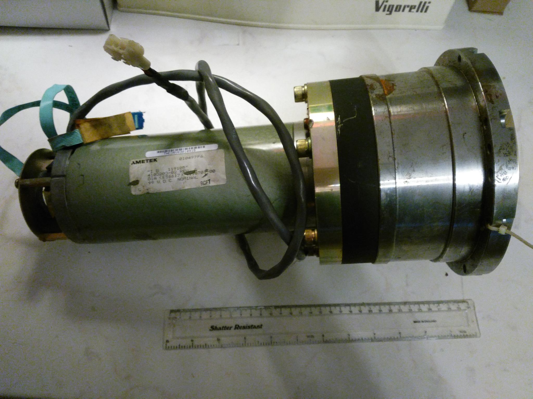

Picked up this harmonic drive some time ago for a 4th axis project, not yet got round tuit. 50 -1 with 25mm through and pre-loaded cross roller bearing on the output ring
Attachment 22615
I just found these things existed but I already feel a deep need to own one, was this an e-bay find?

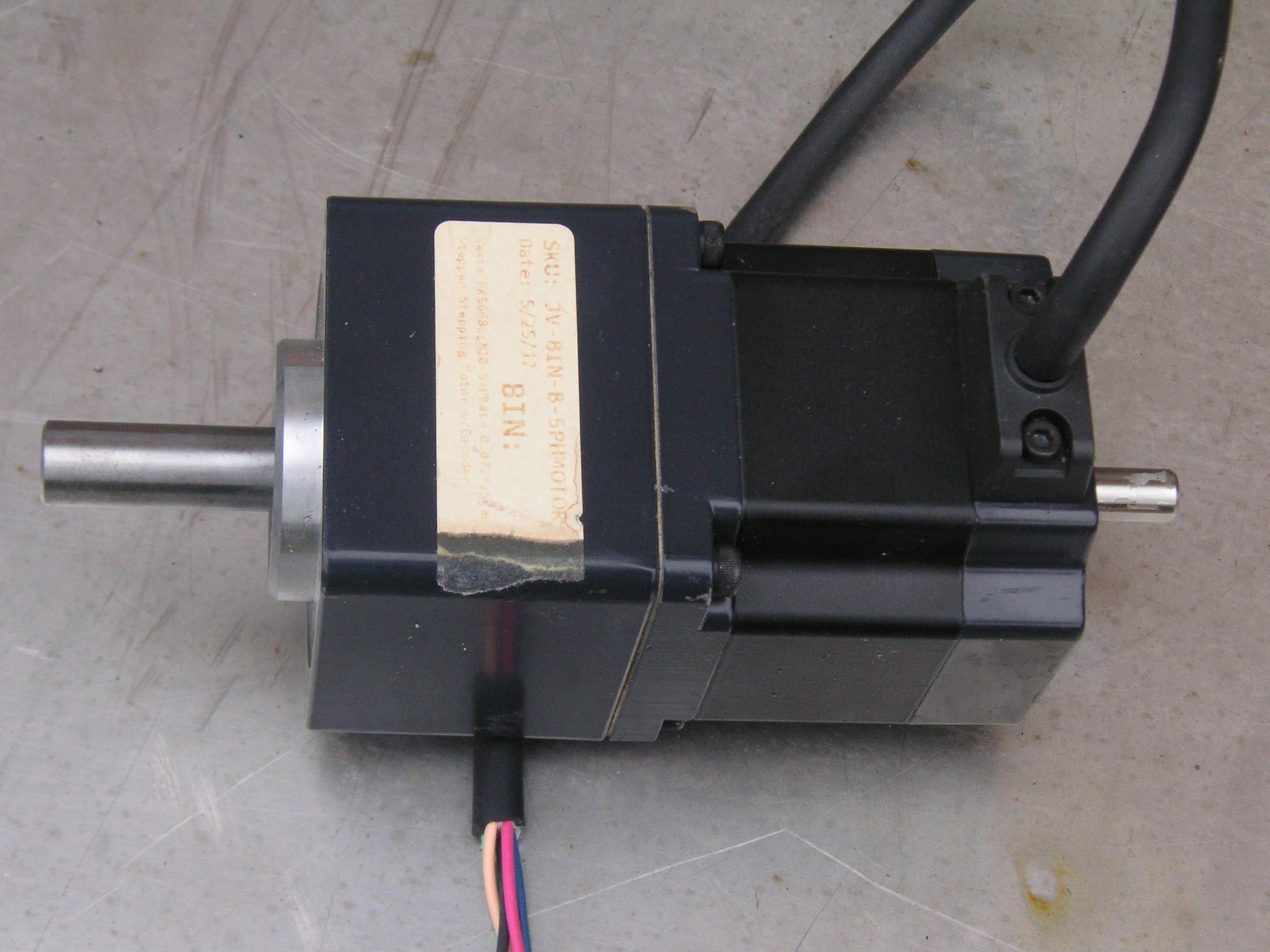

Yes, came across it after I had bought a 5phase stepper with 50-1 harmonic drive ( 25000 steps /rev ) which I was going to belt drive a head 2-1 so that I could incorporate a through hole. I also have some very low backlash 5 phase 10-1 (5000 steps/rev ) epicyclic drives that I thought I might use with perhaps ~4-1 belt drive.
Attachment 22616Attachment 22617

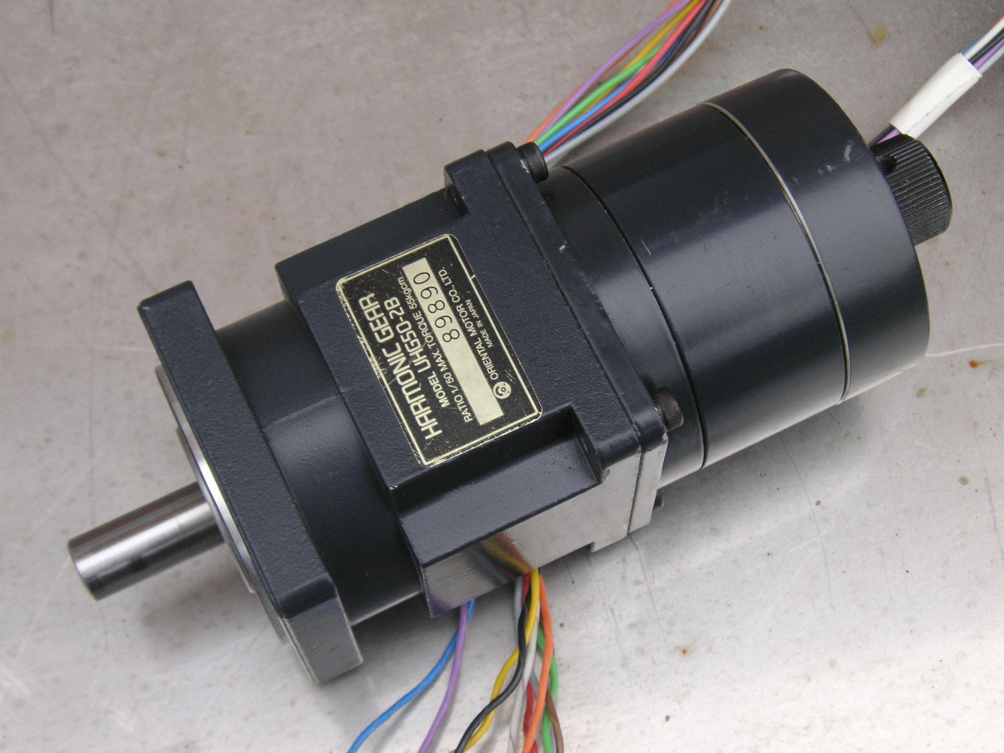

I have now bought a 50:1 harmonic to play with, eBay item number: 291926642351
I thought maybe connect it to a shaft using my favorite Myford change wheels. Not easy to cut the middle out 100% concentric so I would have to spring two together, that seems to do the trick if you want low backlash with Myford wheels. I think I could enjoy this. Somewhere in my junk boxes I have a new pair of 40mm self-aligning, flange bearings, featuring grub screws on the extended inner race. They could easily become a part of this.
They come in various sizes, 11 is quite a small one, do you know shaft sizes

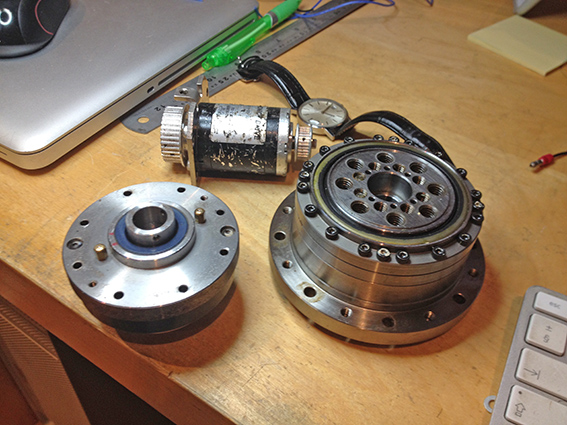

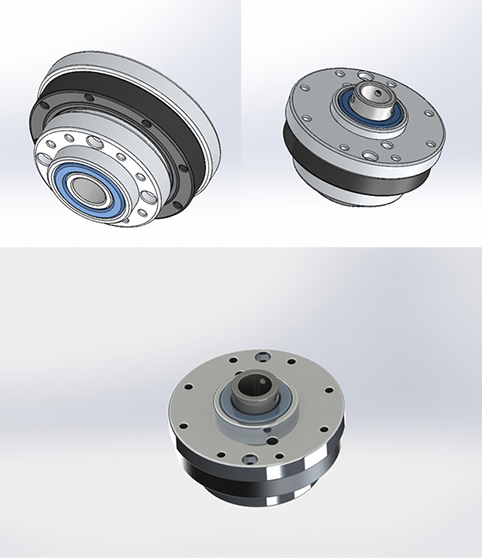

I use lots of harmonic drives for my motion control rigs. I buy them second hand from ebay, but I have also bought a couple of modern brand new ones from the Harmonic Drive rep in the UK. They are very expensive new. HQ is in Germany but usually made in Japan, they own the monopoly, so the cheapo Chinese contraptions may not live up to expectations re. "zero" backlash, quality of bearings and so on. A brand new size 25 HD will usually cost a couple of thousand. I paid £1500 for each size 11 for a camera rig. They are beautifully made.
The one above from Johnattuk is a proper one with very good angular bearings. These usually come from small robotic machines that are decommissioned, a lot from S Korea, and a bit old, but perfectly usable. Some work perfectly, some have seen better days and will work, although they may be a bit bumpy at certain speeds, which you wouldn't probably notice on cnc rigs, but you do notice in motion control where perfect smoothness throughout the range is paramount.
The one you bought, Robin is too small, being size 11, with small bearings. You need at least a size 25, with size 14 being a bit marginal. Typical price for a good decent second hand size 25 with hollow shaft is around £450.
Here is a render of one of mine showing both ends
Edward
Attachment 22623
And this will give you a perspective on sizes. Size 11, size 14 and size 25
Attachment 22624
Lightweight ;), here's a size 50:
Attachment 22644

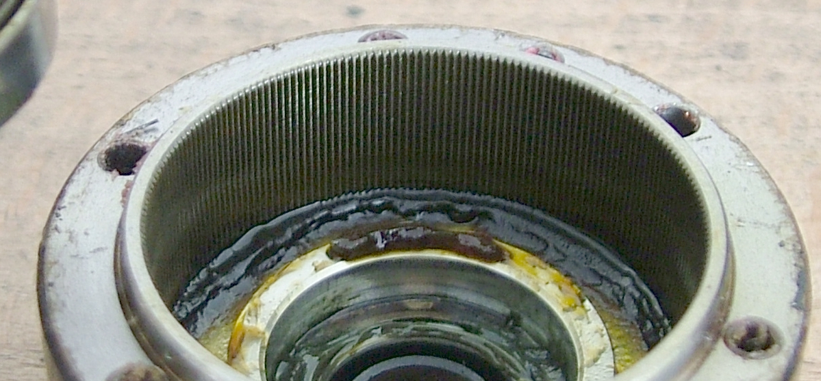

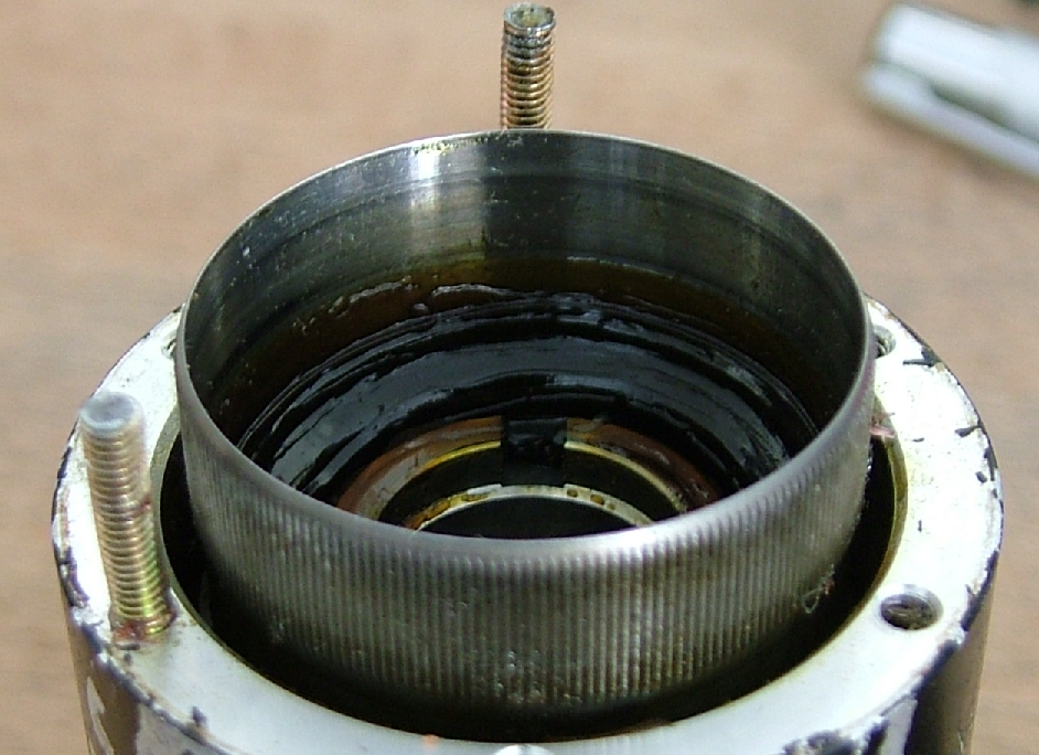

I just took that harmonic drive apart, one screw head decided to snap off, one had to be drilled off.
Much as expected, only remarkable thing is how fine the gear pitch is.
These gears are about 28mm diameter...
Attachment 22685Attachment 22686
Not just the fine pitch but also the fact that they are flexible to mesh and I am not totally sure about the inner workings, but I think they have one more tooth than the gears they mesh with, or vice versa. Incredible concept and I guess very difficult to machine such precision.
Edward
I have to get those headless screws out before I can reassemble.
M2.5 and darned close to the bendy cog. I don't have anything suitable to grab them with.
Any ideas?
Have you tried two or three nuts locked together perhaps with heavy duty locktite retainer as well
