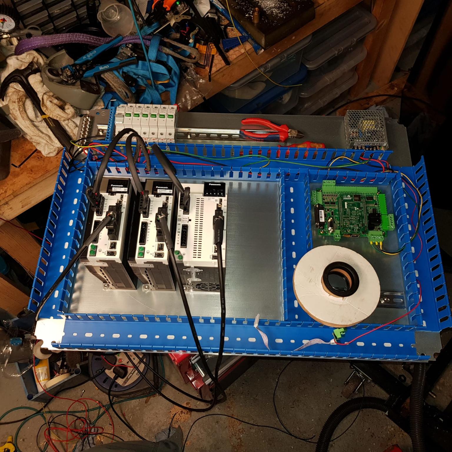

		Acorn control board and MPG ordered yesterday, so getting ready to start retrofitting.
I managed to get a quote from DMM. Great company, quick response.
They have a Nema 42 replacement motor (fairly new, released a few weeks ago). My motors (According to them) are Nema 42.
The ones they are proposing are same shaft size which is very helpful (5/8th inch) as I am struggling to find direct replacement pulleys with 12 and 13 teeth respectively (14 is minimum generally).
The issue is the motors are not a perfect fit (mounting holes are a bit different - 75 PCD vs 82 PCD, probably minimal effort to sort this but they are fairly pricy and potential import tax from Canada. These are 1.3 KW servos, running off 220V (so high volt feed). Including 3 meter encoder and motor cables plus the Acorn DB 25 cable and programming lead, these work out at around £500 ish per axes.
I know the stuff from BST Automation and other sources listed are cheaper. Id like to have as little mechanical fuss / changes to make this all work (most seem to have 19mm pulleys), so modifications will be necessary but it looks like exact like for like change, so mods will have to be done anyways.
Thoughts?

The pulleys are 12 (X and Y) and 13 (Z) respectively. H pitch. Beltingonline are telling me they can have them made to order but warned that they will be pricy (I need to send them some pics) as I've suggested that maybe I just bore them out and install a grubscrew.
In terms of costs, sure, I dont want to spend more money than I need but I could get this machine running on steppers for a lot less money, that's not the point here.
If the DMM stuff isnt much better or doesnt offer more than perhaps an easier fitment, then I might as well save the money and use that for a better touchscreen / PC whatever. I'm not trying to cheap out on the build but dont see value in paying for something that doesnt offer better. Of course the law of diminishing returns persists too.
As an example I have Panasonic drives and motors on Thor and cheaper Chinese stuff on my old Triac. The Triac worked OK but no doubt the Panasonic stuff is better. The only reason I bought them was that I got some stuff at good prices from an Ebay seller. I wont pay RRP or similar for Panasonic.
I can get away with a 750W system, been avoiding it due to mounting concerns, bracketry might be OK, motor shaft diameter and length are the main concerns. One guy on Youtube has basically extended his motor shafts to suit.

 Yep, mine was ordered on Wednesday, import tax is a bit harsh, might be delivered today or Monday latest.
I have some potential Panasonic servo motors sorted, will check over the weekend and see if they will work then i need to sort out mounting / pulleys.

		Managed to get two of these 800 x 600 x 300 enclosures for fairly cheap. Perfect for this (I was thinking to use the original box), but this will work too.
Testing a layout. Any thoughts / concerns with what I am proposing? The VFD will be placed externally.
Attachment 25359
Attachment 25360
		Re: Bridgeport Series 1 MDI Conversion
		Nice project Chaz.
I’m sure you know this stuff but when I did my box I followed a few guidelines and have not had any problems or false estops:
Power lines separate from logic lines
24V logic wherever possible (not 5V)
Star Earth point
Drivers in a row not column so heat went up and away
VFD tucked up in the top left corner so air came in through the left side of the panel and straight out the top (if your VFD fan draws from the left side)
DIN rail power supply not the generic ebay power supply (just for ease of mounting, not sure if there is any electrical principle difference)
Ferrules on each cable
Final tip is give your fingers room to get in to insert cables and space for the screwdriver.
