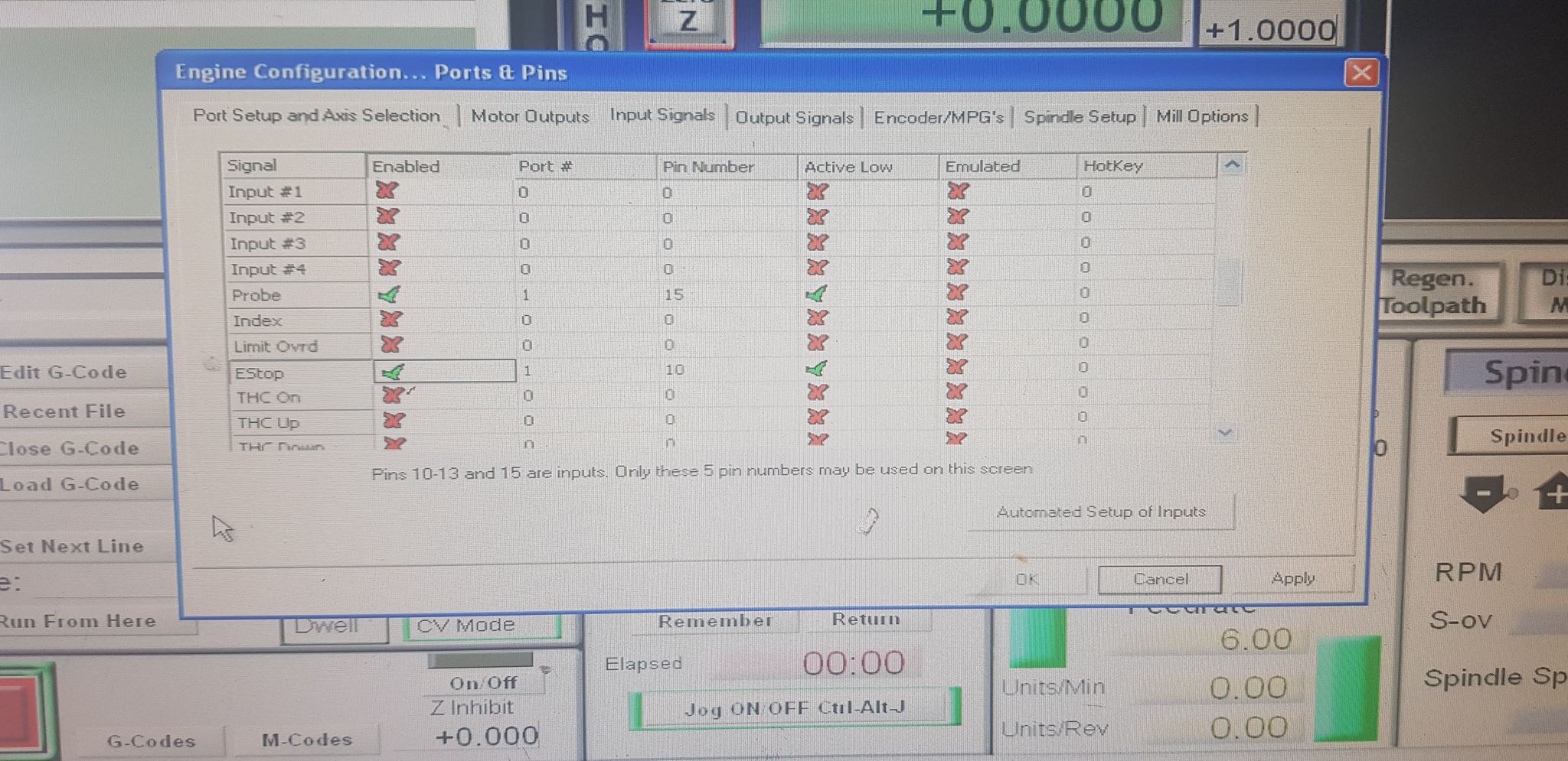

This is the pin allocation within mach, I've got one side of the e-stop wired into ground and the other into pin 10 and set to active low.
Can anyone tell me am I looking at an issue within mach or a hardware issue.

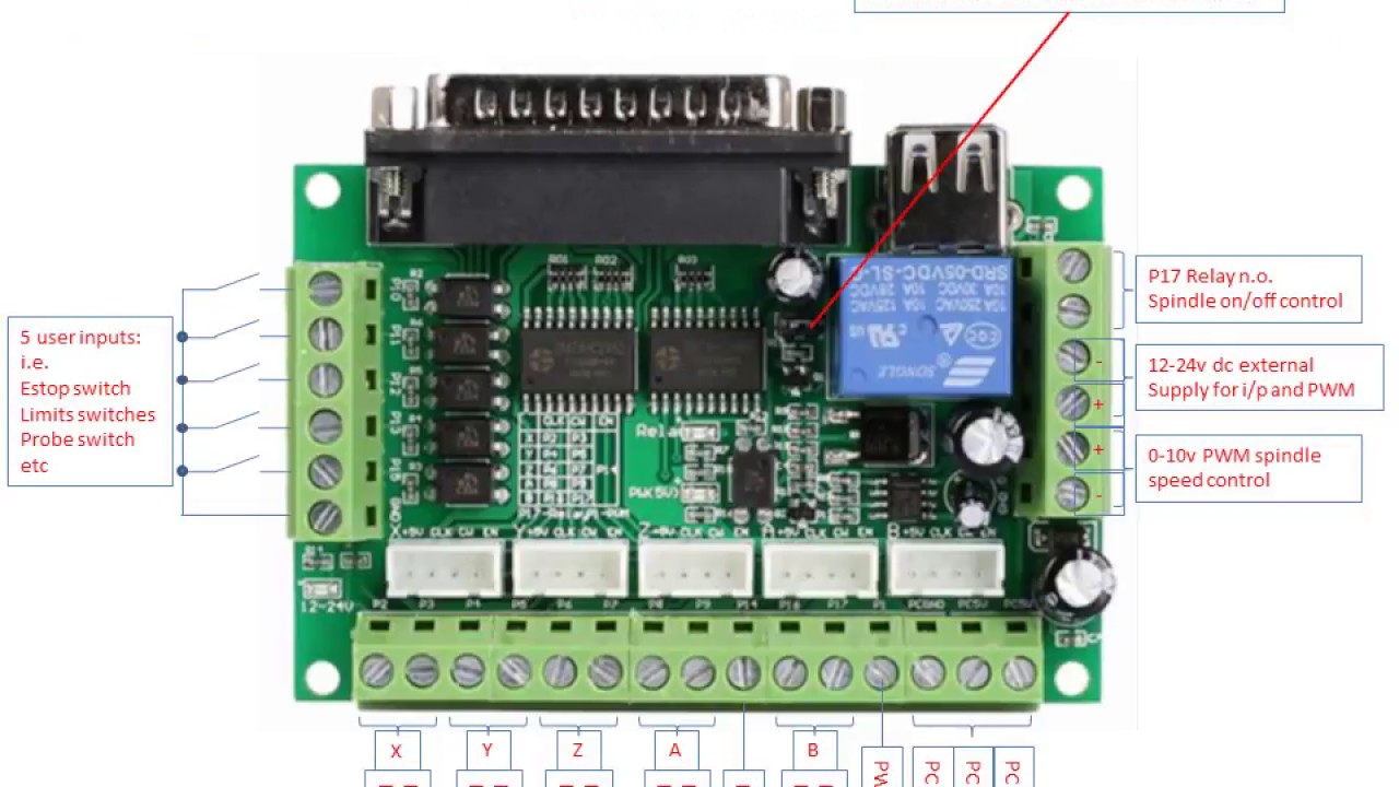

If you go to the Diagnostics screen in Mach3 activating estop should cause a port 1 pin to alter state and the Emergency indicator to come on. If that is so you are wired up and configured correctly. I have this BoB, but unfortunately I am not able to confirm P4 is the appropriate place to take 5v as it is installed in a control box which is not easily accessible. I believe that the p10 input floats to 5v and only needs a connection to, or disconnection from, GND to activate.
While I think about it, is the 12-24v power connected ?
If you need the BoB manual, you can download it here:- https://www.dropbox.com/s/gfq4isvihn...rd-EN.pdf?dl=0

You have not answered Rob's question re the 12-24v on the bob also do you have the correct port set in Mach3. Should the e-stop be connected between grd and pin 10

I did it's in there with the its been working fine. E stop is wired between ground and 10 as described above. It's set to port 1.

Well it seems you don't wan't to answer questions. No one has a crystal ball. re. "I've got 5.5v between pin 4 and pin 10," I don't think that is the correct place to get the 5v The inputs should show about 5V between a pin and ground. The reason for asking if the 12-24V is connected is that the inputs pins won't work without it.
