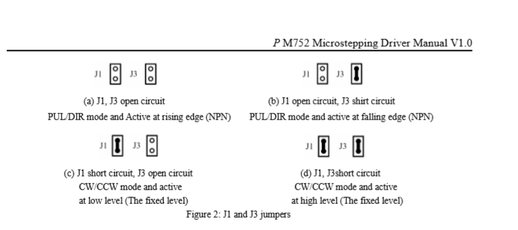

Just about to head down to the workshop to try the pulse edge thing, but I also notice in my drive manual/datasheet that there are 4 jumper settings to choose from:
Attachment 27218
I'm assuming that "a" is default, so I probably need "b" (or vice versa depending on what I find in there and assuming I don't set it in MACH4)?

Yes that's the drive setting for switching leading edge but just do it in mach4 it's easier.

Latest report:
I couldn't find the setting in MACH4 for the Dir Active Low (not in Output Signals, nor Axis Mapping, Motor Tuning tabs in Config, nor in the CS-LABS plug-in which is where I kind of expected to be hiding if its in there). I wonder if the CS-LABs guys need to write it into their plug-in for MACH4? Also CS-LABS have released a new version, but I figured I had enough variables to contend with in one night :)
Anyway, having lessened the ghetto factor recently on my control cabinet, whipping the drives out on their DIN mounts and putting a jumper on J3, seems to have worked a treat and the same toolpath that was resulting in a 5mm unwanted offset is now spot on, so thanks again chaps for the advice.
