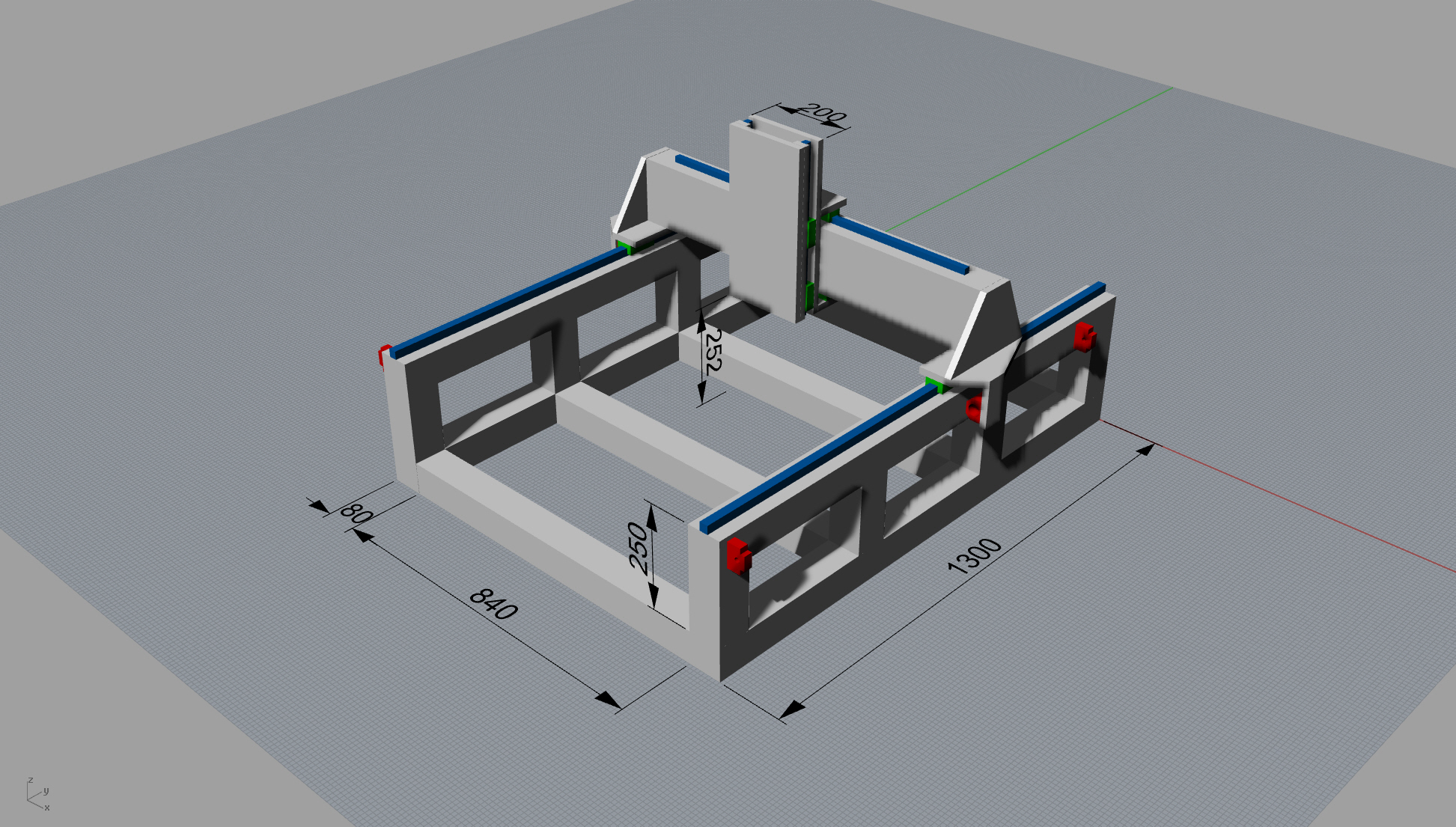

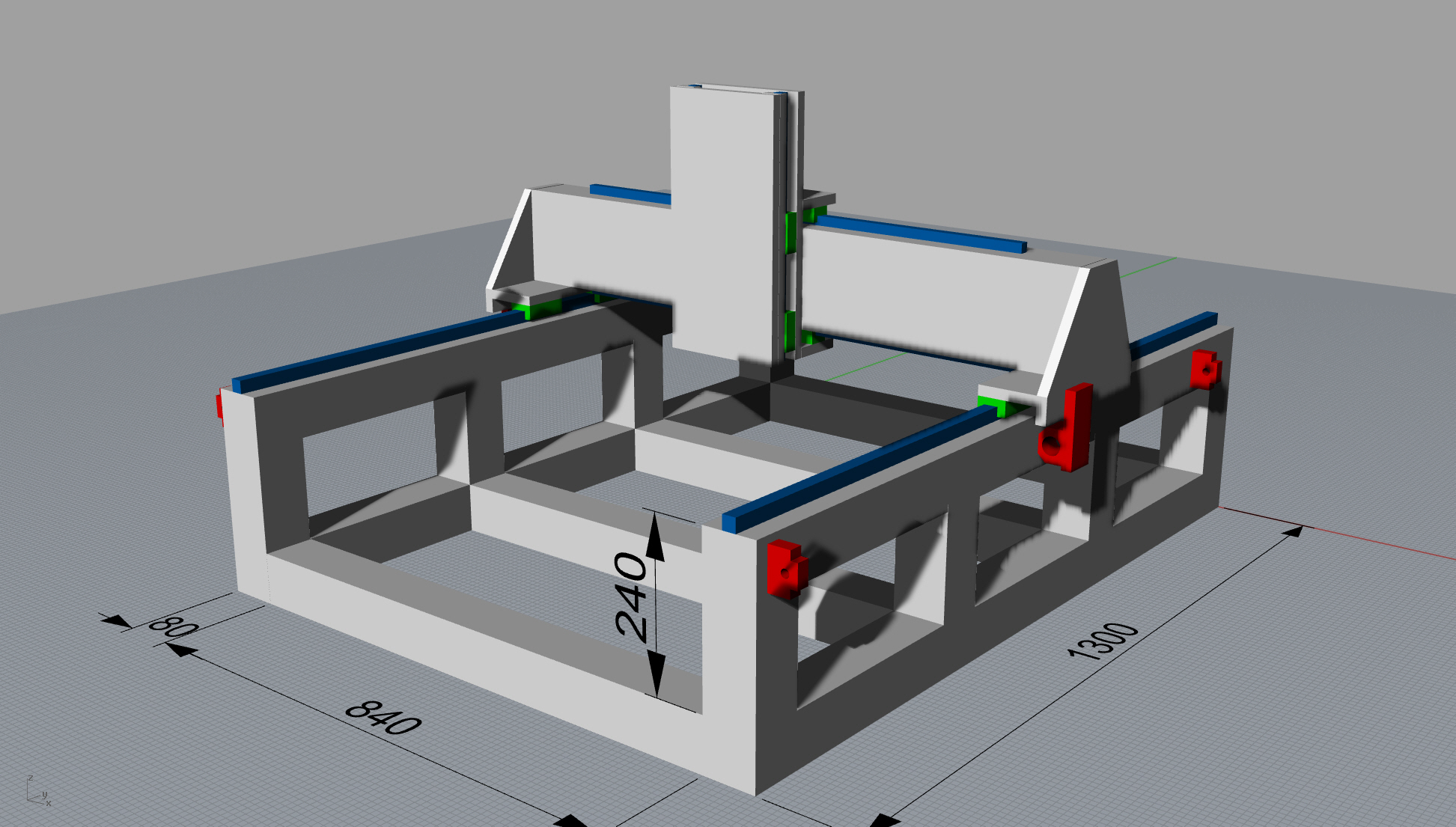

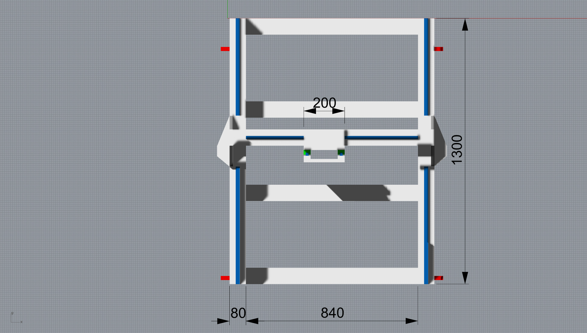

		5 Attachment(s) Joe's 1000x600x200 steel and aluminium router started

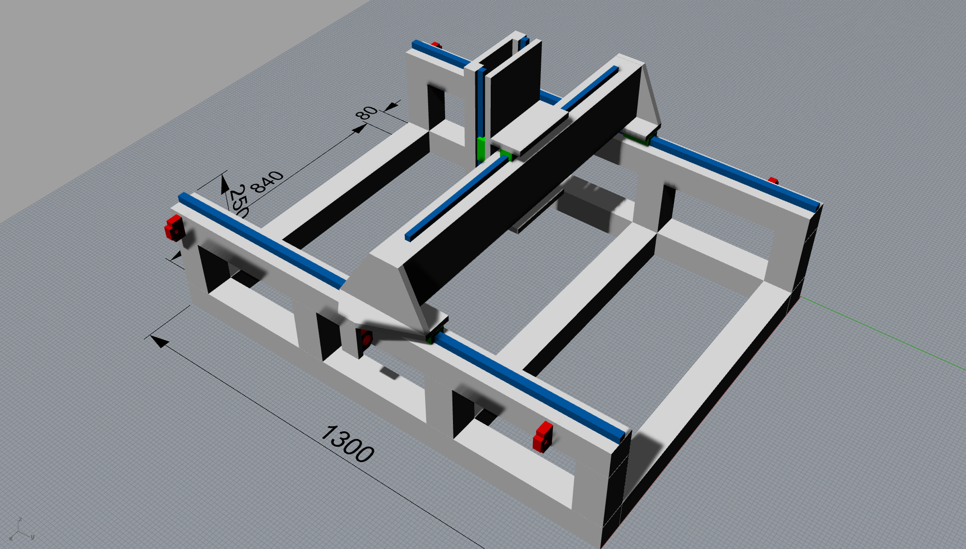

		This will be the 4th machine I've built but the first for 10 years and the first I have posted a thread on. After various house moves, workshop rebuilds, etc, I am actually without a functioning router for the first time in ages which is extremely frustrating!
 This machine will be reasonably compact, work volume of around 1000x600x200mm. It is very similar to the first router build by Boyan, in that it has a self supporting bed frame with raised X rail supports. I need to process aluminium, carbon, modelling board and maybe hardwood.
 Frame is 80x80x3 welded steel box.
 Gantry is 160x80 extrusion (Item series 8 heavy or clone thereof).
 Plates will be 16mm cast milled tooling plate which I will have to produce on my manual mill.
 Ballscrews from Fred, 1610 on X+Y, 1605 on Z, with BK/BF12 AC support blocks.
 Hiwin 20 on X and 15 on Y+Z. X rails will be epoxy levelled with West 105/209.
 I'm going to use steppers (in the past I used DMMTech servos) but seemingly 3N steppers with digital drives are quite suitable for this small machine.
 I have done the basic dimensioning so I can get started on the frame. The gantry plates and Z axis will be adjusted as required but the sketches below should give you (and me) and idea of where I am heading.
 Attachment 26759
 Attachment 26760
 Attachment 26761

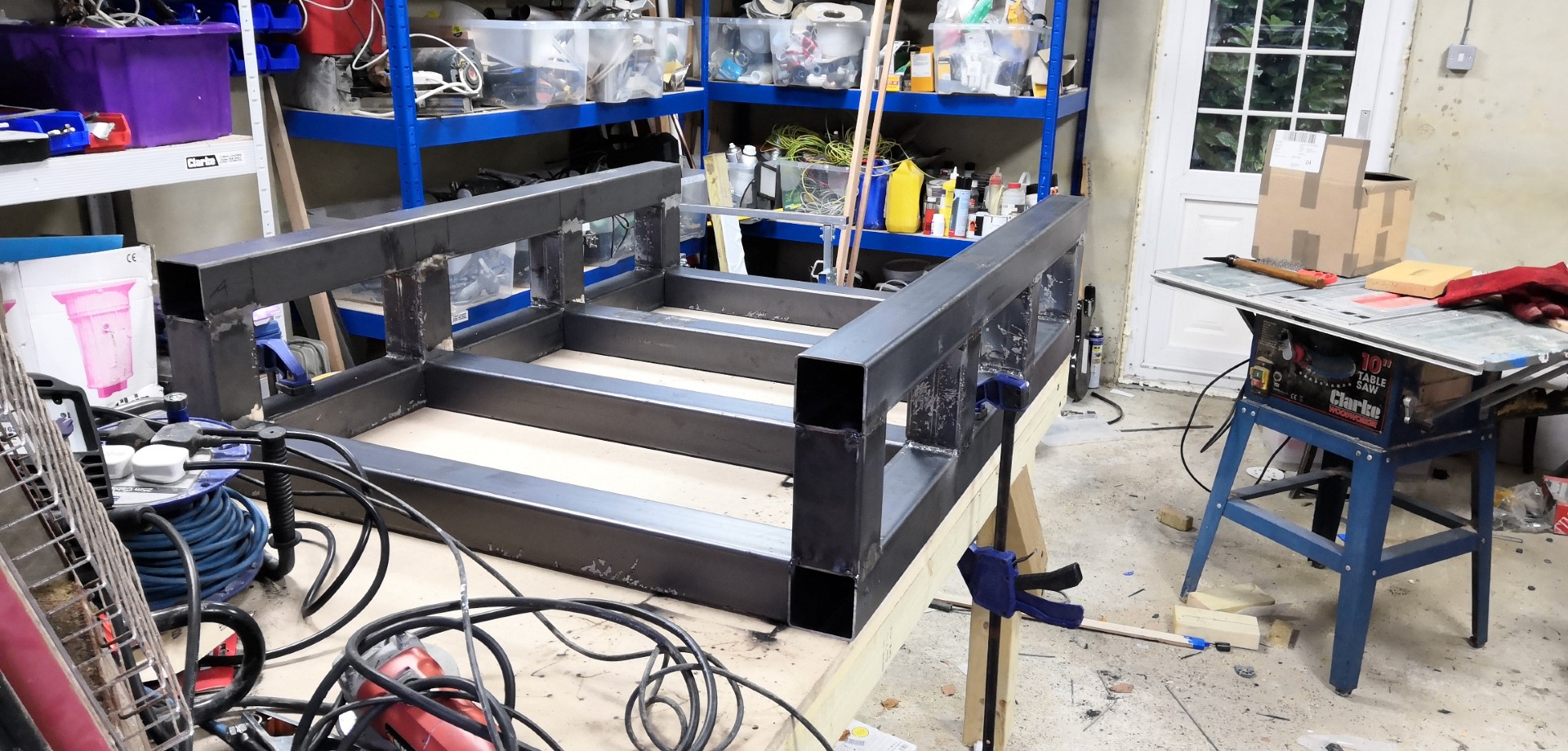

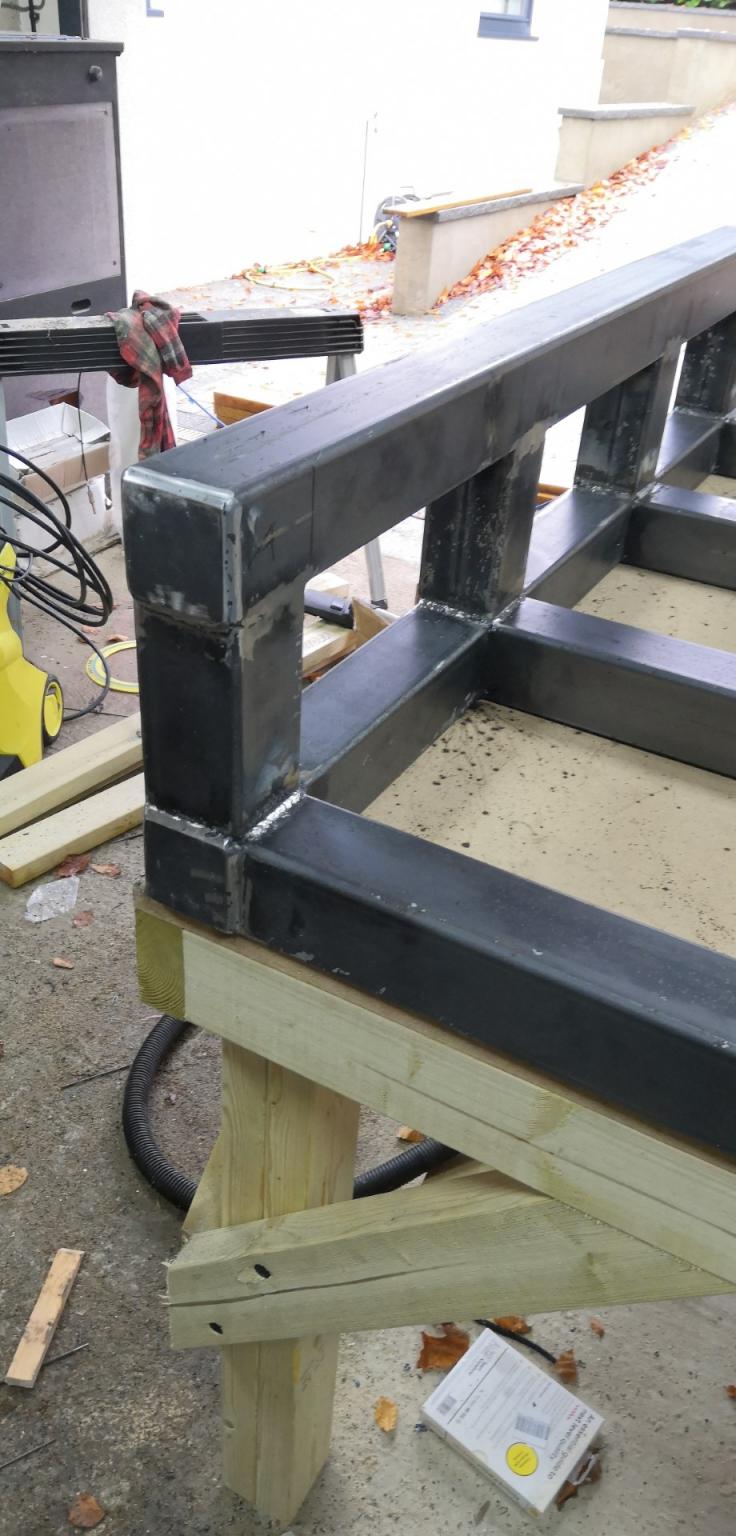

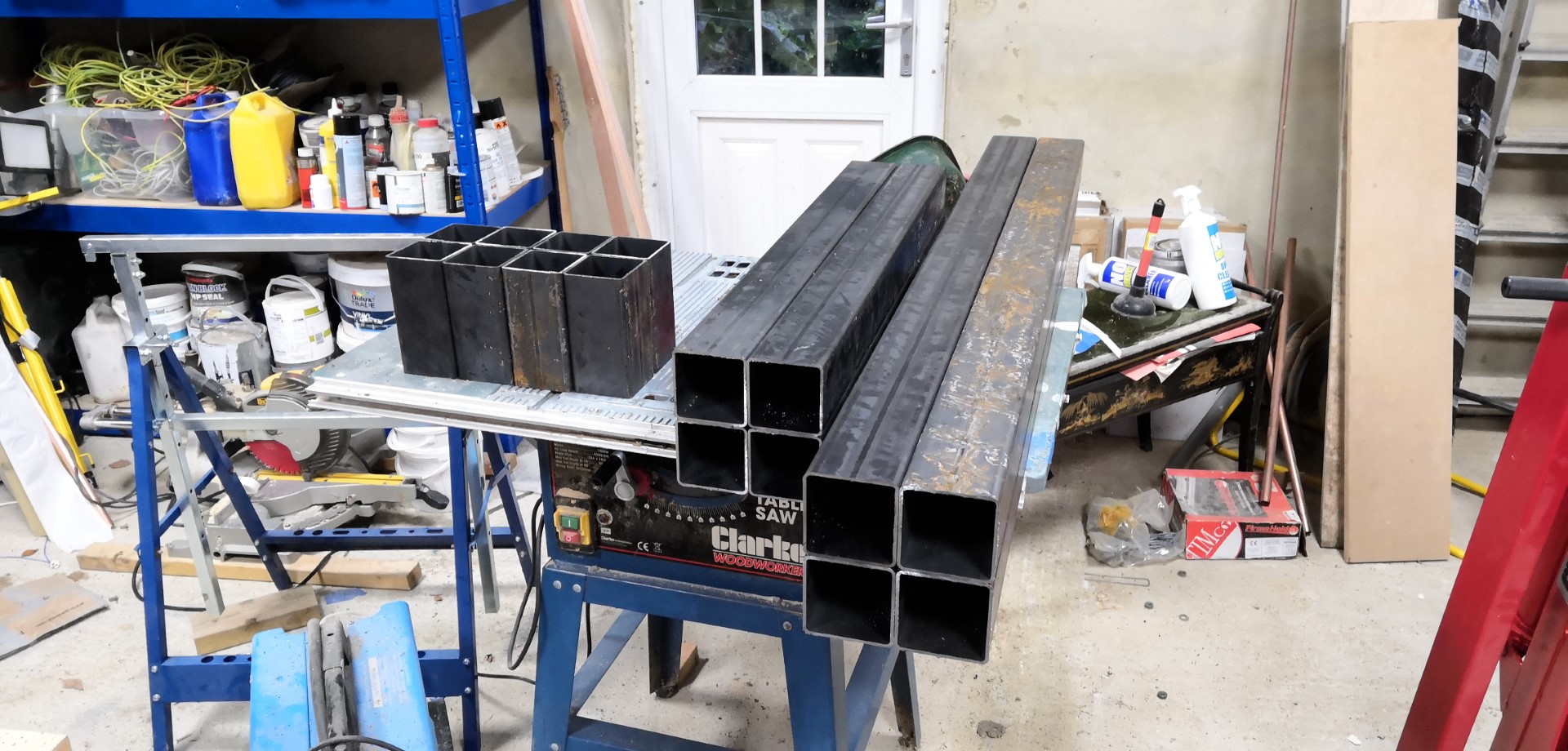

 Frame box section cut to a fairly good tolerance on the trusty/rusty Rage2.
 Attachment 26762
 And frame welded up, not quite finished yet, needs some end plates and reinforcements to catch the screw supports and motor mounts. I used an inverter stick welder, quite a revelation, amazing capability in something the size of a lunch box. Was quite careful to avoid warping, not by limiting heat but rather by carefully sequencing the welds to counter each other. I can't measure any warpage so it was successful.
 Attachment 26763
 I would would welcome any input on the basic design, but more urgently I'd like some help on the following:
 1. Where is the best place to buy cast milled plate from? The guy I last bought from locally has gone to the wall.
 2. What is the minimum constant temperature you would risk an epoxy pour with 105/209?
 3. Has anyone bought extrusion from Alprofil? http://www.alprofil.com/aluminium_profile_frames.htm
 Cheers, Joe

		Looking good, classic design.  Ballnut brackets off gantry plates may need a bit of support?
 I’ve always ordered from aluminium warehouse as you can select the exact size you need.  Other members have mentioned cheaper sources elsewhere (Smiths?).
 I tried to keep 21deg C for the epoxy pour but from my brief experience with it I wouldn’t be concerned going down to say 18.  I guess the heat might be required more at the beginning to keep the viscosity lower for the self levelling as it should generate its own heat as it cures.  Others may have more to add on that.

 I've reconfigured the gantry end plates and extended the gantry. I wanted to keep the nut holder fixing on the outside so that I can fit simple angle over the screw to keep debris off it. With this configuration I would recess the X bearing plate and the gantry extrusion into the gantry end plate a couple of mm to keep the gantry vertical to the X rails.It also provides enough space outside the X rail to bolt up through the X bearing plate into the extrusion.
 The (red) ball nut holder assembly will be adjustable up and down and if I make the gantry a few mm wider it will allow me to shim the ball screw supports off the steel frame to get the screws properly aligned, making the absolute length of the gantry beam non-critical.On my last machine I didn't have enough adjustment to align the X ball screws properly and it was a bit of headache to sort.
 Attachment 26768

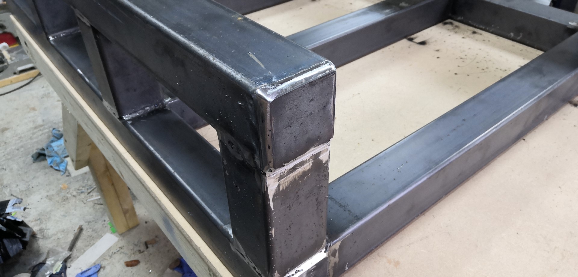

		3 Attachment(s) Re: Joe's 1000x600x200 steel and aluminium router started
		Made some more progress, capped box sections ends:
 Attachment 26796Attachment 26797
 I'm now waiting on the ballscrews to get here (next week) so that I can weld patches for attaching the support blocks and steppers.

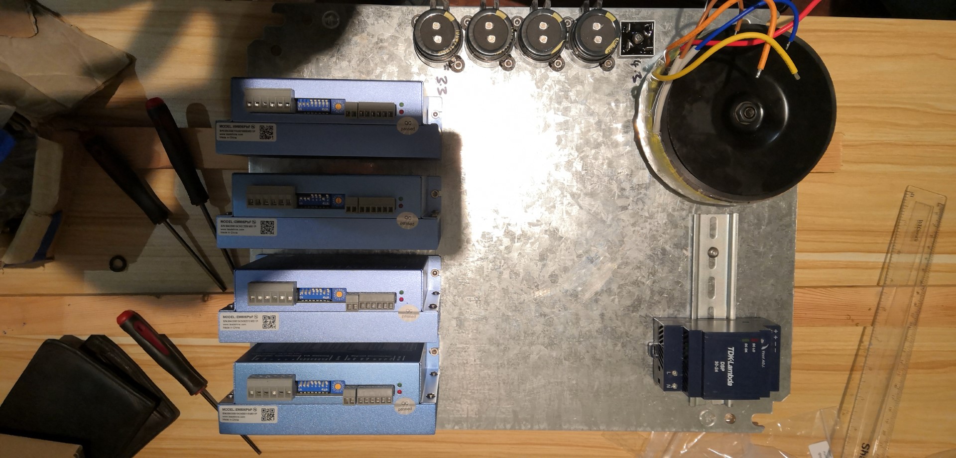

 I've chosen EM806 drivers. Yesterday I was about to order from AliExpress, thought I'd check Zapp first and Gary has a Black Friday deal on, managed to score 4xEM806 for £340 inc vat and delivery and rather unbelievably they turned up this morning 17hrs after ordering! What an amazing service and at the same or better price than China after duties without the wait.
 Steppers are ordered from OMC-stepperonline coming from UK warehouse, should be here in the next few days.
 Given the drivers arrived and I already had an enclosure to hand I've started to build up the electronics, PSU parts are from Rapid:
 Attachment 26798

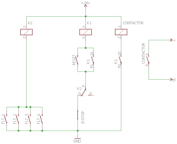

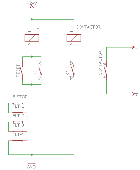

		Looking for some validation of my estop circuit as I didn't need to build one on my last machine, it was all integrated into the servo BOB.
 My proposed circuit is a normal start-stop relay circuit with the addition of the EM806 fault signals, is this how everyone else does it?
 Attachment 26811
 E-stop is NC
 Reset is NO momentary
 FLT 1-4 are the open collector FLT outputs from the 4xEM806.
 K1 is a DPST relay, first pole used for latching, second pole to switch contactor.
 K2 is a SPDT relay using the NC contact
 Functions as follows:
 With no driver fault signals K2 is off and conducting.
 E-stop is conducting and in series with K2.
 K1 is off.
 Reset is pressed momentarily, current flows through K1 coil, latching K1 on.
 Now if any driver fault signal switches on, K2 swiches on breaking the path through K1 coil, K1 switches off. If fault clears K1 remains off until reset is pressed.
 Similarly if E-stop is pressed this also breaks the path through K1 coil and the same happens.
 Any additional NO sources of fault can be paralleled with the FLT outputs. Any other NC sources of fault can be added in series with E-stop + K2.
 Thoughts?
		1 Attachment(s) Re: Joe's 1000x600x200 steel and aluminium router started
		I've just checked the EM806 datasheet and the fault outputs can be set to normally low impedence, i.e. normally closed. This makes things much simpler as they can just be placed in series with e-stop.
 Attachment 26812

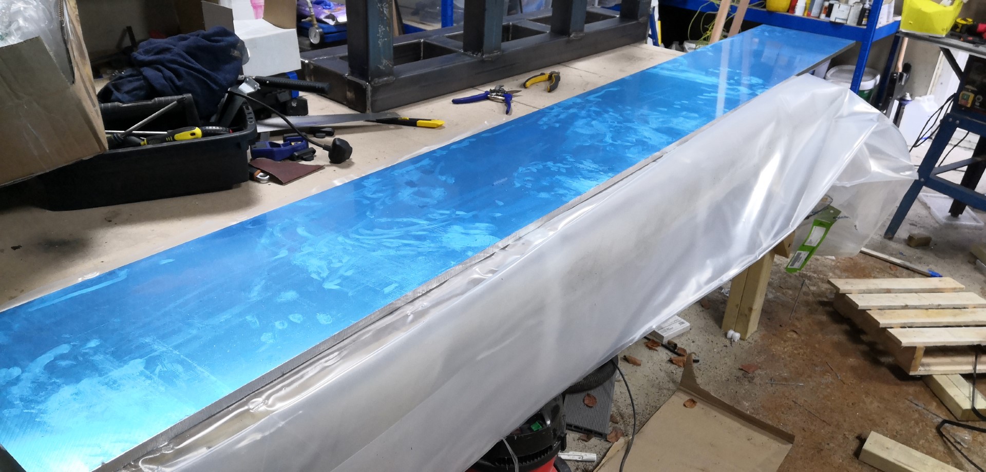

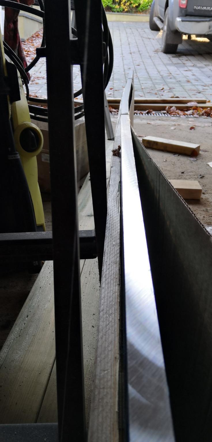

		My plate has finally arrived. The first piece had a bend in it:
 Attachment 26839
 I think it must have been hit by a forklift in the warehouse. Anyway called Smiths and they exchanged it the next day, the new piece is perfect.
 Attachment 26840

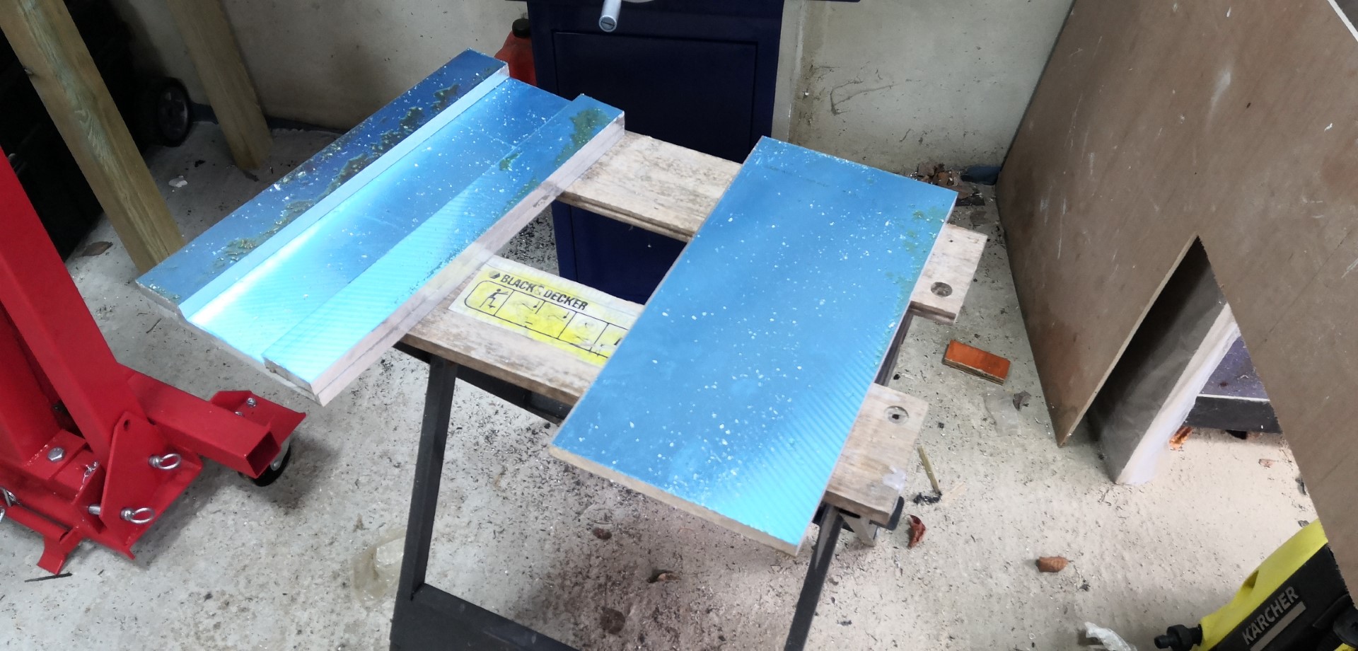

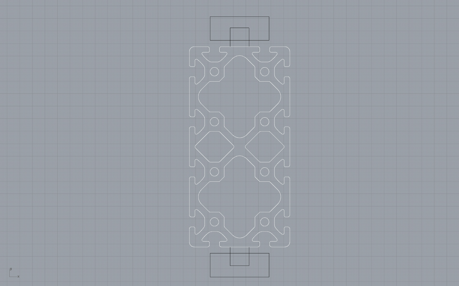

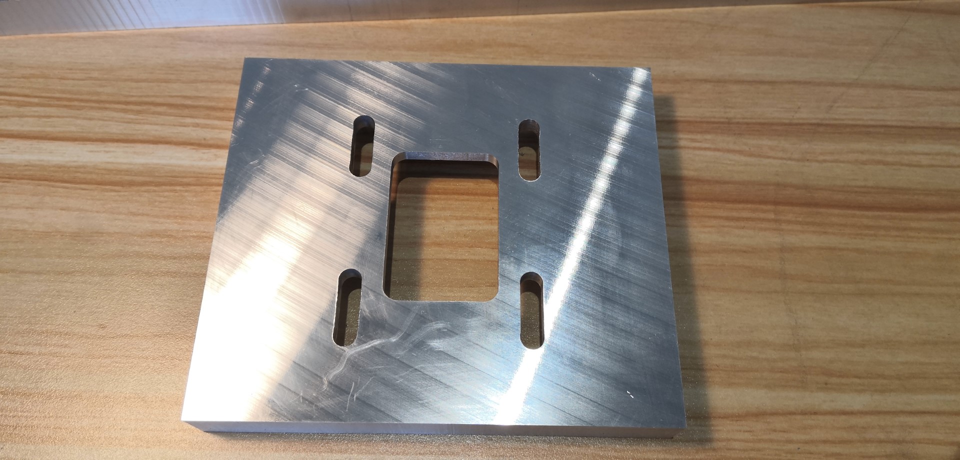

 I've roughed out some bits for the Z axis on the table saw.
 Attachment 26841
 I got a deal on this plate because it was originally an offcut piece, however I have way too much material for this machine. I certainly have enough plate to build the gantry entirely from plate and not bother with the extrusion, has anyone done this or know of any build threads (I have looked)?
 From plate I'm guessing I would form a channel 160x80 with the back open, question is would this be sufficiently twist proof?

 I'm trying to reuse a set of HGR15 rails left over from another project on the Y. These were originally purchased to replace rails on a much larger machine that had rusted badly, since then that machine has been written off.
 15mm rails are too narrow to go over an 8mm slot, this means they will need to be drilled and tapped into the centre flat section between two slots or another plate milled to bridge the slots and then mounted to that. If the latter then it isn't much more work to mill up a front plate as well.
 If I already had 20mm rails for Y then the profile would be a no brainer as the rails could be bolted straight into the slot.

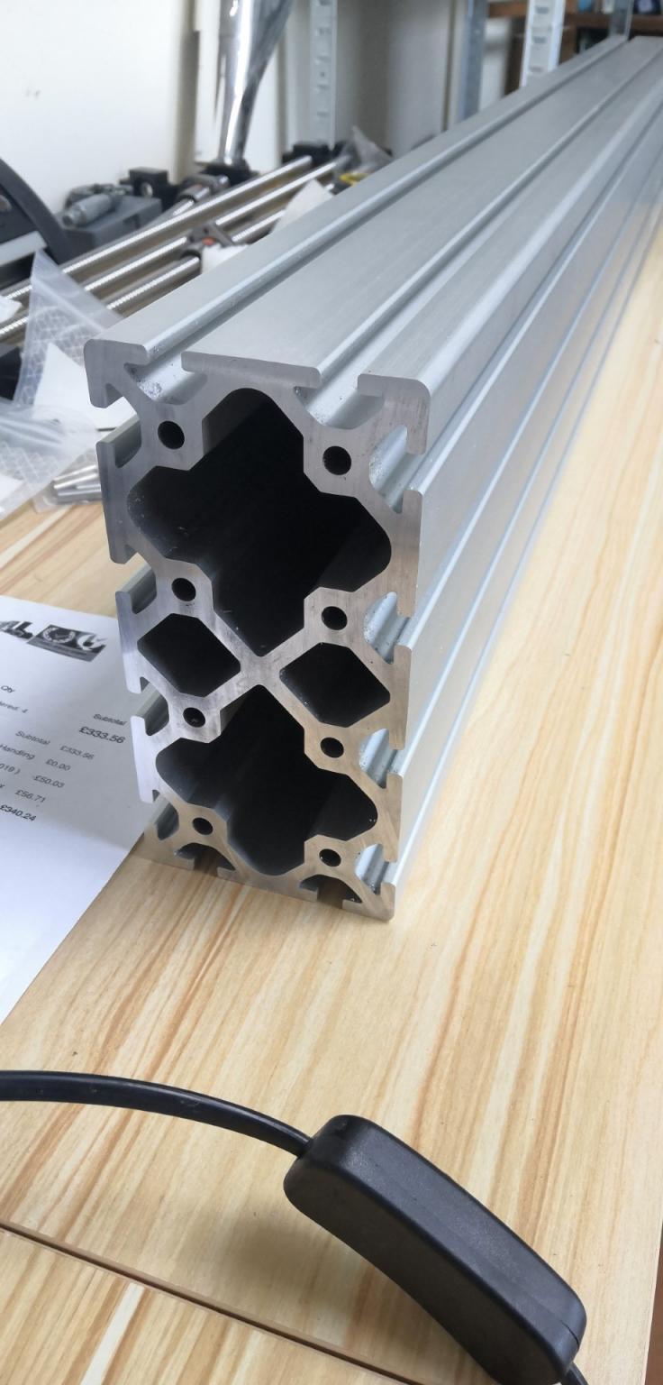

		Right I've made a decision!
 I called around a load of my usual aluminium guys, Smiths, Aalco, Blackburns, plus a couple of local metal shops. No one has any 6x3x3/8 box on the shelf (even Aalco who have a warehouse near me about 10 acres in size) and although they could get it I would need to buy a full length. To be fair I didn't try Simmal.
 I've built two previous machines using 6x2x1/4 box and they worked fine albeit I had to shim the rails, only very slightly as I didn't have a mill back then and I had to bolt blocks into the ends to bolt into (not required on the 3/8 box). Anyway I'm just going to go with the original plan from the first post in this thread, will order some 160x80 Item heavy clone from KJN tomorrow.
 I will first try to just mount rails directly to the central flat on the profile, if this turns out too wobbly I will plate over the slots and fix rails to plate.

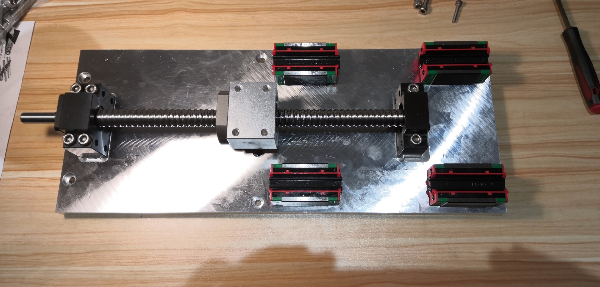

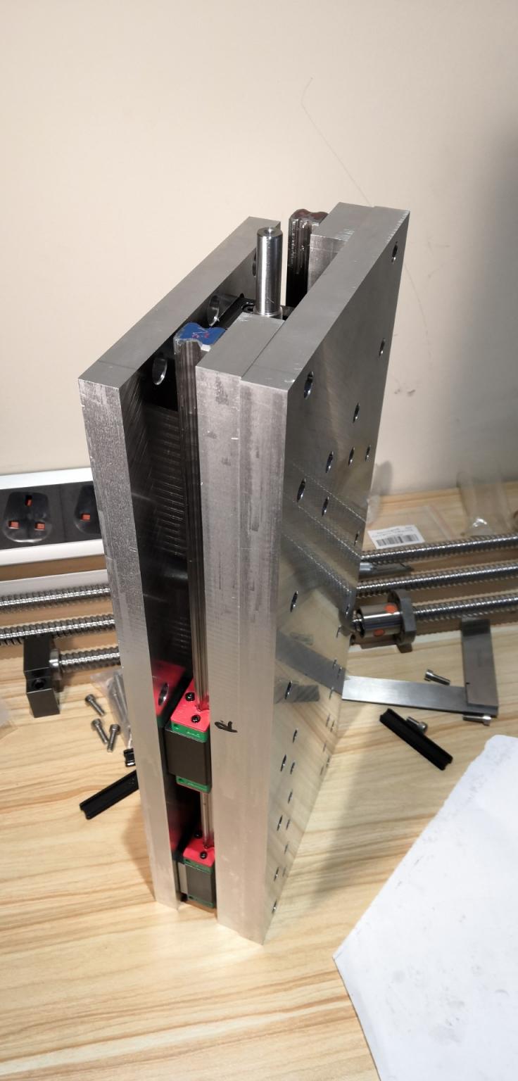

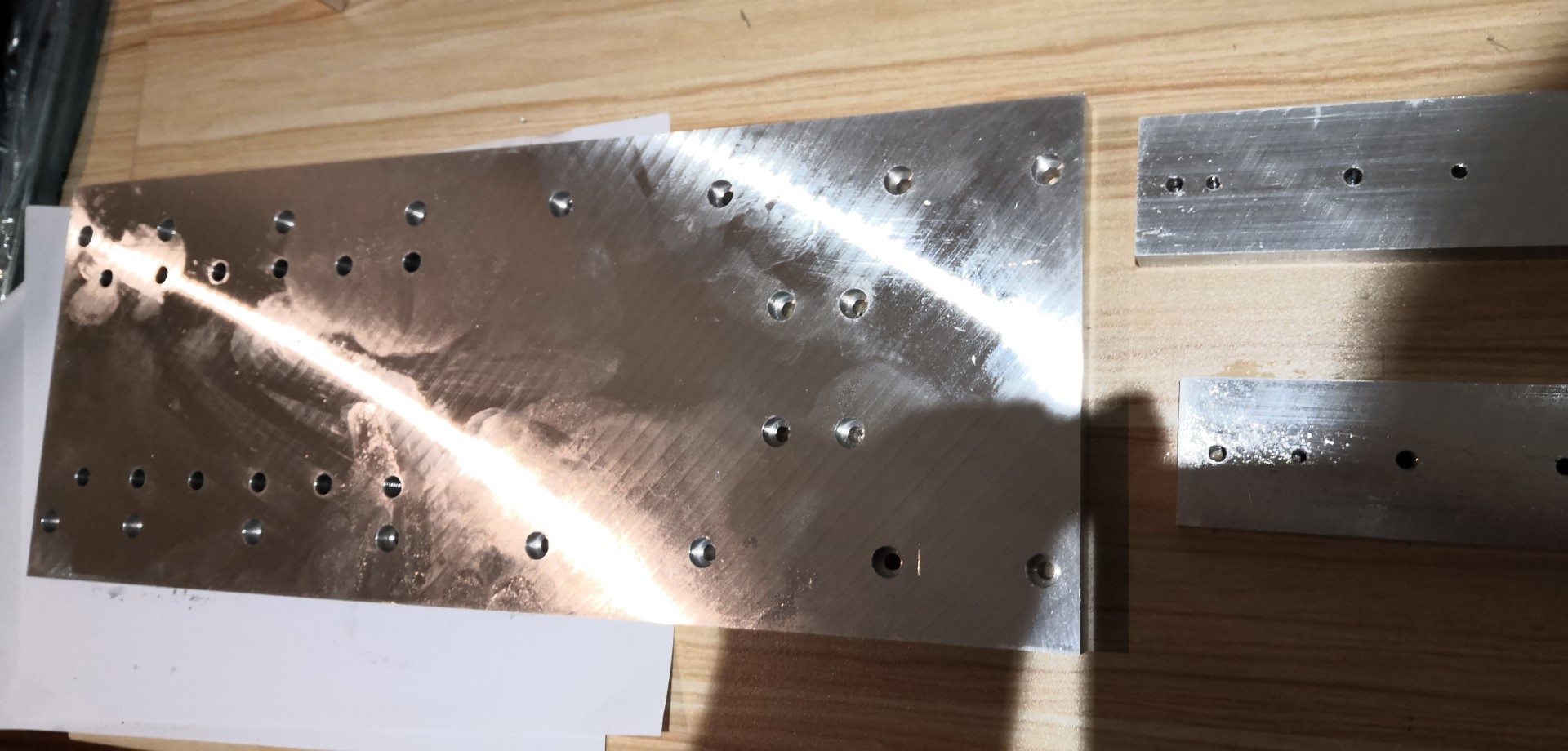

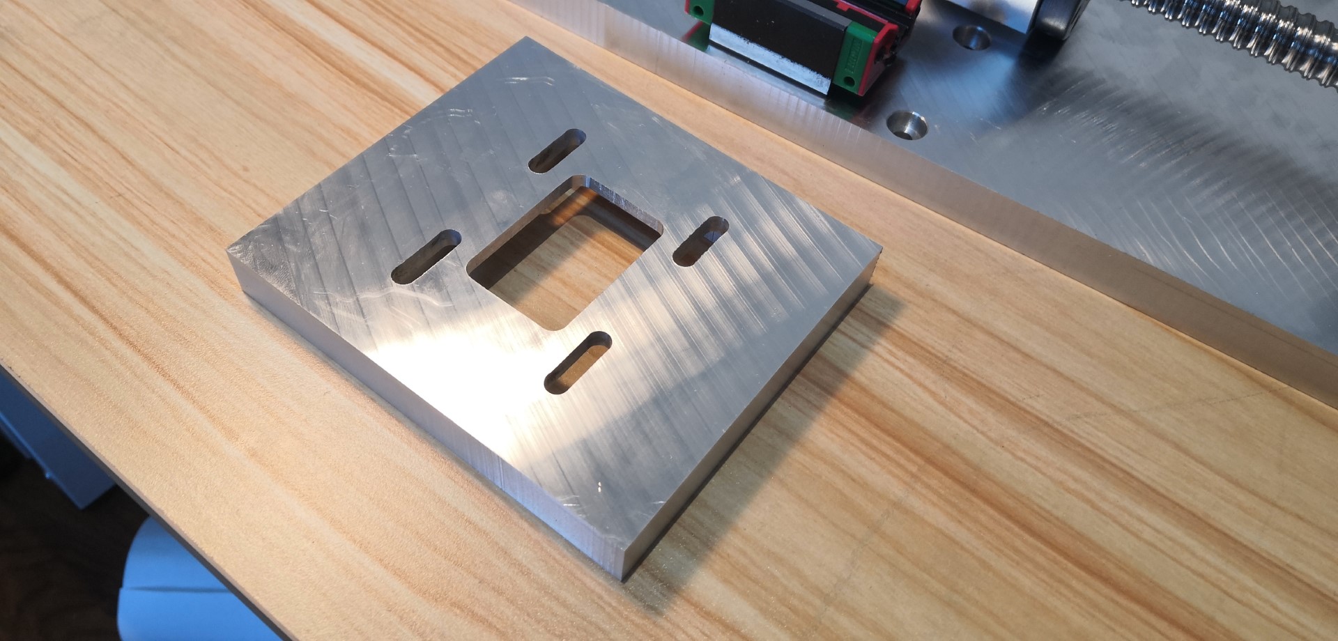

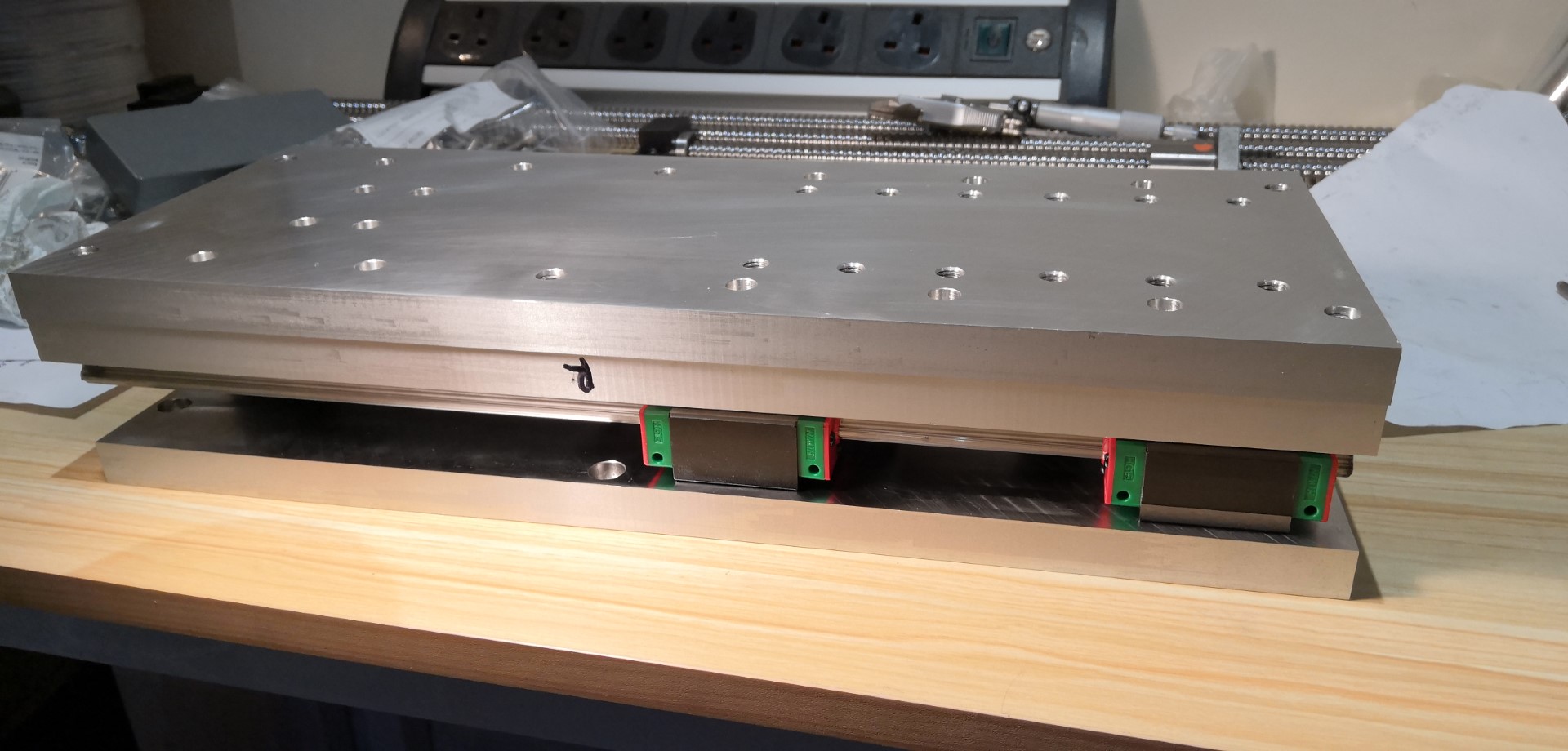

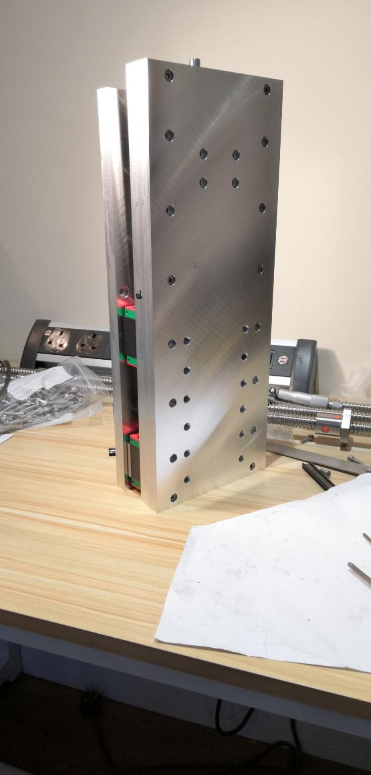

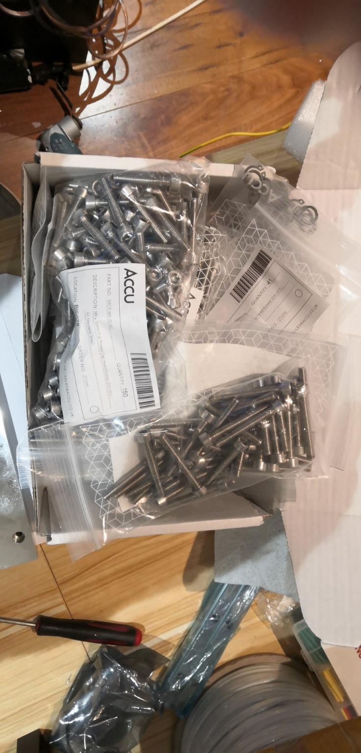

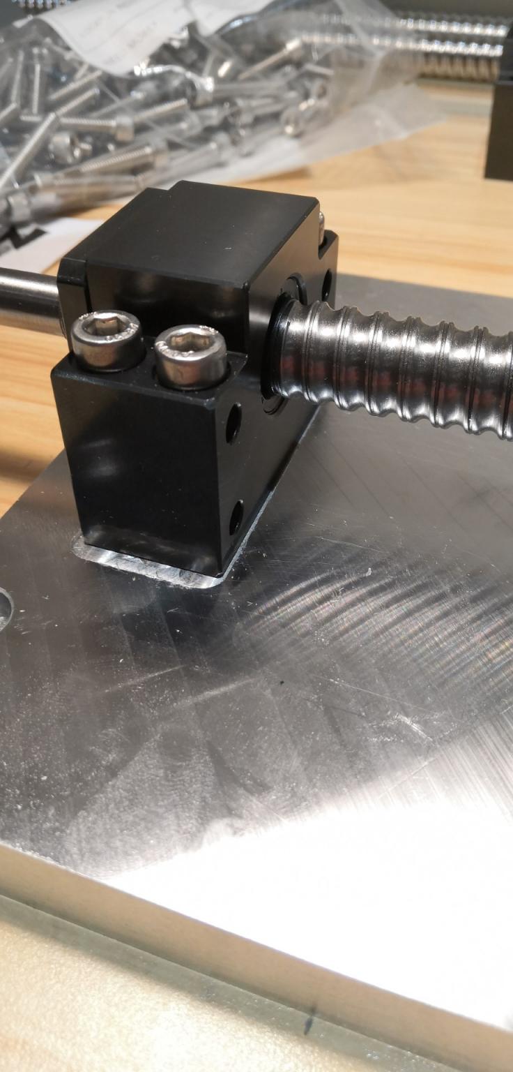

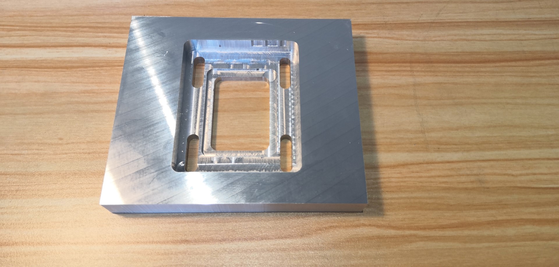

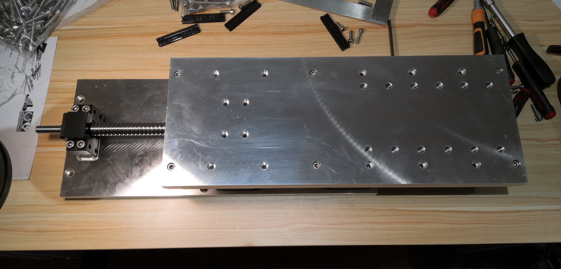

		9 Attachment(s) Z-axis parts
		I've started milling parts for the Z.

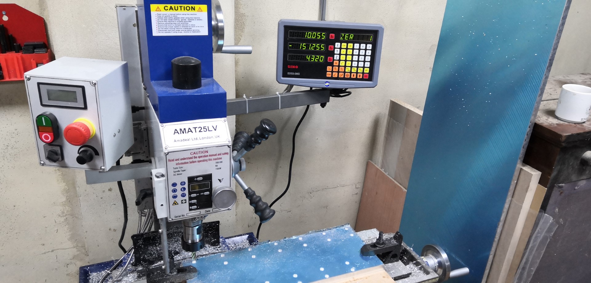

 Front plate and rail spacers finished, all fits well. These large plates take an age to mill out on my manual mill.
 Attachment 26856
 At least drilling the holes accurately is simple with the DRO.
 Attachment 26865
 Also took a delivery of bolts for the machine:

		6 Attachment(s) Re: Z-axis parts
		Finished the Z back plate so have now assembled the Z. Everything fits perfectly. All 4 long edges of the large front and back plates were milled in a single fixture so these will all be reference edges for aligning the rails and also tramming the Z on the gantry.
 Attachment 26870
 Pockets for the ballscrew mounts, these weren't perfect were supposed to be 1mm deep, infact 1.28mm so will need a thin shim between front plate and ball nut holder. TBH ballnut holder is not a precision item, rather it is a cast lump, so probably would have needed shimming anyway.
 Attachment 26871
 Attachment 26872 Attachment 26873 Attachment 26874 Attachment 26875
 I'm now waiting on the extrusion to arrive for the gantry as I need this to measure off for the Y bearing plates, gantry end plates, etc. Hopefully should be here early next week.

 Machined up the Z stepper plate this morning.
 Attachment 26878 Attachment 26879 Attachment 26880

		4 Attachment(s) Re: Joe's 1000x600x200 steel and aluminium router started
		Gantry extrusion has arrived from KJN, it is a real beast. KJN cutting appears very accurate.
 Attachment 26902 Attachment 26903
 So now I need to decide how to mount 15mm rail to the extrusion. I was considering 3 options:
 1. Mount rail directly to extrusion between the two slots, drilling and tapping.
 2. Mount rail on aluminium plate which is in turn bolted to the slots.
 3. Mount rail directly to slot.
 This shows that the profile is not flat across the width which I believe is by design so that the slots pull up to meet whatever you are clamping to them. The slot edges are 0.15mm lower than the centre, the centre and the 2 corners are perfectly aligned within the resolution I can measure with finest feeler gauge.
 Attachment 26905
 Now I have the extrusion (1) is a non-starter as there is a very slight peak in the centre and I would need to mill it flat which is hard given the gantry is longer than my mill table, although not impossible.
 (2) is what many people seem to do and so obviously works but is more work for me.
 Can I get away with (3), see picture below, what do you think?
 Attachment 26904
 I have a 50mm fly cutter, it would be possible given the extrusion is already flat and parallel to fly cut between the high points, would have to tram the mill carefully first.
		That's serious looking profile! What total length did you get for your £340.24?
 Kit
		I wasn't that expensive, think it was about £130 plus vat for 1100mm.
		Looking at your pic with the straight edge it looks to me that the slope on the inside of the slot is slightly less steep than the slope from the slot to the outer edge. This would  mean that your rail would be slightly canted if you go for fixing option 3).
		You have very keen eyes! Yes at the slot the extrusion is 0.15mm low both sides, since the outside flat is shorter than the centre flat it must be at a slightly steeper angle. I have measured and calculated the cant angle the 15mm profile would have as 0.055 degrees or 198 arcseconds, does this matter (it will be mirrored on the second rail).
 Or should I just man up and hit it with this:
 Attachment 26908
		That's not a lot of angle to be true, and when tightened up it might straighten it a bit more. On the other hand facing off the central flat and drilling holes would give a firmer fix I suspect as you're going into continuous metal, rather than a slot - and as Jazz pointed out with HGR15 there's not a lot of contact either side of an 8mm slot to give friction.
		2 Attachment(s) Re: Joe's 1000x600x200 steel and aluminium router started
		I temporarily bolted a length of rail to the slot, it seems to mount extremely firmly and doesn't move (maybe helped by the very slight V angle it is sitting in) but must be slightly canted as discussed above. Will decide whether to face mill it tomorrow, another option is just to mill a few mm each side of the slot so the rail can sit flat, this would also preserve the 3 planar points (both corners and centre) in case I mess up.
 I initially wanted to fix the rail to the centre however this does increase the moment between the Y bearing and the Z plate by 20mm which may counter the increased stiffness from the firmer rail mounting.Then again the centre of this extrusion will be stiffer than either slot as it i supported equally whereas the slots are supported on one side by the unsupported corner. No idea really.
		If I was living in a densely populated part of the UK I'd be asking if any fellow forum member had a nice flat machine that could mill a shallow slot just wide enough for the rails to fit along the full length of the centre of the profile. Possibly in exchange for HobNobs. That looks to be by far the most rigid place to put them.
		One of my earlier machines used a heavy gauge extrusion with 2 slots and I used the slot closest to the spindle rather than go into the centre.  I think it was slightly crowned across the width as well.
 I used a full length steel insert inside the slot (a long thin bar with the edges chamfered) to thread into rather than lots of small t- nuts and this helped pull it flat at least locally.
 There probably was an overall angle to the rail but I also had a similar rail on the underside surface which would slope the other way.  When these were connected to Y axis assembly it must have preloaded the bearings slightly trying to make them parallel to each other.  I didn’t notice any issues and the machine ran for years.  You can check on the Hiwin site what misalignment is allowed and compare to your angle.
