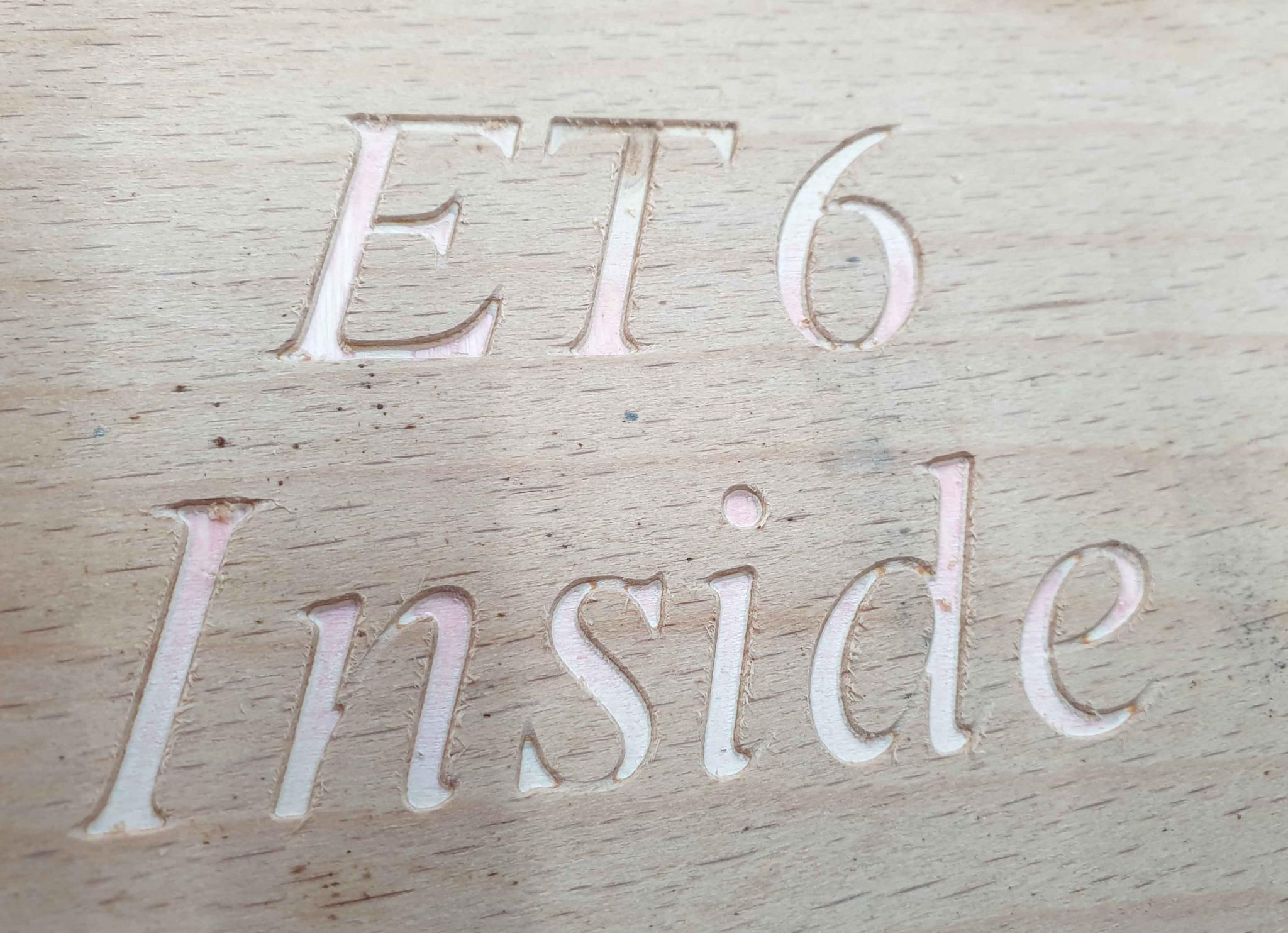

My ET6 arrived yesterday and I'm in the middle of doing a brain transplant on my control box. Wasn't easy removing the IP/M - who builds a DIN rail fitting box without access to the latch underneath? Anti-theft device? I had to remove the DIN rail to take the thing out. I have built a new mounting for the ET6 as it is a bare board rather than boxed item, but it looks as if the current wiring that went to the IP/M is going to fit the ET6 without major work. Shall report back when it's all working.
Now, there's confidence...

But if you want another laugh - I bolted the ET6 in place, connected power and ethernet connections only so I could start on the config process. Plug into extension lead, turn on front panel switch. Nothing, Ah, internal MCB is off. Flick lever. Bang, flash, MCB tripped. Shout from wife in sitting room - "the power's gone off!". Interestingly, took out the 10A MCB in the cabinet, 32A MCB in the consumer unit, plus 100A RCD covering all house rings. 13A fuses in extension lead and cabinet mains lead still OK. Sums up my approach to fuses - they really are the last resort when all else has failed!
Cause was one of those little thing that could happen to anyone. After isolating cable between MCB and mains switch (which is after MCB), the cable was still shorted to earth. I had had to remove the nuts securing the mounting panel in the cabinet and on replacing one last night, I managed to catch the mains cable under it. The nut has a built-in shakeproof washer which comprehensively mashed the insulation.
Still, the board is now talking to my Win10 laptop first time, and I'm starting "ports and pins" configuration via the MyCNC user interface..

No idea what your problem is. All I can say is that I plugged it into the ethernet port, configured the laptop with a 192.168.0.address, and away it went. Can't say that I did anything clever that I can boast about! It's an ET6 rather than 7, of course, so might be slightly different firmware on the board? I think that I saw something about having to plug into a computer port rather than hub, presumably to avoid having to use a cross-over cable, but even if you are using a hub or switch, most of those are auto-switching these days anyway.
I have the limit switches configured and working, at least as far as the diagnostic LEDs going on and off as required. However, I've lost the printed copy of my IP/M manual where I noted down all the wire colours, connections, etc, which makes things slightly more difficult. Also trying to find out why the e-stop system isn't working. I have e-stop switches and fault outputs from the EM806 all in series with the safety relay so the relay trips in an emergency including driver fault. Can't get it to latch on now, so I suspect a wire has been dislodged somewhere but lost in the cable guide. However, the whole e-stop/relay stuff is independent of the controller - just switches a connection to the board's e-stop input - so the problem shouldn't be anything to do with the ET6.
Struggled a bit with motor configuration. There is a reference in the manual for the basic motor setup that says that speeds are units/sec (not units/min, like Mach3) but it's not defined for the "motor tuning" page. I've just set very conservative values as I would rather the motors creep than overspeed and trip the drivers.There is also a min, max, and "mid" speed to define - but I can't find an explanation of the "mid" speed. But I can't test any of that until I have the e-stop/safety relay working. E-stop handling in this software looks a bit more complicated than IP/M and Mach3 so that's going to need a bit of decoding as well.
I'll do a bit more reading tonight and have another go, fresh, in the morning. Wish me luck! I expect this will all be clear in time - I had similar issues first time round with the IP/M and Mach3.

Fixed my broken wire and the ET6 can now see the touchplate. I've also tracked down a sample macro showing touchplate use (it was under "surface mapping" which is why I had problems finding it) and I think I can use it as a basis for my touchplate macros. The router has movable and fixed touchplates and I use a set of three macros for simple touch-off, touch-off with secondary reference to fixed touchplate, and tool height setting from fixed touchplate. However, once you can figure out how to use probing/touch-off techniques for a particular machine, record fixed touchplate position, etc, actually putting the macros together is relatively easy.
I also mentioned problems with identifying output connections. There's a bit of inconsistency here, although there might be good reasons for it. Sometimes you go to a defined page to set particular input pins. For example, this is how limit switches are defined. Sometimes you define a sensor input pin when creating a macro, as for the homing macros. But for the motor output, the pin number is defined in a separate "pins.h" file (which will be familiar to any programmers out there) which is then "included" in various bits of PLC code. As I say, I can see why there might be reasons to do things this way but it makes it all a bit tricky for a newcomer to the system. (Edit - the contents of this file can be edited within the myCNC environment under "Hardware PLC templates" - again, the name didn't really help find it but it is all there).
At that point, I couldn't think of any more good reasons not to cut something, so I downloaded the myCNC postprocessor for Vectric (there's one for Fusion 360 plus a couple of other CAM packages that I don't use) and created a quick bit of Vcarve engraving. I just used a bit of scrap ply that was lying around but here's evidence that it's working! Well, I could be faking it but trust me, I'm a doctor!
Attachment 28203
Image is slightly distorted but that's just camera angle.
Might take a little rest now before starting out on the tool height macros.
