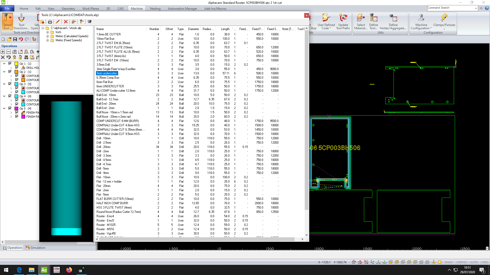

Next on the agenda is what to use to send a 'job'...
It came with an old Alphacam booklet and very old Alphacam cd
Would anyone know if Mach3 or 4 would communicate to this through the rs232?
Or any other suggestions... Use newer design/cam software then run the file through the old Alphacam software maybe?

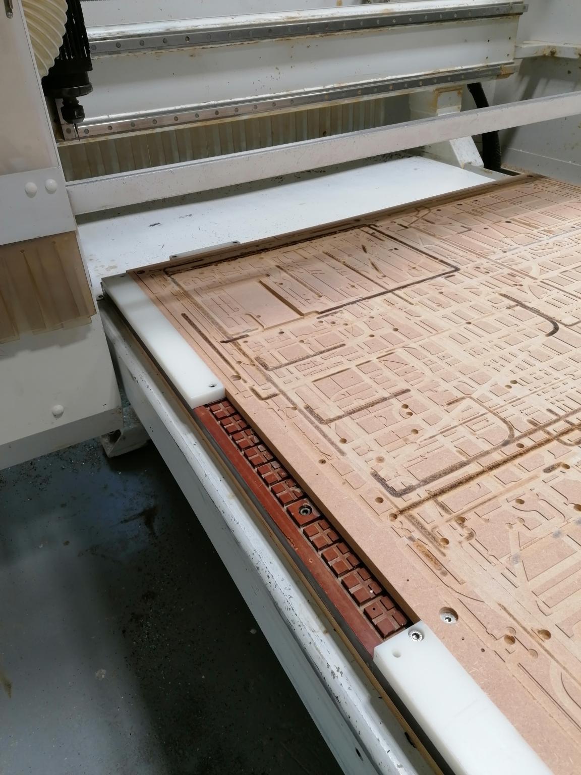

This could be a simple mistake within Alphacam.
I always make a rectangle first point x0 y0 second point 2438.4 (you can put the basic math in this box and alpha cam will input the data like so: 96*25.4) y:48*25.4.
I actually have a 96"x48" MDF scratch board on the bed hence the sizes.
Now setting up this box will always dictate to me my working area for the bed, I have a couple of times not set this right and the machine has a hissy fit.
Now on to the more awkward bit. Checking to see if the micro switches for the machines boundaries haven't slipped and are clean.
I hope this kind of helps. Without being there its hard for me to guide you. Be really honest with you ive only been using this machine a year.
As for the Omicron 3000 controller manual, erm what's that haha Ive only got electrical schematics for the switching underside of the bed. To be really honest there is very little I use on the actual controller. Other than the usual start-up, and setting tool height Z Axis 0 and clearing the previous job I don't touch anything else within the menu system. Certainly a lot easier than my old Thermwood 5 Axis.

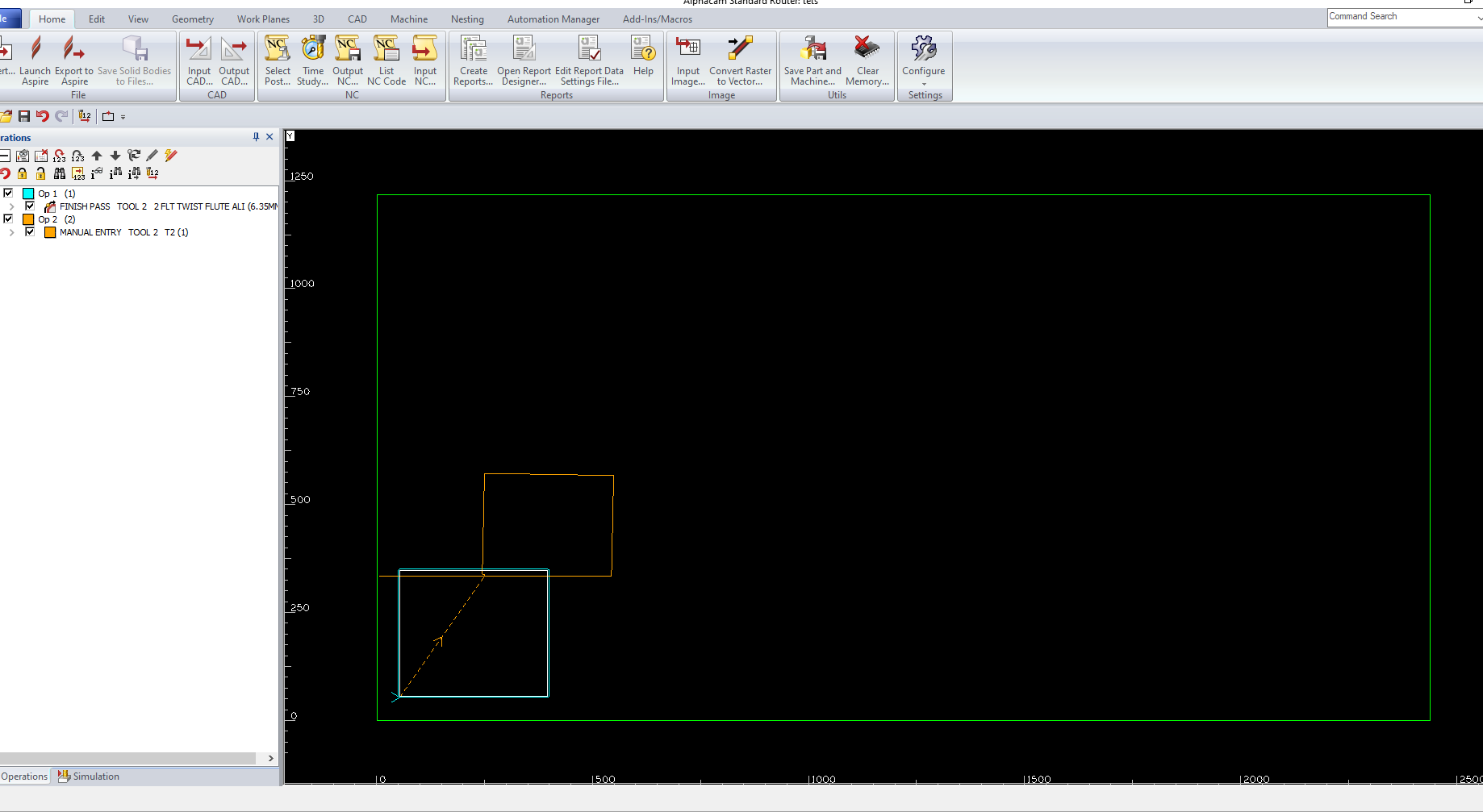

First I just want to say sorry for the state of the pictures. Just quicker for me to take a picture of my old notes as I'm currently at work :thumbdown:
Second I want to state that my usable working area on the bed is offset by x55 y25 which you will see in the first picture (ignore the scratch bed I'm about to change it :emmersed:)

As you see in this one you will notice my notes regarding the offset I have setup. I assume you woul just insert zero in both of these.
Then its just a matter of sending the program and hitting start :thumsup:

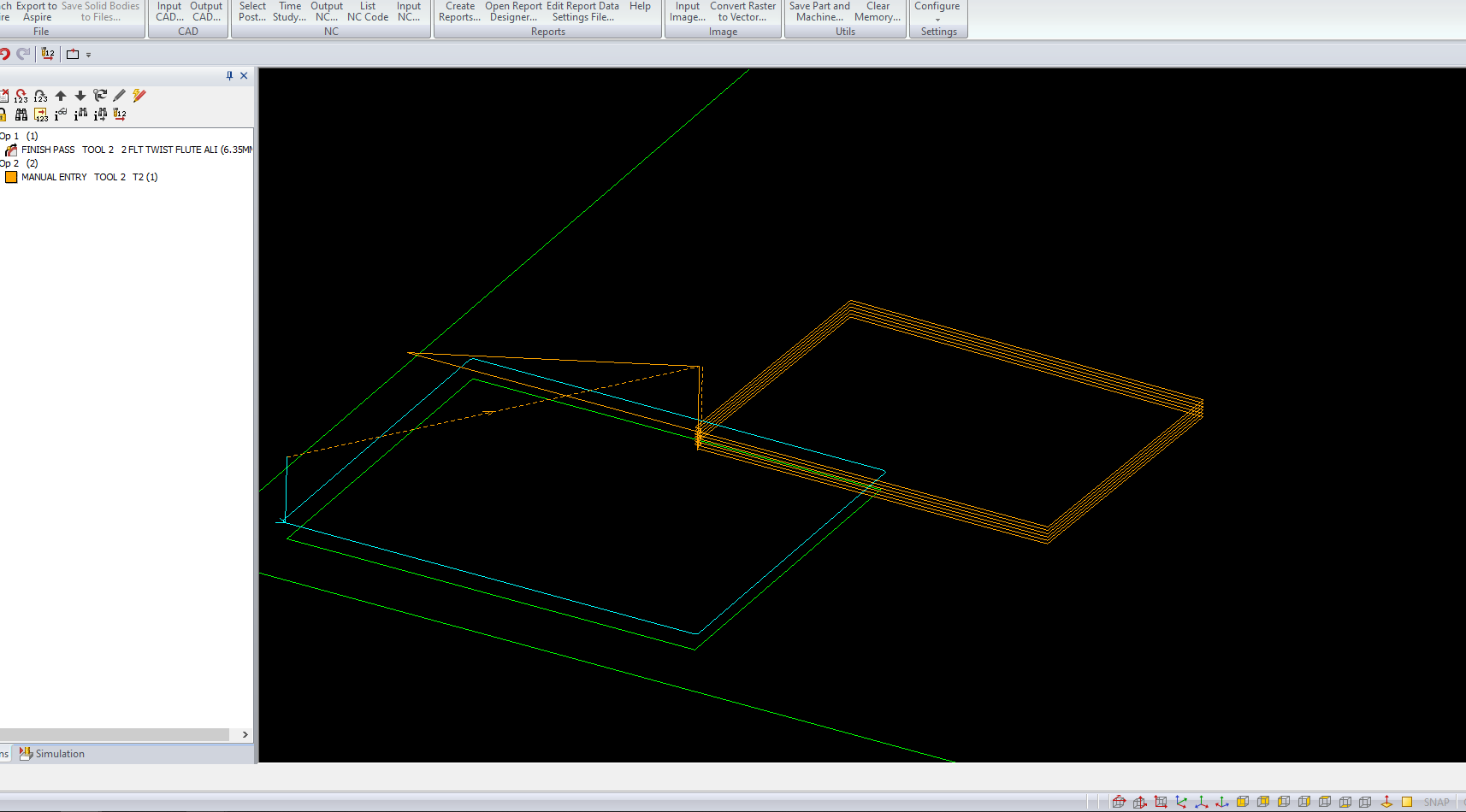

Ok at machine. Everything cleaned and checked.
I've gone through your notes and tried several times I'm still getting an axis exceeded fault each time.
This is what happens from power on...
Screen shows: Datum to home
I press Datum, machine tells me it's datuming the xyz axes.
Once finished I press Alt and screen shows X=0.005, Y=0.005, Z=149.976
Screen shows:Select Key
I follow your instructions on tool head setting etc.
Start job and whichever job I select instantly screen throws up:
Limit exceeded in 'x or y or z' position
I'm going to set up the same drawing in Alphacam and save it 3 times with different names, all other variables the same... to see what happens [emoji106]

My findings are this:
Job1: starts and stops after 1 second.
Job2: limit exceeded in X 5016.500
Job3: limit exceeded in X 5016.500
All 3 jobs were based on material size of x1200, y600 z-15
And a square cut x200,y200 to x400,y400 depth -5mm
I'm bamboozledhttps://uploads.tapatalk-cdn.com/202...ed4a23d418.jpghttps://uploads.tapatalk-cdn.com/202...3e02c1dba6.jpg
Sent from my Mi A1 using Tapatalk
Re: Rye Quantum First Start... Drive Fault
I can see keys for Datum and Set Home.Obviously there is a distance in three axes from machine Home to Part Datum.Have you drawn the test shape at a point in space within Alphacam that would be outside the machine's limits?Maybe posting the Gcode would be illuminating.

2 Attachment(s)
Attachment 28645
Ive imported your code into my test file and you can see what your code was trying to do at least.
Attachment 28646
Side view of your orange tool line.
