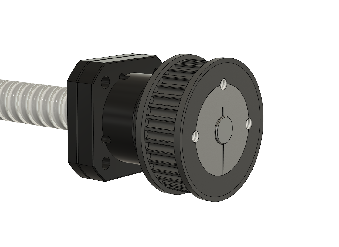

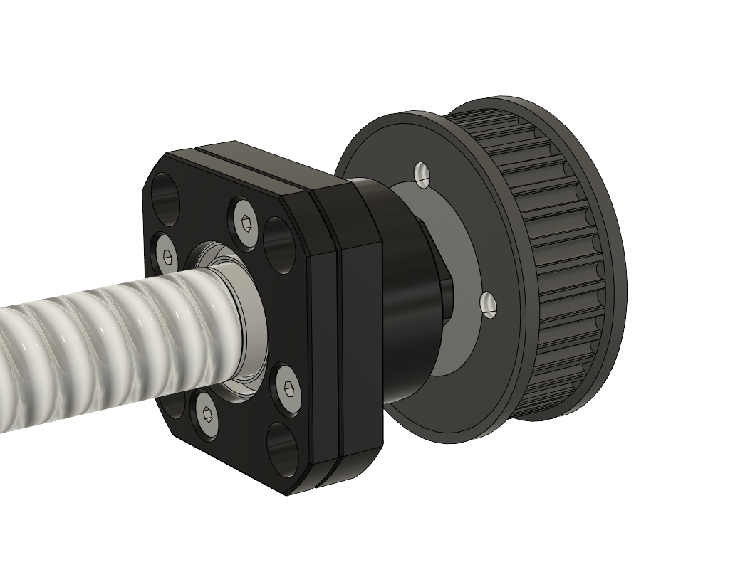

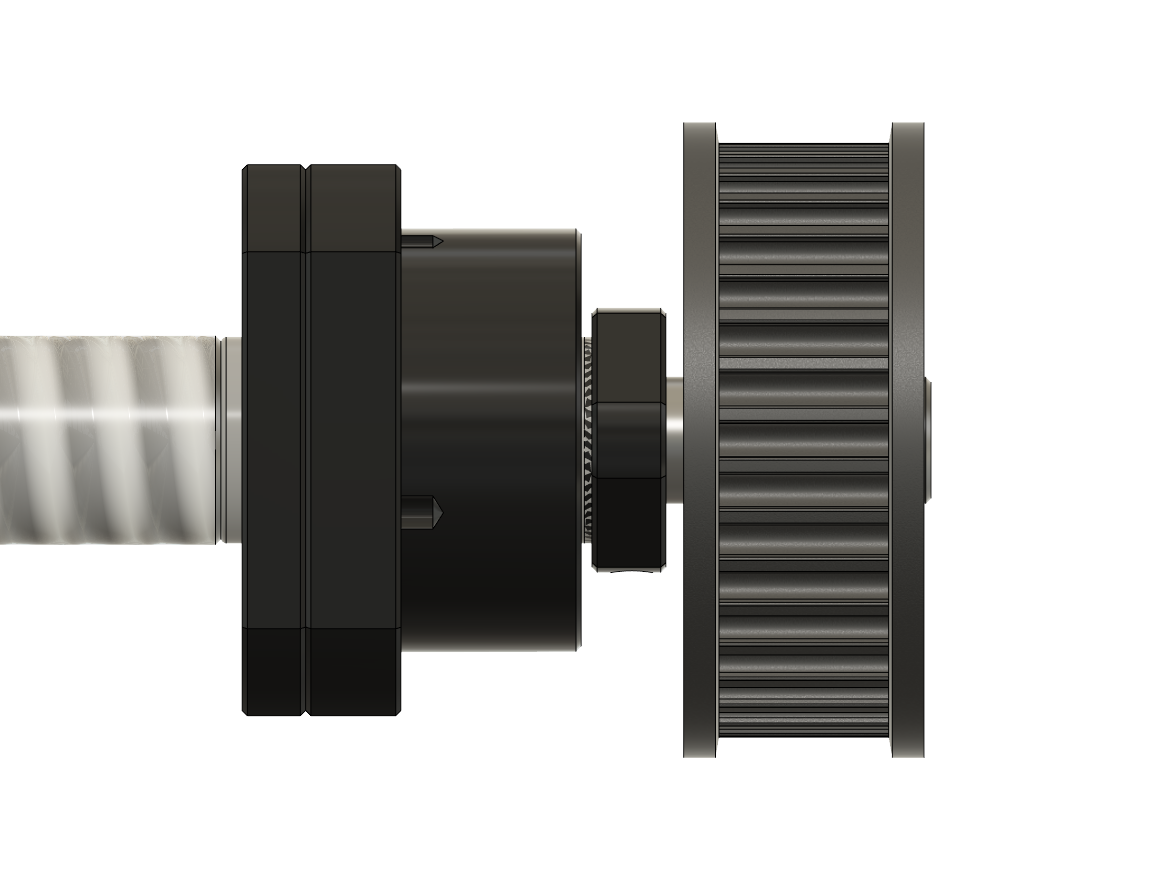

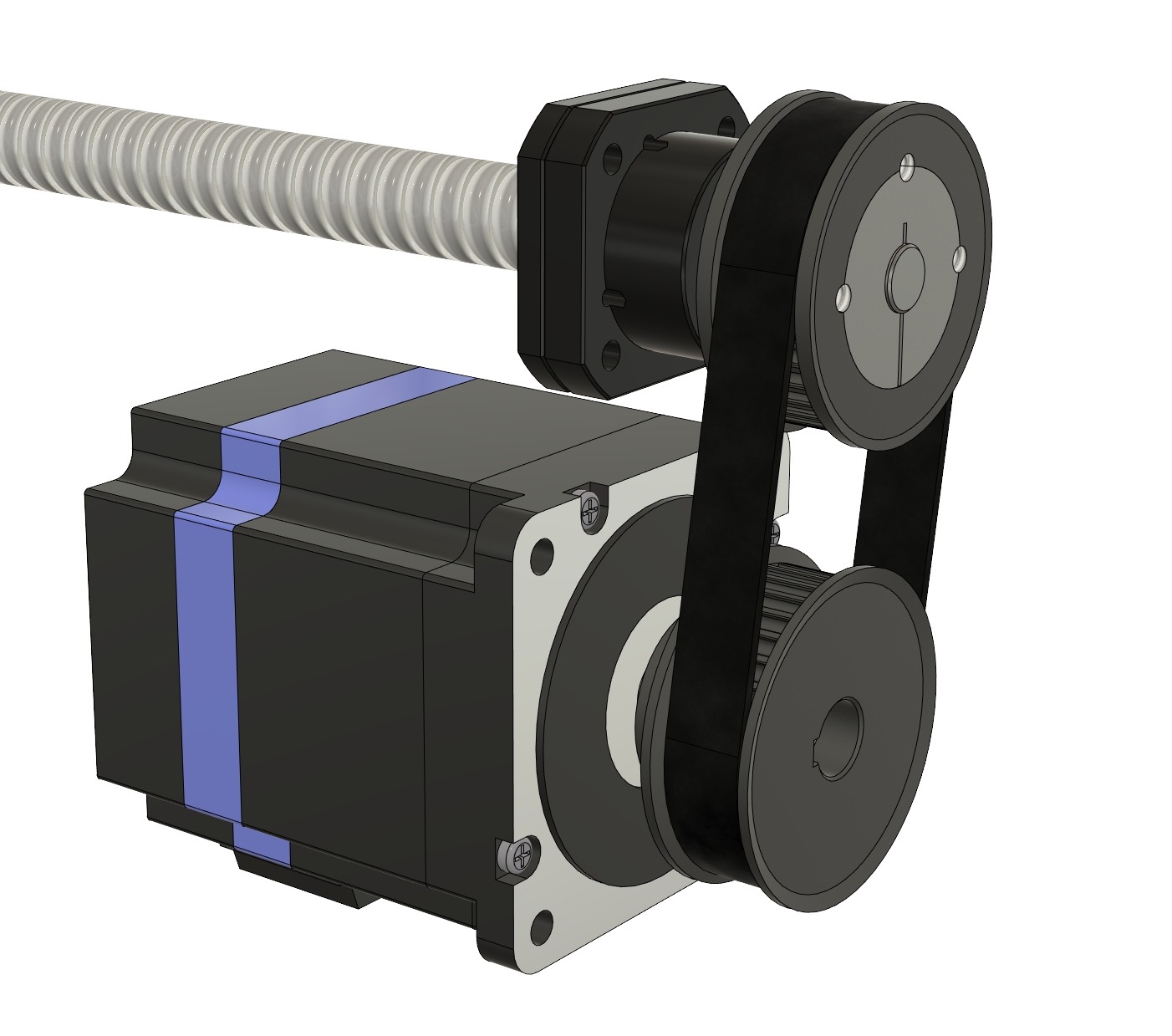

Are taper lock pulleys a good choice for ball screws?
I'm currently trying to figure out what the best way to install a HTD 5m pulley onto a 2010 ball screw is.
It will be driven by a 4.5Nm stepper motor through a closed loop timing belt.
This is what I have in mind:
Attachment 29859
One option would be to have the fixed end of the ball screw machined, either flat (into a d shaft), or into a keyway. This would accept standard AF/BF style pulleys with grub screws. However, I imagine that the loads of a Nema 34 motor are too high for a d shaft setup, and I'm not sure if keyway machining is a reasonable request.
During my research I've also come across taper lock pulleys. At first glance, they seem to be exactly what I need and don't require special ball screw end machining.
From what I've read, their disadvantage is that taper pulleys are large (start at 32 teeth) and heavy (steel).
My design can easily accommodate for the size, and I can't really imagine the weight of the pulley being an issue.
Attachment 29860Attachment 29861Attachment 29862
Unfortunately, I cannot find much information on people using them with ball screws.
Do you think that in my use case, taper lock pulleys are a good choice?

I've used taperlock pulleys wherever possible, as they are much more secure and concentric than keys and grub screws and are often seen on professional machines. As you say, the main disadvantage is the size. All 3 of my machines have them where space permits and my Shizuoka came with them from the factory. I've used keys and grubs where space is tight (lathe cross slide and Bridgeport Z axis) and those don't feel as secure in my mind.
Re: Are taper lock pulleys a good choice for ball screws?
That's a relief, taper lock pulleys it is then.
Thank you!
JeffZ
Thank you!
Wait there's a big difference between a router and a milling machine so it's not that simple.!
The milling machine is often rotating the ball-screw much slower with a lower pitch ball-screw. A router is using a high pitch and spinning the screw upto twice the speed and often much longer length (heavier) screws so the inertia becomes more of an issue. Also, servo's or steppers change the outcome. I've got a feeling muzzer is using servo's which have much higher torque than steppers.!
The weight of the pulley and the effect of inertia DOES affect the machine negatively in some circumstances ie: 3D where you are accelerating and de-accelerating quickly with lots of direction changes. Rapid positioning like when drilling lots of holes over a large area where you need to accelerate hard and then slow down between holes.!
All these kinds of operations are affected by the diameter and length of the screw which play a big part in the effect inertia has on the system, so any extra weight you add will only affect this negatively. If you plan to operate at high feed rates or do lots of 2.5/3D work then think carefully about any extra weight you add.
If the screws are long and the gantry heavy then 4.5Nm isn't a massive amount of torque if rotating the screws at higher RPM's.!

Thank you, definitely appreciate all the information.
This is for a diy router milling machine. I'm still in the initial design phase, so I have not ordered any parts yet.
Right now I'm planning for Nema 34 size motors, but that 4.5Nm figure (or motor type) is not final.
I'll figure this out once the dimensions of the machine are locked in.
I got curious and checked the mass of a 36T htd 5m taper lock pulley, and they are listed at 450g.
Definitely more than I was expecting.
I'll be sure to post my design and ask for critique and comments before ordering any parts.

Personally I wouldn't consider the additional moment of inertia of a taperlock pulley to be a massive concern if you have a long 20 or 25mm ballscrew but if you have steppers, I guess you may struggle with speed and response as it is. Without a high drive (power supply) voltage, the torque output of steppers quickly tails off, so the headline torque figure may be misleading. If you are still deciding what to use on the motor front, this may be a good time to consider something better and Jazz has good experience you can learn from on that front.

Surprisingly it does Muzzer.! . . Esp with a stepper system on long screws and smaller steppers feel it the more and really struggle with it if the pulleys are heavy. This is why when building machines with long screw lengths and steppers, (over 4ft) I select a higher pitch screw and use a ratio to lower screw speed, this serves 2 purposes, lowers the chance of screw whip and lowers the inertia.
I also only fit Nema 34 motors which use high voltage drives, often these are at mains voltage depending on motor size 8nm + but for the smaller 34's I still wouldn't use drives less than 80Vac/100Vdc. The 4.5Nm and 5.5Nm Nema 24 Closed loop Lichuan motors I use now are so powerful running on 60Vac that I rarely fit Nema 34's below 8nm as the difference they allow in performance is much better.
