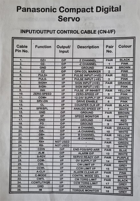

Attachment 31023

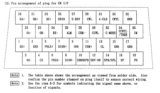

I am thinking that this may be the case (below), but would like confiirmation either way please.
Attachment 31024

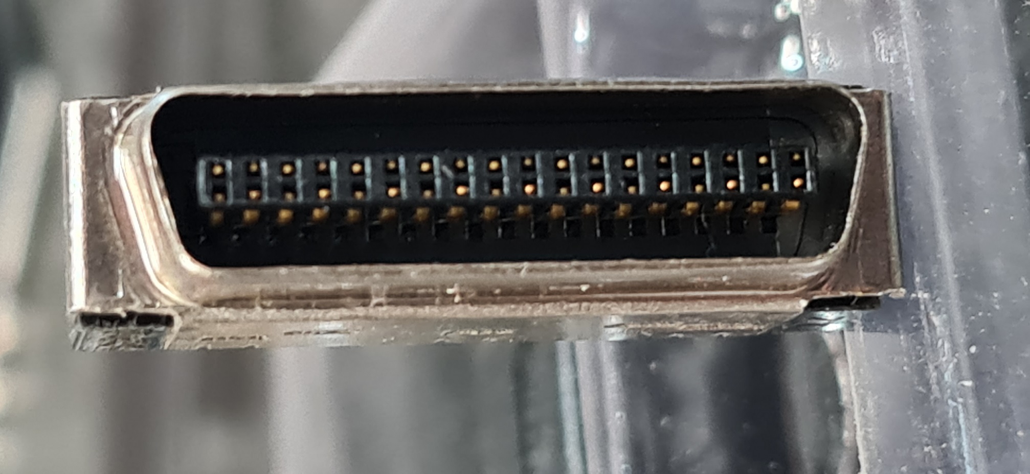

The manual also has a diagram... that I think might be a optional cable connection for the unit????? The image with the trapeziode seems to denote a connector but doesn't seem to follow any known configuration?????
Attachment 31025

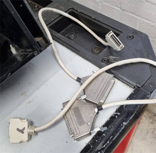

I have the original "pre-made" cables, but I feel these may be a special cable for the AHHA/Artisan boards??? (again guessing). They are labelled "Simplatroll M2-544854" but I cannot find any information on these.
Attachment 31026

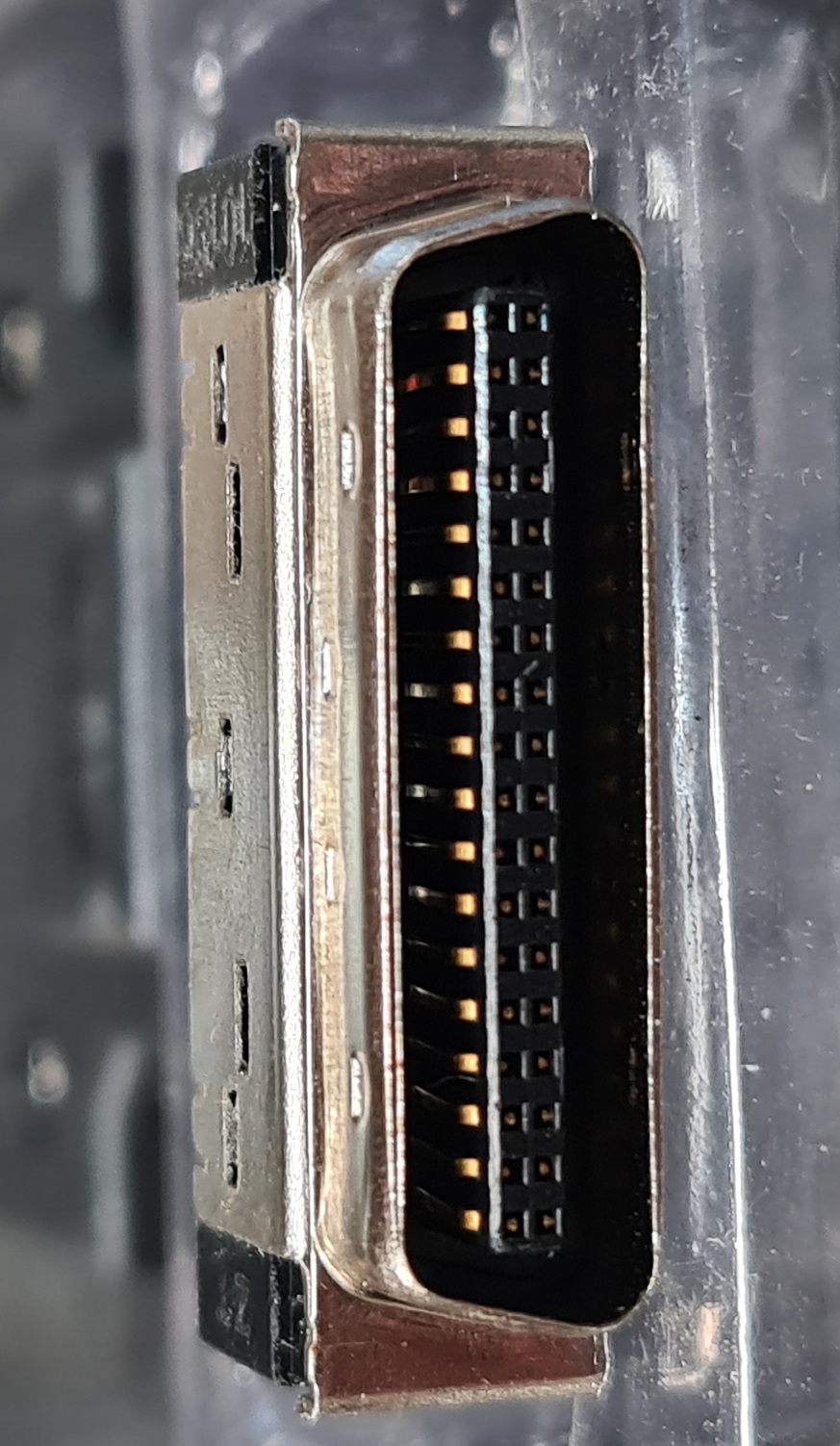

The unit in question is the Panasonic MSD043xx series servo. Not worried about the breakout board side. https://industrial.panasonic.com/con...s_manual_e.pdf
The first image in my above post shows the pin outs for the panasonic unit (from the paperwork included with the miller). But the manual does not state which pin on the physical drive connector is pin 1.
Picture 2 is what I "guess" are the pin numbers on the connection actually on the unit and the corresponding connector that connects to that.
The last picture is of the the cables that came with it, but I think they are proprietry to the Artisan boards. So of no help to me. But I can cut the serial connectors off and still use the cable.

Ok, I found the manual and it looks to me like the diagram below is what you need, I know it says for external equipment but I just think that means when being controlled externally rather than using the built-in control functions and using as stand alone drive.
Now I'm not too familiar with SCSI plugs but did a quick google on the SCSI and most show a 4-row pin arrangement. However, as it says in the manual you need to confirm the pin location on the connector matches.
This is not an unusual arrangement on servos connectors, I recently retro fit an Hurco with Honda 44 pin Scsi connectors on Yaskawa servo drives and they used 4 rows that were similar in layout to those.
All this said I wouldn't connect up to the servo until you have verified the pin layout because it will be very easy to blow an input if you get it wrong.

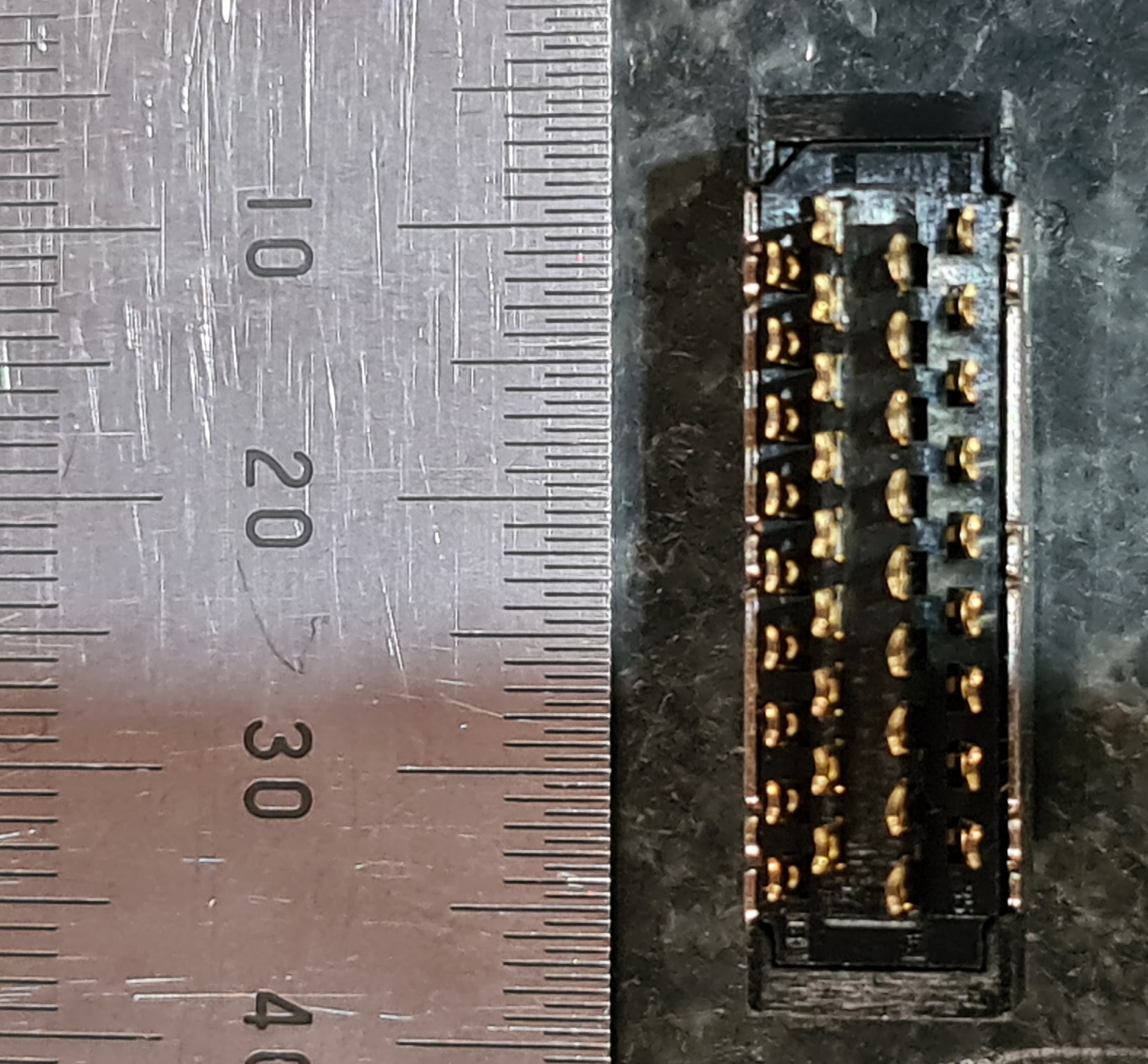

4 Attachment(s)
Re: Panasonic MSD043Axxx Servo Driver pin outs????
Nemo1966
Picture no 2 in the very first post :thumsup:
"Hi, I have three Panasonic MSD043xx servos on a Triac" - then picture two is labelled "MSD043xx" in large red writing.
I know the drive model, I referring to showing us the rear of the cable connector you have because you say the 3rd diagram doesn't match, so what do you have.? plus those pictures were a bit shit so can't see the connector on the drive very well.
Just because the front of the connector shows two rows of pins doesn't mean the rear of the connector has 2 rows, in fact, many have 4 rows just like the diagram shows. See the pic of one of our Lichuan servo drive connectors to get the idea.
Attachment 31034 Attachment 31035 Attachment 31036 Attachment 31037

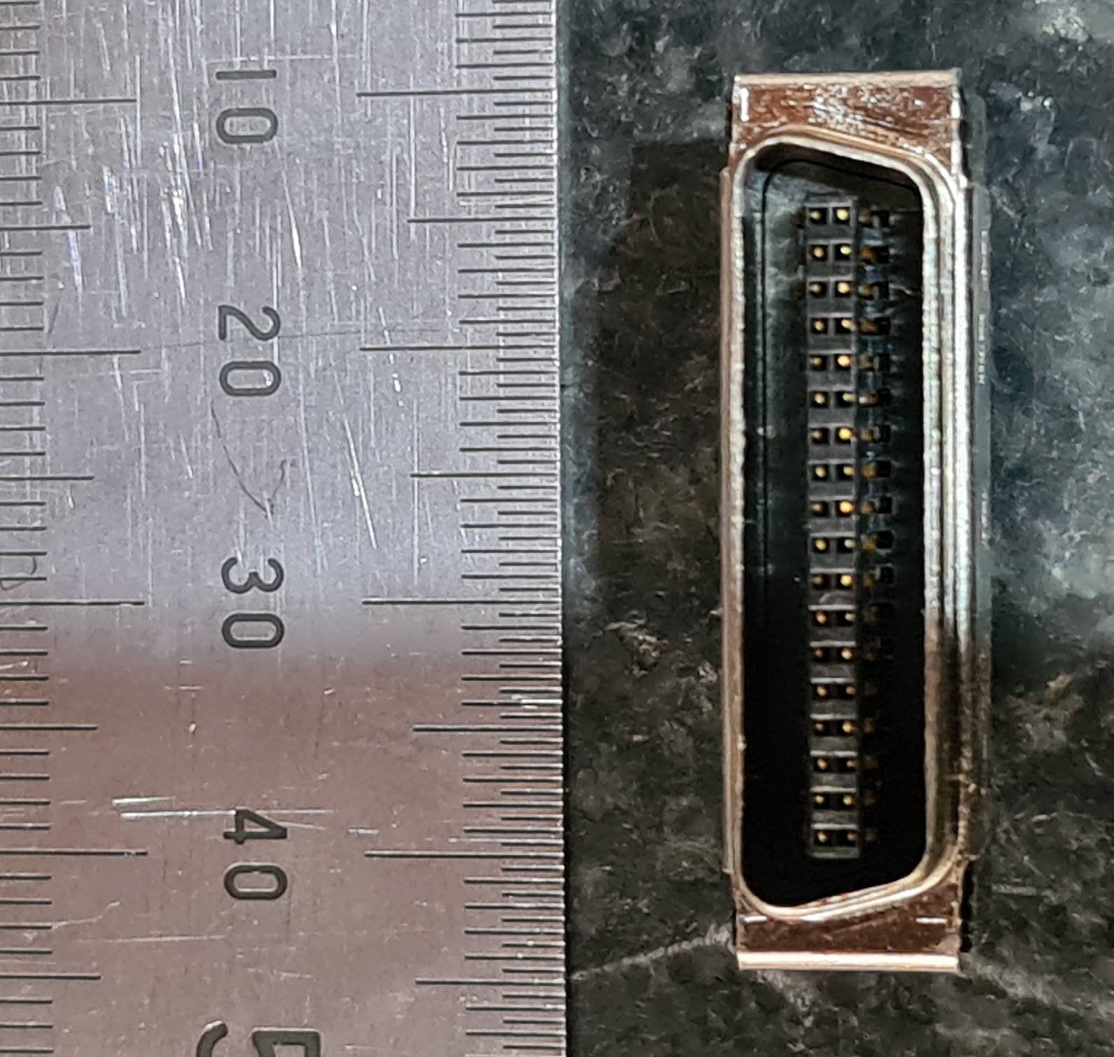

I see what you are saying.. but if you look at the first diagram I posted there are only 36 connections on the Input/Output control cable CN-I/F.
I've counted inside the connecter and there and theres 36 connections (18 each side - not 19 and 17 as shown in my numbering...sorry). Then on the other end (connection to the AHHA board) is a 36 pin serial connector. Would they really use a 72 pin connector when they only used 36 of them?
Also the pin out picture you posted (from the manual) uses 4 rows of 9 pins (making 36 pins). Which is also just strange.... if there was more pins would they really only use the top half?
The whole thing would be so simple if they just had Pin 1, Pin18, pin 19 and 36 marked on the device. I posted hoping someone had fitted these type of drives before and would instantly know. It looks like one of situations where if you "know" you know, but if you don't... you don't and there no way to actually work it out.

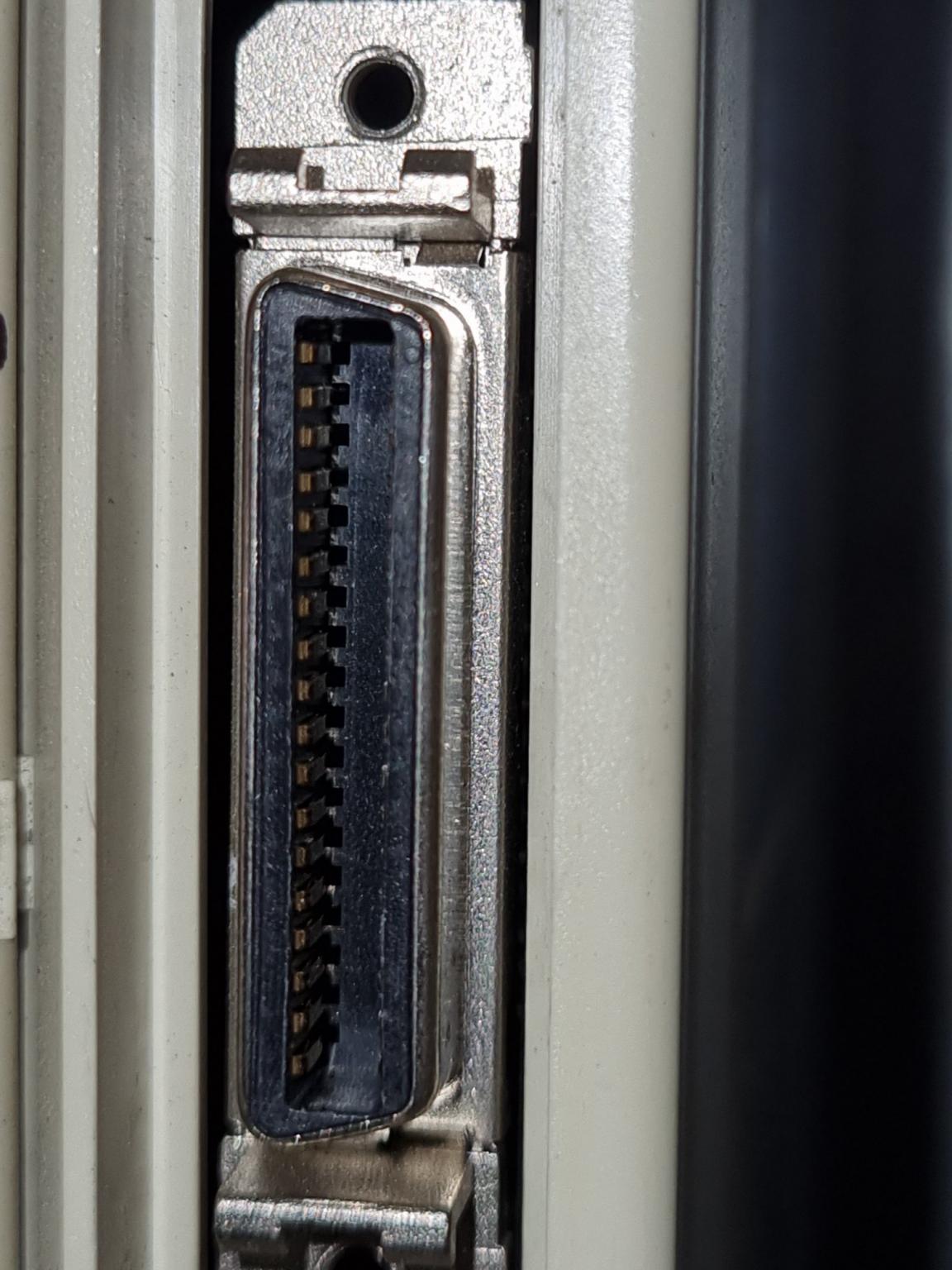

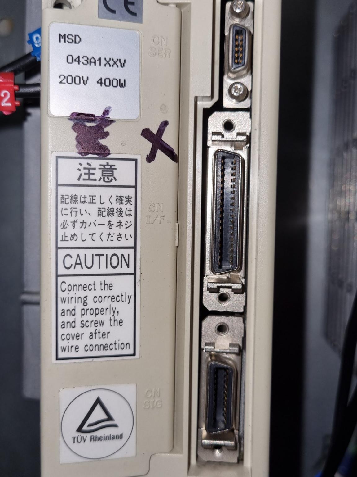

Take a detailed photo of the front of the drive itself showing the connection.
I did find part number:
10136-3000VE. Connector.
10336-52A0-008. Shell.
Conn part no, search, came up at RS components.
Shown as discontinued product there.
https://uk.rs-online.com/web/p/scsi-connectors/1761986
Numbers were taken from manual for MSD series that came up when searching your drive number. Config looked the same 4 rows.
Technically, there should be a part number for connector/shell in your manual either above or below the pin config image.
Also part numbers for different encoder cable options depending on motor driven.
Double/triple check any cables after soldering, with a meter.

The rows in the manual don't make sense as explained previously in my last reply to JAZZCNC.
Also found this https://www.ebay.com/itm/30385701666...gAAOSwAxtgCptv
The fact that this guy in the USA is selling generic cable for Yaskawa, Mitsubishi, Panasonic servos would also suggust to me a standard pin numbering for the port.
Attachment 31039
Attachment 31040

Yes but look at the rear and there are 4 rows of pins although it shows a 26pin, not 36 they are just the same with more pins, and the diagram in the manual is shown as if you are viewing from the rear, not the front which is where I think you are possible getting confused.?
Do you have the cable connector.?
Nemo1966

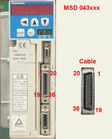

Ok, now I can see the connector properly I can tell you that it's exactly the same connector as the pics I posted.
So in your original post, the 2nd pic is correct if viewed from the front. BUT the manual diagram is also correct when viewed from the rear of the connector as you would normally wire the connector.
JAZZCNC
As in the 'plug-in to the drive' side is configured as long rows......
The solder tabs on the back 'cable side' are configured as the diagram.
Just make sure you solder the numbers in the correct order.
JAZZCNC
Ah yes I now see what you are saying, I have a cable already I wanted to know the pin numbering from the FRONT of the cable connector. I didn't realise that they looked different from the back.
The cables I have are the 4th pic in my original post. So I wanted to cut off the NON-Servo connector (36 pin serial) and trace back the signal with a multimeter and re-use them.
Looking from the back (like you say) then it does match what I thought on the servo 1 - 18 down the left side and 19 to 38 down the right side. Which will match the from of the FRONT of the servo.
