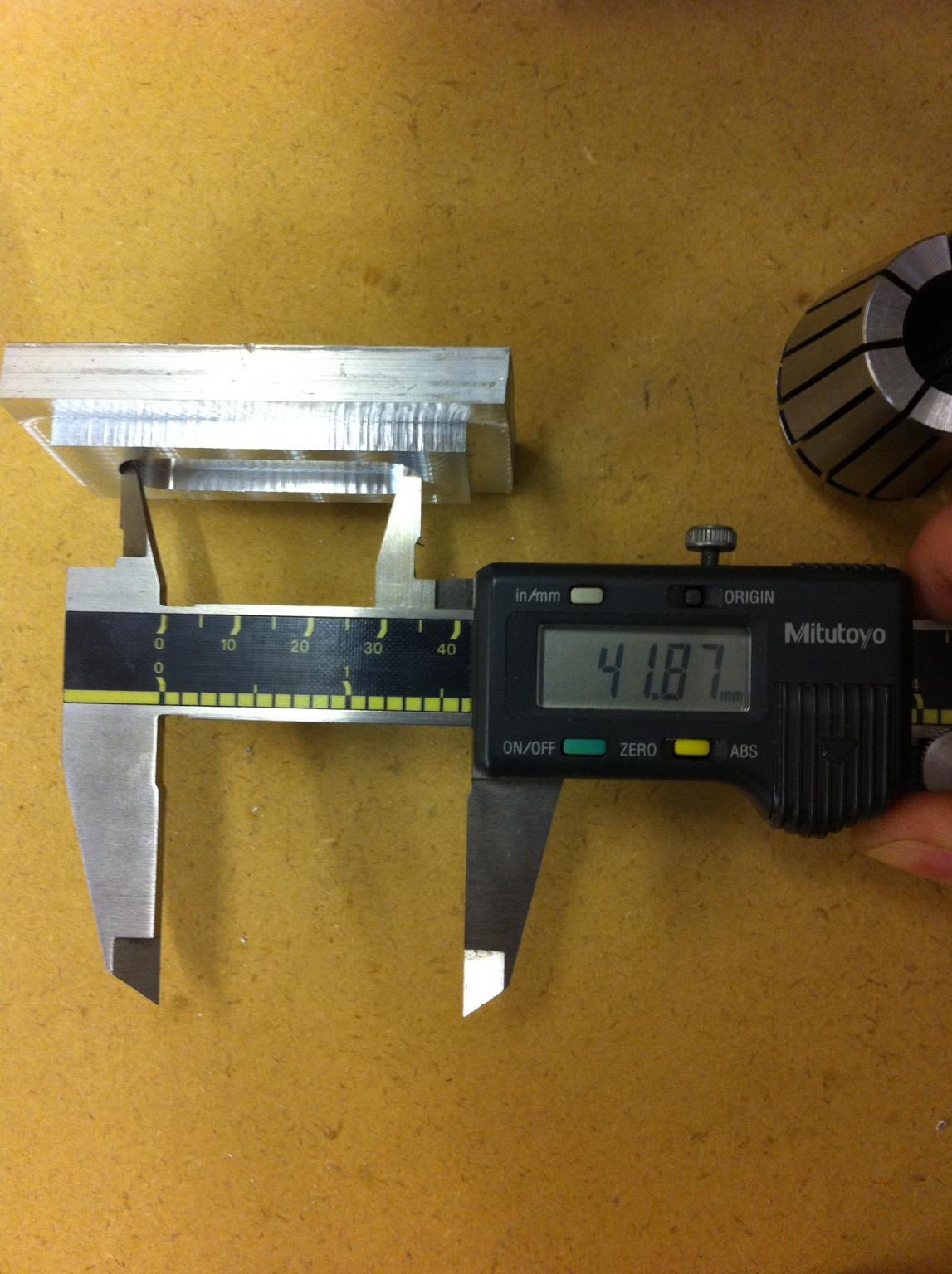

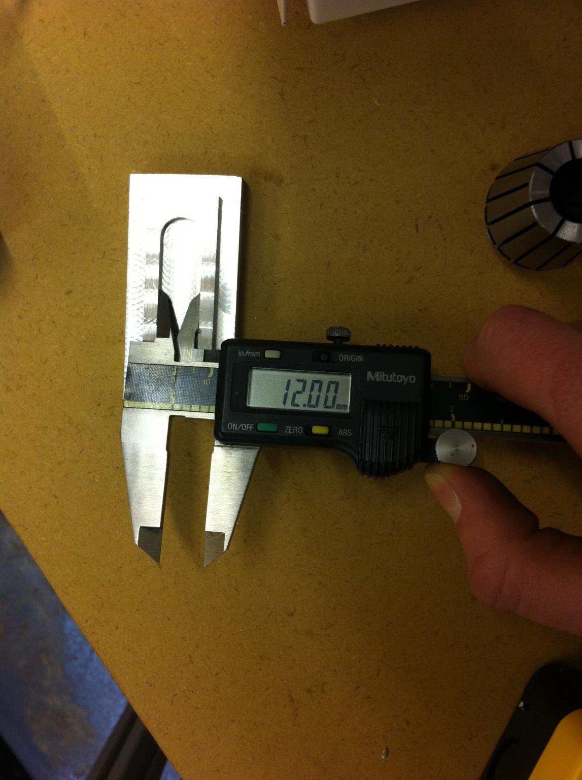

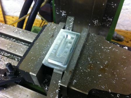

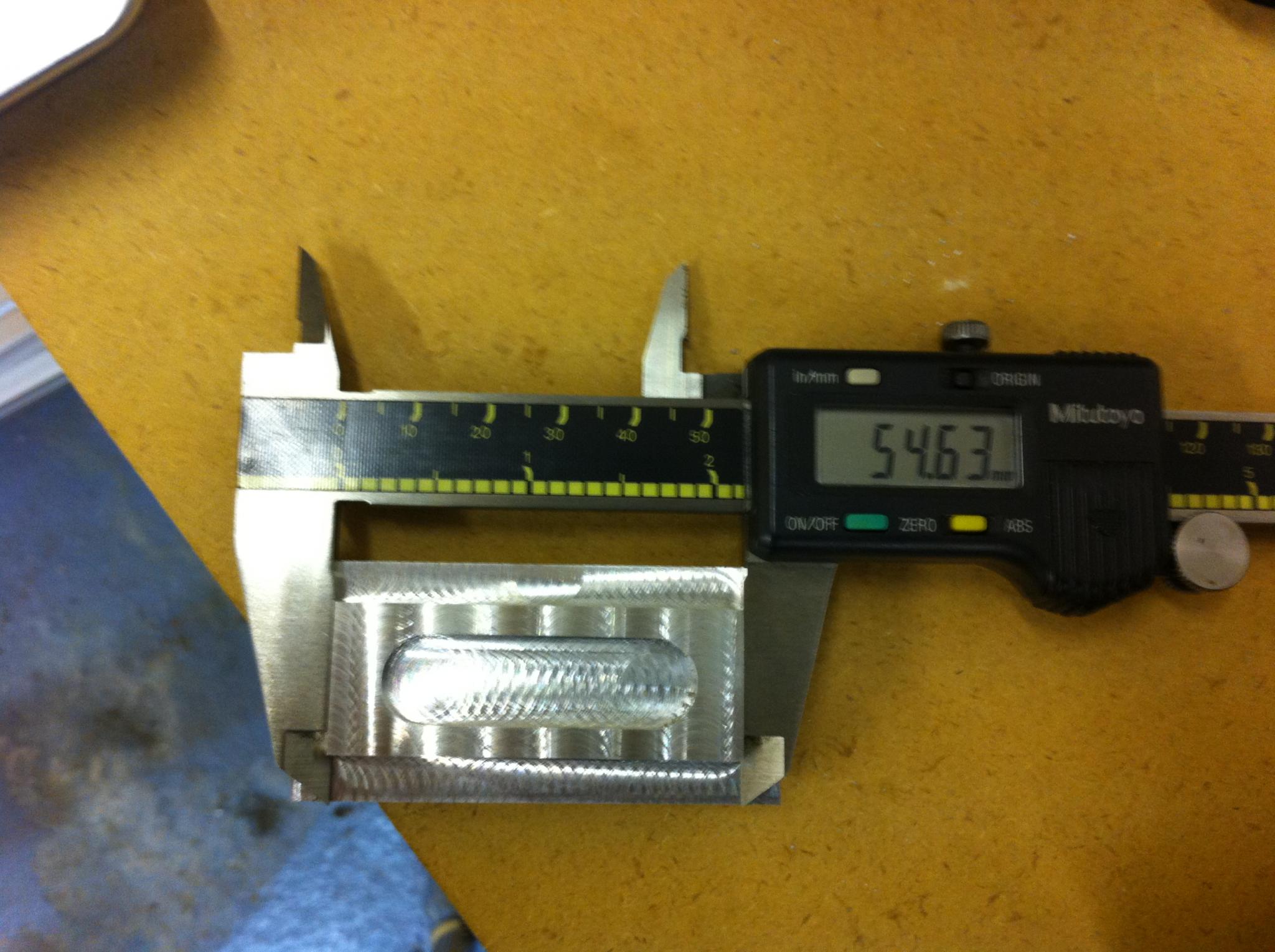

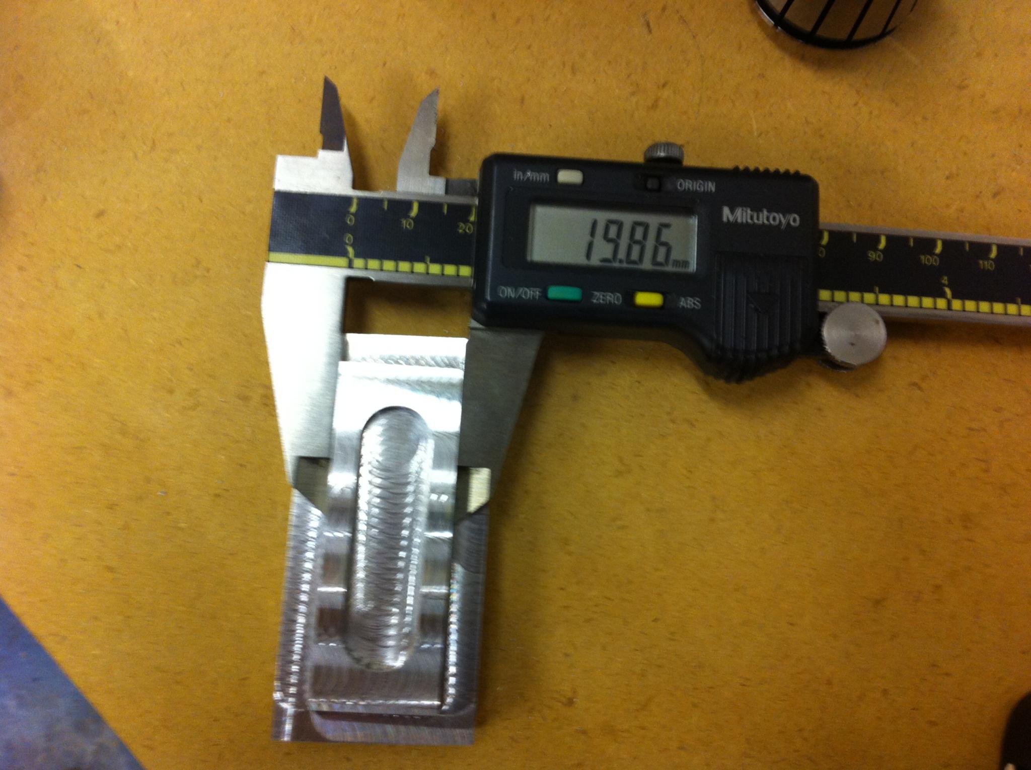

5 Attachment(s)
Re: Warco VMC Turret Mill - CNC Conversion
I replaced the ball screw in the machine now. I had Zapp Automation machine a "custom" ball screw for me which was a great job. Fitted like a dream.
I posted a video of my test on the machine.
http://www.youtube.com/watch?v=aQblxA38q5w
Now I have a problem which I'm not to sure how to sort out. Positional accuracy is pretty good. I machined a test part but I'm a little out. I'm guessing the backlash compensation will sort it out but I'm not sure how to ensure I get it right. What procedure should I use to see how much backlash I should compensate for?
Attachment 3824Attachment 3825Attachment 3826Attachment 3828

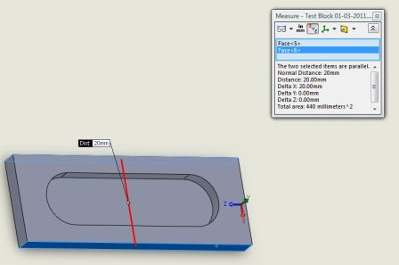

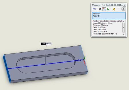

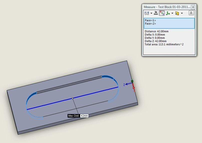

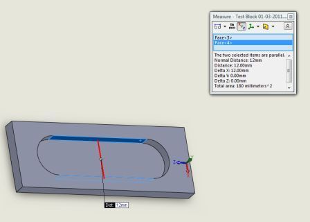

4 Attachment(s)
Just thought I'd put my model with a few dimensions just to show how far out the machine is.
Attachment 3829Attachment 3830Attachment 3831Attachment 3832
Hi Anstals,
As you are using ballscrews you should have negligible backlash so i don't think that is you're problem.
Looking at the finish on the part I'd say you have play in the jibs X &/or Y or the Z column could have excessive play in the housing.
Have you checked the amount of backlash you have "Do you know how" ?
Phil
