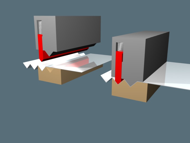

I think this sample was made using an Amada press brake from flat stainless steel sheet by making bends perhaps using a 6 mm V-die as shown in the diagrams. The sheet had to be manually turned over before each fold, easy enough for the press brake operator making a small sample but turning over before each fold becomes an issue with larger panels.
This image shows the position of the sheet relative to the 6mm V-die block before the 3rd bend is made. The top tool is not drawn in.
http://img577.imageshack.us/img577/7...ebefore780.jpg
There would seem to be two alternative possible ways to position the sheet for each fold
If a CNC press brake is used, the back edge of the sheet could be positioned against the back-gauge which would move under operator sequenced CNC control by a set distance before each fold.
Or, and this would seem to be the only method for a non-CNC press brake, a strip of steel could be attached (either using a strong epoxy glue such as Araldite, or soldered) along the vertical side of die block which would serve as a shim between the die block and the vertical side of the previous bend and the sheet could be positioned against the shim on the die block.

I have drawn up a few diagrams showing the appropriate way I believe to produce small-corrugations, "wave profile" panels using a press brake from steel sheet of thickness 0.9 mm, which would I think give a wavelength of about 7.6 mm and an amplitude of about 3.6 mm.
To make this profile using a press brake, a standard #12306 Amada 6 mm V-die or equivalent needs first to be custom ground to suit.
http://img190.imageshack.us/img190/9...grindround.jpg
The next diagram shows the position of the sheet after two bends have been made and before the 3rd bend is made -
http://img820.imageshack.us/img820/3850/6mmvdiep9mm.jpg
The above diagram assumes a CNC backgauge stop is being used because I have left a 0.2 mm or thereabouts gap between the vertical side of the sheet and the die.
The next diagram shows the position of the sheet after the top tool (not drawn) has been pressed down onto the sheet to make the third bend.
http://img600.imageshack.us/img600/3...odified658.jpg
One slight variation on these drawings is simply to use the side of the die as a stop (no CNC back-gauge required) which presumably would produce a 0.2 mm shorter bend separation width than as shown.
Using the die as a stop might mean a wavelength dimension of about 7.4 to 7.5 mm and an amplitude of 3.4 to 3.5 mm.

Depending on how many you want to make, it may be more economical to have a custom die made that can do a complete V without having to turn the metal over.
It would also have the advantage of keeping any score marks from the female die on a single side of the metal.

Ah you mean these types of corrugating press brake tools?
http://www.theroddoctor1.com/sheet_m...rragations.jpg
http://www.metalmeet.com/forum/pictu...pictureid=1987
Such tools would need to be custom made to the right profile so I think we are talking many thousands for 2 metres of such tooling, maybe even more than £10,000?
Now, OK, if a company was producing many panels, then such a specialist corrugating tool would be a good investment but I only need 12 panels for just now so a small custom grind of a standard tool is about all I can afford.
m_c
I believe there is urethane film available which is designed to be inserted under and over the work sheet to protect the sheet against marks from the die.

Modified offset die for corrugating
Peter Dow
The "L" angle shown is for illustrative purposes only. I have not worked out what the angle should be for best results yet.
OK, this is what I have now.
http://img546.imageshack.us/img546/6...fsetnewdie.jpg
Here's a tidier wide-angle diagram.
http://img833.imageshack.us/img833/9...orrugating.jpg
Versatile corrugating tool
The press brake double V-die tool, the Amada 12206, can be custom modified by grinding to allow the tool to "revisit" previously formed corrugations to allow the bends to be selectively increased to curve or straighten panels.
With the standard V-die, you get one chance to get the bend right because you can't go back and re-do a bend. This modified versatile V-die solves that issue I think.
http://img405.imageshack.us/img405/9...nbefore700.jpg
http://img705.imageshack.us/img705/8495/122065mmmod.jpg
http://img10.imageshack.us/img10/618...anafter700.jpg
Amada quoted £226 or $350 extra for the modification in addition to the £127 or $200 for the cost of the standard tool.
