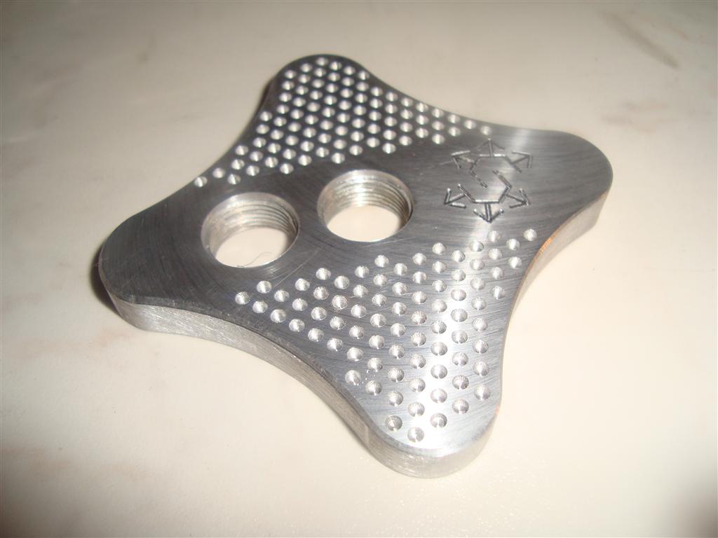

Some progress with this - here's the block that holds the pipes with decorative engraving done with 0.8mm and 2mm tools:
Attachment 4349

nice work.
Have you got the parts anodised, i have just started anodising my self with some great results.
i think you might have sealing issue with the o ring groove due to surface finish.
i would avoid nickel plating the copper as it will affect the thermal transfer.

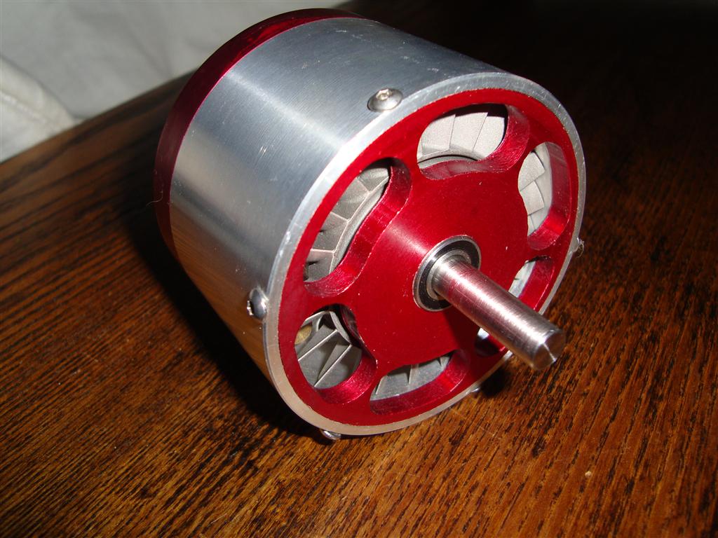

I have anodised several parts myself before with good results, however this sadly is not one of them.
This is:
Attachment 4510
fragger6662000
I chose the correct sizes for the O-ring slots to ensure it seals properly. I will confirm this by submerging it in water and pressurising it with compressed air. If I see bubbles then either there's a problem or I'm using a much higher than operating pressure.
fragger6662000
While this is true, the effect is rendered neglegible by the several micrometre thickness of the plating. This is widely accepted as the best solution to galvanic corrosion, confirmed by nickel plating throughout the majority of high ended water coolign components.

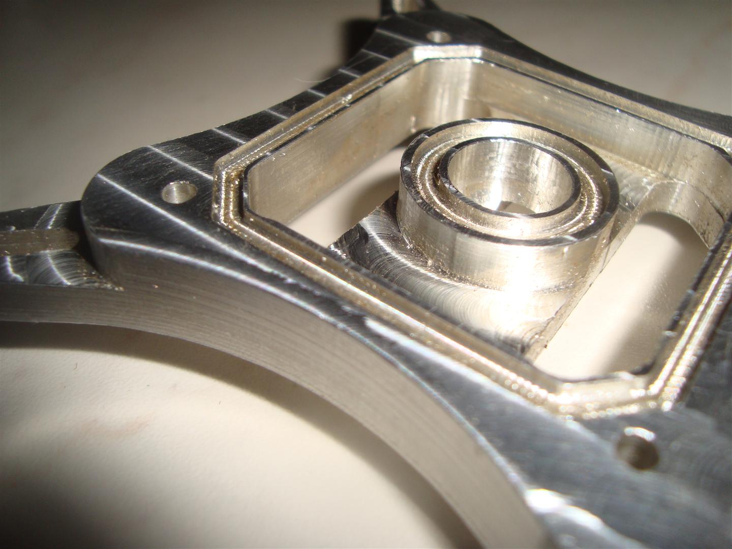

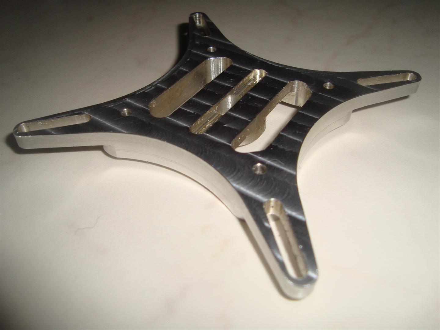

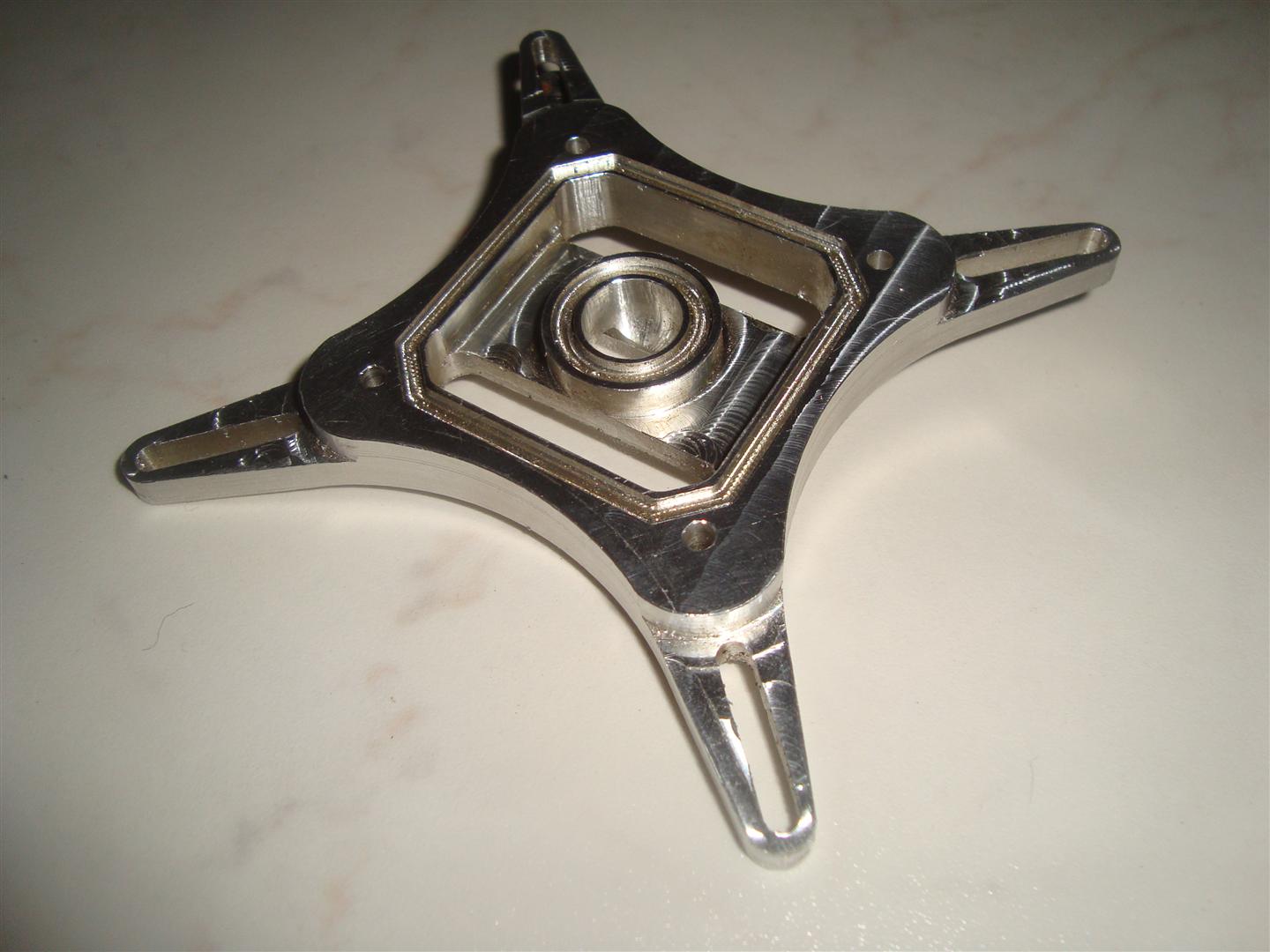

Some more pictures showing the copper block and assembled parts:Attachment 4507
Attachment 4508
Attachment 4509

you did well machining the copper as it does have a tendency to work harden and snatch tools. i was sure you were going to pressure test it, but o rings do need a good surface to seal. I designed something similar and it let in coolant like there was nothing there.

Cut the connectors for the water tube, nothing special here. Cut the M14x1 thread on the lathe to ensure it's not wonky.
Also nickel plated the copper which worked well, but forgot to take a photo.
Attachment 5121Attachment 5122
Plus some bits for the motherboard, started these ages ago but still not finished:
Attachment 5123

chip
i was wondering in order for them to be re-anodised would they need to be taken back to bare metal or can they just be steel wooled then re-anodised?.
Anodising oxidises the outer surface of the part, then the dye bonds with that so to re-anodise and dye you need to remove the previous layer of aluminium oxide. If you submerge it in sodium hydroxide (NaOH / caustic soda) the aluminium oxide layer will be dissolved. However you have to be careful since that will reduce the size of the part, especially if you leave it in too long. If there's fine threads they could disappear...
