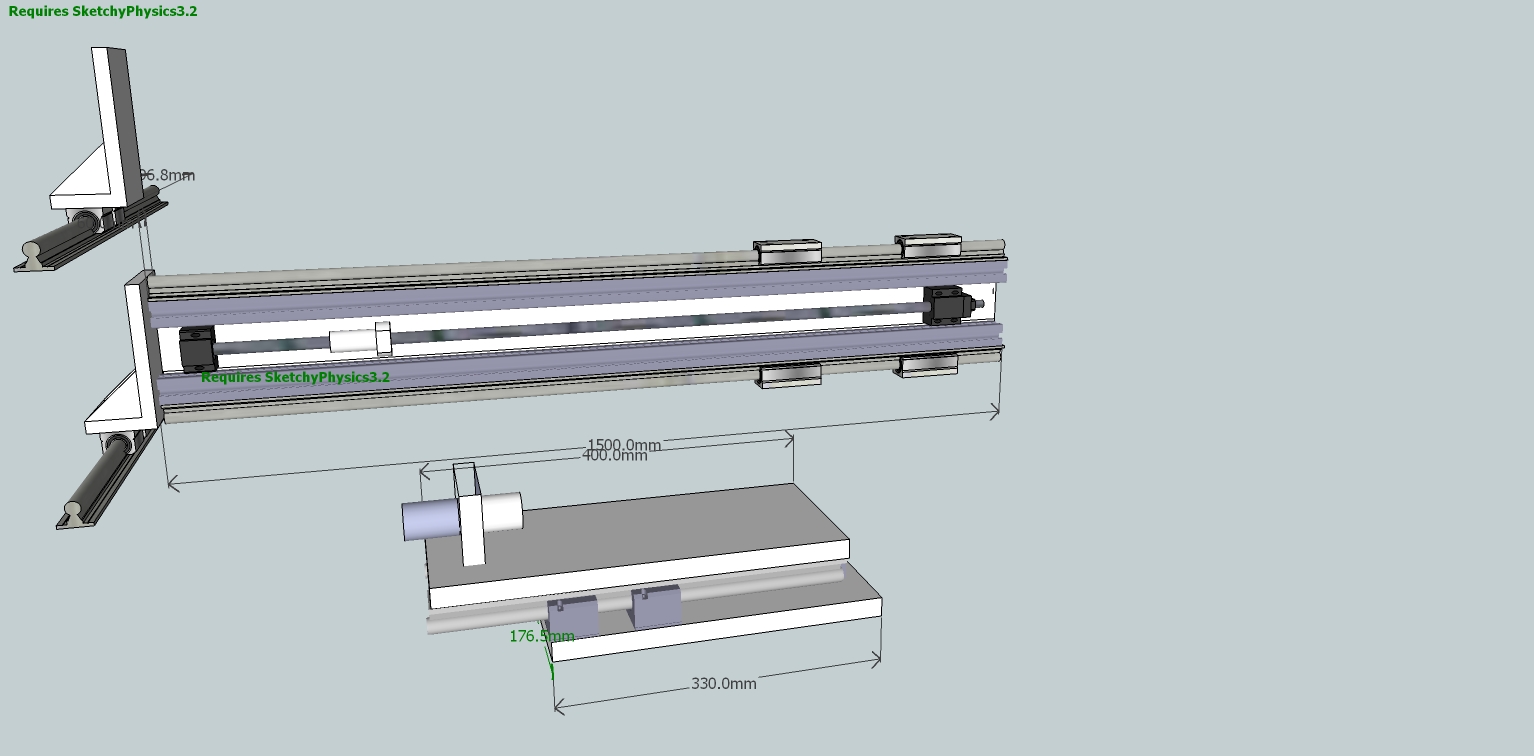

ok, first attempt using sketchup 8
Hopefully this will work. I hoping to have the Y axis 1500mm long and the x 850mm, this will help with the space i have available and will make it easy with placing the work material. i have 16mm rails,16mm screw on the x. 20mm screw and 25mm rails on the Y axis and i was thinking 16mm screw and 16mm rails on the x axis. This will sit on a steel box section frame. Have i got it right or wrong:confused:. Also going to use belts and pulleys, that's 45x 45 ali profile and 20mm ali plate as well

Hi Deanos,
Looks like a 'landscape' format machine with such a long Y axis gantry. 1500mm is quite a long span for a pair of 45mm profile sections. You could double the (torsional) stiffness if you go for 'portrait' format and have an 850mm gantry, although you do mention that you want to make it easy to load material.
If you want to continue with this style then here's Joe's cnc in case you haven't seen it, which is very popular:
http://www.joescnc.com/themachines-hybrid.php
Any thoughts on how you will attach the X axis drive system (pair of leadscrews I assume) to the gantry sides?

Hi Dean,
There's pro's and cons to both portrait and landscape designs. Landscape is good for reasons like only having one long screw on Y axis rather than 2 long screws on X axis which is a problem with large format machines, space saving and easy loading are just a bonus IMO.
The down side is that you need to really beef up the gantry and your choice of 45mm profile fastened to a single plate will leave the machine very weak IMO.
Nothing wrong with the format great for light duty wood use but I would seriously look to beef up the gantry.
If you must use profile then why not use 45x90 sandwiched between 2 plates like the pics below.
The wider profile helps with ridgidity and mixed with the extra plate it would be very strong. Plus It has the advantage of protecting the screw with just a slot for the Y aixs ball nut mount bracket which is covered with simple brush draft excluders but still allowing ballnut bracket to slip by.Access is simple by unscrewing the rear plate.
The slot is easy cut into the plate by drilling hole either end then simply running circular saw up each side.

Re: ok, first attempt using sketchup 8
My advice on sketchup, I see you are scaling the supported rail and the mounting blocks as one,
If you double click the entity, then you will be able to select them separately and then select the rail and press "S" then drag it to the length needed.

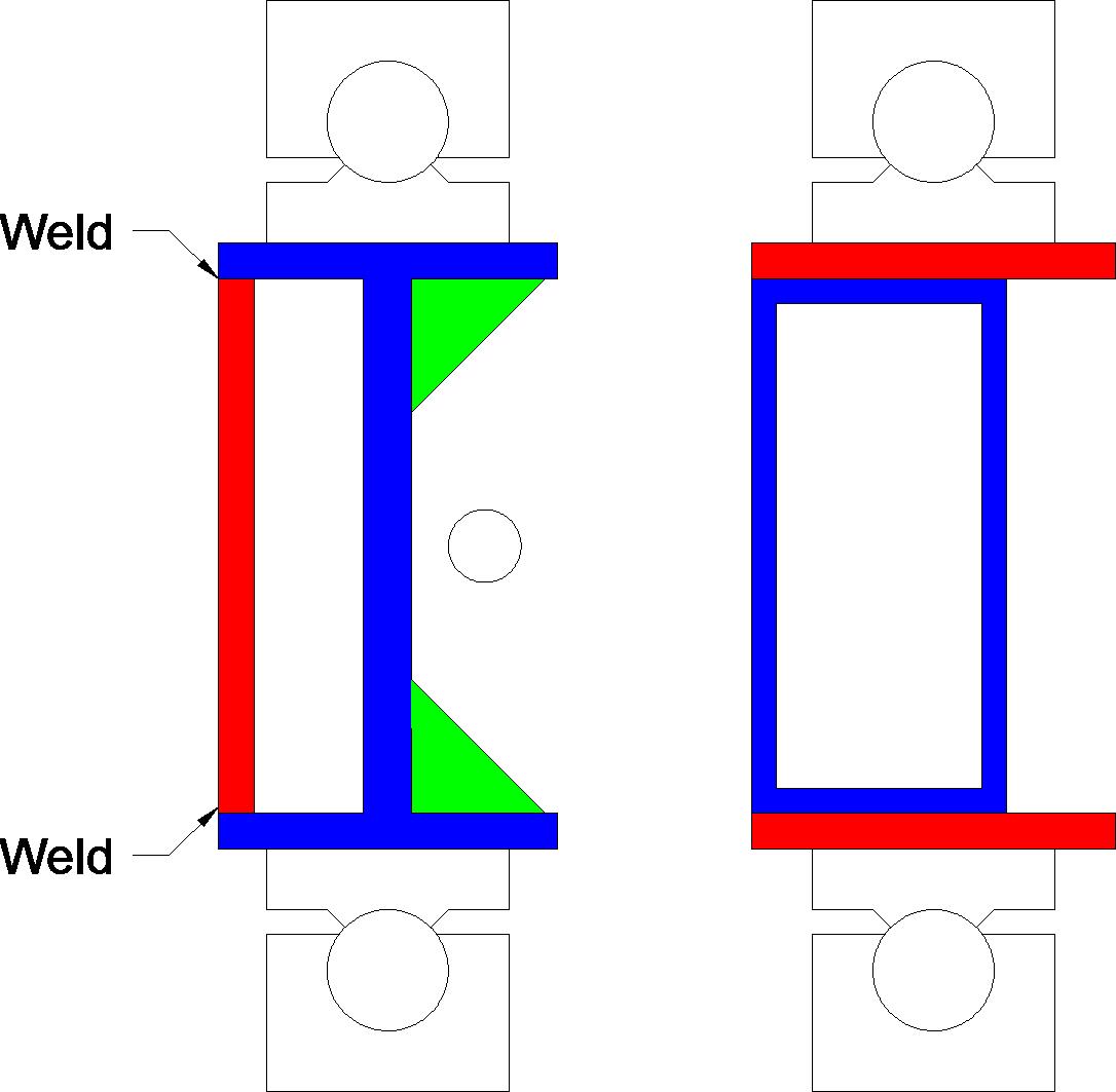

Well seen as your using steel for the frame then I'd probably look towards using that. Simplest way would be an I beam RSJ type beam.
Would get 180x100 for about £30 if your buying steel for rest of machine. You can buy 1500mm length from Metals4U for £37 plus postage.
This would be an easy option and plenty strong enough for your needs, easy to fasten rails, screws etc.
You will need to make sure you get a nice straight and flat piece then may still have to do a bit of cleanup with grinder/sander and straight edge to make it's flat but it makes a very strong gantry. (Don't be fooled into thinking profile is always straight or flat.!!)
The weight will be slightly higher but to be honest for a wood router if mixed with a strong spindle/big router the extra weight can be an advantage and allow deeper cuts which offsets the slightly lower feeds.
The other way is to use 80x40 box section in a similair setup to the Cad model using profile, just slightly cheaper than profile at £35 for 7.5mtr.

Here's how I'd go about it.! . . .Miniumum welding and very strong. I've drawn it with welded corner braces but this could be built without any welding what so ever just drill and bolt if you used 19mm plate for the corner brackets.
Personally I'd weld 5mm plates in the corners and proably a few extra braces across it's length round the back side to just help reduce resonance but again these could easily be bolted, just weldings quicker.
I'd also probably incorparate a thin detachable cover plate on front with slot in it using brush's like in other design just to protect the screw from debris, esp if main use is wood. For the little extra work and expense it will save the screw big time. You could use flexible consertina type covers but they are expensive and can be akward to setup.
EDIT: OR you could just cut a slot in the RSJ and mount the screw on back side and cover with thin plate, something like clear perspex so you can see workings.!! Added pic (RSJ4) with slot in couldnt be arsed to alter sides or move motors but again you'll get the idea.
It will weaken the gantry thou and some extra bracing along it's length would be required.

The torsional stiffness of I section is very poor compared to RHS or box section and clearly the ganty twisting directly leads to tool deflection (proportional to the extension of the Z-axis) parallel to the Y-axis. For the same mass you should be able to make a much stronger gantry with RHS, or an equally strong but much lighter gantry. The difficulty is the position of the Y-axis ballscrew is sub-optimal, but you should be able to get it close to between the rails. That's why people often use two pieces for the gantry with the ballscrew between. That also allows adjustment to get the rail mounting surfaces parallel.
Routercnc's spreadsheet posted a few years ago on this forums lets you compare the sections easily.
There you go again Jonathan completely missing the point.!! . . . . YES AGREE there are stronger and lighter ways to build a Gantry BUT and here's the point.!! THIS WILL EASILY HANDLE THE JOB OF CUTTING WOOD AND BE MORE THAN STRONG ENOUGH . . very easy to build and cheap easy to source.
From what I under stand Dean intends mainly wood use so the Z extension will be minimal, or should be for best results, so given that it's only 1500mm long and twin screw driven being securely tied into both the X axis bearing plates and the gantry end plates and with a good steel thickness on RSJ then the twisting(torsion) will be minimal.
Not every body has the skills or equipment you and I have so minimising the equipment required but still having a strong gantry doesn't get any easier than this.! . . .Drill and saw/grinder are the only tools required.

Hi Deanos,
I've compared the following 1500mm long steel gantry shapes for tool deflection due to gantry twisting (when cutting wood in the X direction):
_____________________I beam__RHS____RHS
Width _______________100_____100_____100
Depth _______________180_____180_____180
Flange/wall thickness ___6________6_______3
Mass (kg) ____________26______38______19
Deflection (mm)______0.021___0.00037__0.00068
Clearly RHS is better, but I beam is also 'useable' for cutting wood. In the end it is about what is sufficient for your needs and what you can comfortably make.
Jazz i'm with you on this one, i would love to see Jonathan try and twist an RSJ mounted on his machine? you are still talking 5/6mm minimum steel plate.
JAZZCNC
Of course it will handle cutting wood well. A machine built from wood is capable of cutting wood but that doesn't mean you should make one.
My aim is to make as good a machine as I can, not one that's just meets my current needs.
JAZZCNC
A substantial joint at the ends, i.e. welded plates, will help but it's not the whole story. Good end fixity makes a big difference to beam bending but not torsion.
For instance, using the spreadsheet to calculate torsional stiffness relative to 180x100 RHS:
180x100 RHS section, torsional stiffness, 1
180x100 box section, 3mm wall, torsional stiffness, 103
180x100 box section, 5mm wall (same mass as RSJ above), 164
100x50 box section, 3mm wall (biggest from metals4u), torsional stiffness, 13.9
152x12.7 plate, torsional stiffness, 1.1
So you're talking 10-100x difference. The mass of the RSJ is greater than all of the above and the bending parallel to Y on all the above sections, except the plate, is negligible (much less than the torsional deflection).
So I suggest deannos should use the design Jazz suggested earlier with two 80x40 box sections, with the ballscrew between and a plate on the back. Easy to make with hand tools, no worry about parallelism of the rail mount surface and bending is less than all of the cross sections discussed above according to the spreadsheet. Unfortunately can't calculate torsional stiffness without FEA but it's clearly less.

Yes Dean it will be more than up to cutting wood.! . . . . There are issue's which arn't Ideal like easy setup of parallel rails like Jonathan touched upon. . . But if like I said with carefull selection of material they will be very close and then It's not difficult to manipulate them parallel with filling/grinding and spacers/shims.
My experinece with Cheap chinese round rail is that it's not straight or consistant in dimesions along it's length, just as the bearings mounting surfaces are rarely level, flat or true so shimming is nearly always required to fine tune. . . BUT AGAIN . . . It's down to intended use and for machineing wood then the tolerences are much lower and forgiving so can be tolerated.
If you want to wear belt & braces (excuse the PUN!!) and just add some bracing along it's length.!!
Regards that Pic you posted I'm pritty I've seen that before and it was actually built to cut stone.?? . . . . But don't quote on that!!. . . . But I've certainly seen one built the same that was cutting stone and it actually came up for sale on Ebay.

Ok didn't see this or Jonathans last post so this apply's to both post's.
First I'm not knocking the Calculations or saying they are wrong but your both missing the POINT. . . .!! IT WILL DO THE JOB AND DO IT GOOD.!! . . . IT'S CHEAP AND EASY.!!
It's easy to build with absolutly minimal machining or drilling, far less Jonathan than my first design which yes is stronger but much more expensive.
Jonathan good design is about building the best machine to do the intended use accurately and effiecently. A good designer will always design a machine to do the required job with a certain safety percentage designed in and no more. Any more is just wasted expense and ineffiecent.
Working On your design criteria then you FAILED because you could have used far heaver gauge box section or steel plate rather than Aluminium or why not go the whole hog and Cast some Iron castings.!!. . You had the knowledge,equipment and abilty so why not.? . . . . . Because it didn't warrant the extra cost and effort to accumplish what you intended to do with the machine.
I've just checked price with my supplier and I can get 1x1800 & 2x1000mm 178x102 RSJ 8mm steel for £75 no vat cut to length delivered.
That will do both the gantry and the X axis. Or Just the gantry would be £37.!!
So Profile/plate way:
Ali plate 4mtr x 150 x 9.5mm = £86inc vat + £10 delivery = £96 (400mm left over)
Profile (as per my other design)1800 x 90x45H = £41.50 x 2= £83 + £10 delivery = £93 . . .or 1800x45x45 (As dean's design) =£43 +£10 del = £53 . . .OR. .
80x40x3 steel box section £39
Plus lots more Nuts and bolts so another £10
Total £199 OR 45x45 £159 OR Steelbox £145

One last thought:
Attachment 5272
You could weld a steel sheet (red) on to the back of the RSJ (blue). Then you've got the torsional stiffness of box section and the convenience of RSJ. It needn't be very thick, I think 3-4mm sheet would be fine. Adding several of the green triangular pieces might help, but it's a lot of effort to cut them out without a guillotine. Only problem with all this is the welding might distort the top surfaces, so it's best to do it from the start.
Other option is use box section but add plates on the top and bottom so that you can put the linear bearings off center to get the ballscrew in a good position. Not sure which would cost more...
deannos
The only thing that worries me slightly is the weight of the gantry, i know weight is a good thing, but would this be to much to get decent speeds. Now i'm not looking to break any speed records, just to get a reasonable feed etc. The motors i have at the moment are nema23-3NM and MSD542 drivers with 50v power supply.
Jonathan

It's only a suggestion, take it or leave it. I post these things to benefit other people who may want more from the machine than Dean.
Adding the plate to make a box is very simple and should make a big difference but if Dean never wants to cut aluminium regularly there's no point. 0.01mm tool deflection might not sound like much, but when you start cutting metals it is - surface finish, material removal rate and tool life are affected. Running the calculation with cutting force for aluminium gives 0.058mm.
I used 8mm web thickness for the RSJ, not 6mm, in all the calculations as that's a standard size - with 6mm tool deflection is about twice as much.

Dean for your MAIN need of cutting wood the RSJ will perform perfectly well without any extra bracing, welding or what ever. It will cut Ali but obviosly with restriction and greatly reduced performance compared to if it was built for that use.
Accept it's limitations and you'll love the machine which will become your faithfull servant but push it past them and you'll hate the bloody thing because it will try to kick you in the bollocks at every inopertune chance it gets.!!
Personally I'd use the RSJ but want to fill in the front and rear with thin covers, these would be serving 2 purposes with a frindge bennifit of adding strength.
Firstly functional, Secondly cosmetic, on the front they would be protecting the screw from debris with the slot idea on the previous design and on the rear it would be mainly cosmetic possibly houseing wires etc.!!. . . . but heres the fringe bennifit.?
To do this I would cut plywood braces that get bolted between the flanges and thru the web of the RSJ the covers would be just thin plywood screwed to the blocks. The bolted blocks would increase rigidity and combined with the plywood increase strength.
I've attached another pic to help explain.
Edit: Added coverd in pics for completeness.!
