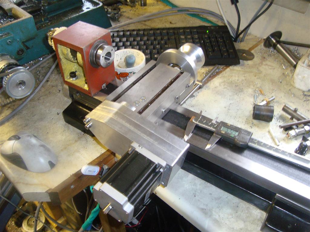

		I recently found a Clarke CL250M micro lathe for a good price, so I got it to convert to CNC. This lathe is very similar to the C1 micro lathe from Arc Euro.
Parts bought:
Unfortunately I didn't take many pictures to start with, so this is going to be more like a 'look what I've made' in parts than a build.

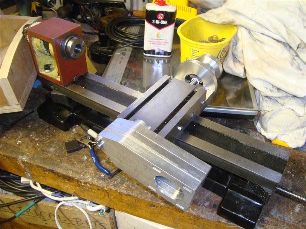

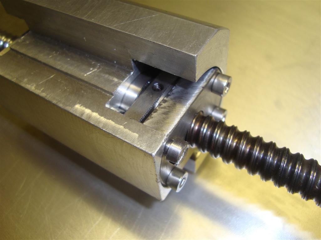

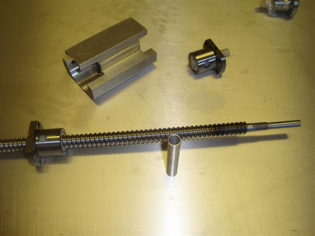

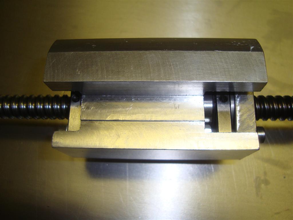

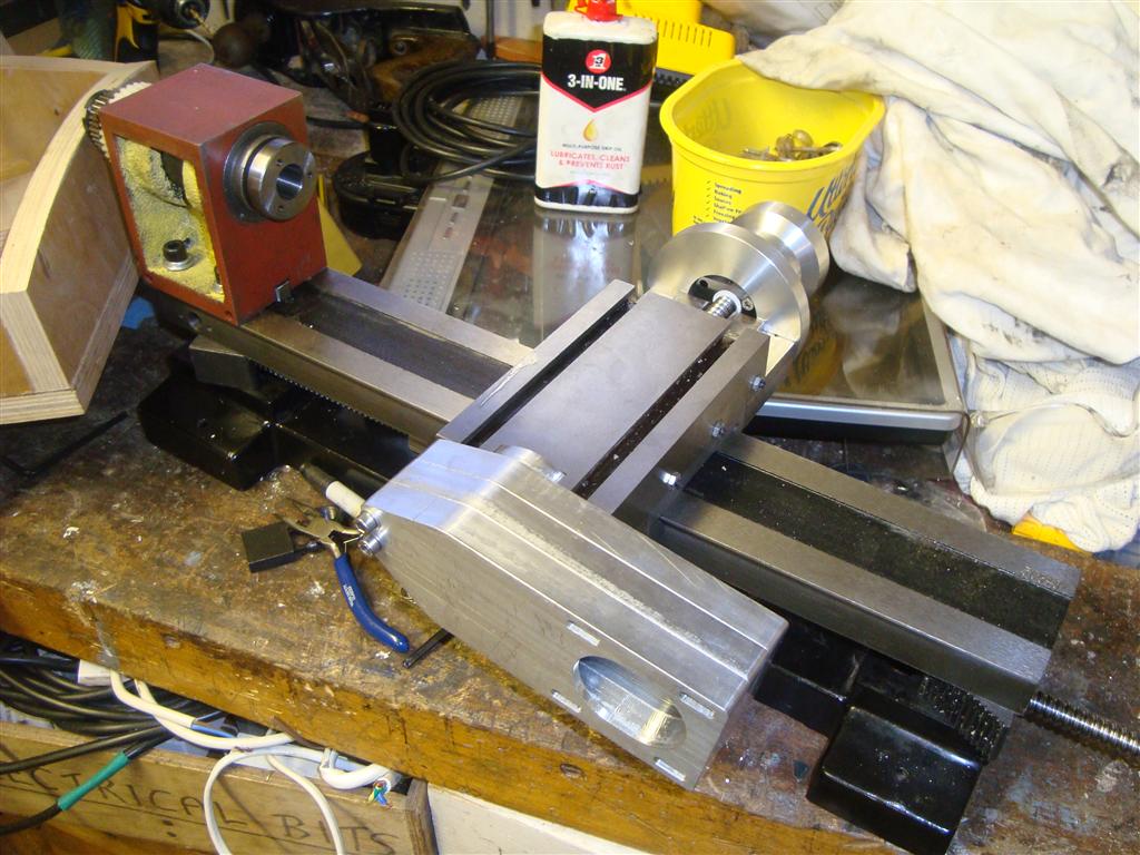

Not a chance of getting an RM1204 ballnut in the cross slide, let alone two, so I've mounted them behind. To do this I milled a block of steel to extend the saddle for the ballnuts' mount and drilled it:
Attachment 5877

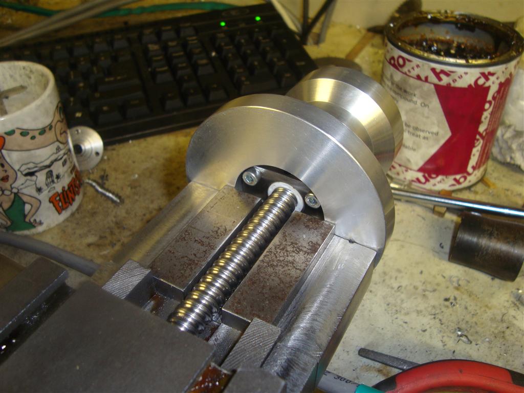

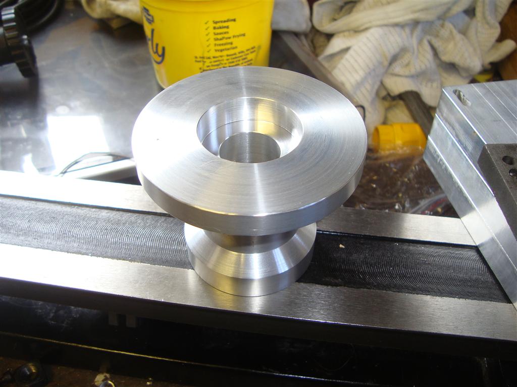

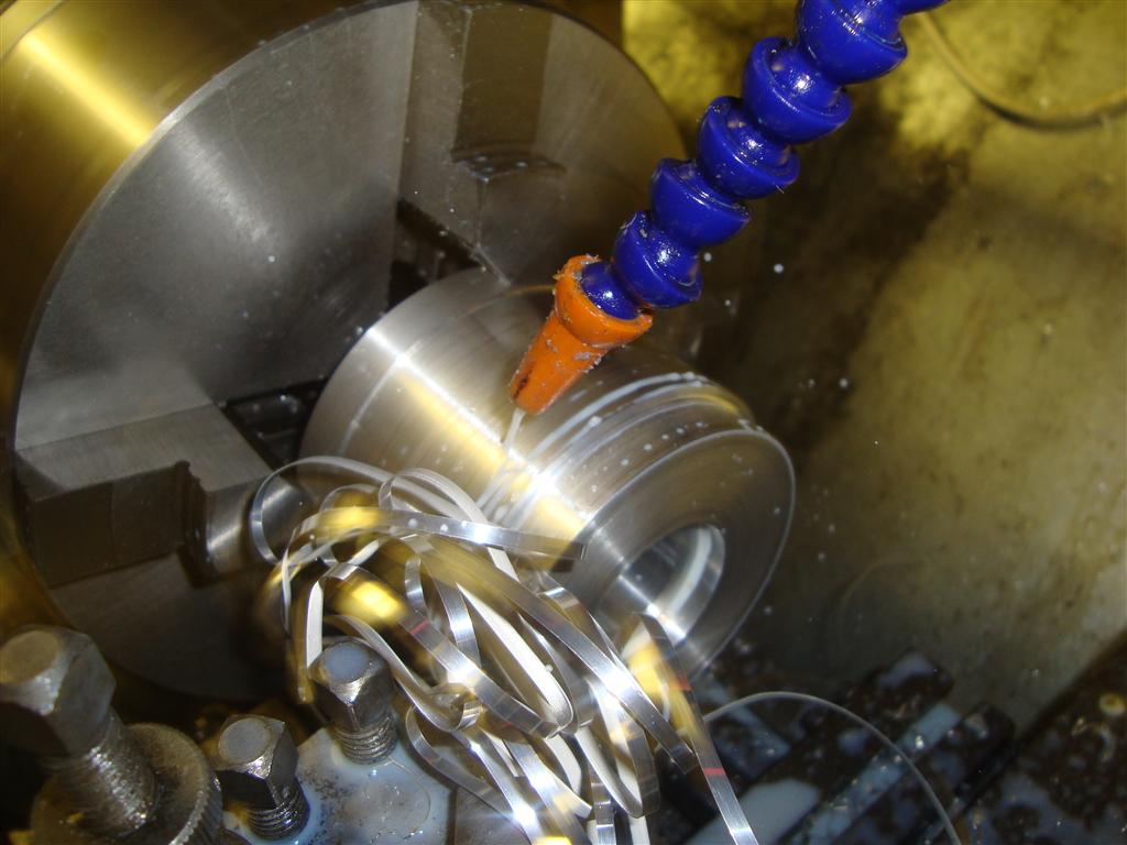

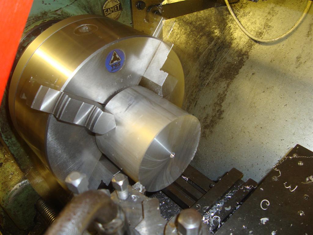

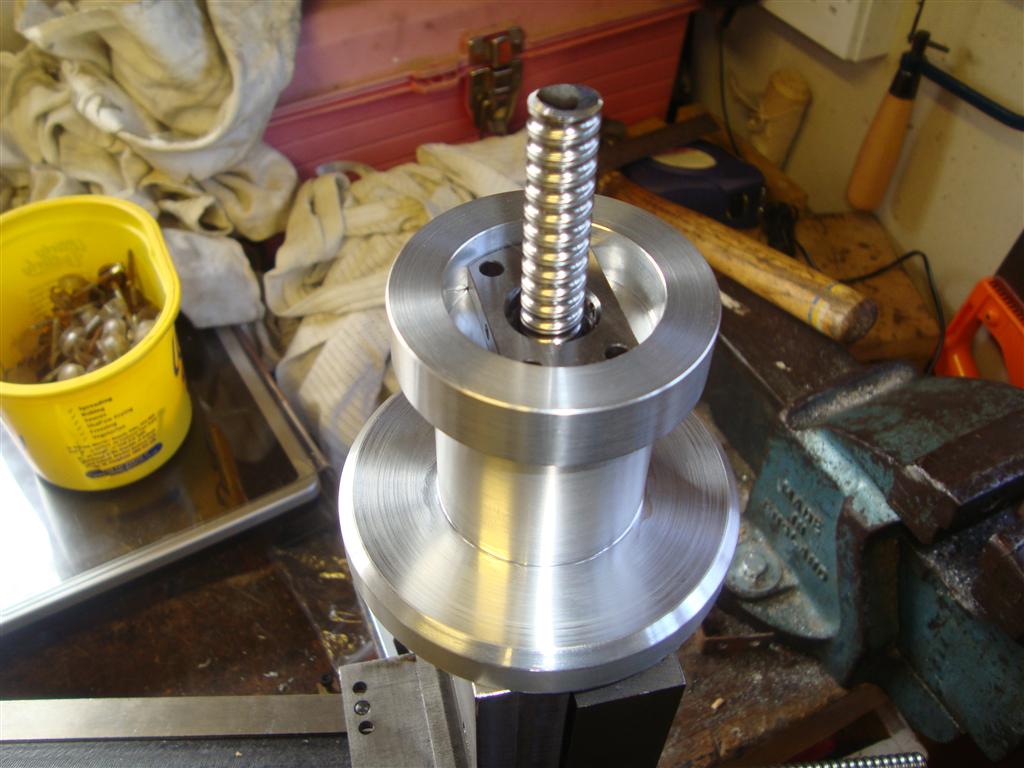

Next I turned some 3.5" aluminium bar to accommodate a two ballnuts, one in each end:
Attachment 5872Attachment 5873

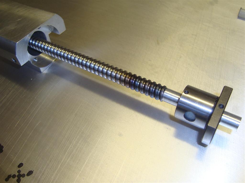

One ballnut fixed in this side:
Attachment 5874

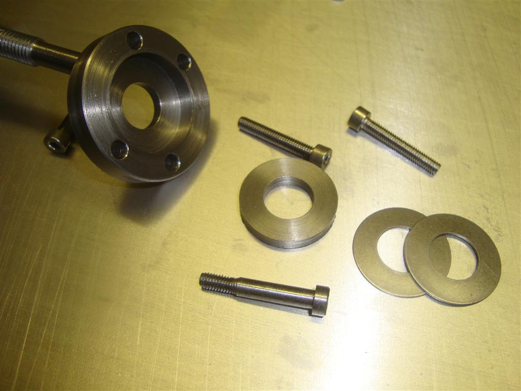

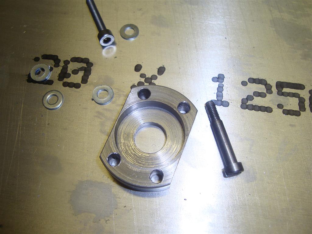

The other goes in this side. On 'top' of that goes a steel spacer, then and end cap to accommodate a pair of beleville washers. This cap is bolted through the ballnut to apply a preload of about 300N and rotationally constrain the ballnut:
Attachment 5875

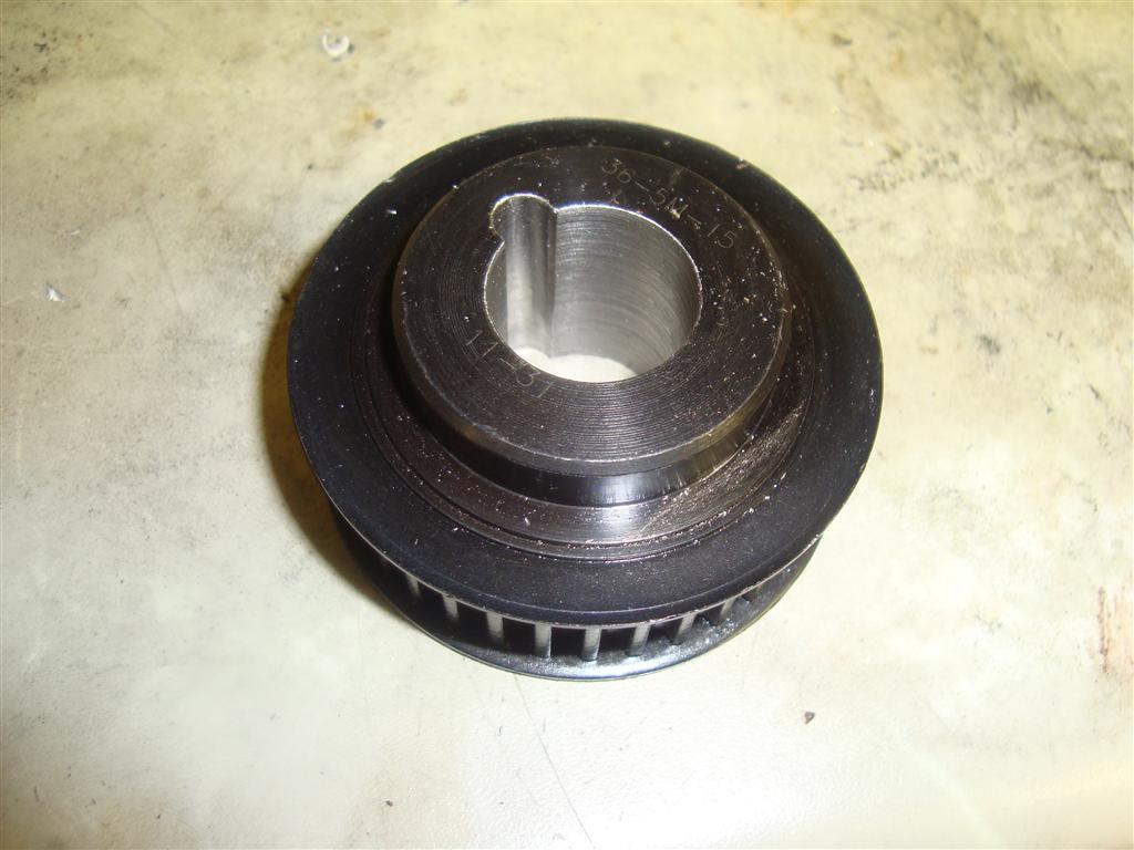

Cut the aluminium motor mount on my CNC router. Just a few 5/8" thick aluminium plates with a cavity between to accommodate the pulleys so that swarf cannot get in the belt drive or bearings. I used a 12T pulley on the stepper motor and 30T on the ballscrew for 0.008mm resolution with a 200step/revolution stepper motor. If you count using microstepping it's a convenient 1um resolution. Once assembled I put a DTI on it and you can see the needle move for every microstep...so reasonable to assume somewhere between 8um and 1um, either way plenty good enough for this sort of machine. The angular contact bearings are held in a separate part and clamped with a 5mm steel plate also cut on my router. I machined the ballscrew with an M8 thread on the end used to apply preload to the belville washers / magneto bearings.
Z-assembled, but only with one ballnut:
Attachment 5876Attachment 5887

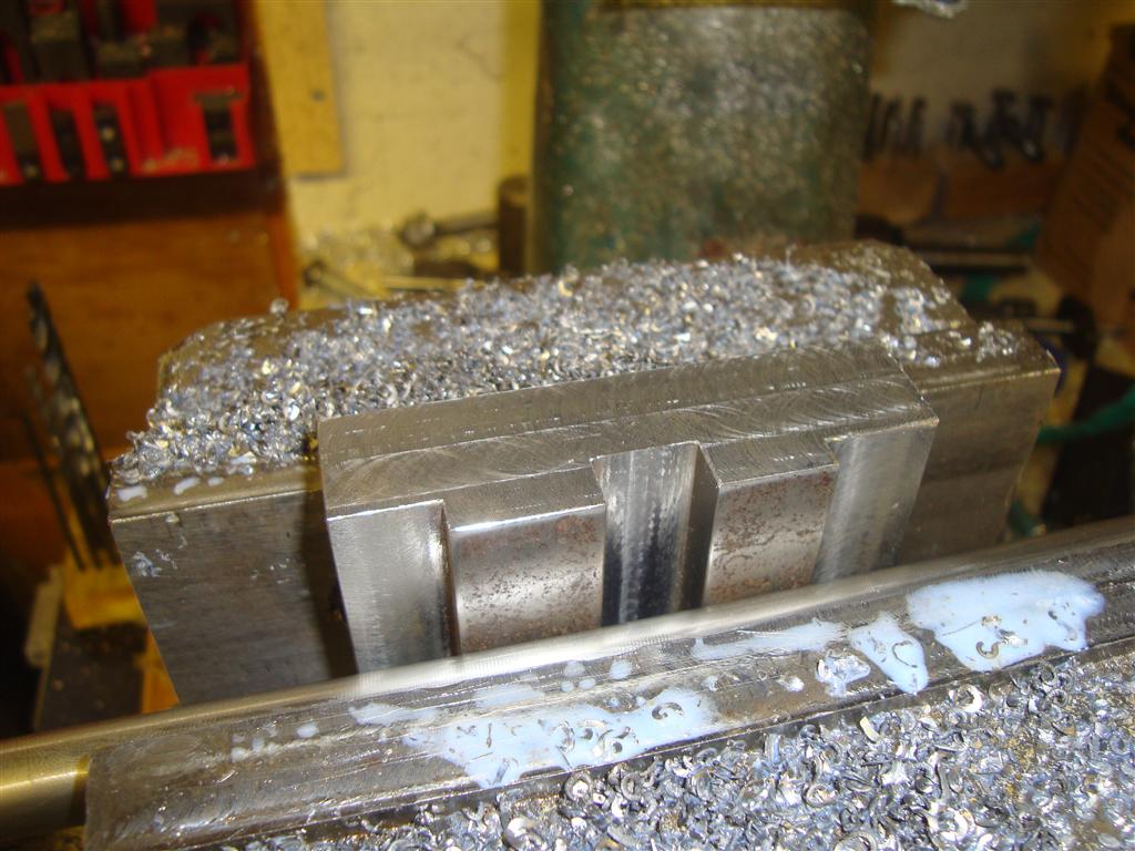

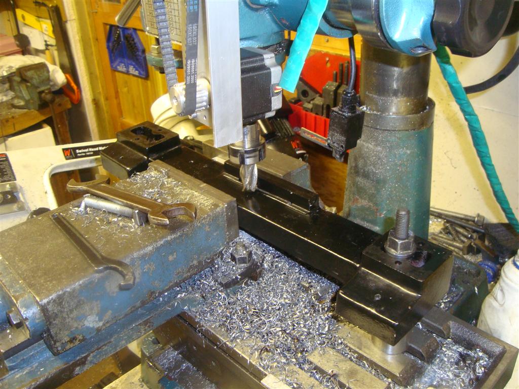

After much deliberation I decided I couldn't get an RM1204 ballnut to fit under the lathe bed without milling some of the bed and raising it. I just milled a couple of mm off the webs in the bed to get the ballnuts to clear, so that shouldn't weaken it to much. Forgot to take a picture of that.
Next I milled the middle protrusion off the bed stand:
Attachment 5878
Then made some 10mm spacers from ground flat stock to go between the bed stand.

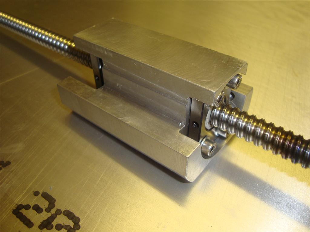

I cut the ballnut mount from 2.5" aluminium bar. Bored, drilled and tapped both ends to accommodate the ballnuts in a similar fashion to the X ballnut. Then some milling and finishing with flycutter. Next I machined the ballscrew and made a quick tube to fit over the end and transferred it into the ballnut. This enables fitting the ballnut without all the balls dropping out...
Attachment 5879
Belville washer pressure piece and one screw machined to closely fit the ballnut on the cylindrical portion. This constrains the ballnut rotationally.
Attachment 5883Attachment 5882
Sliding the ballnut on:
Attachment 5880
Assembled and preloaded:
Attachment 5884Attachment 5885Attachment 5881

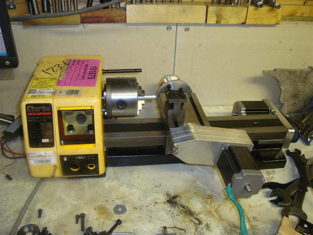

Assembled with Z-motor mount, not shown:
Attachment 5886

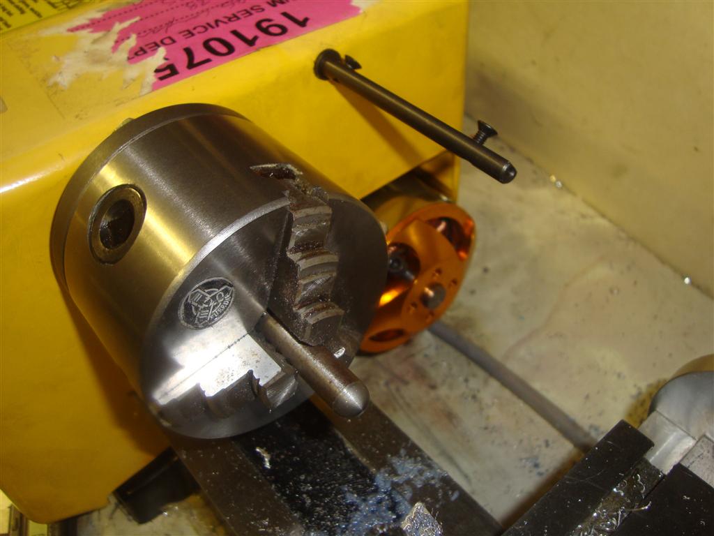

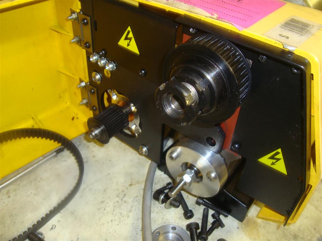

The 6.5kW (allegedly) brushless motor I had was the same diameter of the somewhat limited 150W DC motor this lathe came with, so it bolted straight in with the mount it came with. I just had to make a shorter shaft (so the original covers fit) and machine the pulleys. Although this motor initially seems excessive, it's arguably well matched since it has plenty of torque over the full speed range, I probably wont need to use the 1:3 ratio.
Attachment 5889Attachment 5888
I've not had chance to do anything with the lathe for a couple of weeks, so I've left it like this:
Attachment 5890
I will soon add plates to the Z-motor mount to seal the belt, similar to Z.
Now I can cut hemispheres!
Attachment 5891
Enough for now... more to follow shortly.

 Thank you... but spoke to soon I'm afraid.
The backlash is nowhere near zero - 0.04mm on Z and 0.024mm on X. I've tried various preload settings on the Z ballnuts and different amounts of tension on the ballscrew to make sure there's no end-float. I'm therefore not sure where the backlash is coming from. The preloaded ballnut is possibly a little tight in the mount on Z, so that might be it ... I'll have to investigate. Not sure about X :(

			What strength did you get and how many per screw. How did you stack them series or parallel IE: )))) or ()()
 For preloading the nuts I got:
http://www.leespring.com/uk_product_...ype=W&subType=
 For preloading the bearings I got:
I chose the springs based on:
Preload force=10-20% of ballscrew static load rating
Belleville washer compressed no more than 75%
I stacked them like () to get greater adjustment whilst maintaining the same spring constant. The Z-ballscrew has two Belleville washers at one end, the other end fixed and one angular contact bearing on each end, so the screw is tensioned. On X the end of the screw is floating, so clearly both washers and bearings at one end.

		This lathe has sat on the side doing nothing since I posted here, just not had time for it. A few days ago a 12Nm stepper motor arrived, which just so happens to fit the lathe mount, so how could I resist using it to power the spindle?
Attachment 6947
A few moments later:
Attachment 6948Attachment 6949
I had to take the covers off since now I don't have the right length belt which means the motor is in a funny place. I chose a 36:22 (motor:spindle) ratio since if we take the speed/torque curve from Zapp's site and convert it to more meaningful units, the peak power is around 600rpm so around 1000rpm spindle speed with that ratio.
Attachment 6950
I've only got the motor on 70V (DM860 drive), so that graph isn't ideal, but it seems to work well and runs the spindle up to 2000rpm. The motor was fine with drilling a 6mm hole in aluminium and general turning. I think I'll make a bigger pulley for the motor and try it anyway. The finish leaves a bit to be desired, but I think that's mainly the lathe itself being weak and having to have the material quite far from the chuck as currently the rear shaft on the motor interferes with the saddle. I don't think that will be a problem with the longer belt and if it is I can easily mill a little bit off the steel block I attached to the saddle to get clearance.
I configured LinuxCNC to run the stepper motor as the spindle by editing the .hal file - pretty simple. Next step is to get G33/G63 to work so I can do threading. I could just run it as an A-axis and program a ramp (e.g G1 Z-10 A10), but I'd prefer to do it properly...
Anyway, it seems this thread is useless without a video, so here goes:
http://www.youtube.com/watch?v=fHCu4...=youtube_gdata
Edit: Almost forgot to mention I solved the backlash problem on Z. Turns out it was just the belt being a bit loose, tightened it up and now the backlash is essentially zero - the 0.0001" indicator returns, as far as I can see, precisely to the same mark if approached from either direction.
I just need to make one piece for the X-axis so I can put the second nut in to get the same result. I wonder where the Belleville washers went. I think I've broken the magneto bearings whilst working out what was wrong, so I'll buy some better ones. He's got 708A and 708C so presumably that's the different contact angles - it would be good to know which is which so I can get the ones that tolerate higher axial forces!
