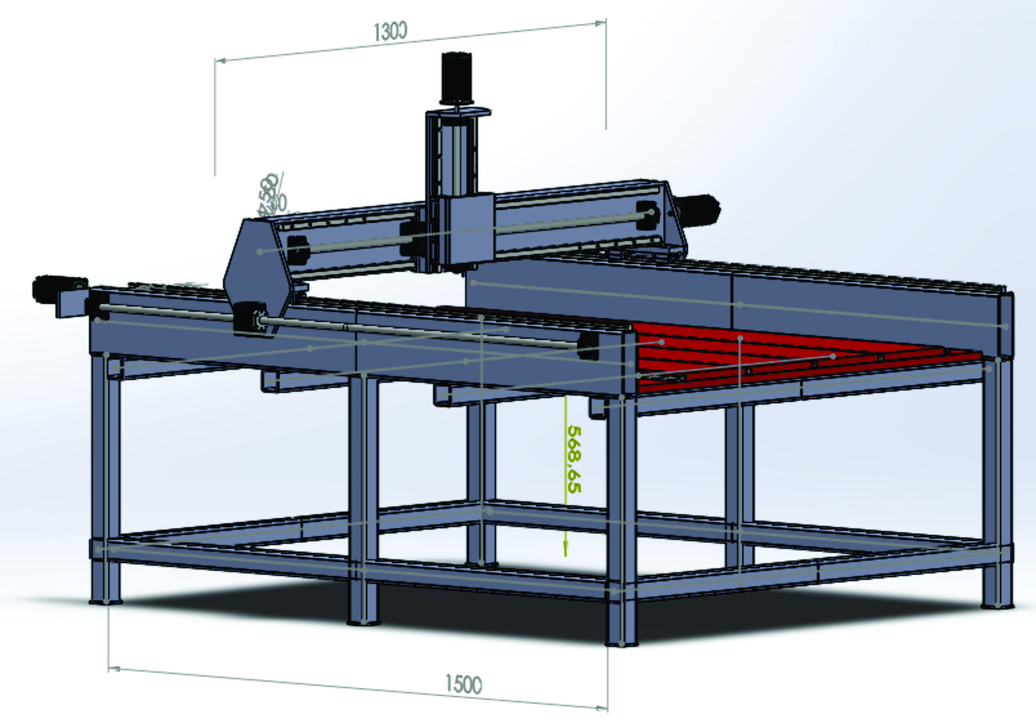

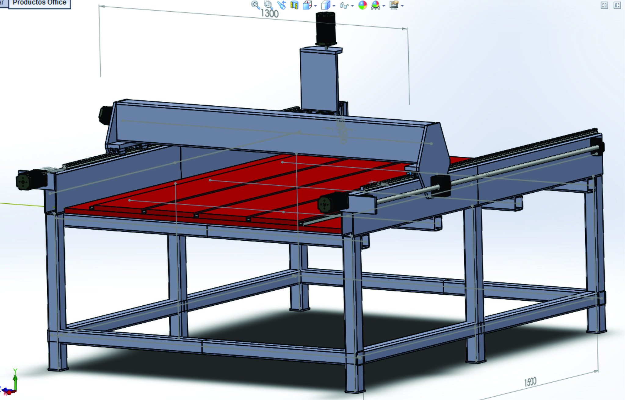

I did a 3D model to verify the dimensions of the metallic frame, I will attach some pictures so that you can give me your opinion, because I have problems starting with the linear movements and the electronic, but regarding your observations I will be able to change them.

Re: I NeeD HeLp PLease AM882 a good choise
jpsicilia
Here are some old frame renders
Hope this is just initial draft because You will need many more supports and bracing adding before this design is usable.
Also it's too wide for a central ballscrew and you will never successfully cut aluminium, or wood for that matter with this design. ABSOLUTELY must have TWIN ballscrews.!!

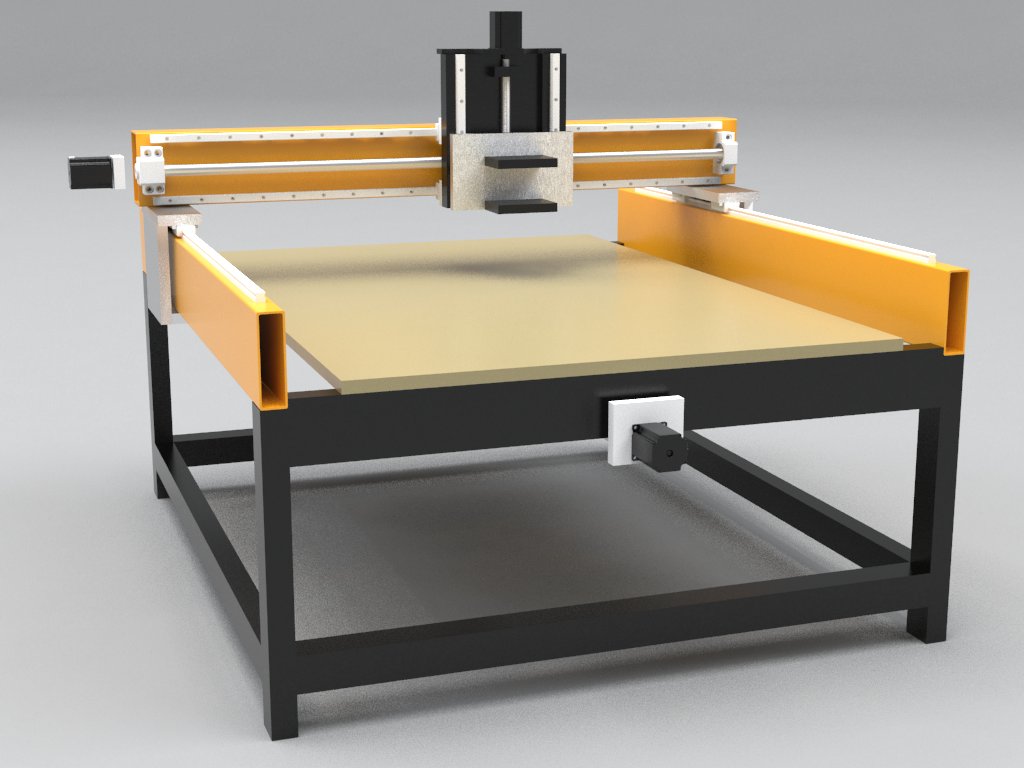

How are you Jass? You are amazing! You have clarified many doubts for me. I hadn“t considered the pitch before and the quality it brings. As you said, it is true that we think that the bigger the engine the better. It is very interesting your idea of changing the ratio of the pulleys to get more resolution or speed and considering the torque. With all the information you gave me I have decided to restart my project. I will remodel these aspects with the solidwork software and I will most probably ask you some questions if you do not mind. Thanks a lot!!

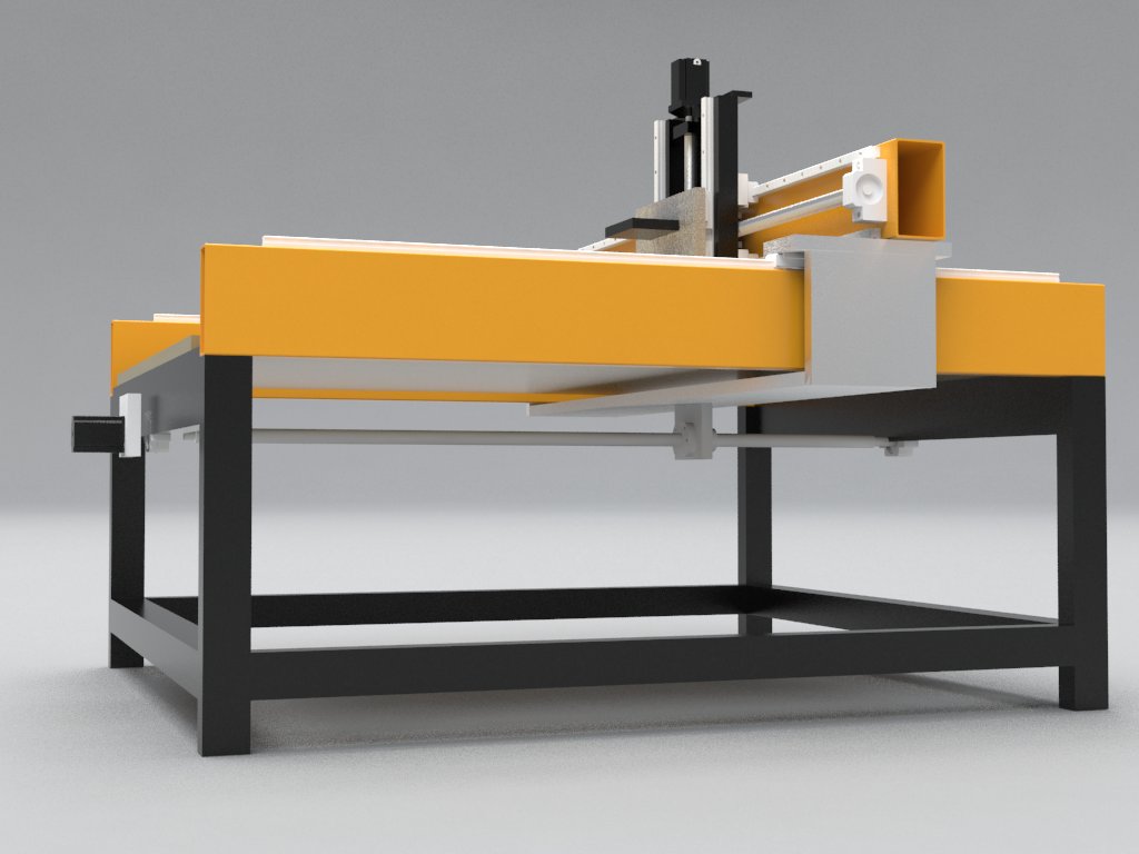

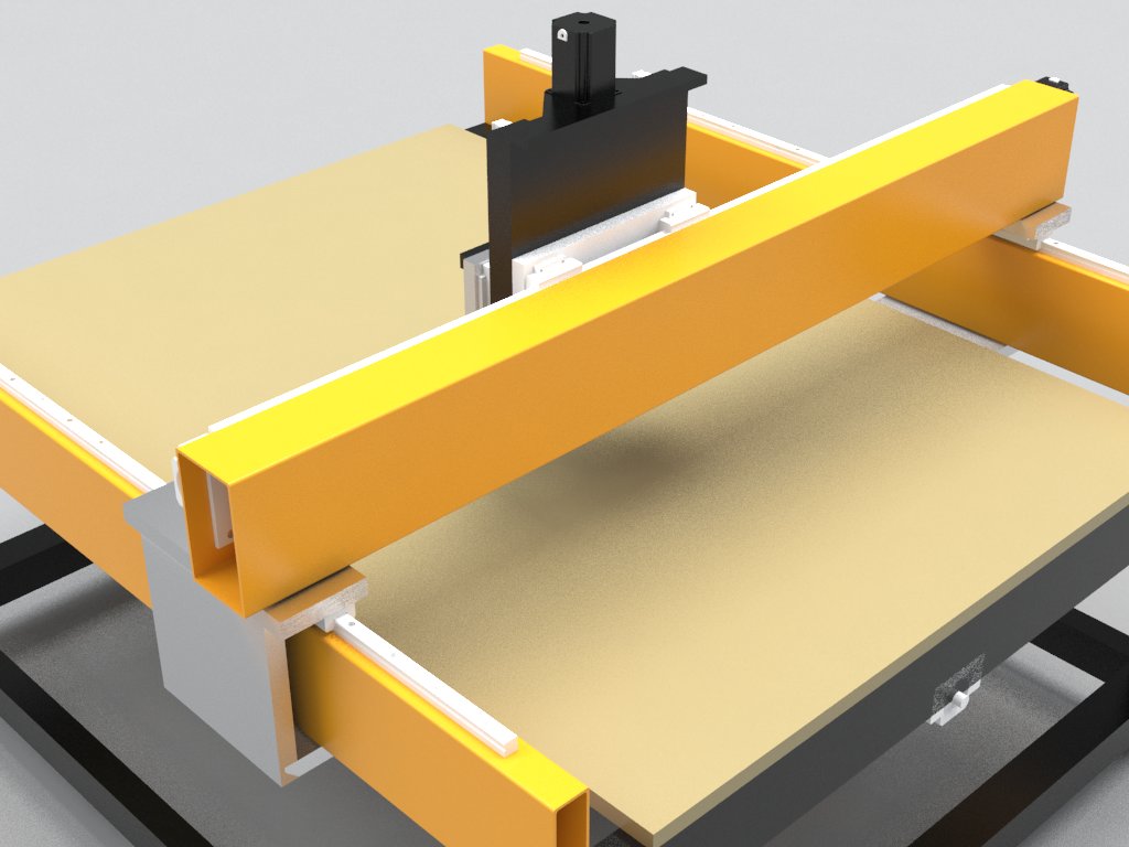

Same pictures of the cnc frame
Attachment 10574Attachment 10575

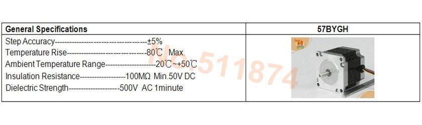

Hello guys I try to follow your advice in all the buys. I bought this models, wt57sth115-4204a, Attachment 12414Attachment 12415Attachment 12416 and I find this on internet Attachment 12417Attachment 12418.
I ask for low inductance as Jonathan told me. Ibought this in October 2013 and after 1 month of travel and the rest of the time in ARGENTINA CUSTOM y recived this. Some times I want to leave this country!! But my family is here.
Thank guys I really apreciate your time.
jpsicilia
Great good to see you took Jons good advise. Those motors while still a little higher than some motors of same power are still have low enough impedance not to be restrictive.
