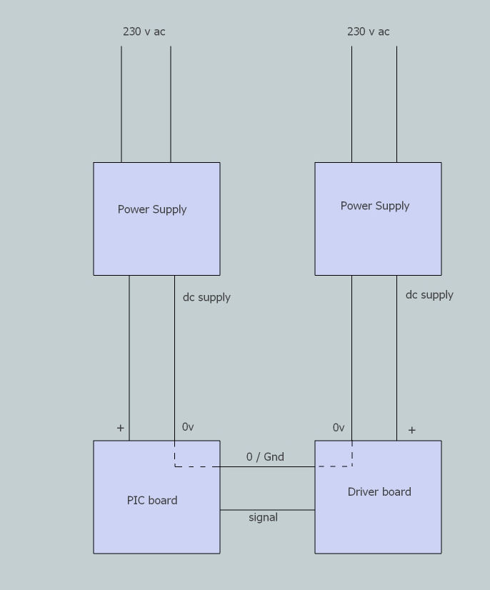

Re: clunks / missing steps - DM856 and single pulse operation
Ok then, here's a connection diagram:
http://i1120.photobucket.com/albums/...om/diagram.png
I'm using this as power supply:
Solderless MB-102 Breadboard Power Supply - Dual 5V and 3.3V DC Jack and USB New | eBay
As it can be used on a breadboard, had enough faffing about with 7805 on their own (too thick legs to fit on a breadboard). Not sure about what capacitors it's using, as it's all tiny SMD stuff.
I'm using the SPS705 unregulated power supply from Leadshine (Zapp) and used it on both the DM856 and the HBS86.
The only other thing is the setting on the DIP switches for the current, I was told by Zapp to set it to 2.1A peak, currently it's software configurable, but I can't connect to the driver as the software package from Leadshines drops the RS232 connection for some reason when I view the config of the driver.
Regards,
T.
What you've drawn look fine to me.
Have you put a decoupling capacitor adjacent to the PIC? e.g. 0.1uF capacitor across VSS and VDD.
Jonathan got the point of my questions exactly right. The driver ground and the PIC ground should be kept separate.
That power board is fine for a PIC assuming you have nothing else loading it; it's good for 700mA and has the required decoupling. Do you have any decoupling capacitor (100nF typically) on the PIC power pins? Shouldn't really be necessary on a breadboard that size (I'm assuming the PIC is on the breadboard) but sometimes not having one can cause oddities.
Otherwise I can't obviously see where you're going wrong.

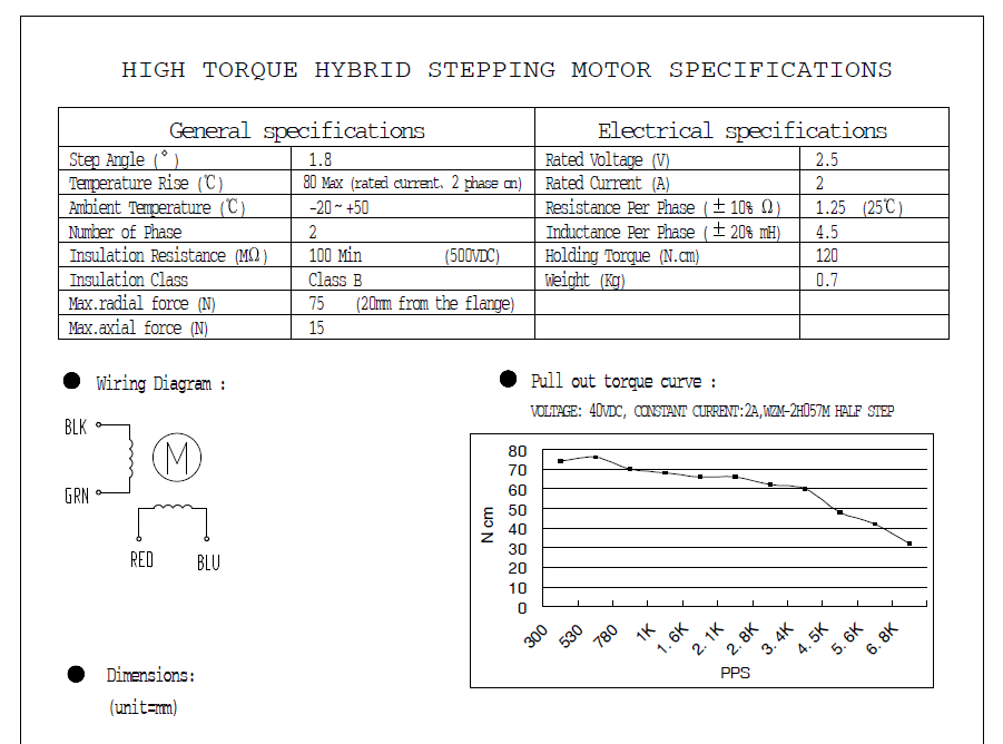

Just to double check the wiring, here's the connections to the motor:
http://i1120.photobucket.com/albums/...ndom/wires.png
A+ BLACK
A- GREEN
B+ RED
B- BLUE
This comes from a spec sheet for the motor itself.
Regards,
T.
