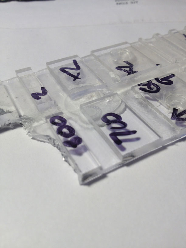

Id say its too fast(rpm)try knocking the spindle speed down by 1000 rpm increments jogging back and fourth on a bit of scrap acrylic.
Re: Melting Acrylic/Plastic
deisel
Agreed - the chipload is too low so you need to decrease the spindle speed and/or increase the feedrate.
Acrylic as a very narrow chip load range and thats why it melts so easliy. I'd be going for higher feed rate first as 400mm/min is way to slow. Try 18000rpm and 900-1200mm/min then play around with both. Thou i'd be going higher on feed not slower. You'll definatly be wanting to at least double your original 400mm/min. I'd also cut with more DOC start with 50% cutter Diameter but it's not unusual to cut at 100% cutter dia.
The type of acrylic also plays a big part to how it cuts.! Extruded can be a pig to cut and Cast tends to be better.

lower spindle speed seemed alot better here are some test results @ 9K 700-800 x 2mm ( im increasing slowly :) )
Attachment 12722
Thanks for the tips

Try increasing the DOC and see if that helps often does. Have the tool under engaged is one the most common reasons for poor finish and excess tool wear.
Jazz is correct on increasing DOC. Also as Jazz posted you really want to work with Cast not extruded. Cutting a lot of acrylic for sign folks and the best I can suggest has for the most part been stated. The only thing I can add is that you want to stay with either two flute or single flute for the best finish. Also doing a finishing pass in the opposite direction will aid greatly in the quality of finish you get (this does include areas where you have not cut all the way through). The only exception to the second pass I have found is when cutting with a V carve bit, than it is one pass and the job is done. -Michael
