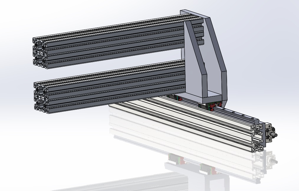

		Hello, im looking to build my first CNC, so i have been lurking around here for a while now looking and reading up. I recently met the builder of SweetDream at the engineering show, who gave me some great pointers and as a result i have altered my design more.
So im looking at building it 500mm x 400mm with 100mm Z axis. Im looking at using SRB20 supported rails and 1604 ballscrews throughout the design. I still need to do more drawing as you can tell ie the rest of the frame below the y axis rails, but if anyone can spot anything that would be great.
The gantry side plates and main spindle plate will be from 6082 20mm aluminium, and the box that wraps round the rails on the x axis will be from 6082 10mm aluminium. The gantry side plates will be joined to the y axis bearing blocks via 60x60mm x 4mm thick aluminium box and inside that i have mounted the ball nut into an aluminium block which is then joined to the aluminium box.

		It will help with advice if you mention what materials you're intending to cut.
Re: Initial Design Check Please
		Sorry my mistake.  I would like to mill plywood,  carbon fibre and aluminium.
Im looking to make the frame it will sit on out of 50mm steel box. Just got to find a local welder.
Trev
		Like Ian asks materials to cut will help but I've got a few why's.?
Why supportedround rails.?
Why 1604 ~(Do you mean 1605 ballscrews)
Why that size Profile.?
Why is there No bed.?
Got few a suggestions as well. Would make it so the Gantry sit directly on the bearings rather than between the bearing with brackets. This will make it easier to build and setup along with making accurecy easier to find. The way you have it will be much harder to setup without causing binding to bearings etc than sat directly on bearings.
Don't wrap a box around the gantry it doesn't add any strength really and makes setting up harder with bigger potential for causing binding bearings. The extra weight just means less potential acceleration.
Use thicker Rear Z axis plate as 10mm isn't enough and any resonance here will transfer to the finish quality.
Better if you can get the ballscrews down the side out the way as being stuck up high like that they are open to being lent on or caught with material when loading etc.
You don't show any lower frame so it's hard to tell what you thinking here but just bare in mind the base is the foundation for everything else so if this isn't accurate or strong it will impact the rest of the machine in a negative way.!!

		Hi thanks for the reply
I went with the supported rails due to profile ones being out of my budget
yes they are 1605
i went with that profile as it lined up nicely with the holes in the supported rail, making it easy to join the two.
Sorry i know having no bed and lower frame makes it tricky to check, its just i wanted what i had drawn checking first in case my design is junk.
With regards to mounting the bearing blocks to the gantry sides, do you mean by bolting a plate to the bottom of the gantry side and then the bearings to that, forming like an upside down T shape?
Ok i will make the plate 20mm and remove the rear plate on the gantry. I saw the idea originally on the Sweetdream CNC which did seem like a good idea.

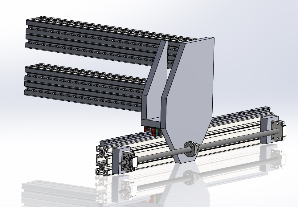

 Well if you haven't bought them already this is worth re-thinking. Profiled linear rails from china are now quite cheap and the difference isn't worth not using them.
Gotty101
			yes they are 1605
 Well this again is worth reconsidering. 5mm pitch is fine for harder materials like aluminium but does restrict the speed for cutting woods and plastics correctly. 10mm is a better balance and while more biased towards softer materials it's still gives more than capable resolution for aluminium.
If you connect to the screws with timing belts, which I suggest you do for resonance reasons, then it's an easy ratio change to increase resolution if you ever find your mostly cutting harder materials which need torque and resolution.
Gotty101
 Ok ye thought that may be case but layed flat like that weakens the material unless it's well supported from below which could be ok for the base if supported from below but the Gantry has is designed can't be so positioned like that so it will be weak in one direction. I'd think about using square rather than rectangle and beef it up a little, say 80x80 or 90x90, or go with "L" sahpe setup like I've posted on forum many times which is stiff in both directions.
Gotty101
 Something like this I knocked up to show both screws and gantry but with a little more bracing etc. There's many ways but sat on the bearings is strongest and easier to do.
 Argh but he's only used to taking Pics of UFO's and knows nothing about CNC.! . . Lol . . (:joker: He's a mate not being rude.!!)

		Thanks guys for the help so far. ive scrapped and started from scratch. Ive based it heavily off the pics you posted Jazzcnc, they where a great help and have used 20 Hiwin rails as suggested. Ive done everything in 20mm ali and doubled up on the aluminium profile now. Ive still got a fair bit to draw like the lower frame and bed and stepper mounts with belt drives, and y axis ball screws. Unfortunately im off for a short break so im going to have to go cold turky from solidworks for the next few days.
im going to have to find a good source of 20mm plate next. I was talking to a close family friend about my project who is an ex tool maker so now i have access to his machine shop now which is a great help.

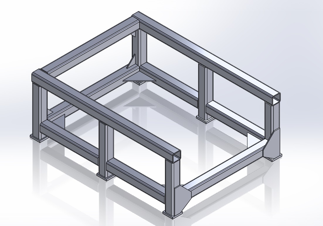

		Hi guys, ive done some work redoing the design as per the suggestions. The lower frame will be made from 50mm square steal box with 3mm wall. The total z axis travel is 120mm. Ive not drawn the bed yet but it will sit in the space at the bottom of the frame but also be adjustable upwards .
Ive still got some things to draw like the z axis screw and stepper ect and x axis stepper mounts.

		You need some diagonal bracing on the base. How are you going to ensure the rails are on the same plane? There doesn't seem to be any adjustability in there.
irving2008
 He can shim the Profile between the box section. This will work well and be easy enough to get on same plane with careful setup.
Trev. Design looks ok but I'd build the frame differant regards how section is arranged.? Make the the legs extend down to the floor this will make the welding easier and give more support to the uprights. See pic knocked up to show what mean.

		Thanks for the replies. My dads got the lower frame priced up built from a company who does work at his company. They gave the choice of carbon steal or aluminium in 50x50x3mm. I will see if i can have the design tweeked. I know they will do a first rate job as they do all sorts of precision work.

 I think you will find mild steel is sufficient for the frame and will be much cheaper than aluminium, also the extra weight will be a benefit when the machine is working.

 Agree with Eddy and aluminium tends to crack around welds from vibration over time so wouldn't use it for the frame. I weld aluminium often and wouldn't build the frame from it unless weight was critical and even then I'd use much thicker aluminium than I would steel.

		Hi Jazz, thanks for the reply. Ive altered it and hopefully im getting there. I am planning on using thin aluminium angle to build up a shallow surround. Im planning on using mist cooling and not flood.
http://i120.photobucket.com/albums/o...2/BedFrame.pnghttp://i120.photobucket.com/albums/o...ithGutters.pnghttp://i120.photobucket.com/albums/o...cnc2/Assem.png

		Hi Jazz, does that look ok, the t slot plate will be bolted directly to the adjustable steel frame. Then gutters can be added to the steel frame if im going to be running coolant or not, these will be just aluminium angle.
Gotty101
 Yes but personally I'd have the rectangle cross pieces vertical so they provide more strength against deflection. Have a Flat base frame then sit Aluminium onto it then just make thin sheet surround which fastens into sides of ali plate.
		Thanks again Jazz, ill update it. I cant wait to start the build, especially when you look at the build logs on here.
