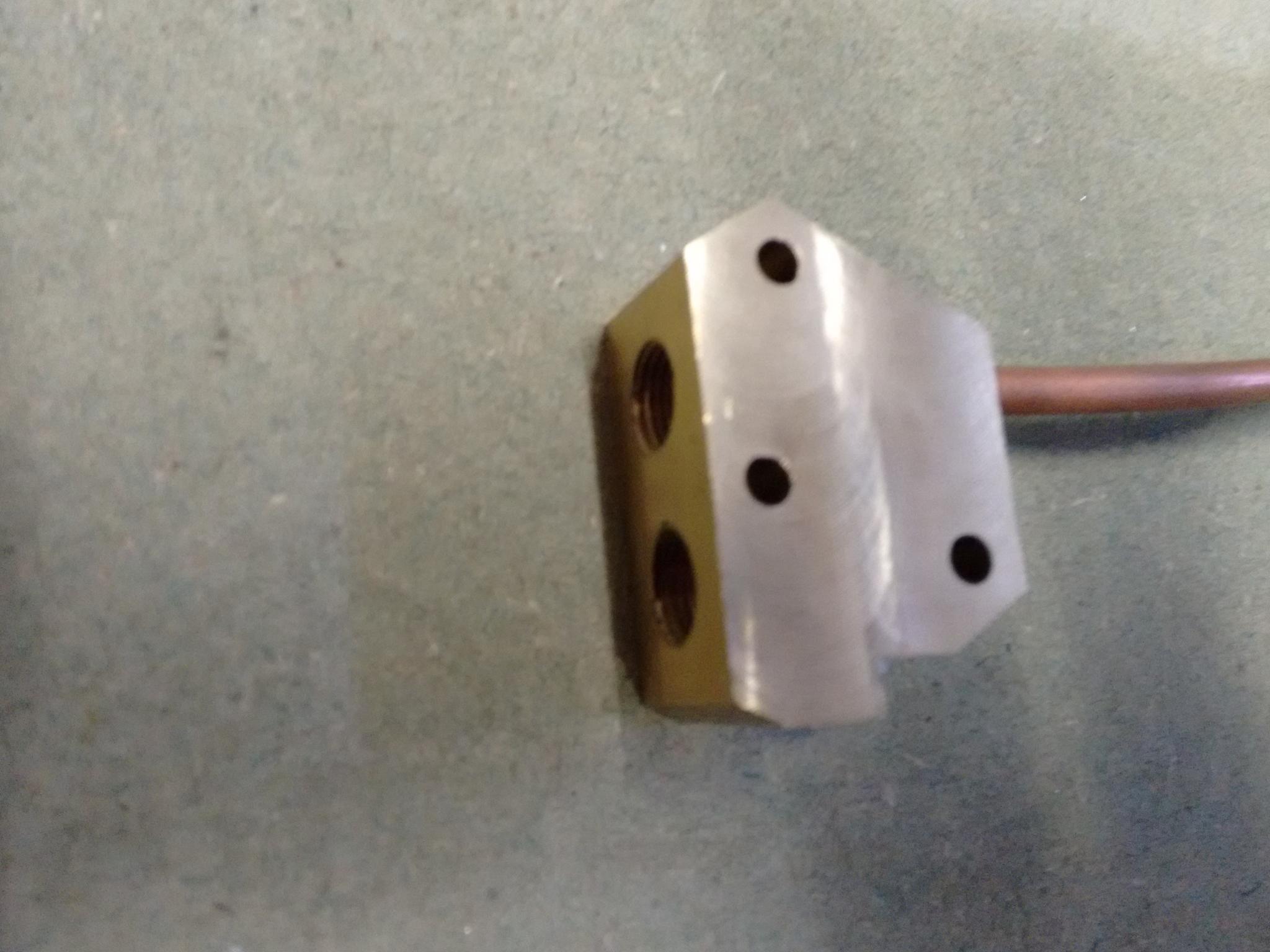

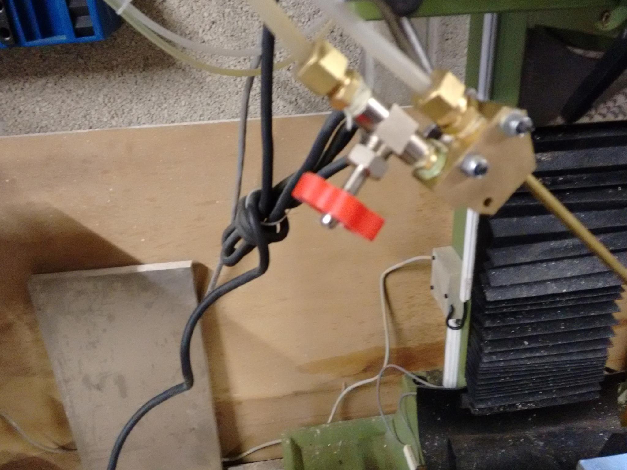

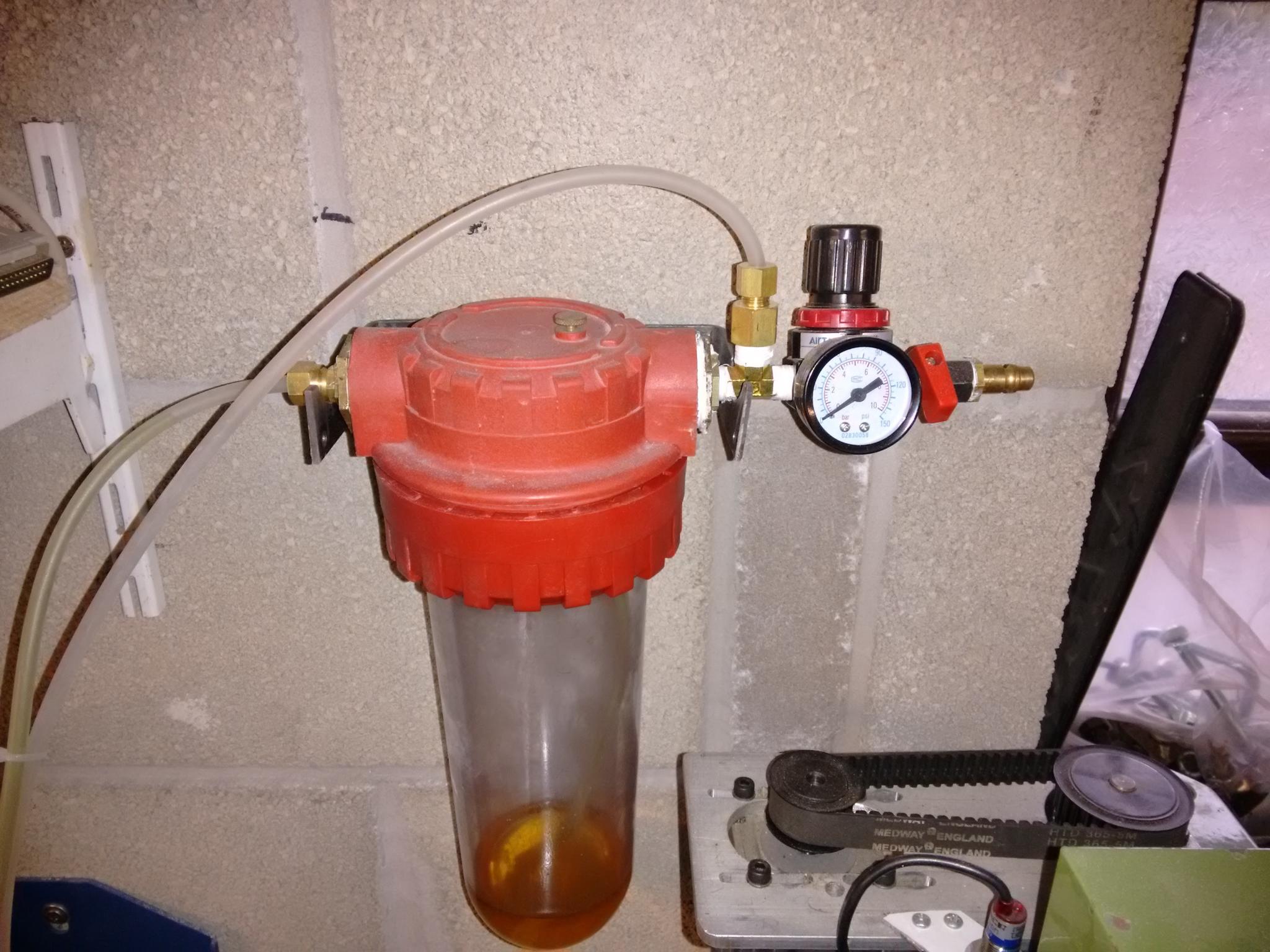

Dave I built a few of these just my version of a copy from a well proven design that put droplets in the air stream.
The manifold was made from a hex piece of brass bar.Attachment 17996Attachment 17997Attachment 17998
Attachment 17999

Dave how have set it up. Did you see the dxf post #6 I use one reg on the compressor and one into the container. You do need a needle valve as well.
Re: Potential coolant system : Will it work?
Different shape but essentially the same, I followed dimensions I found online, 2.2mm through-bore with 1mm fluid bore, I have a flow control on the fluid inlet, one regulator on the fluid feed and one on the air feed.
I think the nozzle is too small at 0.6mm, I will drill out to 1mm and try that - it should reduce air velocity and increase droplet size hopefully.
Edit
Just been looking at the Original Fog-Buster web site an they have no nozzle at all - just a plain tube so I might just cut the nozzle off and try that.
