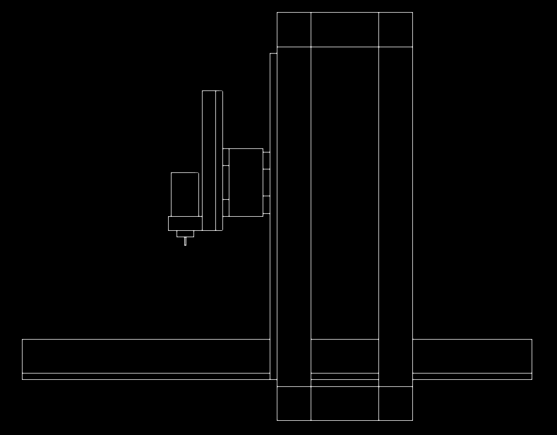

		Z travel 1meter on a moving gantry?  I can't imagine it milling steel let alone titanium.
Get some drawings down then post them up for better advice.

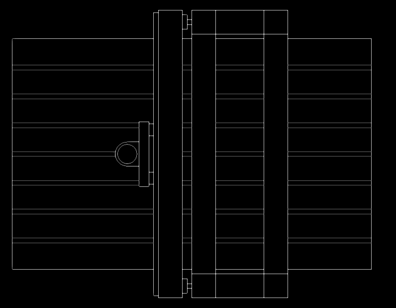

The problem with a machine where you move the work around is you loose working area. Although that machine looks great it only has a working area of 500x500mm.

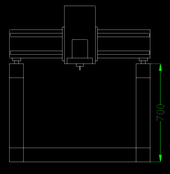

I was thinking I would have a 5axis head attached to a normal xyz gantry machine like this http://www.5-axis.com/.

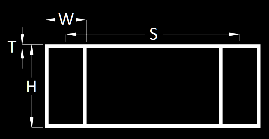

I'm thinking of designing the gantry like this, cross section
Attachment 16415
The Z axis would probably run down the middle.
Anyone know how to work out the deflection? I'm thinking If you had a load of 100kg at 1m thats equal to 333kg with a separation of 300mm. Then calculate the bending deflection of one beam with 333kg, then multiply that by 3 to get the deflection at 1m.
To be clear I was thinking the frame would be 100x100x5 and the gantry 200x100x8 but only because those where readily available sizes. If I have to special order some bigger then so be it.
 To be honest I would avoid any box section for stiff areas of the machine like Gantry, Z axis etc and look more towards plate and weldment setup then have the structure machined flat and true. This is the only way you can control strength and resonance properly.
This can and will get expensive fast.!! . . . After all There is a reason why the Big boys toys cost so much money.!!
It's very easy to get carried away at this design phase and create a monster CNC but it's all different thing when the fat lady sings and reality hits you in the balls.! The reality of costs alone sting like a B@~~rd for Strong/heavy high quality machine and thats without getting Silly with 5 axis heads etc so to quote Ali-G try to "Keep it Real" otherwise your doomed to dissapointment from the start.:dispirited:

		Hi Rufe0
These are my thoughts for a machine like that -
1.  Double gantry, as per your drawing, and the machine I linked to, and MechMate:
https://www.youtube.com/watch?v=NakBfccU2dc
and Jonathans machine a while back-
http://www.mycncuk.com/threads/6484-...strong-machine
2.  Box Z, as per the link machine and Jonathans using 4 rails on the Z
3.  Twin ballscrews on the X,Y and Z axis to avoid racking and allow the bearings to be close to maximise travel.  Z twin ballscrew is to help with lifting the weight of the 1m axis, plus keep the loading central to the spindle.
4.  Hiwin rails all round, 20mm or bigger.
5.  Height adjustable bed with vertical rails at each corner -
Manually
or hydraulic using 1 ton bottle jack in the centre
or ballscrews
Which ever option you must be able to 'lock it down' before cutting - like you would lock a quill or lathe saddle once in position.  Maybe thick angle brackets around the edge to nip up and hold it fast.
The alternative to height adjustable bed is to use bedplate mounting blocks (scroll mid/bottom):
http://cnzbzg.en.alibaba.com/product...eers_cube.html
6.  Spindle(s) capable of high speed medium torque [alum, wood], plus very low speed high torque [steel].  Maybe via a single spindle linked to a separate cartridge spindle with pulley drive to give different ratios.
7.  Automatic Tool Changer (air powered), optionally with ATC carousel.
In terms of your calculations the bending stiffness calc is straightforward (load one beam then half the deflection for 2) but that only accounts for the Z axis weight and the plunge stiffness.  For the sections you are talking about (200x100x8) etc this will no problem for simple bending.  However, where you will come unstuck is having enough torsional stiffness when cutting in X (gantry moving forward or back), especially at 1m extension.  I don't think hand calcs would be possible on a double beam in torsion so you need an FEA program if you want to work it out.  I notice Fusion360 has FEA built in and this is 'free' so worth a look.  This will give you deflections once you have learned how to use the CAD part of the software.

		Indeed indeed, so just brainstorming what my options are now. Thinking the height adjustment on the bed is abit of a hassle I could do without. But I still want to be able to work on tall items. So that leaves me with a very tall machine, would have to use waste boards or something to space the work up, maybe a hassle maybe not. Something like this.
Attachment 17148
I'm wondering if there would be a better way though. I had an idea... it's basically a fixed gantry except the bed is fixed and the gantry moves(not shown but bed would sit on supports at both ends). I think it would look really cool, like some sort of scanner out of a sci-fi movie. Would offer better access aswell and I think I could make it significantly lighter. * not a proper drawing just an artists interpretation * shown with spindle hanging out the front for ease of drawing, obviously it would be a dual gantry with centralized spindle.
Attachment 17149Attachment 17150Attachment 17151
I think both would suffer from strength issues, especially as there is no diagonal support to stop skewing.
Any thoughts?

		Why don't you put the Z axis between the gantry uprights?  It would put the C of G much closer to the center of the gantry bearings and you'd lose much less cutting area at the back end of the bed.

 Thanks which one are you referring to? Can you do a drawing?

 Ah I think I get you, in the real design the spindle would be centralized to the gantry, not hanging out the front.

		Yes, that's what I meant :encouragement:
