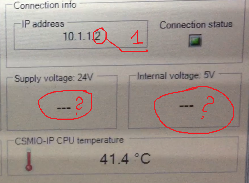

Hi Guys
Got question regard that module.
So far I only done bench test with basic circuit including:
Panasonic CF-19 Toughbook - win7 64bit
CSMiO-IP-M
Motors Nema 24Hs39-3008D 4.2A 8 wires in Bi-Polar Parraller
Driver DM 542A Longs (1/4 steps, 1/2 holding current)
42VDC PSU - torus trafo.
1. Why voltage doesn't appear in 5V and 24V box?
2. Motor stalls above 1.5m/min (5mm ballscrew pitch, gear ratio motor20/18screw, 1/4 miocrostep - about 177 steps/rev)
I had the same thing with nema 23 motors on bench but in machine they reach 5.1m/min - scratching my head why?
Max motor speed 1500mm/min (free spinning)
https://www.youtube.com/watch?v=HFFpDxwv3cQ

Why the Voltage isn't displaying I'm not sure it could be the plug-in or PC. Make sure your running Mach3 as Admin.

Thanks Dean
Those drive meant to be digital 'DM' but they are fake (they do not have autotuning like Leadshine) dodgy ebay seller:(
Only getting 1.5m/min on bench, on Machine 5.1m worst axis, 7m easy on Z, all with genuine digital drive.
Motor wired as described - Bi-Polar Parraller (8 cables)
Mach runs as Admin, tried both laptop same result - seen video without those reading
Attachment 20140
