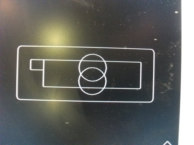

I have got a very old version of AutoCAD loaded on my CNC computer, which has no unnecessary software (networking etc), so the easy way of explaining my problem is to start with a photo of the screen
Attachment 17787
What I am making is a harmonica case. The inside cutout is two rectangles and two circles. I want to end up with a pocket which is the combine of the four shapes. I can do the drawing in Coreldraw, and weld up the shapes, but when I transfer it to the CAM program (EstlCam) it produces a very 'steppy' outline, which is no use. I have to export the drawing to a .dwg file with Corel and then open it in AutoCAD and export it as a .dxf file to go into Estlcam. Somewhere in this process it loses the continuity of the shape.
How do I make the four shapes into one outline ?

I have got past the stage of creating the shapes I need. Now I find I can't make them into a dxf file to put into my CAM program. All I get is the outer rectangle. I attach a copy of the dwg file, if anyone can help. The inside shape was created as a REGION and then made an outline with the UNION command.

Re: Help needed with AutoCAD R14
cropwell
Thanks Clive, but I was hoping to find out why I could not do it,
Because it's a REGION.
Explode the REGION, and use PEDIT to Join the lines into a single polyline.
Always save as V12 .dxf, for best compatibility.
Ger21
Thanks Ger, I have sorted it now. I must admit to my ignorance in using AutoCAD. I need a good tutorial and the timeand brain energy to go through it.
I am using AutoCAD from the '90's R14, so saving as anything other than a .dwg is not an option, and V12 is not in the export options list.
BUT I did what you said (I suspected it was the REGION problem) and it worked after a couple of fumbling attempts.
