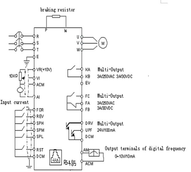

		Re: Installing Huanyung VFD on Heiz Zero3 Controller
		Its very simple.
First- you dont connect the VFD 0-10vdc input  to the LPT port.
 You connect it via separate cable to the breakout board of the machine which has to have dedicated output for spindle speed control with a trimmer to adjust voltage. if board is good, that would need a separate small 12vdc 0.2A transformer to be connected to board.
On the VFd side typically VI is +, so are you sure about that schematics?  Typically on any VFD i have seen VI is + and from diagram ACM must be the common, so double check that. Read manual cause may be  depends if you have changed somewhere  parameter "sinking" and "sourcing" and that changes. Depending on what region is set the VFD i mean that could change and be oposite, so take care and set it for EU. Cause maybe line  HZ and voltage  input  is also not set right.
So question is:
what  breakout board you have on your machine. In breakout board manual it is clearly stated how to connect to VFD.
If the breakout board lacks 0-10VDC output for spindle, then you will need a separate small board to do that. I will tell you from where and model, if thats the case.

Attachment 17720
		Thanks Boyan,
That was my worry. They are two separate units and don't have a common ground. Added to that one is a digital common ground for the start forward and one is an analogue ground for speed, so different I presume?
I haven't received the CNC controller yet so I can't probe any ports at the moment. I'm still trying to figure out what the lower 25 pin 0-10V port is for :confusion:
Gavin
artmin
Gavin
Hey, i missed that. They must not have a common ground or connections to current from other circuits. They must be isolated. I speak for the 0-10VDC. Not for the ground of the box and the VFD ground. Thats why usually they are on separate PSU, the spindle speed  control i mean. Assuming that they have that integrated, you only need to know wher to take + and - from. Nothing more.
In fact you must  measure with multimeter to check continuity  between spindle control - / 0-10VDC/ and VFD - input/ for the speed control/. There must be none.
Start forward on spindle, typically is implemented on VFD by closing a contact. usually the VFD provides the 24VDC and from breakout board side just a relay has to be closed, then the VFD knows to start. Once the relay is off, the VFD stops the motor. Look at the picture of your VFD schematics and you will see it. Anything different from that would be very strange.
