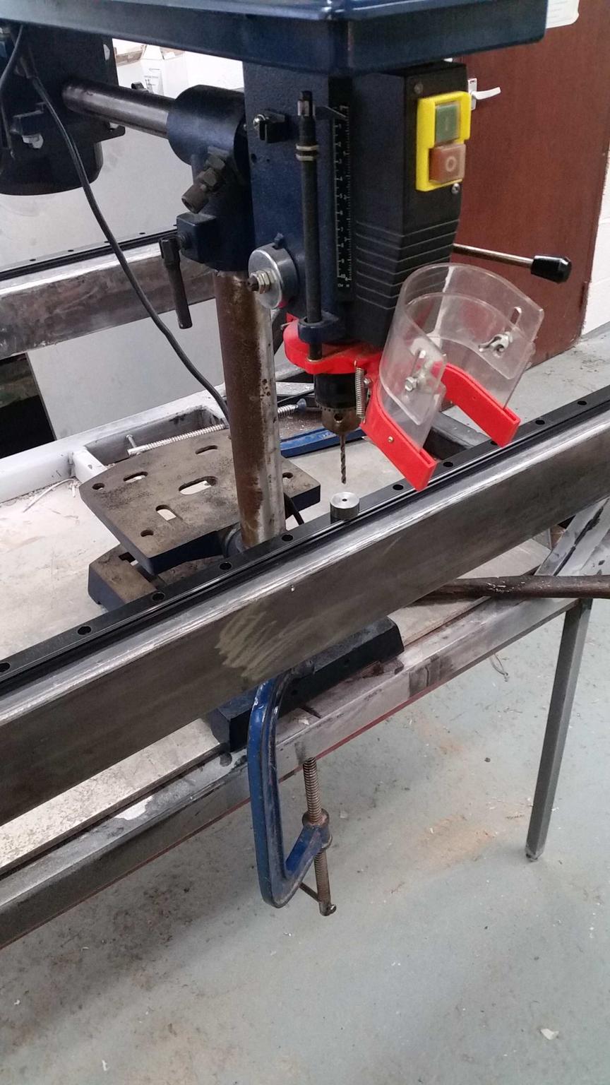

4 Attachment(s)
Re: Comments sought on new build: A CNC Router for RC Gliders and Planes
I've decided to cut the 20mm piece of Ali I currently have to the correct width for the bed which will leave me a 100mm (ish) wide strip 1000mm long (ish) which I can use for mounting blocks. I'll cut a piece 200mm long and machine a carriage block...
Attachment 14339
Then after attaching the carriages on the master rail I'll move it up and down and clamp the rail ready to drill.
I've made a small drill guide to go in the rail so the drill bit is kept at 90° (or as near as damn)
Attachment 14340
Attachment 14341
I've put a piece of 10mm Ali plate on the bed and moved my Pillar Drill on to it to drill the holes, a bit like below...
Attachment 14342
Should make drilling easier (but slower) and I hope not to snap any more drill bits as I snapped one in an end hole on the rail :hopelessness::hopelessness:
Neil, It's obviously best to drill the holes spot on but if they are tapped at an angle it's wasted effort, I like your drill guide so maybe a similar thing is reguired for the tap or maybe you could just open out the drill guide hole slightly.
Funny you should say that....I've just made a tap guide as I had that very thought. Will be tapping them by hand, shant be impatient and use a drill!

Well I've stopped buggering about and started drilling and tapping the first (reference rail) rail. I put the two reference sides of the rails together , as suggested, and I couldn't get a 1 thou feeler gauge to even start to go between them.
I've drilled and tapped about 7 holes so far with my set up as below and all the holes are nicely central with approx 1/2mm each side of the hole so plenty of room for any adjustment if needed.
http://tapatalk.imageshack.com/v2/15...e993f30e81.jpg
http://tapatalk.imageshack.com/v2/15...98492109ca.jpg
http://tapatalk.imageshack.com/v2/15...159e91c2c7.jpg
Tooling plate is on order but will be 5-6 days [emoji17] and now going to order a straight edge from the same place as Silyavski in Germany to make sure that there isn't any (or negligible) twist in the rails.
Thanks for all the comments and suggestions guys!
