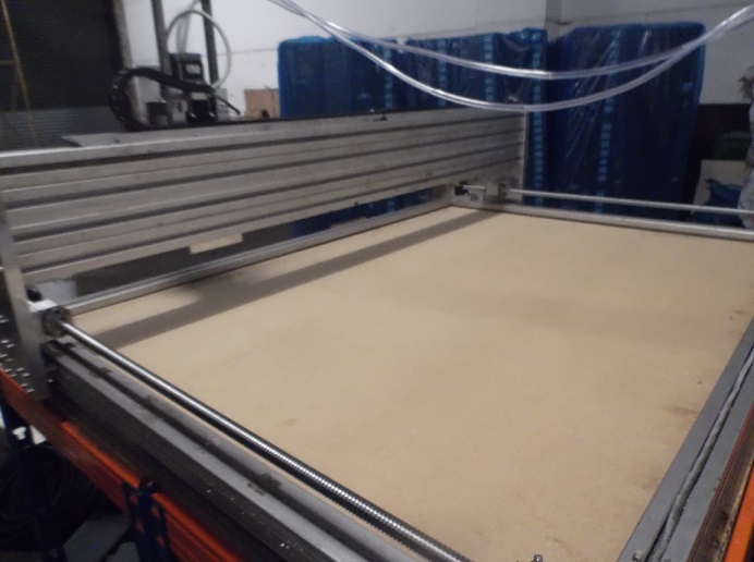

Got my MDF bed on now I need to make it a vac bed ;)
I used an 18mm sheet
Pics or it didnt happen :D

It just fits and I mean just lol I had to tap it in the corners which is the fit I wanted was stressed about this cut as I had to outsource the cut and I knew it would be a bastard luckily I got a friendly a wood guy to help me out.
As soon as you say i want 135.1cm *100cm people look at you funny lol.

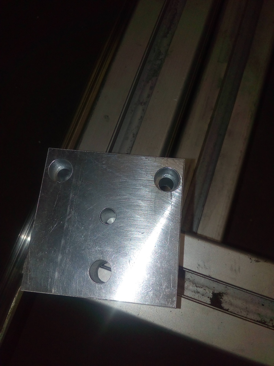

I made a simple clamp today, whatever I made it from came from Krypton lol.
We broke 4 drill bits (With cooling, low speed, bosch cobalts) 3 of them brand new and tried drill press, dewalt and snap on cordless to drill the hole.
We made it about 1mm so far lol, will get photo tomorrow but when I find the kryptonite I need to drill the 2 holes I will have a clamp solution but am going to do a vac bed solution as well.
Wtf! :D
Expensive clamp!
I say kill it.
Kill it with fire

I'm going to ask my engineer mate to drill it he won't charge a lot (Like £5 for both holes) and probably know what it's made of.
