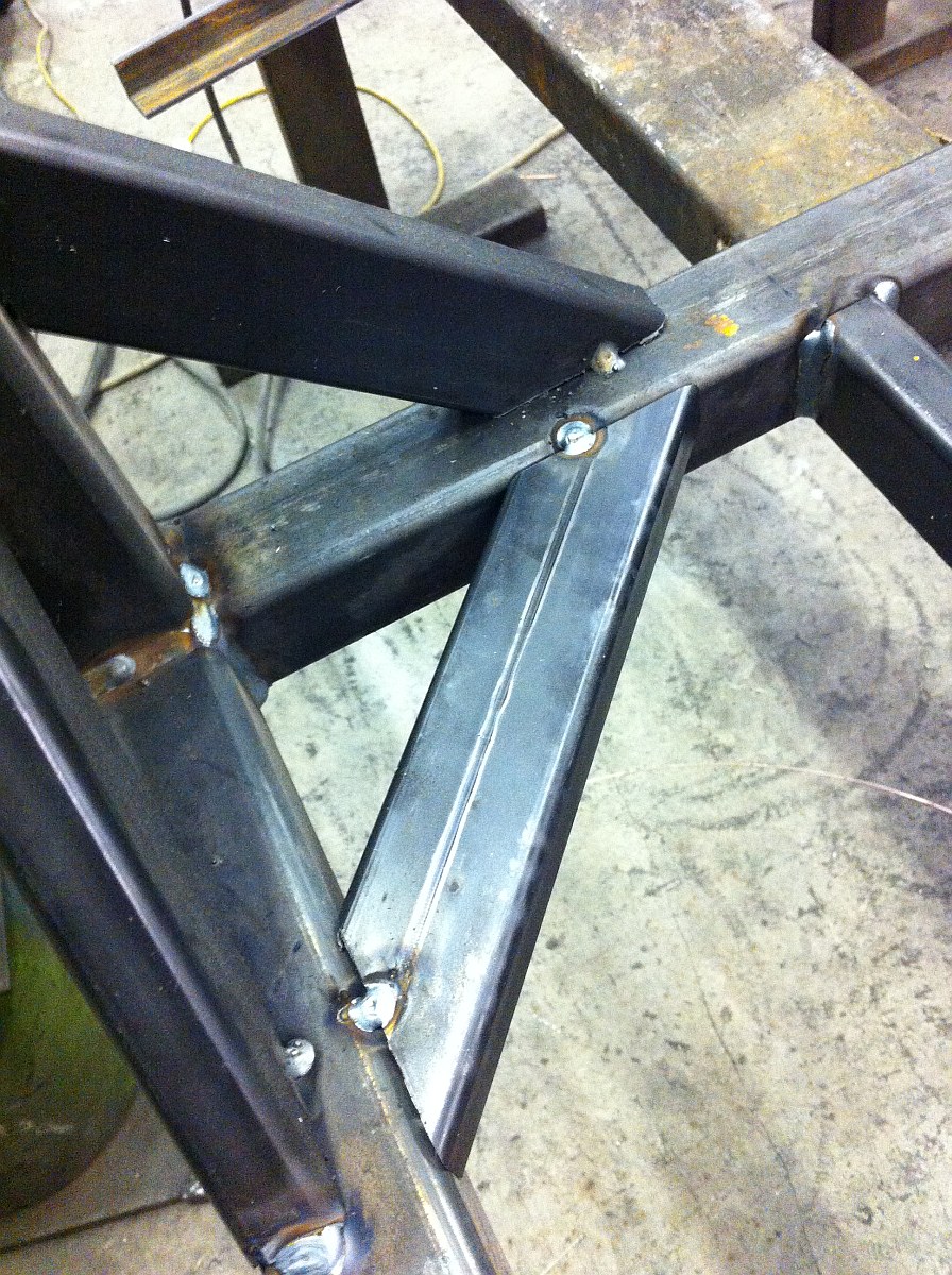

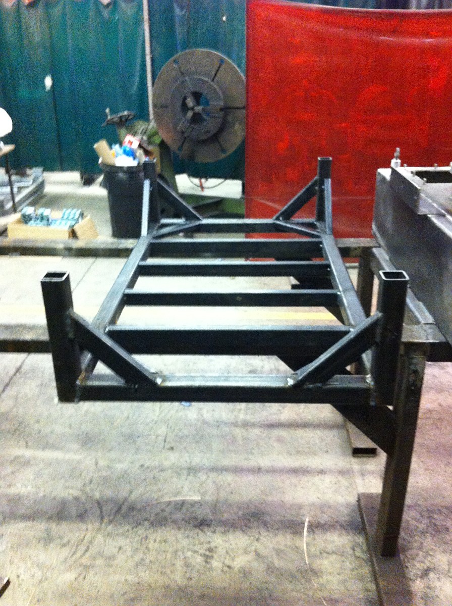

Frame re-design....hopefully I can keep the number of re-draws to below 6 this time. router is held to the frame with 4 off M12 bolts :wink:
Attachment 15722
The frame is going to be mounted to the wall and floor rigidly and adjustably so it can be mounted level and slightly off the wall to get access to the botls holding the router to the frame (I can see a re-design on its way already...) :hopelessness:

Ok so 20 mins on it tonight and ive drilled the holes to mount the 20mm thick Ali base. Just got to notch the front corners and file where the frame welds will be and then the headache of putting the base on, drilling and tapping the mounting holes and then bolting the base on. It's blinking heavy without the base on, still what's another 50kg eh.....
http://images.tapatalk-cdn.com/15/09...77123b9f4b.jpg
Re: Comments sought on new build: A CNC Router for RC Gliders and Planes
Up ended the router, b*@@#r me it's quite heavy!
http://images.tapatalk-cdn.com/15/09...52f28cfe35.jpg
Notched the corners of the 20mm plate and chamfered where the weld beads are. Put the plate on the base and used an 8.5mm transfer punch to mark the bolt holes.
http://images.tapatalk-cdn.com/15/09...29951f4592.jpg
Drilled and hand tapped the plate...
http://images.tapatalk-cdn.com/15/09...6e51df3f98.jpg
Put it on the frame and tightened the bolts up...
http://images.tapatalk-cdn.com/15/09...35c364167d.jpg
And then put foot pads on and put it down on the floor for the time being....
http://images.tapatalk-cdn.com/15/09...661df5b8e0.jpg
