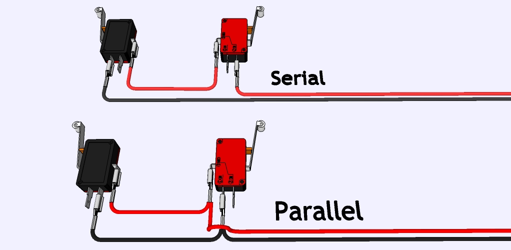

Hi again.
I.ve build the metal box and reorganized everything, and wired the new Bob. It seems the motor problem has gone, but will post a video soon and let you be the judge of that.
Now, I.ve wired the Bob like in the photo attached, and I.m not getting any response from the input pins, from none. P10 to 15 are not seen in automated setup in mach 3.
I should know the answer from the first picture from post 49, but the truth is that I don.t. :(
What am I missing?
Attachment 24648
Re: Help please. Dip switches and mach 3 settings
If you are using the BoB in the picture, you will need the 12-24v input to work the LEDs in the output opto-isolators. It looks like you have a fault there. Also check that the GND connections are all together, except for the PC ground.

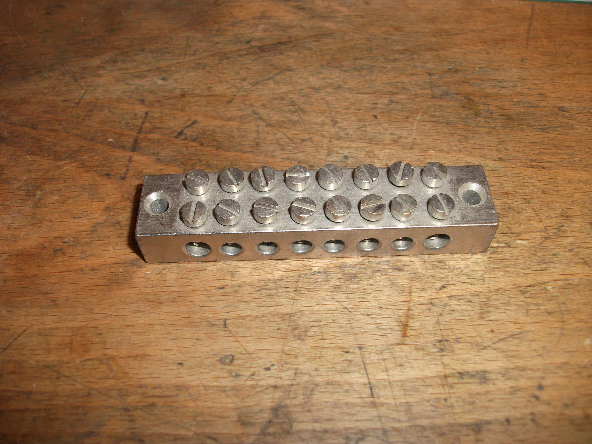

It has the 12 v input, a light is on on the bob at the end of the input pins. It makes a subtle high pitch noise when I connect any of the input pins to the ground pin, but it does not register it in mach 3.
All grounds are together, but now I.m testing it with a single wire.
Pc gnd is not connected to anything.
The only difference with this bob is that it has a P14, to which all I ran all ENBL- from the drivers.
does it still make a noise if you remover the jumper to disable the relay ?
(I can't think of anything other than the relay that could make a noise)
the supply is a 12v transformer, which used to power up some car led.s strips. the multimeter reads 12.1 v. it is the one i use for the enclosure fans.
as i fiddled with the wires, somehow it works now. probably a bad connection from the 12v supply. so Thank you!

What voltage do you have between an input pin and ground with out any switch connected?
Hi.
Sorry for the late reply, the internet was out for a while.
Nice tester. It seems you guys are doing this electronics thing for quite some time. That.s why you.re all so smart. I suspected at first, that you.ve made a pact or something, like Faust, that you knew the answer to every problem I came up with. :P
Regarding the question, if I remeber right, as I measured a lot of connections today, I don.t think it was any voltage between the input pins and ground, but I might be wrong. I.ll check tomorrow, if it helps.
It seems ok so far how the project is going. I just finished a few hours ago to install the touch plate, added some script in mach 3, and it seems to work ok but a bit slow. I.ll change some numbers in there and should be fine.
Next week I.ll set the soft limits, reconnect the x and y motors to the ballscrews, and run some tests. I don.t know, what test I need to check if I get steps missed, but at least I have a plan. :)
