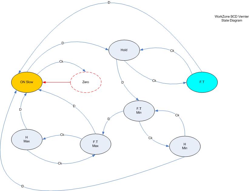

It sounds to me like the vernier is not being set to fast mode correctly my the PIC. and it is mis-reading the vernier as a binary version rather than a BCD type.
Fire up a serial comms package or hyperterminal, if ALL else fails :)
Set baud to 115,200, 8, n,1
Send 'i0' and the PIC (in position X) should respond with something.
;command line interpretor
;Commands: (case insensitive)
;rx - Read - reads and transmits abs position (x=x,y,z,w)
;sn - Sets sample rate (n=0,1,2) 0 =poll mode, 1 = 300mS (normal), 2 = 20mS (fast mode)
;zx - zero vernier display (x=x,y,z,w)
;vn - set vernier type (n=0,1) 0 = old, 1=decimal
send V1 to set decimal vernier, then S0 to set poll mode, then RX and the pic should respond with X00.000: (inches) or X000.00:
(mm). If it returns XH000000: then it is not reading the vernier as a decimal type.
I have one vernier here that has a similar problem , so if I can fine the time I'll look into it. In the mean time, you could try inserting an extra pulse clk in the setfast routine

A quick PIC to PC test:
disconnect serial lead from PC , disconnect vernier from PIC
Run VB application, select correct comm port
Connect serial lead, connect vernier to PIC - you should see a new frame appear for X, Y, Z or W - if this happens the serial port is working OK.
you should see the vernier be reset to zero then depending on type H (for hold) and F (for fast)
Press ZERO (and hold) on the vernier, this will stop the clock signal, after a second or less the PIC will signal the PC to remove the frame .
Releasing the zero will start the clock, the PIC will signal the PC and the PC will issue a reset to the Vernier.
If all of the above works the serial comm must be working fine.
