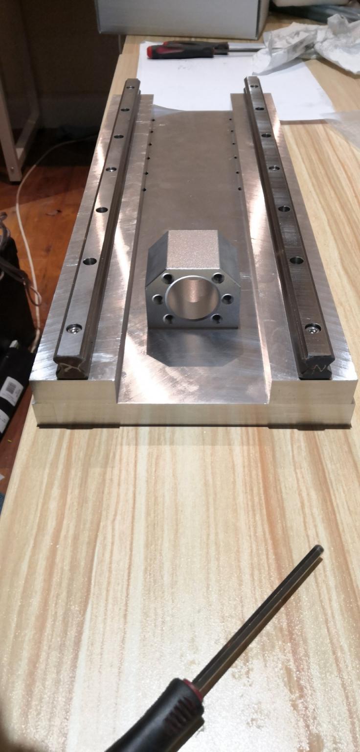

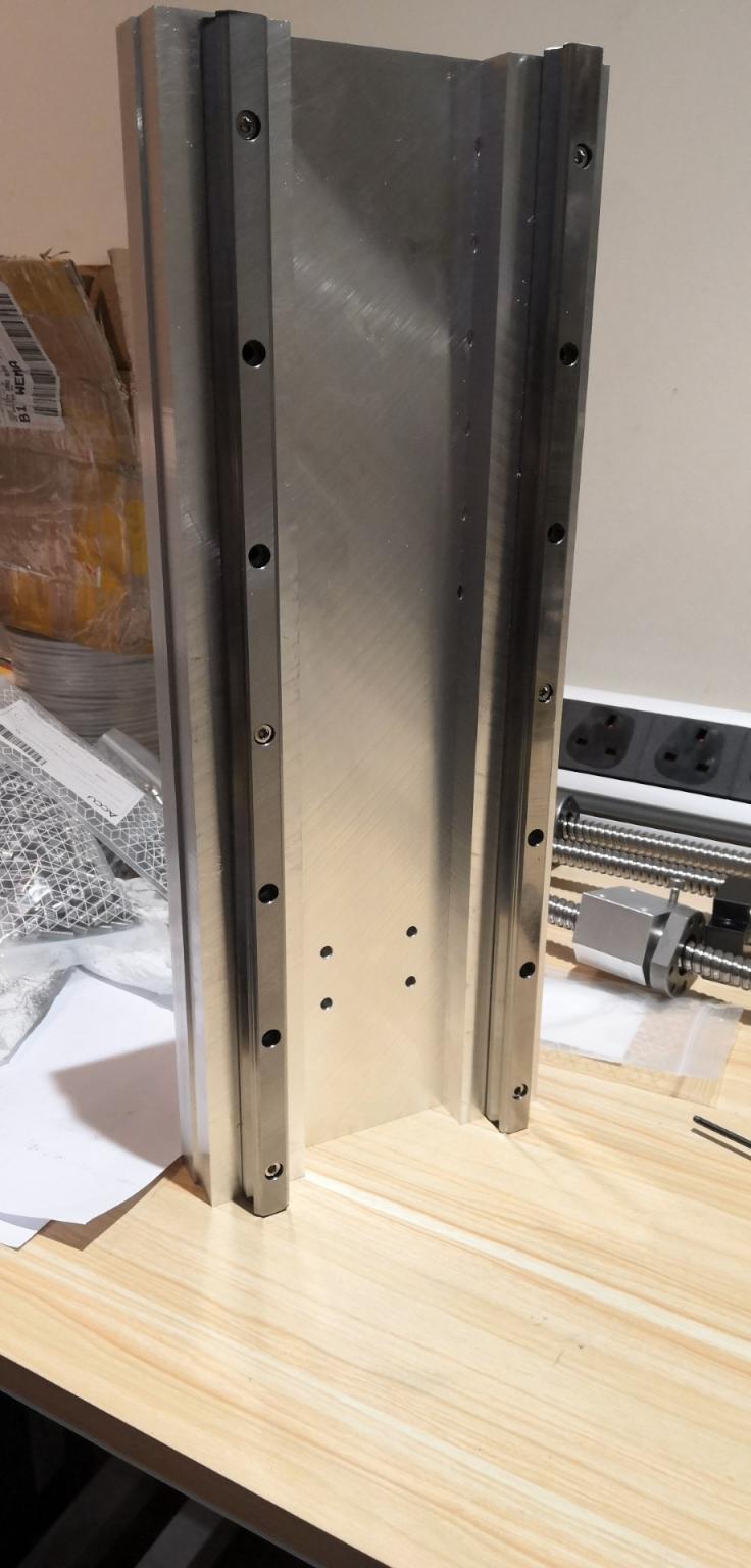

I got back to the project after a break of a few months to work on other things. I ended up pouring epoxy to bring the X rails into plane, then set the master rail straight using a taut wire, microscope and some software as described here:
http://www.mycncuk.com/threads/12966...r-level/page27
I now have both rails mounted and the gantry moves very smoothly.
Attachment 28236
Next step is to fabricate the motor brackets and mount the ballscrews and steppers. I've ordered belts and pulleys and am waiting on these so in the meantime I started to fabricate a stand for the machine. Since the machine is itself a rigid structure this stand only serves to anchor it to the floor at a decent working height, hence the lack of bracing. All 4 legs will be bolted to the concrete floor then the machine will sit ontop on leveling bolts, finally the machine frame will be clamped hard to the stand so that it doesn't throw itself across the room (voice of experience...).
Cut and welded yesterday, painting in silver hammerite today. The more I use it the more I love this little MMA stick welder. welded the 3mm box section mitres at only 45amps! Almost as good as a MIG without any complications.
Attachment 28237 Attachment 28238 Attachment 28239

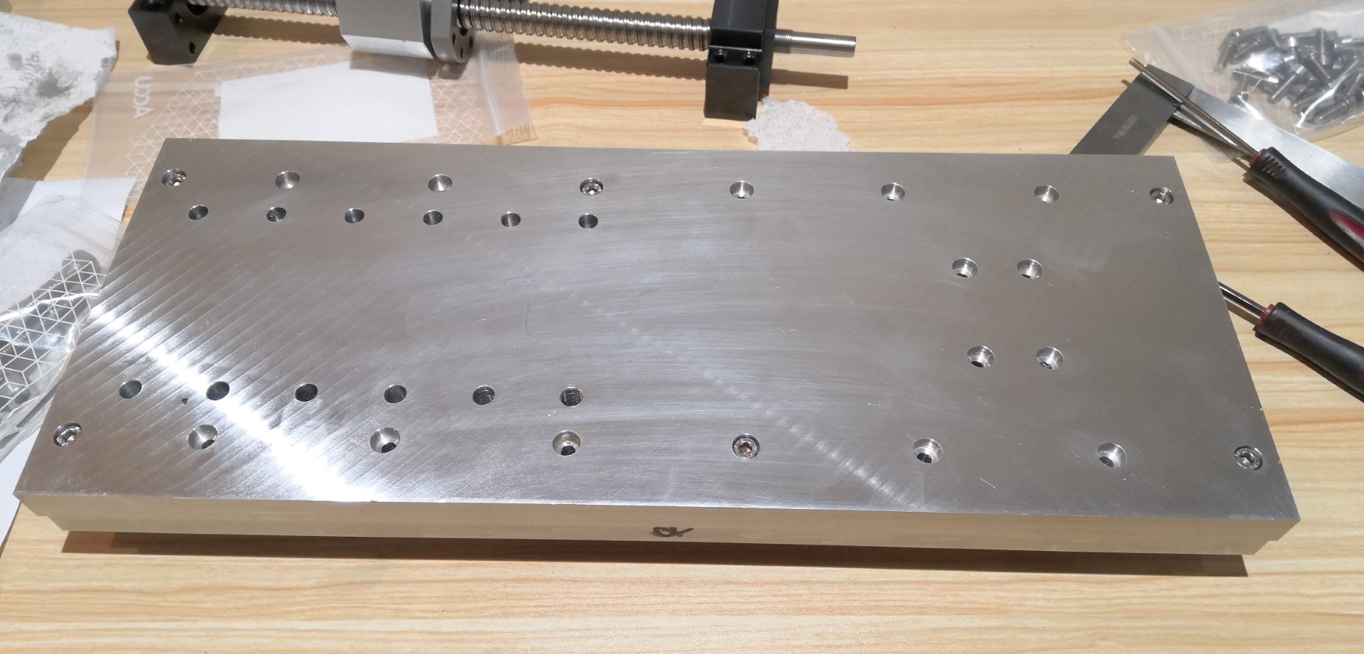

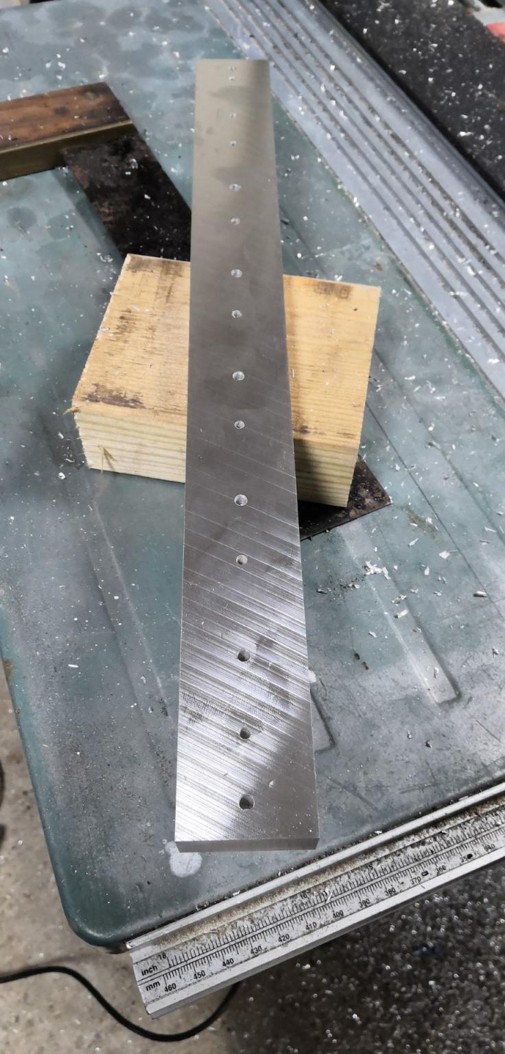

2 Attachment(s)
Re: Joe's 1000x600x200 steel and aluminium router started

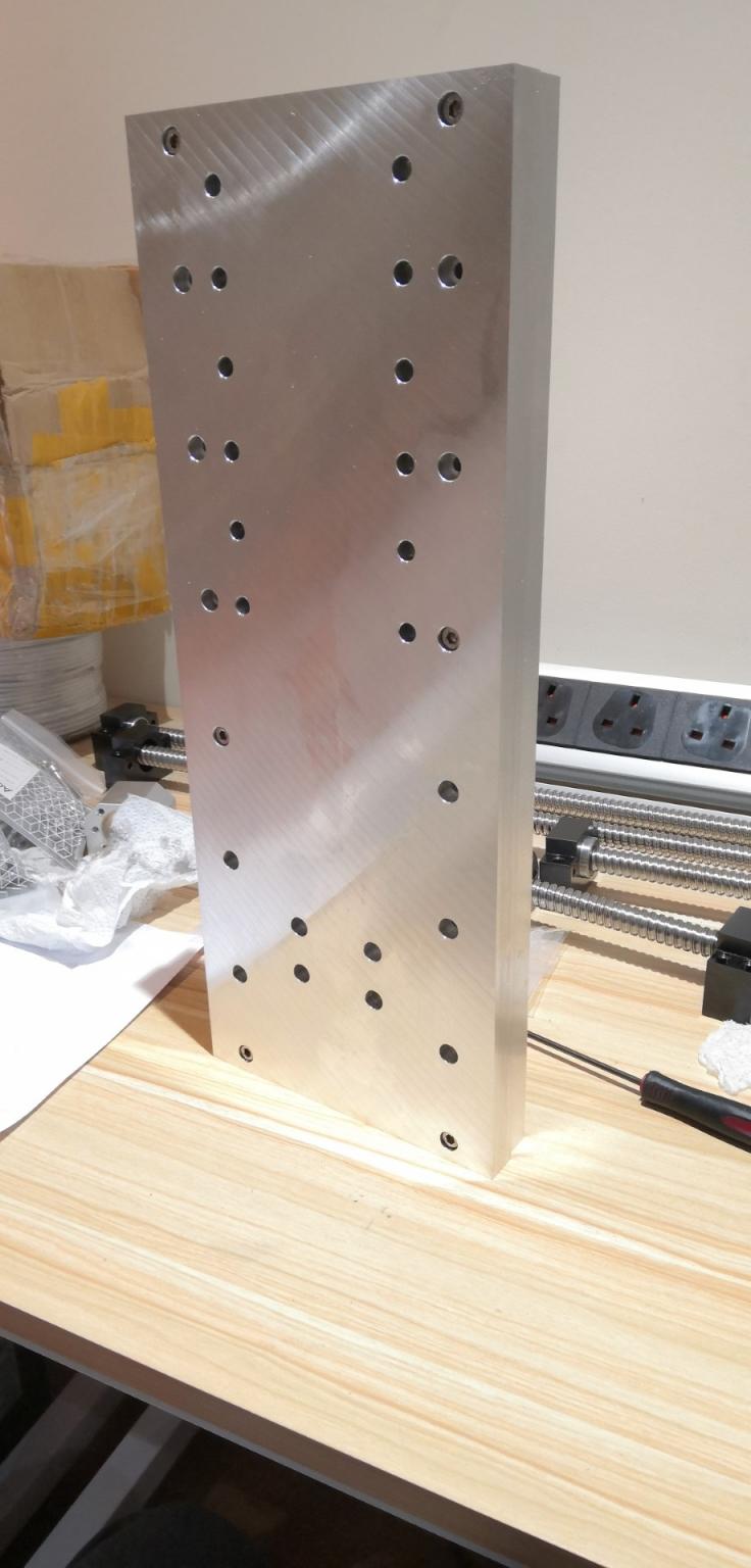

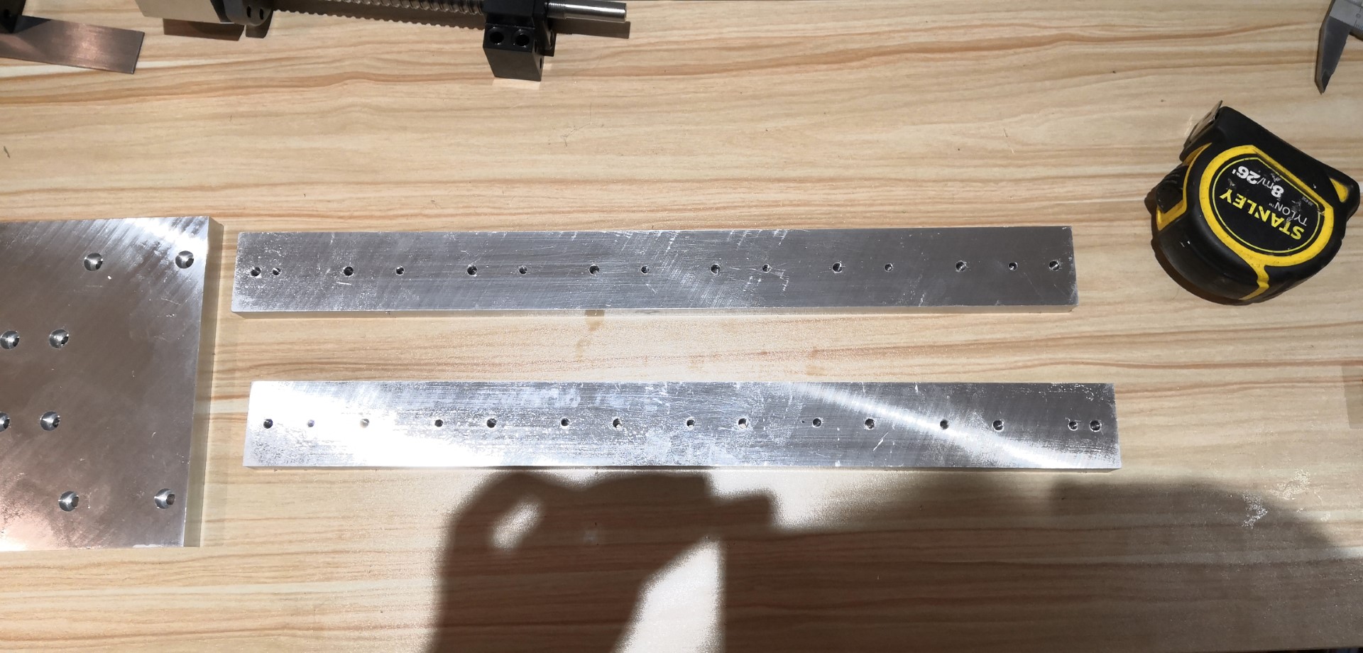

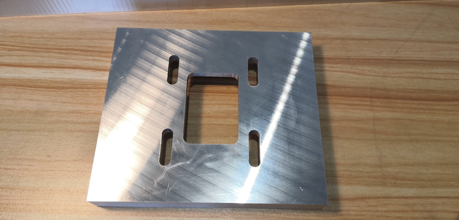

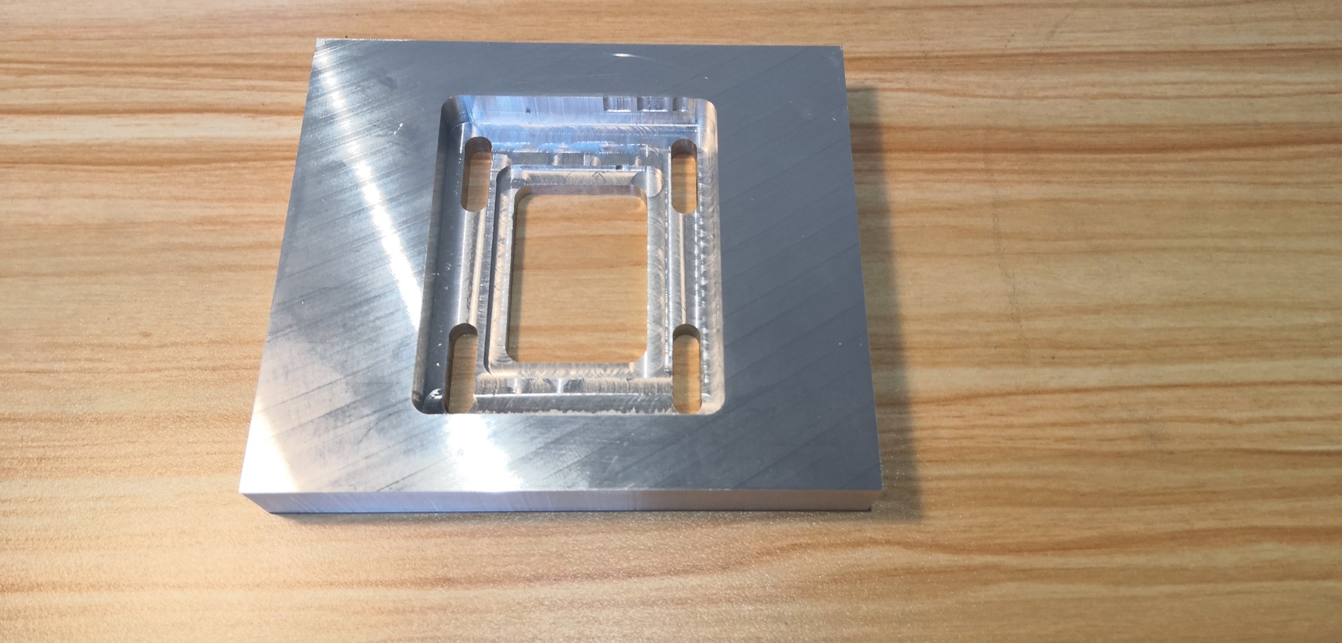

Finished making the last set of plates, these are for the X and Y axis, ballscrew mounting. Hopefully this is the last of the aluminium work on the manual mill. I still need to make some stepper mounting plates but leaning towards doing those in 3mm steel.The white parts are 3D printed standoffs for the X axis ballnut holders, I didn't have any large enough ally stock so we will have to see how they fare. They get clamped between two aluminium lumps so should be ok, if not will replace when I have some bar stock.
Attachment 28250 Attachment 28251

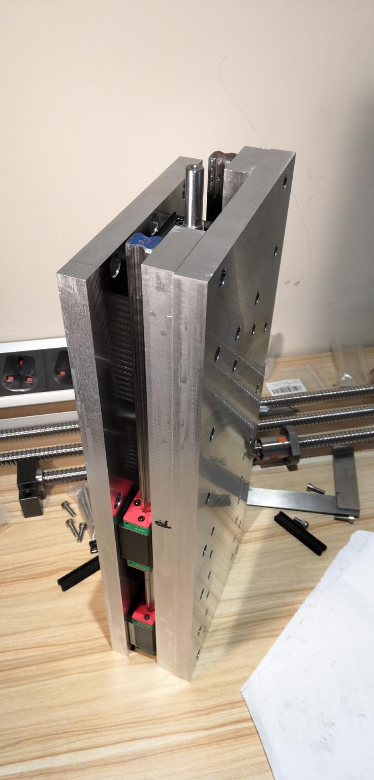

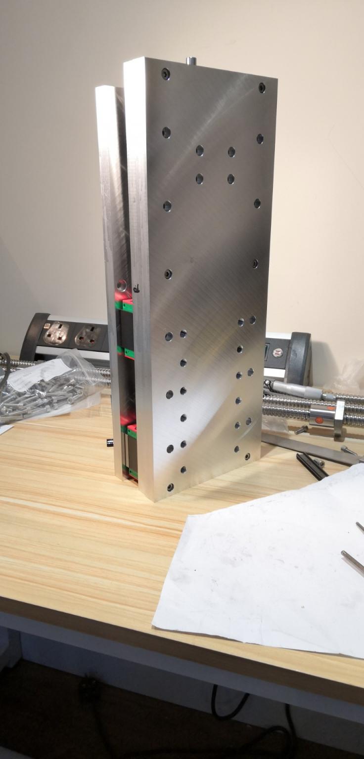

9 Attachment(s)
Was still waiting for the pulleys this morning so decided to align the Z axis assembly and fit the ballscrew. I needed a 0.25mm/10thou shim between the ballnut holder and Z-plate, but it was extremely difficult to get the shim into place as the holder is buried between the rails inside the assembly. A bit of lateral thinking and I used some plastic lamination film cut from a normal A4 laminating pouch.
This stuff has the advantage of a) being quite hard after lamination,b) having a heat activated adhesive. So using an old iron I laminated 4 layers of the stuff onto the back of the ballnut holder, this formed the perfect shim. I trimmed it with a scalpel and cut the bolt holes. Worked really well. Z axis is now complete apart from lubrication points. These are a pain with the nipples supplied with the hiwin carriages and the ballscrew so will need some thinking.
Attachment 28265 Attachment 28266 Attachment 28267 Attachment 28268
Just as I finished the Z the delivery guy turned up with my belts and pulleys, so I spent a rather boring couple of hours, boring, reaming, cross drilling and tapping 8 steel pulleys. All done now. I only installed one M5 grub screw per pulley, each shaft will have a flat on it, hopefully this will be sufficient. I could do with some longer grub screws, or maybe just use an M5 bolt given the low RPMs.
Attachment 28269 Attachment 28270 Attachment 28271 Attachment 28272 Attachment 28273

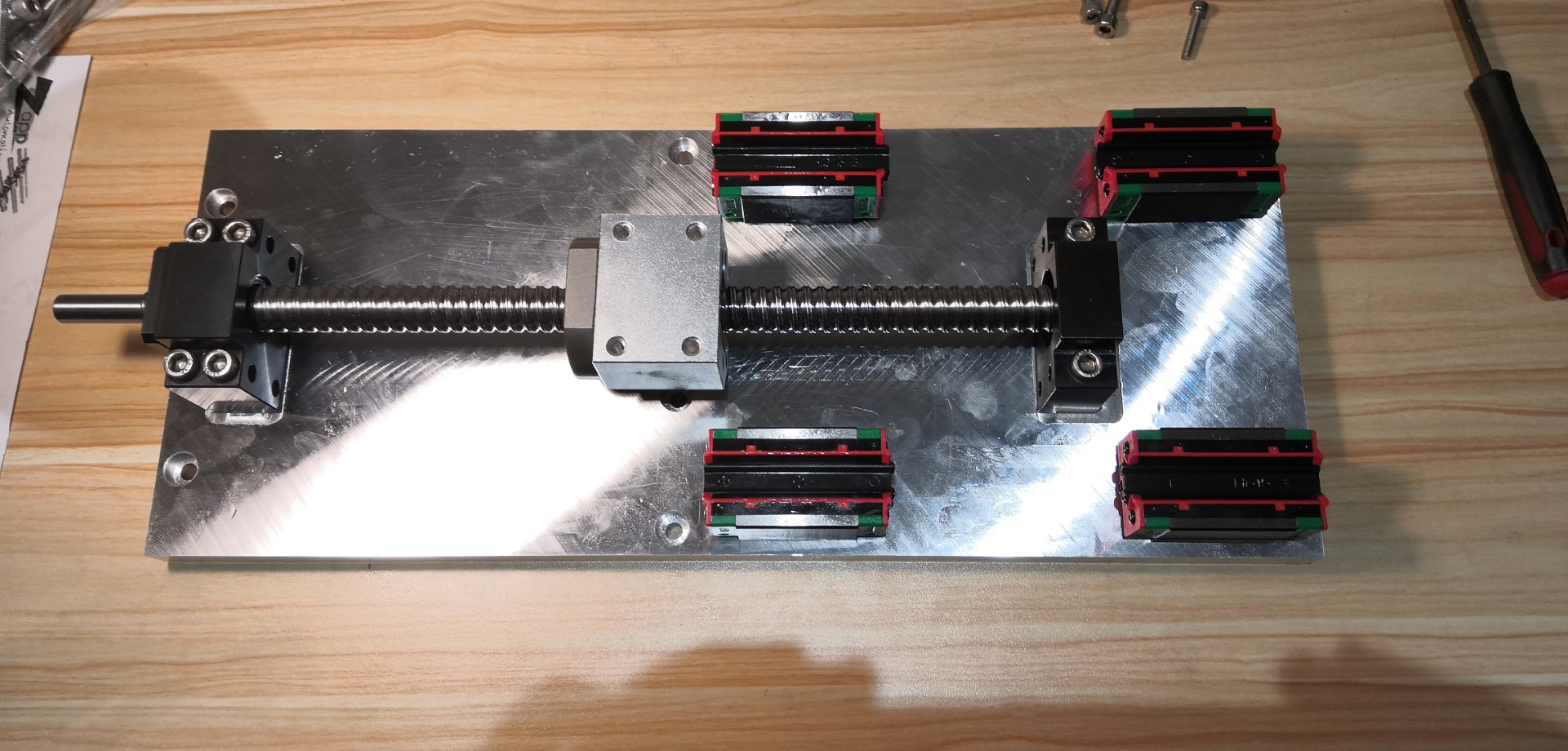

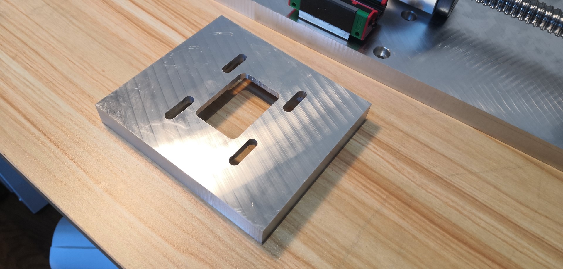

4 Attachment(s)

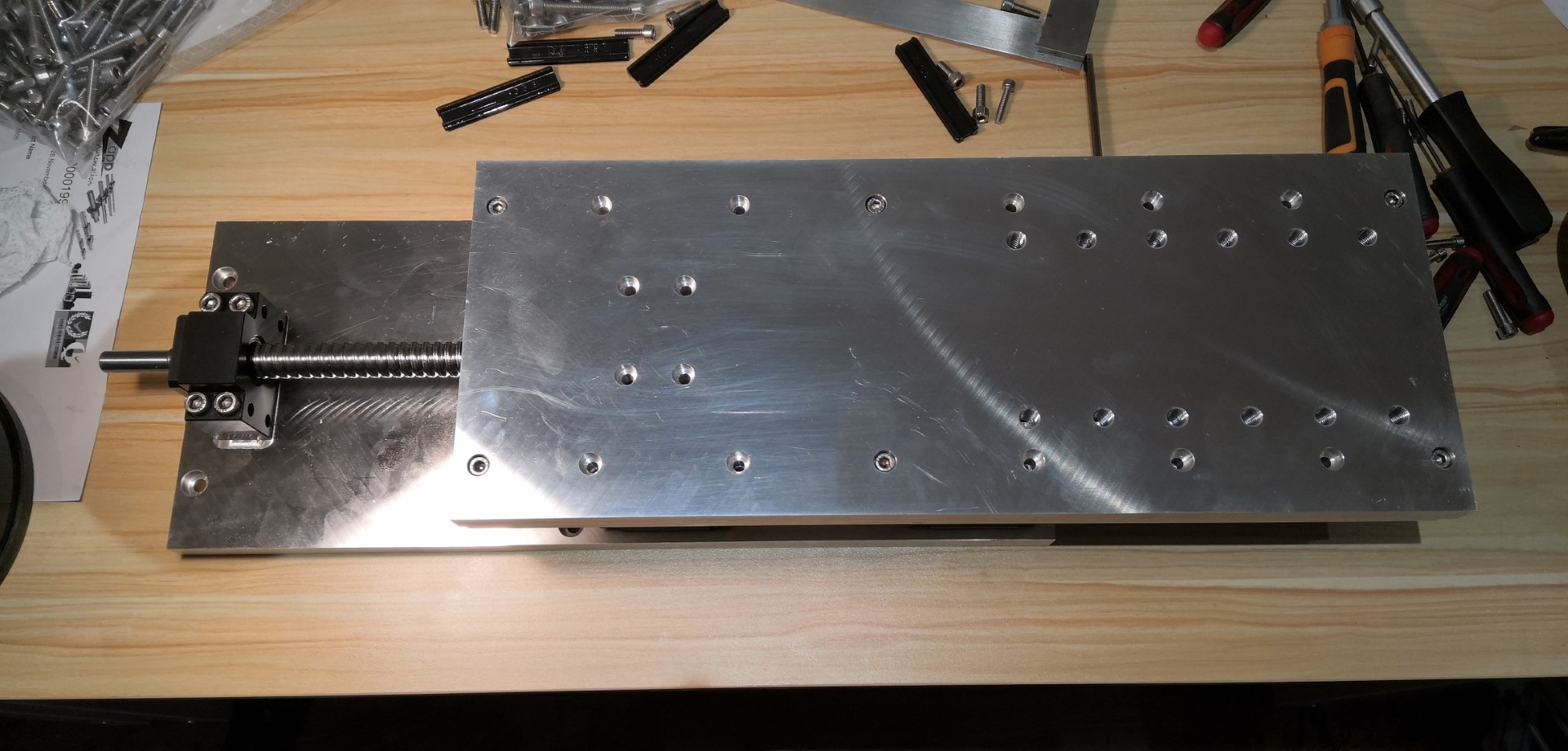

Made the motor mounts today, 3mm steel cut from some scrap box section. I used a cheap screwfix holesaw, wasn't at all convinced it would work. Lots of cutting fluid and smoked like crazy but delivered a very clean hole, cutter seems like new still. Just cleaned them up on the linisher and ripped the end of my finger nail off, very messy.
Attachment 28274 Attachment 28275 Attachment 28276
They are now painted.
Attachment 28278
For the machine bed I got a few quotes for 30mm HDPE, various Phenolic paper boards, etc, all around £300. I called Smiths for a quote on 1300x880x20mm aluminium plate, quote was £274, then they found a pre-cut piece 1500x990x20 which I can have for the same price. Seems a no-brainer so am picking it up tomorrow.
I will get a 1200x600 piece of phenolic for the spoil boards, these are a standard size and just right for my machine and readily available from electrical wholesalers.

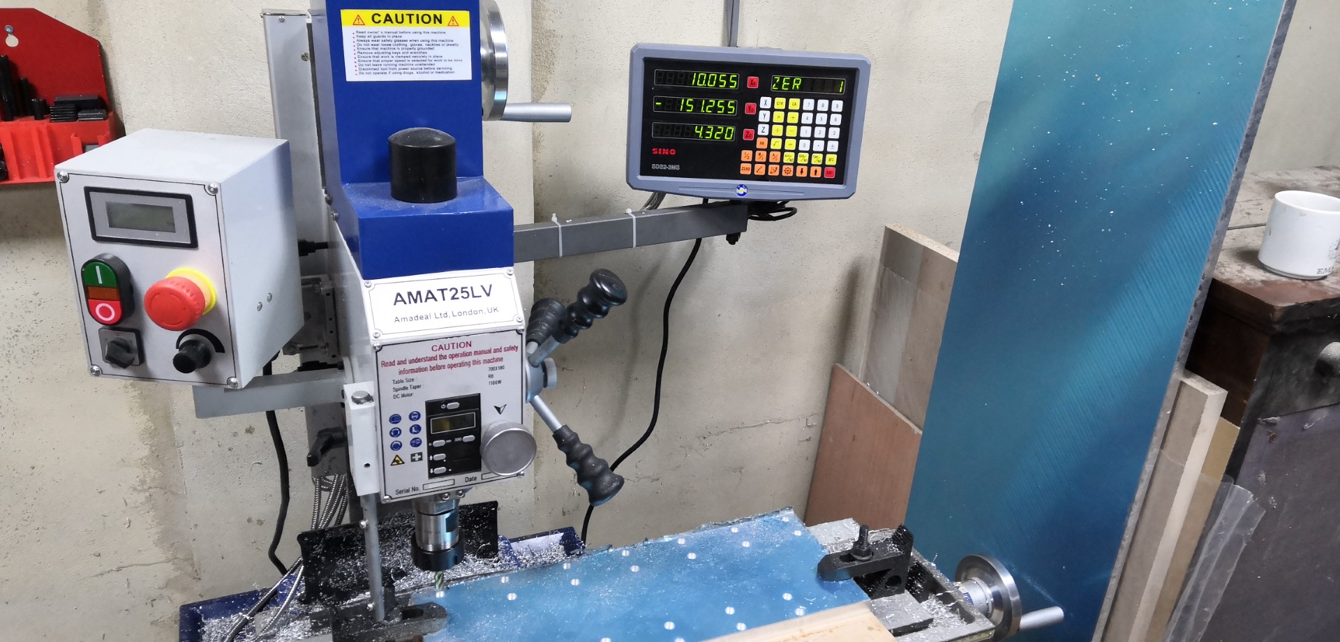

Picked up the bed today, 82kg of 20mm plate! Not sure how I'm going to cut it, too heavy for manoeuvring over the table saw. Will probably just use the circular saw very carefully...
Attachment 28283

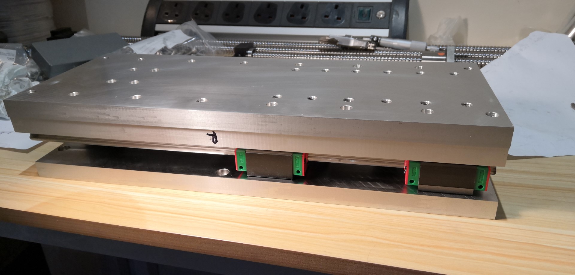

Bit of a set back today. I noticed that the Z screw was operating smoothly in one direction but lightly jammed and clicked when the direction was reversed. I've taken it off of the machine and now believing there must be a ball trapped between two circuits, however I've now re-packed it twice and the exact same problem persists. I think there is probably a small error where returns are machined leaving a tiny gap that allows one outer circuit and the middle circuit balls to touch. The plastic returns didn't look to clever to me.
Anyway I've contacted Fred from BST to see what he suggests.
Fred is sending a replacement, what an excellent after sales service. In the meantime I've ordered a ball nut from Cardiff for £11 that should arrive tomorrow so I can finish the machine.

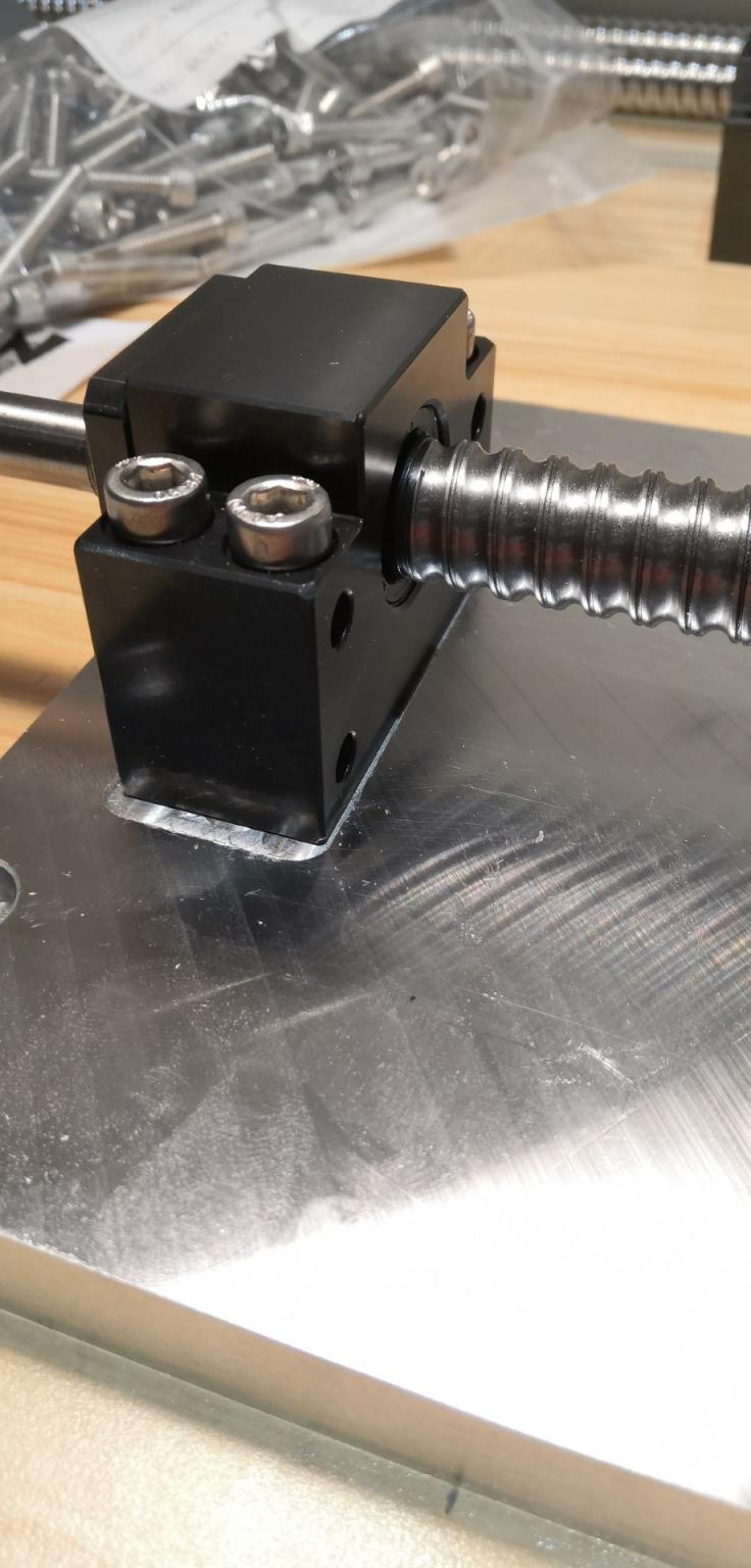

This time I got a piece of KASTAL 300 from Smiths, but tbh all I do is phone my local branch and ask what they have ready to go, so long as it is cast milled plate.
The rails are set on epoxy what was cast in plane. The ballscrew supports are bolted to the steel and shimmed with the ballnut hard mounted to the gantry so it aligns perfectly. I. E. fit ball nut before end supports.
Edit:
This is what I use for shimming, £15 for a pack of different thicknesses from RS, works really well.
