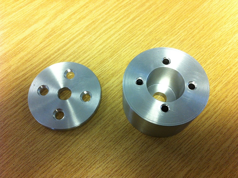

Bought a small boring bar and today in lunch bored the inside of the bearing holder out. Tomorrow will face off (parting tool not big enough) the part to the correct dims. Then just need enough Bellville washers to fill a 12mm gap...that offer of some washers still on Mark? ;)
Last bit is the cap then fit it all together...will take pics later!

Attachment 6009Attachment 6010Attachment 6011Attachment 6012Here you go Mark...pics from lunchtime's machining. The Ali has been in the bottom of a box of all my CNC bits from when I moved 2 months ago so is looking a bit worse for wear. If I can be bothered I'll skim the surfaces once it's done to tidy it up!

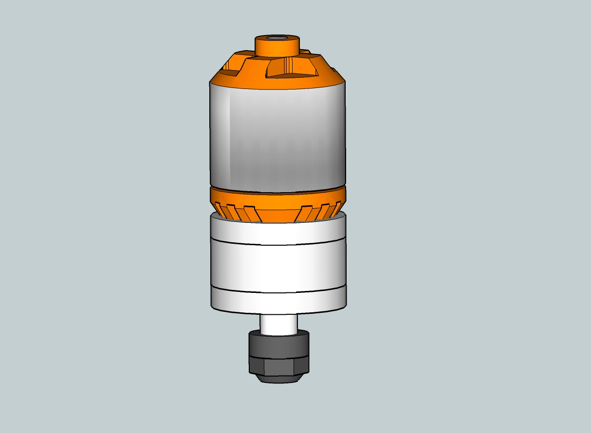

Here are some pics of my copycat spindle design, I think I'm in the same spot of the build as you are Neil.
Attachment 6032Attachment 6033Attachment 6034Attachment 6035
Attachment 6036
I'm using a Turnigy G110 motor, two 8x22x7 angular contact bearings, 4 belleville washers, and an er11 collet with 8mm shank. I'm mostly going to use this spindle for light work: plastics, engraving, PCB cutting, etc.
I'm a little concerned the bearings will heat up, any thoughts on this?
Also, did you re-install the e-clip ring onto the new shaft?

Looking good, I couldn't get the holding nuts in the housing as the PCD of them is too close to the 22mm centre hole. I'm going to have a real session on it this weekend as for once I'm in Hereford and not got anything planned (although if it continues to be sunny like predicted I'll be out up the field with my RC helicopters :nevreness: ) and as June will be a write off as I'm out every weekend :thumbdown:
I think the bearings will get warm, what speed are you going to be running it at? blackburn mark or Jonathan will be the ones to ask as they use theirs! If it gets too hot I'll use the router it to cut a water cooling jacket for it :nevreness:
I'm not going to bother turning a groove for the circlip as I reckon that the grub screw (I'll drill a small recess in the shaft) will hold it as well as some locktite :)
Looknig forward to seeing pics of the finished spindle!

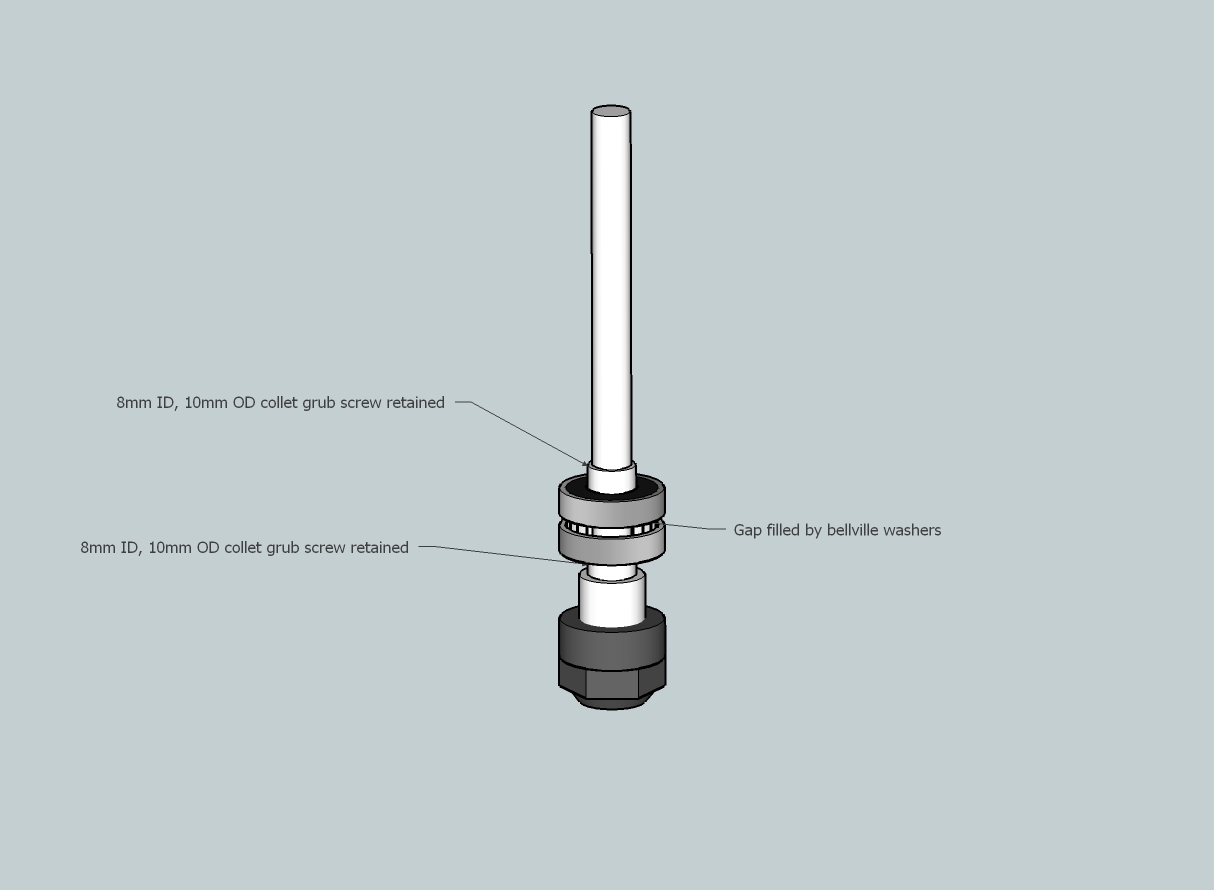

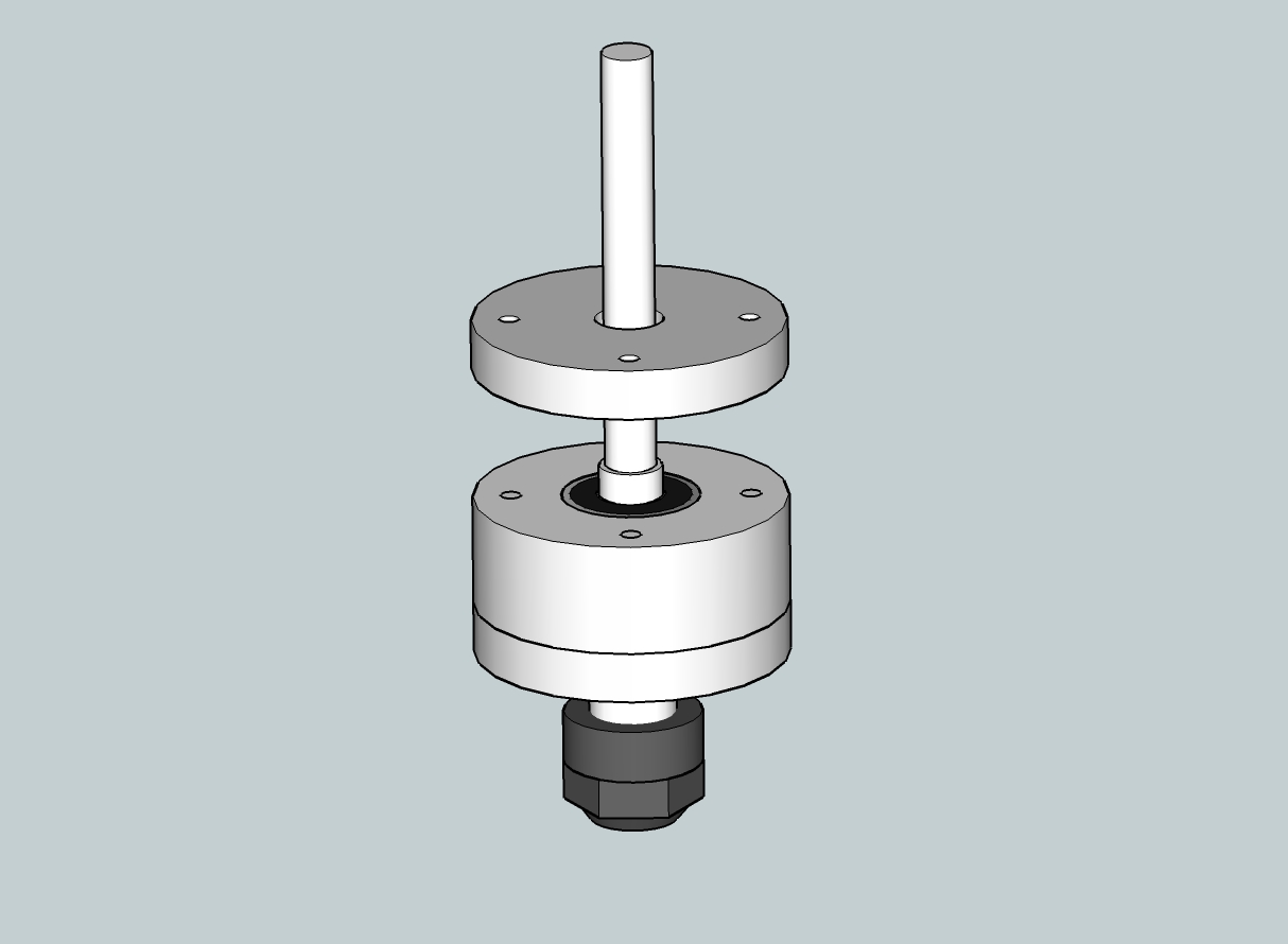

Well I've had a look at the design and tewaked it a bit. Will probably do a MK2 spindle using this method or I might tweak this one I've already machined. this one is only really going to be cutting up to 6mm balsa and 3mm ply so I can't imagine the forces as being huge. I might stretch to some delrin/acetal and even try some Ali for a laugh :smile:
Attachment 6038
This shows the top collet (but I haven't bothered showing the grub screws) on the 8mm shaft which is pre-loading theinner races against the bottom collet. I'm guessing I could get away with not securing the bottom collet (locktite) as it will be trapped between the bottom bearing inner housing and the ER16 collet.
Attachment 6039
This shows the assembled unit (minus the bolts but we all know what they look like!!)
Attachment 6040
The bearings in the above are not spaced the correct distance, they will be a further 10mm apart so I can get some Bellville washers in between.
This design has the inner races locked to the 8mm shaft and the outer races are constrained by the endcaps...............comments?

Neil,
I like the design. Is there enough wall thickness of the collar (8mm ID X 10mm OD) to accommodate a small screw?

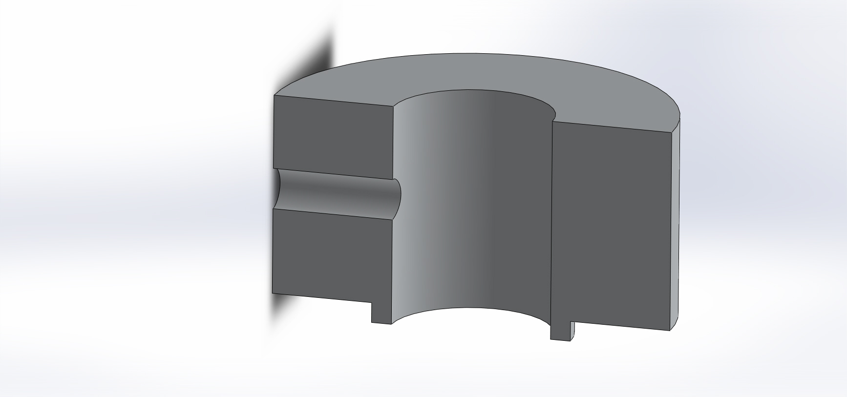

What about a collar that has a thicker wall and a little standoff, like this... gives you more meat to tap into.
Attachment 6047
This could also allow for a more tortured path on the bottom collar to keep dust out.
My last comment is to not forget to think about how you will assemble this... go through the steps in your mind, sometimes I design something and find out I can't assemble it because there are inaccessible features! :(

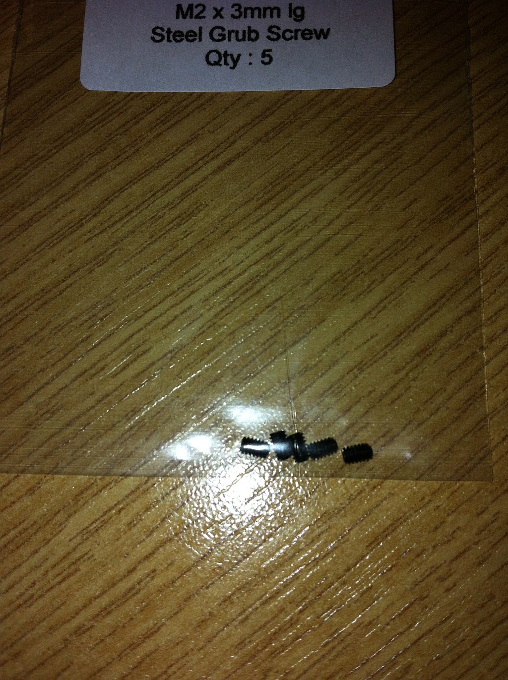

I'd be using 2 off M2 x 3 grub screws and locktite in each collar (will prob make it 3mm thick for extra purchase of the grub screws) as per the attached photo.Attachment 6048

Re: Diy brushless spindle
Made some progress on this after concentrating on helis for the last goodness knows how long. The amount I've spent on helis recently I probably could have built a reallt top notch router by now.....oh well still having fun with the helis so not too worried :D
Anyway....below is the progress I've made with the spindle housing, will dig out the bits from the box in the cupboard tonight and see if I can put it together tonight (minus the bellville washers as I've forgotten to order them!!)
Attachment 7095Attachment 7096Attachment 7097Attachment 7098
3 Attachment(s)
Here it is roughly assembled....I know the shaft is sticking down by 12mm ish as I've not put it all the way in the motor bell, see last pic! I'm waiting on getting some Bellville washers then I can finish it off :)
Attachment 7102
Attachment 7103
Attachment 7104
i could have sworn i sent you some
