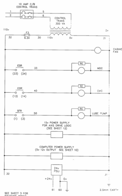

Look at the image below, this is the wiring diagram and shows that the 24 PSU (down the bottom) is fed from 110V, correct?

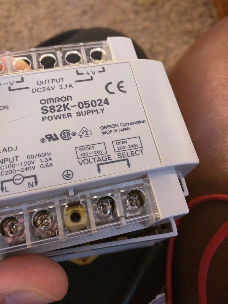

Then here is a photo of the same 24V PSU, take a note of the 'jumper' on the bottom right. What is this set to take as AC input voltage, 220 or 110V?
http://www.mycncuk.com/attachment.ph...id=15607&stc=1
So, if there is a jumper, its 110V, if not 220V?
The way I read it is if you want to run the tx on 110V then leave the link in. leave the link out if you require it to be run on 240V.
Have you measured the o/p voltage? ..Clive
That's my understanding too. There is no jumper, therefore its set to 220V.

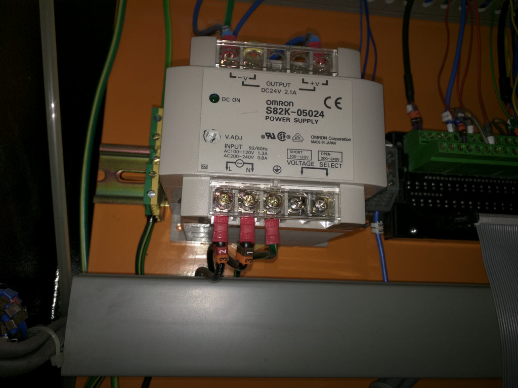

Clearly not .... Maybe both of us have the wrong way of thinking of this link / jumper. Just to confirm, that pic was taken before anything was changed and shows all wiring as it was. There is no jumper / bridge. I checked the unit again this morning before coming to work.

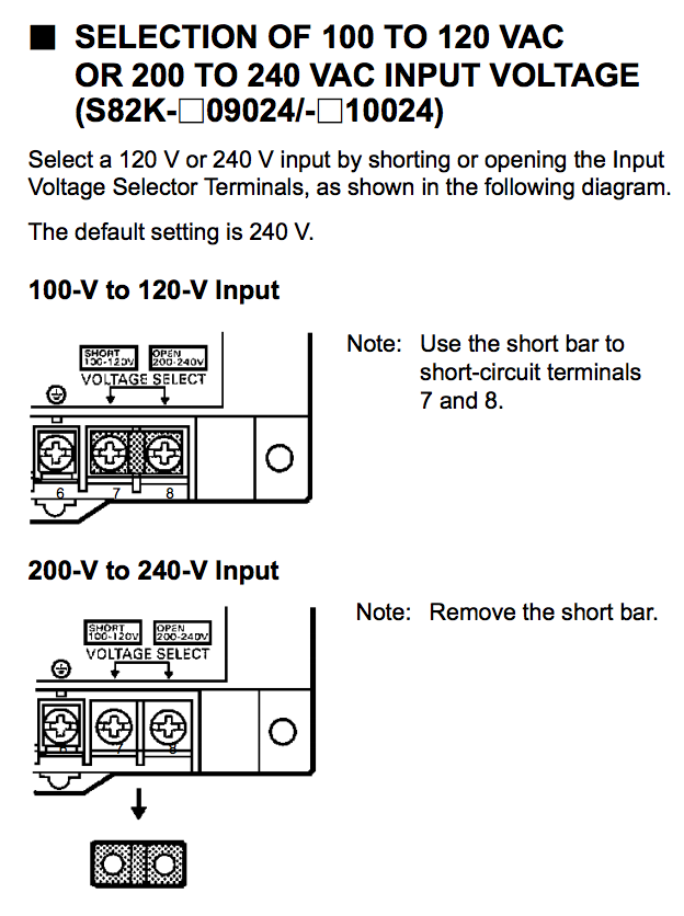

There must be a jumper in there somewhere. Ill triple check tonight. If you look at the manual too, it confirms what we both believe to be correct. I see no jumper ....

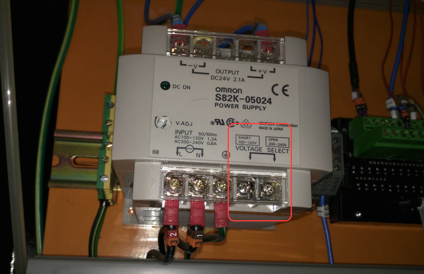

http://www.mycncuk.com/attachment.ph...id=15608&stc=1
It's hard to tell due to the clear plastic cover, but I'd say there's a little metal bar going up and over the plastic divider between the terminals.
Yes I was going to say put an ohm meter across the two terminals and see if it is in fact a dead short.
Yep, will do that. All hindsight now, need a new PSU.

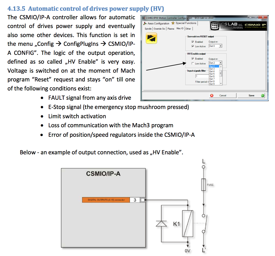

Thanks. I have a question about enabling '0V' for the drives.
Currently, to enable the drives, I need to provide 0V to a certain wire which allows a relay to activate (24V).
I have looked at the wiring diagrams and believe I understand how to wire the limits, E Stop, spindle activate etc.
What I am unsure of is how to enable a 0V grounding to enable the drives. I could reverse the wiring which means that it will switch the relay on, on providing 24V. There seems to be a specific way to do this in the manual as per below. Here, it seems to be for the same purpose but the 24V and 0V are reversed. Is this what I need?
There is also an option for 'low active', does this inverse the logic to satisfy the current need for 0V?

On the topic of the 24V PSU, if you look carefully, there is a bridge there .... :-(

Chaz For the sake of clarity please be aware that the word grounding is not always the same as 0V. Grounding usually what is referred to as the star point ie earth. OV is the -ve from the power supply (but is not always at earth potential). ..Clive
Chaz the Cslabs Controller outputs are PNP logic so you can't control 0v only Load. So change the relay around and provide it with Positive.
The way the outputs work is you provide 24V and 0v to each bank of 4 outputs. Then each output switches the Load. The Load must share the 0v of the Output.
It's similair with Inputs as well except that each individual Input is provided with 24v & 0v but you can choose which to sense. So can use NPN or PNP logic if required.
The HV option could be used for enableing the drives but again it just uses an Output so will be PNP logic.
Low active just changes how it reacts or switches and doesn't inverse the voltage etc. IE: Active if Voltage goes High(24v) or Active if voltage goes Low(0v)
Or in case of outputs If OUTPUT High Turn it Low when active and vise versa.!
EDIT: If controlling relay with OUTPUT make sure the relay coil load isn't more than 250mA otherwise you'll damage the OUTPUT.

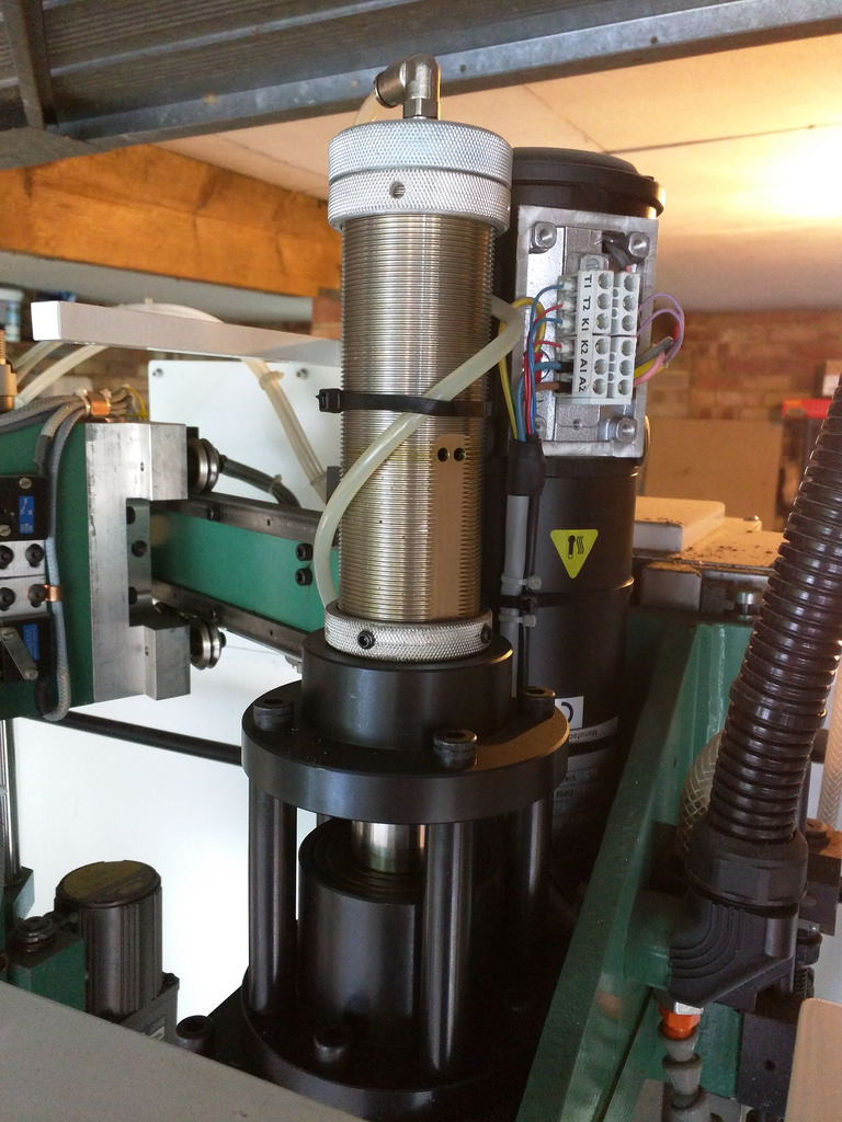

I am trying to get the missing solenoids replaced but am stuck with 1 open question.
There are 4 x small pipes going up to the ATC for left / right / up / down and one single 6mm OD pipe for what I believe to be the drawbar.
When you look at the spindle however, there is a single pipe, I presume this is the same 6mm pipe to activate the drawbar?
http://www.mycncuk.com/attachment.ph...id=15616&stc=1
the 6mm pipe is for the drawbar
Perfect, thanks.
Getting pricing from http://www.jjairsystems.co.uk/ for the manifold, 5 solenoids (2 x ATC left / right), 2 x ATC down / up and drawbar).
you wont need 5, just three. The in/out can be done with one valve, same as the up/down.
