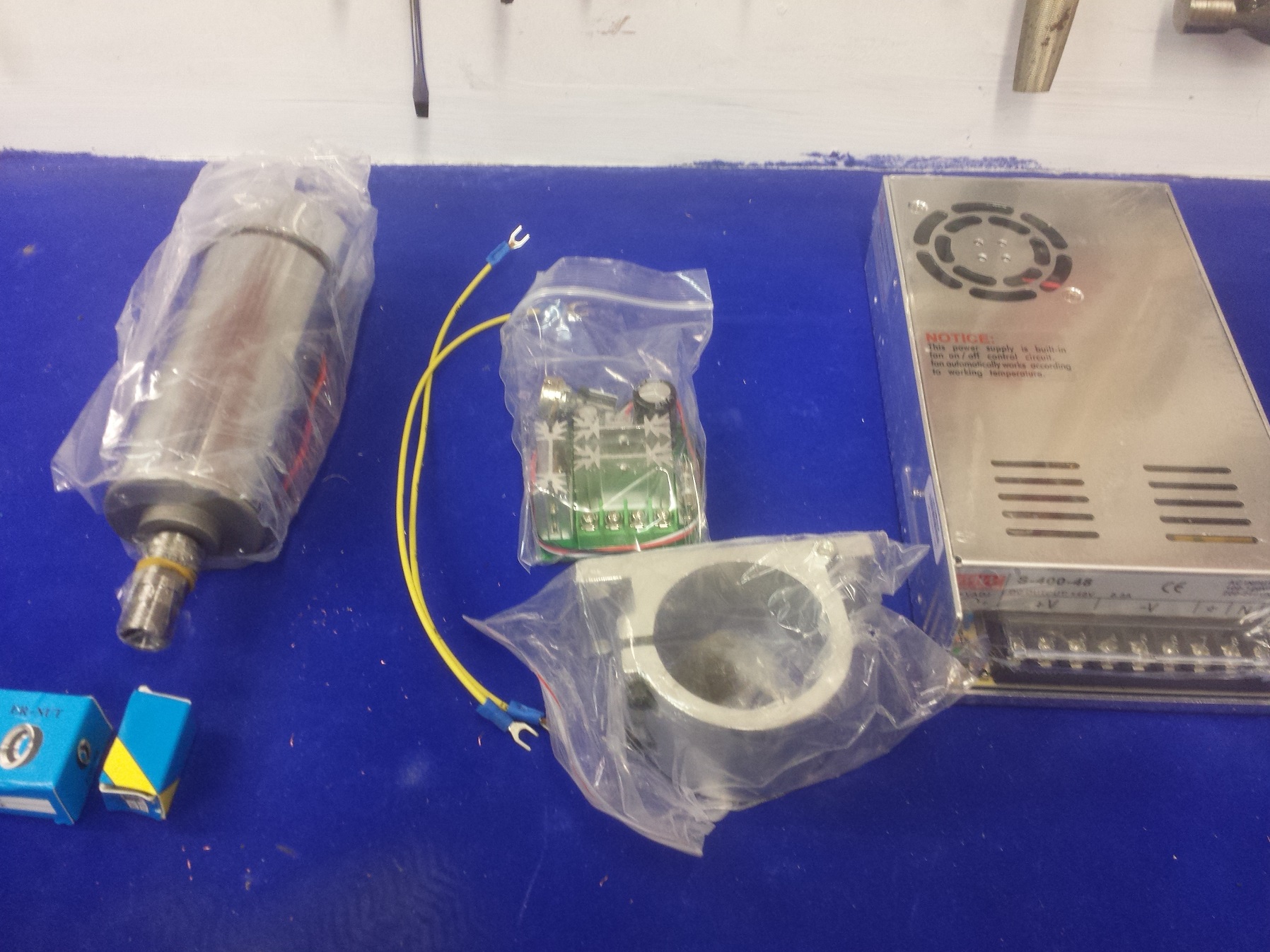

Right chaps I need some help. I have Wired the spindle control board up to my planet cnc enclosure box as instructed by Planet themselves. However I am having difficulty in getting advice on how to get power to the spindle power pack.
Here is what I have done so far:
I have removed the potentiometer, capped off one wire and wired the 0-5v and gnd to the pin6 and gnd on the planet board. I have soldered the wires and heat shrunk them

I just dont know how to supply power from the enclosure box to the large silver power pack which is mounted on top for the spindle.
It has these connections on it:

Hi there, could you explain a bit more what you mean when you say power pack on top for the spindle?
The photo you have there is a typical Chinese power supply, it will need to be wired to 230v AC - Mains.
Attachment 22983
I don't understand the question. You connect the mains to the L and N, the Earth to the one beside N and the spindle to the + (normally red wire) and the - (normally black or blue wire). If you have a regulator to adjust RPM then you connect that in between the power supply + and - and the motor + and - terminals. The PWM module should have some kind of documentation describing this, or printed on the PC board there should be clear markings.

Hi Ravi,
You need to connect that Power Supply you have to 230v AC - Mains Voltage.
Looking at the PSU you have the far right three terminals: Earth, Live, Neutral.
Get a common Kettle Plug (For a PC or a PC Monitor etc), cut end off and use it to power the PSU.
USUALLY - in a typical plug it is as follows:
Blue - Neutral
Brown - Live
Green / Yellow - Earth
If you want to be neat about it then you can get one of these: Click Me
That will you mean you can just plug it in and have it modular.
Once you have the PSU live, you just need to (I assume - I do not know what you have been supplied to control the spindle), power the PCB using 48v DC from the PSU using any of the remaining terminals. You have 3 sets of -V & +V on the left hand side of the PSU.

Do you know what the draw is of the spindle? I would advise against running that new PSU for the spindle through that On / Off switch, i would just power the Spindle PSU direct from the IEC / Kettle Plug, if you want to be able to turn it on & off away from using the wall plug, then get one of those additional IEC / Kettle Plug mounts from ebay like i linked.
You need to wire that PCB to the Spindle PSU, just take 'Power -' on the PCB to a 'V-' terminal on the PSU and the same for 'Power +' to 'V+'.
That should be all you need to do in terms of power.

Hello Alex mate,
here is some info for the spindle:
Brushless Spindle DC Motor:
Working Voltage: 48V DC
Rotation Speed: 12000r/min max
Power: 400W
Torque: 230mN.m
Insulation Resistance: >2Megohm
Dielectric Strength: 400V
Diameter: 52mm
Axis Collet Length: 48mm
Diameter of Axis Collect Holder: 16mm
ER11 Collect: 3.175mm
Power supply (enough power for motor):
Input: AC220V ±10%, 50Hz
Output: DC48V, 10A
Power: 480W
Re: My Cheapo Chineese 3020t mini CNC Build (more like improvements) leanring all the
Attachment 23010
Am i on the right track at last?
Yeah based on the info you gave there i probably would not wire that PSU through those small wires & switch.
Yeah your drawing looks good that is how it should be wired.
