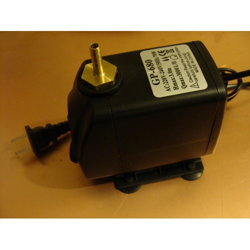

I have the pipes. my question was about the connection. The brass connector.
On mine (pump) the seller said is 18mm diameter outlet. I cant find anything with that dimension at one end and with 1/4" or 6mm on the other end.http://www.mycncuk.com/attachment.ph...id=16044&stc=1
Weird :/ Mine is different. It's made of plastic, exactly like the one on this kit:
http://www.aliexpress.com/item/CNC-S...444_5,201409_1
Though I have to admit it was quite hard to fit the pipe that came with the spindle. The coupler I have has the same size as the one on the spindle.
Many of you have the same setup. Where do you find the connector?
Gabi
Not sure what your asking here . ? . . . The pump in the picture doesn't need or use a connector it's got a Barb so you just push the pipe on and clip it.!
If your wanting the Barb Fitting that screws into the pump then try these people.
http://airaccessories.fluidfittingss...s/0033000a0007
Hi JazzCNC,
The photo is for reference only. My pump came with a bigger plastic connector. I will have a look on that site.
Still maybe know where I can buy the right one. I bought the 3/4" barb and doesn't fit, it is a hair big...
