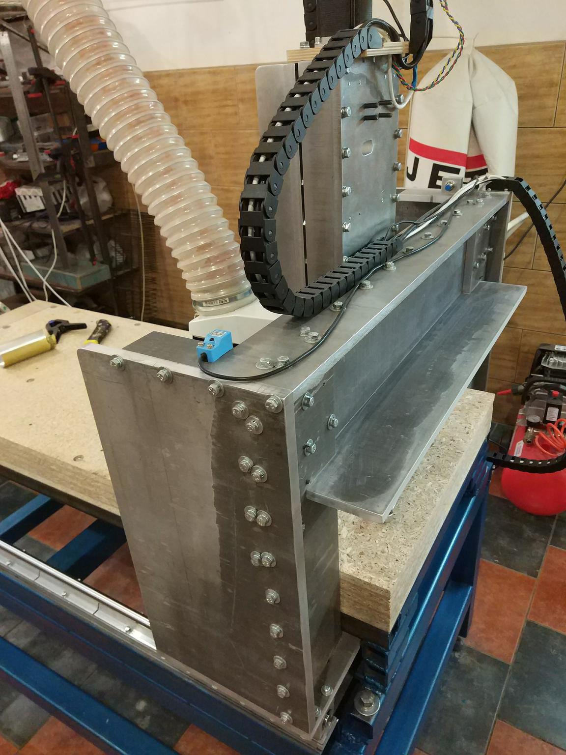

Here on this machine I have a problem with the perpendicularity of the x and y axes. On some tasks this did not suit me. I solved the question in a minute, in the mach3. And with the utmost precision. I do not imagine how much time I would have spent on the alteration in order to achieve the desired perpendicularity of the x and y axes.
Any software to correct the dynamic variable geometry of the commercially made (in Devon) machine that I have ? My machine just does not cut the mustard. At least not accurately !
Does the controller in question handle master and slave drives on a single axis? Can it use a homing switch on each of these with defined offsets to allow the gantry to be re-squared each time you home it? That seems like a better approach which allows for the possibility that the perpendicularity is not built-in when you have a moving gantry with separately-driven ends. I agree that the ideal, and certainly in the case of milling machines rather than routers you would expect X and Y axes (and Z, of course) to be built perpendicular.
