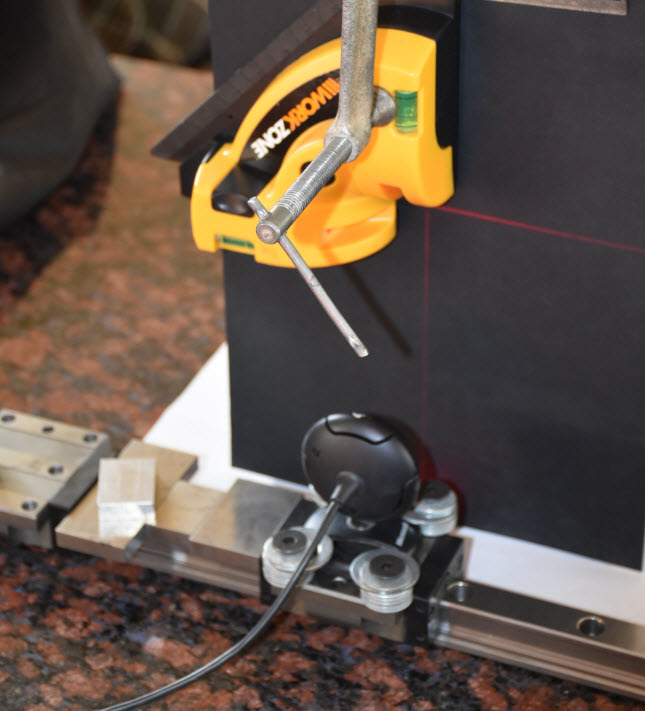

Got a question about this Laser setup.? How wide a beam can it throw and still be accurate.? Could it, for instance, cover a 6mtr x 4mtr area.?
So the way to think about it is as a bunch of rays leaving the laser, each will travel in a straight line. If the optics are good then all these rays will also lie in a plane forming a line on whatever vertical surfaces they hit. I haven't tested the straightness at that distance only that it can be focused to a tight beam at around 10m.
One thing you could try with your large surface plate is setup the laser on the plate, take a bunch of readings in a 1m radius with the sensor sat on the plate, this will tell you whether the laser is planar and if not what the error is for each arc segment, i.e. you can calibrate the optics. Then you can project this error as far as you like to whatever you are actually measuring.
The biggest issue will be whatever you mount the laser on will have to be really solid as just 1 arc second of wobble on the mount will be 0.05mm at 10m. One solution to this is using differential measurement like they do with electronic precision levels, setup one or more fixed sensors and use these to offset any error caused by you breathing near the laser ;-)
This is the part of the system I'm really struggling with. With my laser mounted on that piece of box section with sticks out 400mm from the machine, reasonable finger pressure
is sufficient to bend the box section enough to cause a ~10um deflection in the height of the beam at the other end of the machine say 1.5m away.
When looking at this stuff where the sensor is measuring 3um pixels everything looks like it is made of jelly, at least everything in my garage including the 6 inch concrete slab.
What are you planning that is so large?

Hi Jazz
Well, i think we arrived at the point were the cheap cam +software used as a levelling sensor proved it is very good.
The new problem is the lens you use to spread the laser into a beam....
The projected line can be a non straight because of the deviations caused by the optics used to spread the beam.
Does that summarize it?
I plan to use it to level check Y and X 1 axis at a time in the axial direction where the line is straight. First for vertical then horizontal deviation. maybe the diagonal
After that i will see...
Not sure how to do Z yet.
My laser crosshair only aligns in 1 orientation. +/- 0.8 mm /mtr out of plum
according to factory spec.
So Z could stil be non straight
Grtz Bert.

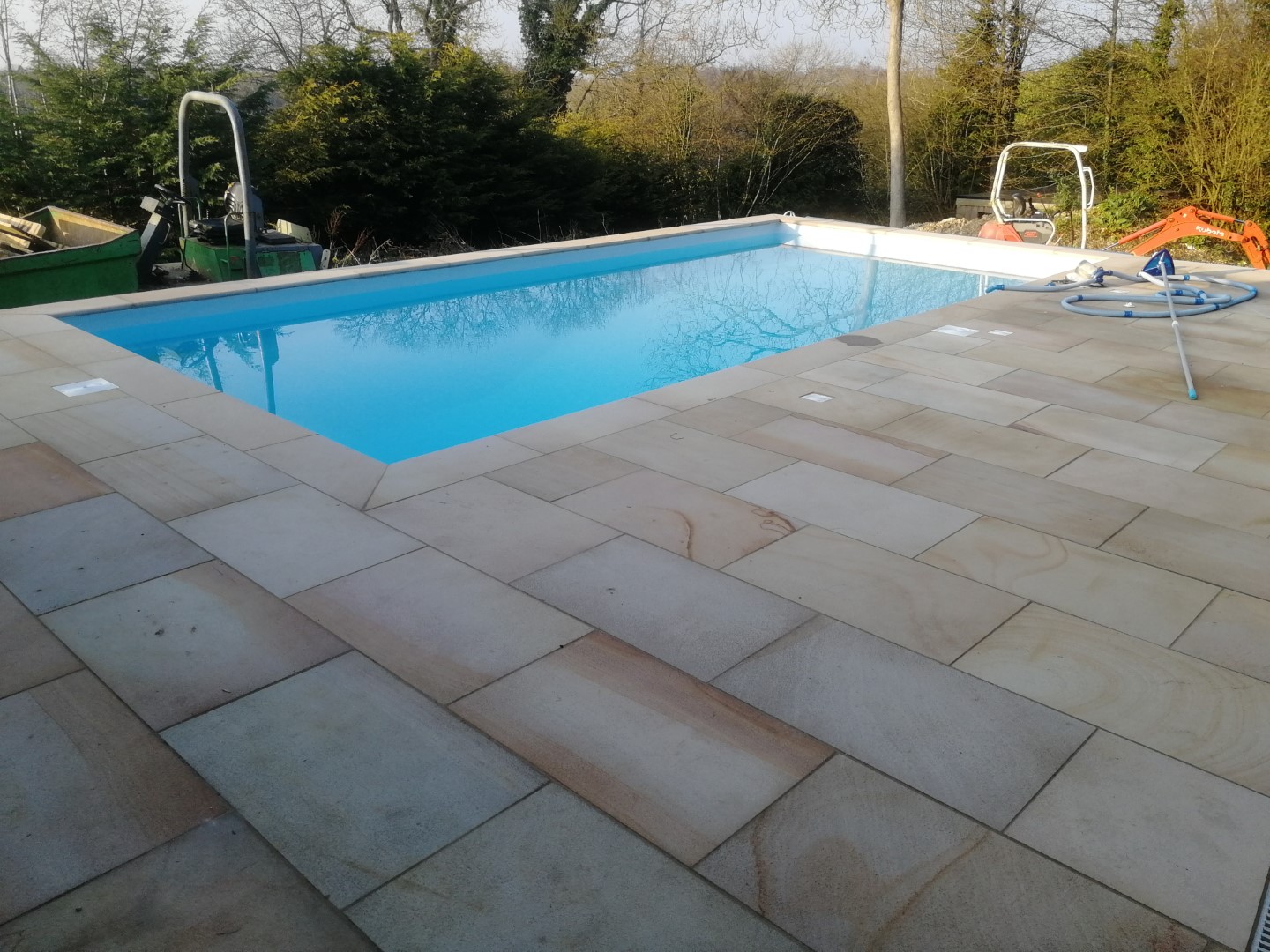

LOL, my swimming pool is within 2-3mm when full and I used a cheap dewalt laser when I pumped the concrete for that, your eyeball can tell 4" at the length of the pool. Anyway you are confusing the pendulum laser alignment error with the optical error, quite different things, surveyors only care about the former. Similarly a window fitter, specifically someone who fits bespoke bi-folds will have a laser scanner for scanning the openings as the units are manufactured to fit.
Attachment 27095 Attachment 27096
Still would have required some shimming to attach linear rails rather than sandstone ;-)

Back to the job in hand.
I found a rather obvious flaw in my sensor setup for setting my routing jig into plane today. I have the sensor mounted in a nice true cube and this sits on the jig plate. I then alternate its position above the 3 levelling points bringing each up to the correct height with the jack screws. The problem is unless the sensor is positioned in exactly the same location at each point for subsequent rounds of this procedure you will get different readings. This is because the sensor is effectively rotated around the axis of the jack screw and since the plate is not yet planar to the laser the height of the sensor relative to the laser plane changes based on this rotation. This makes it bloody difficult to do, and it is not until the plate is planar with the laser that sensor reads the same height right across the plate.
To put it another way with the sensor sitting on a plate that is not planar with the laser if you rotate the sensor about any point that is not the vertical axis of the sensor chip itself then the reading will change since the height has changed, similarly if you slide the sensor up and down this plate the height reading will change. This means you can trick yourself into thinking the heights are zero'd by moving the sensor, which I noticed I was doing.
There are two options:
1. Machine up a new sensor mount with some mechanism (likely a dowel pin) inline with the vertical axis of the sensor to that can be used to relocate the sensor consistently at 3 points across the plate.
2. Use 3 sensors simultaneously (would need software change) each fixed to the plate for the levelling operation.

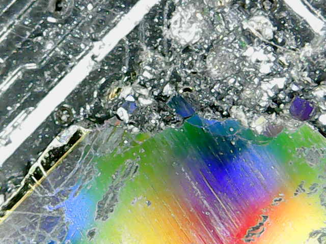

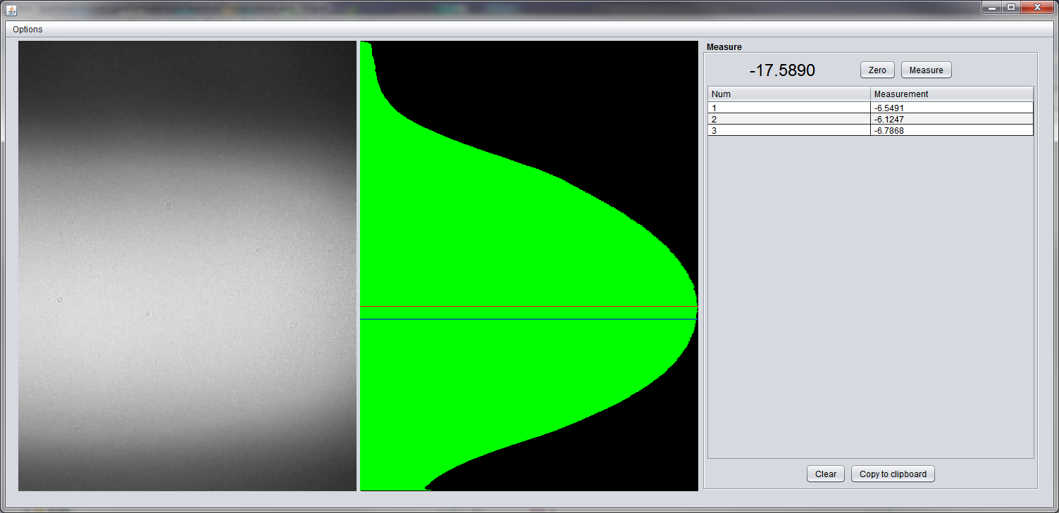

I have realised something about these sensors. They are colour sensors, and the colour detection is done by layering a grid of colour alternating RGB filters over the individual pixels which are all identical photodiodes (i.e. the pixel is monochrome) in what is called a Bayer pattern. These are laid out to match the human eye's response to colour, with 50% of the pixels green and 25% red and 25% blue. See https://en.wikipedia.org/wiki/Bayer_filter
Attachment 27114
This isn't ideal as I'm using a red laser. This means only 25% of the pixels are useful and the sensor will be interpolating the values between 'red' pixels.
Anyway someone pointed me towards some super crazy people in astrophotography who 'de-bayer' their very expensive DSLR sensors with a toothpick so the sensor becomes monochrome at its native resolution, effectively scratching off this colour filer layer to expose the raw sensor.
https://stargazerslounge.com/topic/1...-bayer-matrix/
I have just tried this procedure and ruined a webcam sensor (ripped it off the pcb) so I don't recommend it.
EDIT
The first casualty of this miss-adventure, don't think it is still worth £7 !
Attachment 27117

I suspect this is not the greatest limitation on the acuracy of your system. Making the concrete floor of your shed more rigid should be a higher priority.:whistle:
Re: DIY Laser levelling using webcam and laser level
Kitwn
You may think that Kit, however I believe the (presumably linear) interpolation on the sensor is messing with my non-linear intensity fitting algorithms. It makes no sense to resolve down to sub-pixel resolution when 75% of the sensor information is estimated (Nyquist would have a fit).
For example imagine the raw intensity at the peak of our gaussian laser line looks like this:
100, 100, 101, 101, 100, 100
Now if this falls under the bayer filter on a green+red filter line arranged as:
G, R, G, R, G, R, G
With only red laser light, nearest neighbour linear interpolation would look like this:
100, 100, 100, 101, 100, 100
If the bayer filter is offset 1 pixel the other way you would get

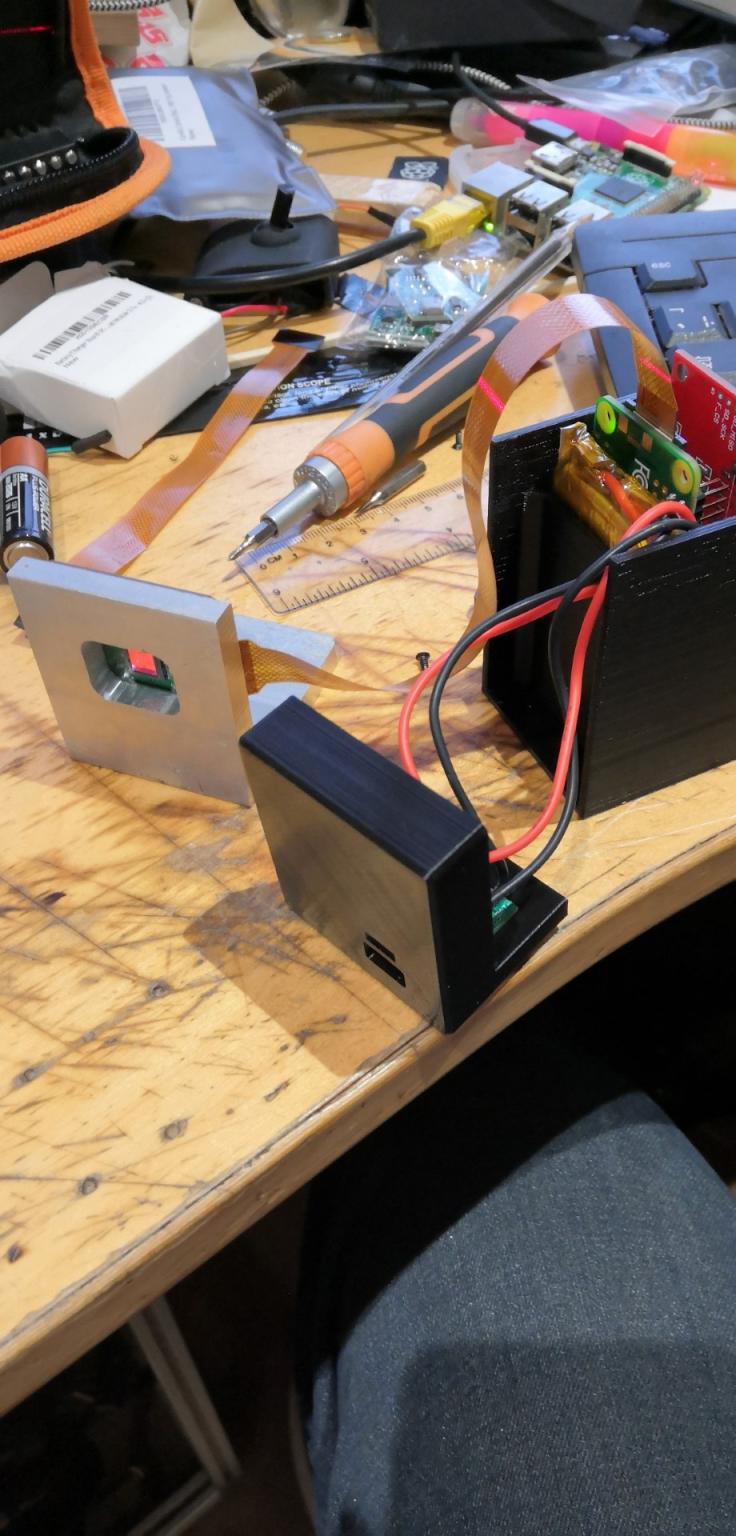

Been a bit busy with other jobs, however I have been playing around with a raspberry pi version of this system. I took a PI zero W (with builtin wifi), a small TFT screen and an OV5647 (pi camera v1) and wrote some more software. This will form a simple standalone unit and addresses a number of the problems I was having with a simple webcam, specifically:
1. I access the raw camera sensor directly, read the bayer data and only use the red pixels. This removes a load of noise that was being introduced by the blue an green channels and interpolation. There is no interpolation done at all on the sensor using it this way which means I get the true intensity per (red) pixel. Pixel pitch is 1.4um and 1/4 are red so system resolution is 2.8um.
2. Vertical range is much improved around 4mm.
3. With lens removed there is no glass (or a very very thin glass maybe) over the pixel array unlike the VGA webcam which had about 0.5mm of glass which gave some diffraction patterns.
4. I put in an algo to dynamically adjust the exposure, this means I increase exposure until the detected gaussian starts to clip (sensor saturates) then back it down a bit. This makes things much more accurate and repeatable at varying distances from the laser source.
5. No more cables!
I printed a case for it today and mounted the camera to a piece of Aluminium, still need to fix it all together. It has a lipo cell on board that I salvaged from a dead rc pack, a usb charger / ups and lasts for about 3 hrs before needing recharging.
Attachment 27233 Attachment 27234 Attachment 27235 Attachment 27236
https://youtu.be/m-zK3vz7bbQ
Cheers, Joe
EDIT
Attachment 27117
