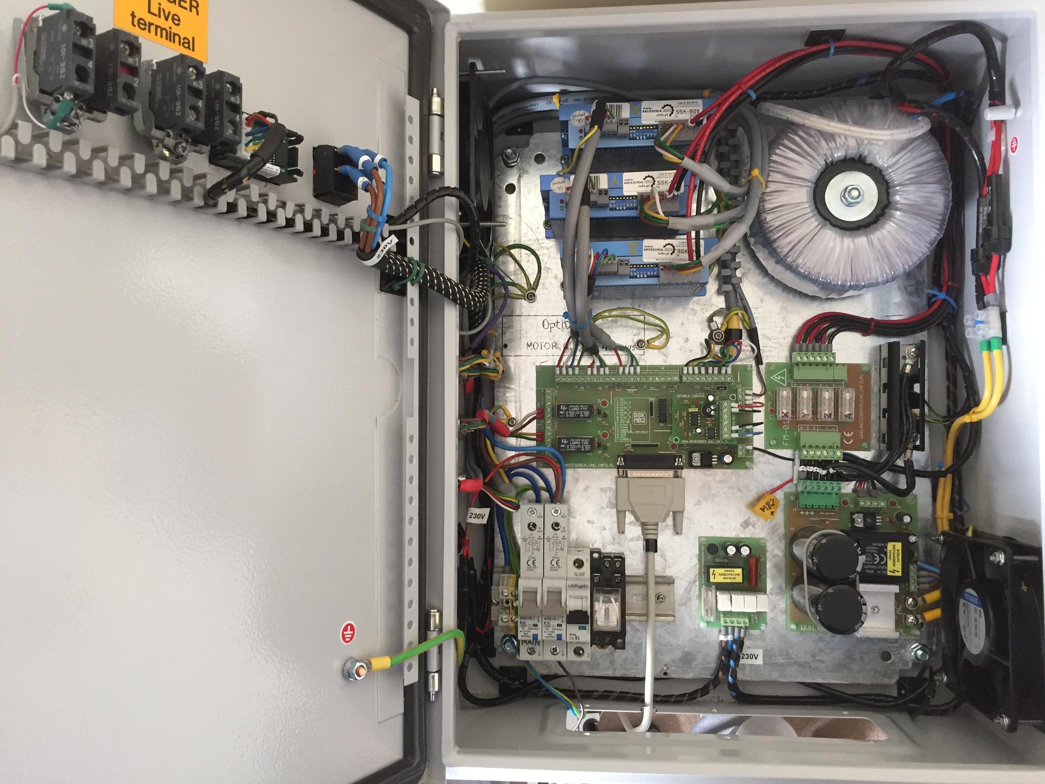

My 1st panel 3 years ago had 720VA trafo with soft start and stabilized 12v for BOB lpt1.
Attachment 20214

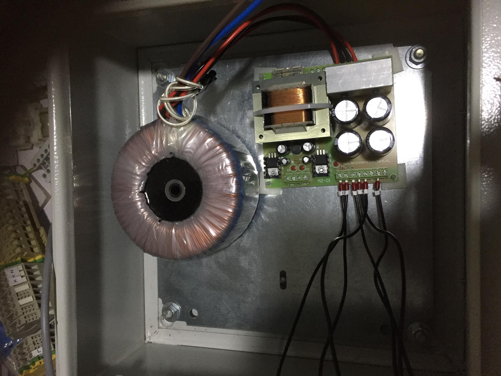

I am building another box 300x300 which is only High Voltage PSU and 24vDC
Attachment 20215

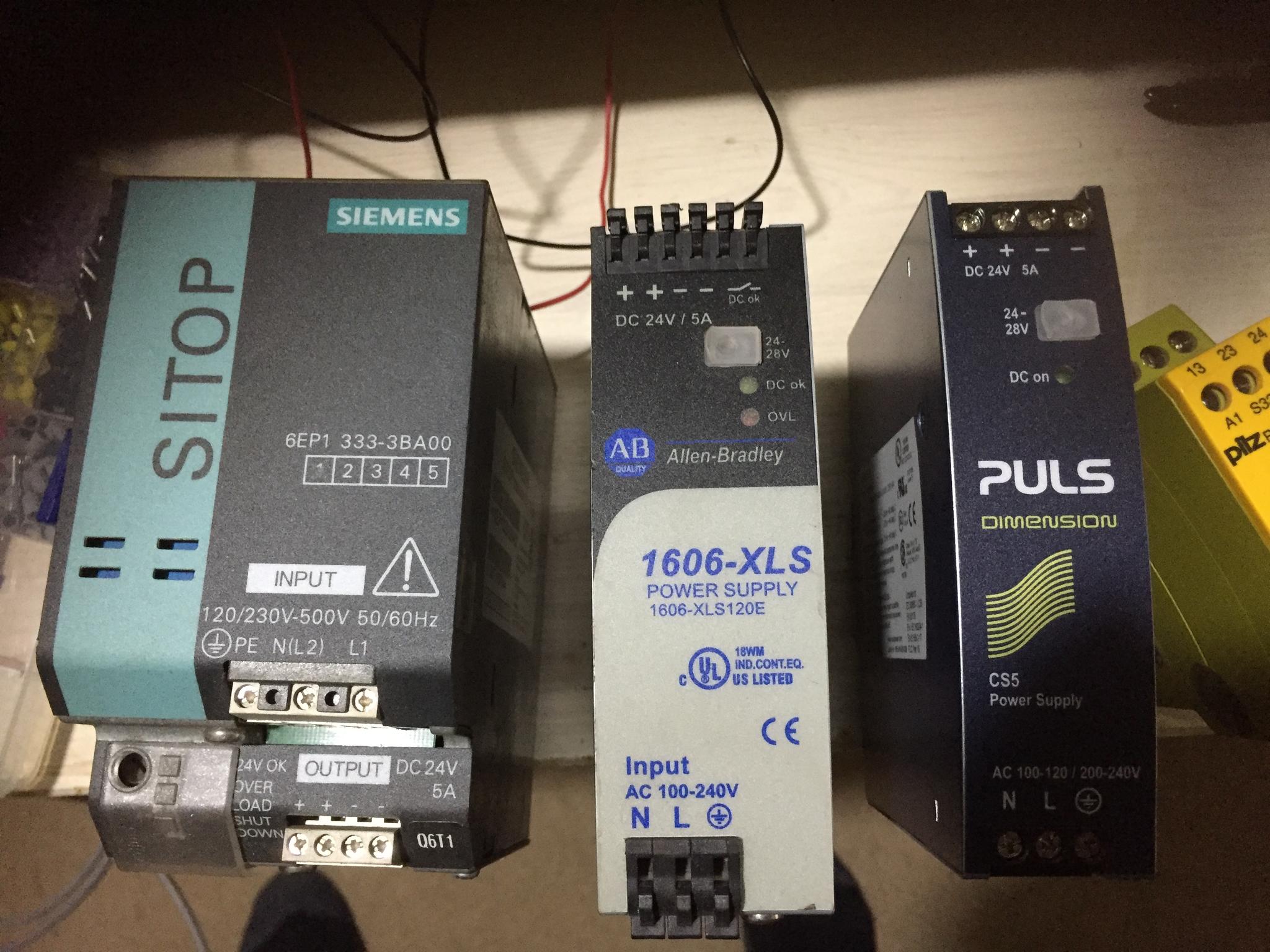

here are industrial PSU 24Vdc all stabilized
Attachment 20216

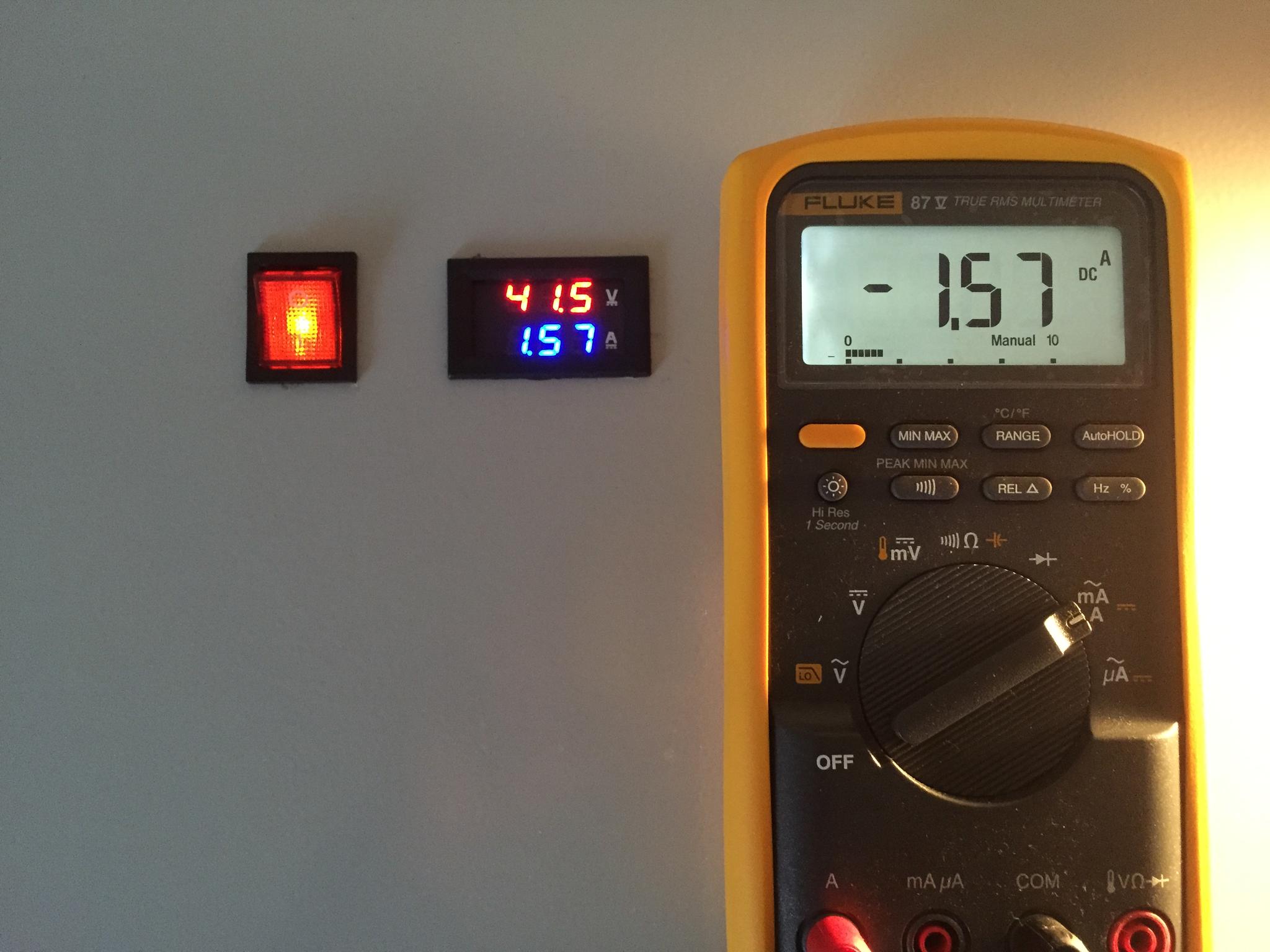

33VAC - 52VDC, big boost over calculation, any idea why was like that?
My both 420VA & 720VA has 30VAC and gave 41.5VDC (calibrated Fluke 87V and 1587)
Secondary coil was ~32VAC
Attachment 20226
picture shows Amp meter after calibration, voltage was set too

yes , sorry corrected to "secondary coil was ~32VAC"
1.57A has nothing to do with transformer, just a picture. VOLT/AMP meter red/blue LCD shows the same voltage as calibrated Fluke - that was my point.
I had only picture with Amp displaying on Fluke which also was calibrating. I know I confused enough but some guys say that my meter might be off.

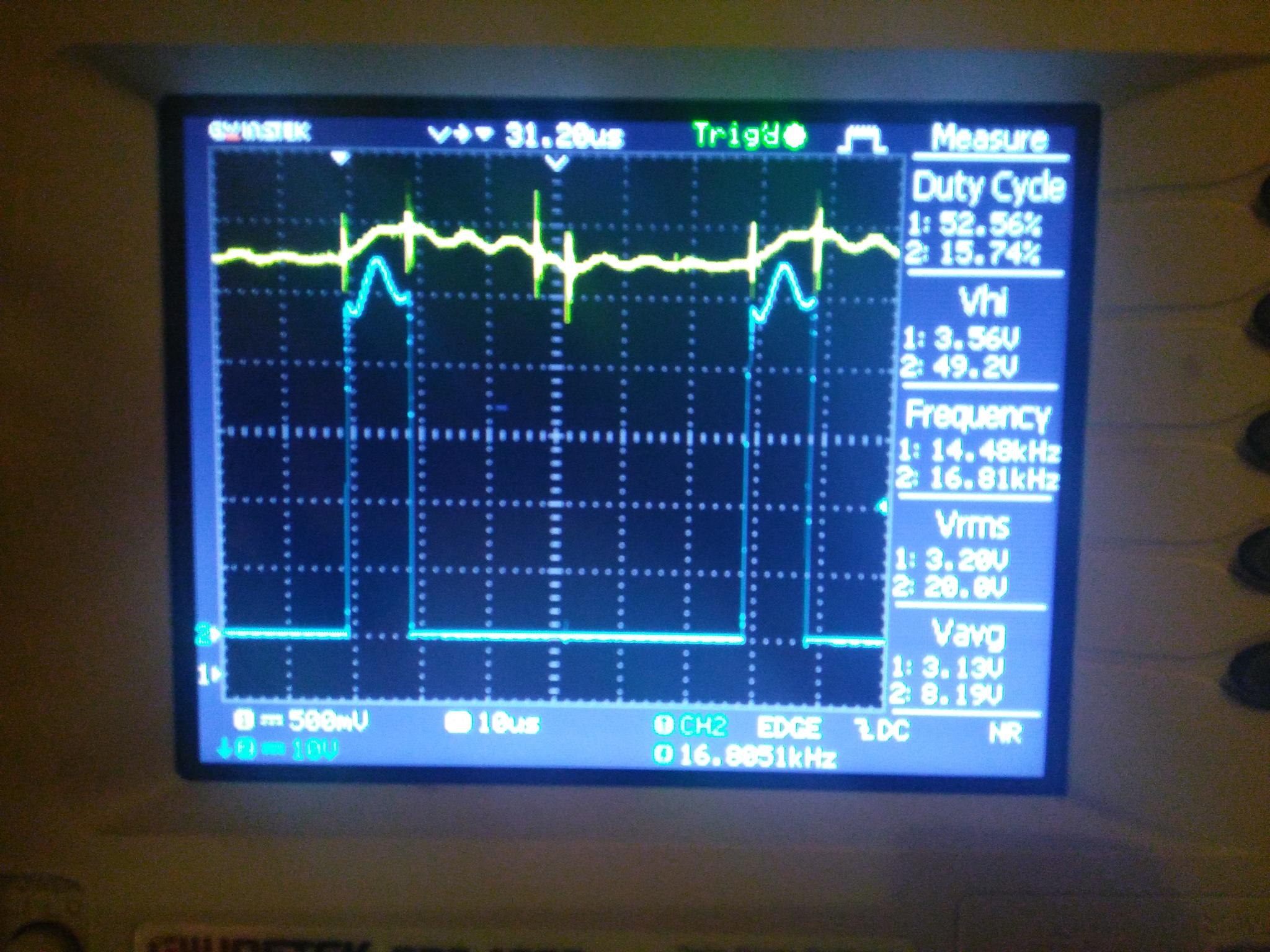

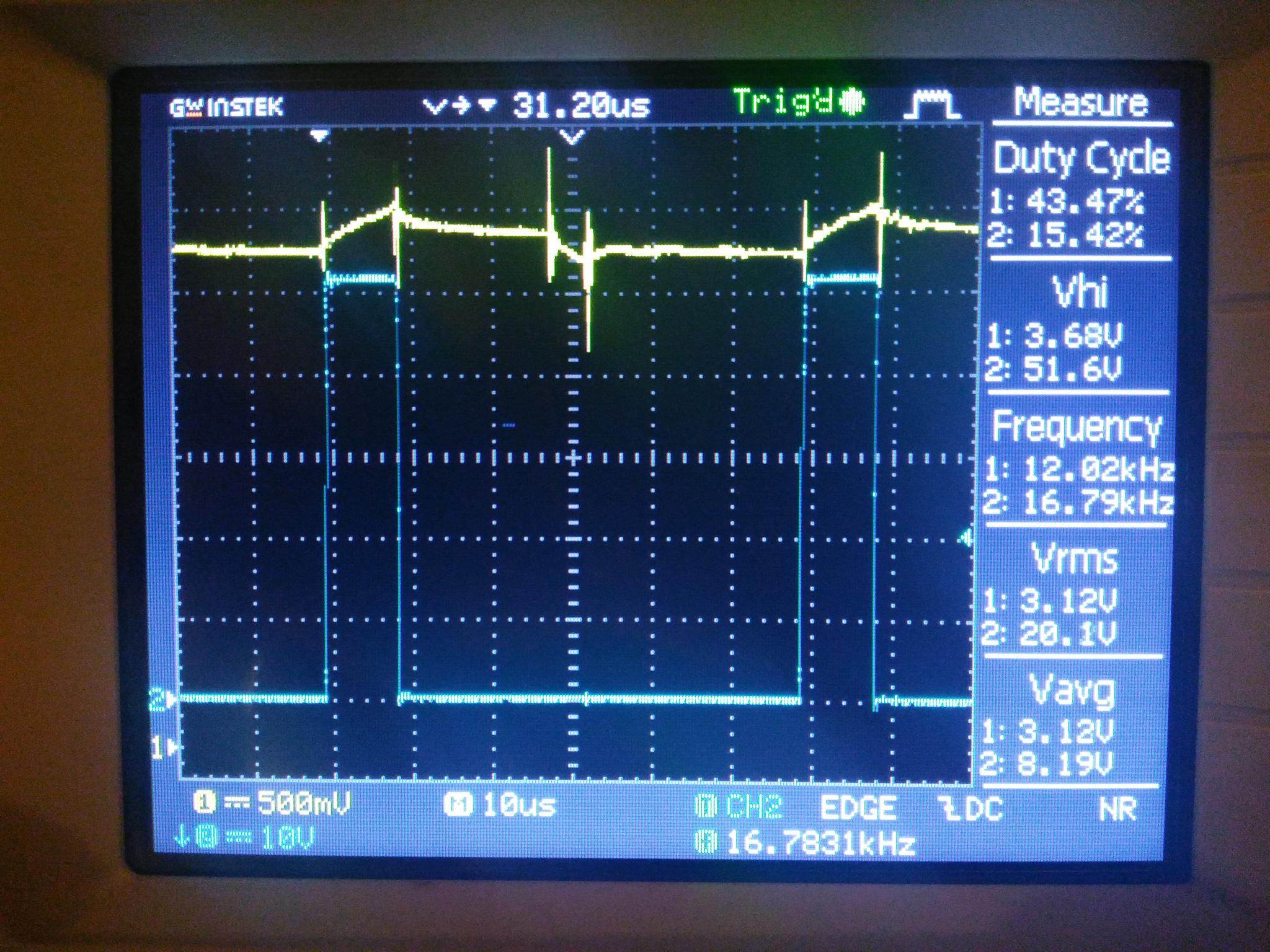

Meanwhile, I just dug out these graphs I captured whilst repairing a stepper driver, showing the voltage across one mosfet Vds (blue) and the line current through the same (yellow).
The first graph shows a normal situation - we see the current rising when the voltage is applied, and falling otherwise with the inductance of the motor smoothing this current. Observe how little overshoot there is on the voltage.
Attachment 20240

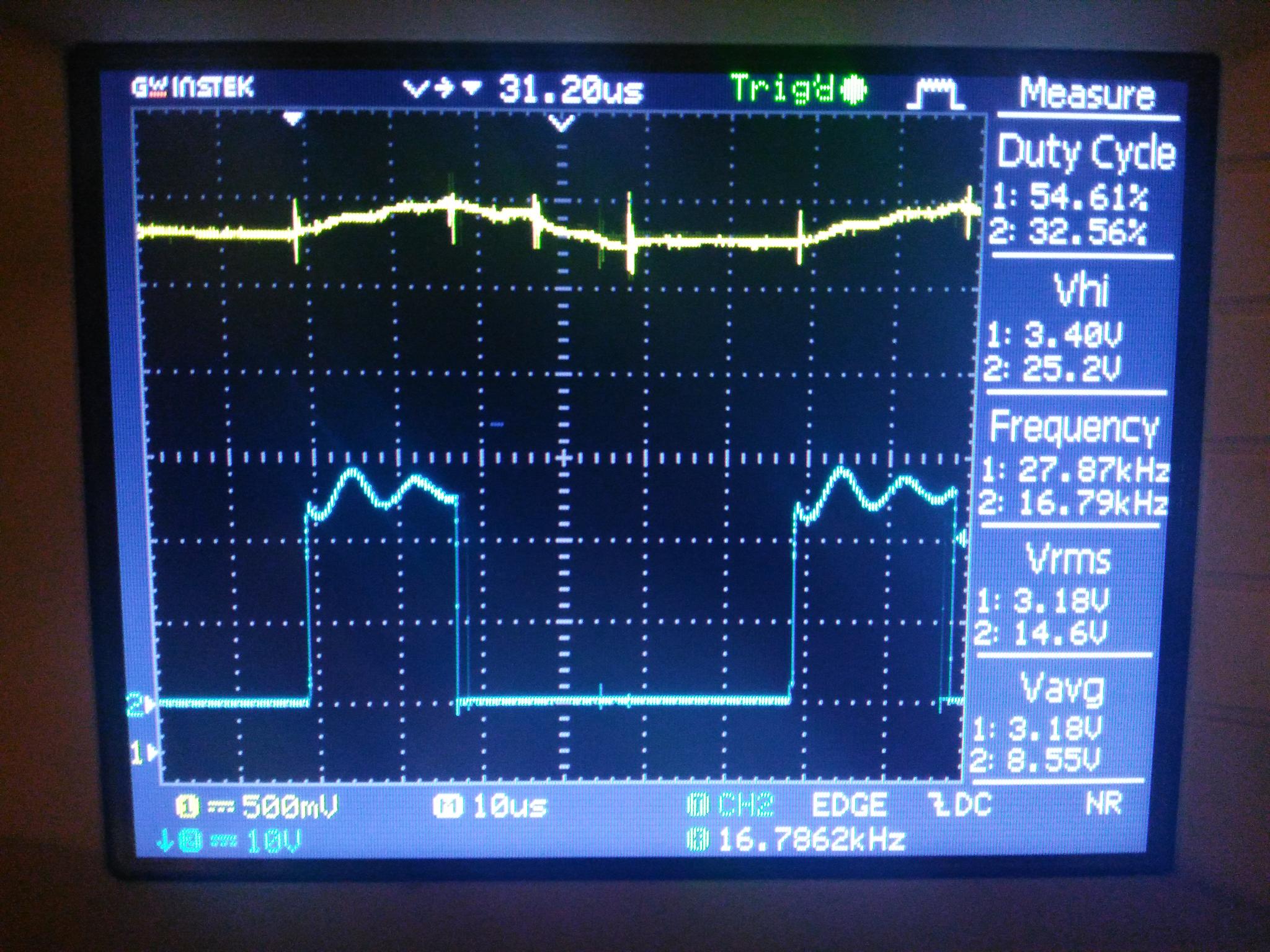

For this one I removed the dc-bus capacitor (can't remember if it was the small or large one) and supplied from a lab PSU. You can see the voltage and current now oscillating horribly.
Attachment 20238
Same again, but with a lower supply voltage - notice the current is the same (so the regulation is working) and the duty cycle has increased.
Attachment 20239
This doesn't tell us anything about sizing the supply capacitor, still it's mildly interesting...

A few months ago I said that I would have a look at the output of my power supply with an oscilloscope to get a feel for what was happening to the supply voltage with the router in operation. I was able to do this recently. I had some gcode running that was winding X and Y backwards and forwards at full rapid speed (gantry probably weighs in at around 50Kg, rapid speed on X and Y 4.5m/min, NEMA23/ballscrews, to give an idea of mechanical load), and I hung the oscilloscope off the supply to one of the drivers. Basically, there was the best part of 10V mains frequency ripple, with maybe a couple of volts of high-frequency noise on top of that. Mains ripple was presumably what the smoothing capacitors could not remove, and the high-frequency noise was the combined result of four unsynchronised switching drivers. That's all on top of a nominal 68V DC supply - the output voltage was swinging either side of that. The amount of ripple didn't change very much when the steppers were stationary although the stepper drivers are set to half-current mode. Clearly that doesn't make much difference to the PSU ripple.
Edit - have now seen that PSU has 2x6800uF smoothing capacitors, 100V/105C rated. Voltage limit is fine for this job and it's good to see the higher temp capacitors being used rather than the cheaper 85C - electrolytic capacitors are not the most reliable of electronic components but the higher-temp versions are better.
On the face of it, that doesn't sound like a great result. I was surprised by the amount of ripple - much more than expected. I can't read the capacitor values where they are, unfortunately, so I'm not sure how generous they are (the original PSU is the PS806 from Zapp although with a replacement transformer). On the plus side, the stepper drivers clearly don't give a damn and just keep on doing what they are supposed to be doing, and do it very well. Maybe, just maybe, it's possible to get a bit too hung up on the details sometimes and worry unnecessarily.
