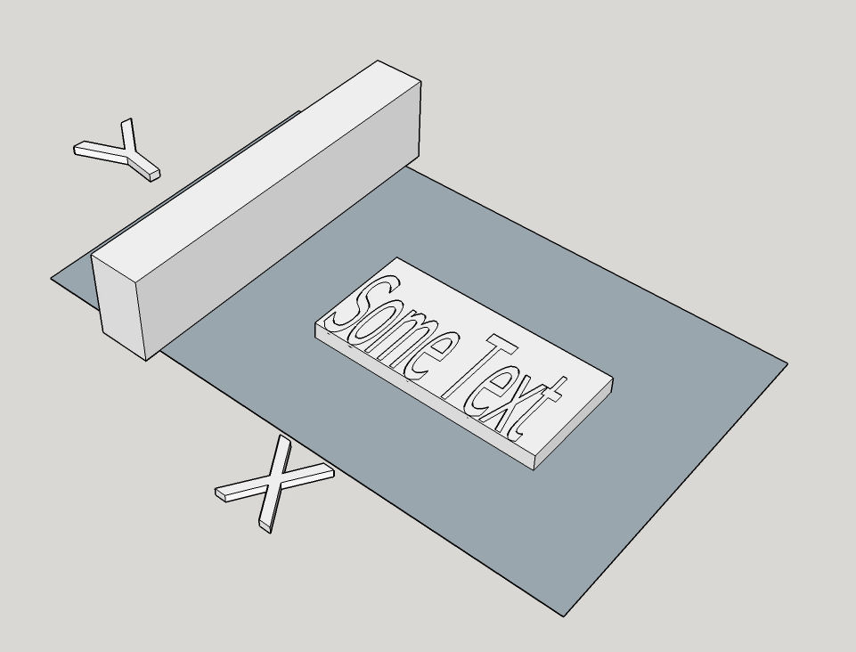

Hey guys, I'm having a bit or a mate at the moment with the workpiece in vcarve pro outputting to the machine.
for example if I want to cut along the Y on the machine I have to create my workpiece vertically in VCP
any ideas

Basically if im doing text along the width of my table I have to draw it vertically in VCP. When really it should be across my screen
In V-Carve Pro, the X axis is left to right. It sounds like you stand at your machine with the X axis moving from front to back.

draw it in X-axis and rotate into Y-axis
yeah thats what im currently doing but thought i would rather try and fix it so i dont have to mess about
It only takes a couple of key strokes!!
yeah, i get that, but surly you can see im a fussy twat haha
This is how my machine is, you can see the direction of text on a work piece. When I designed that workpiece on my computer the text would be showing left to right.
Attachment 13776
So is your's like that ? if so then it's normal.
so its a case of just living with it
If you were doing lots of it the same way then you might want to change but if you are working on different layouts I would say leave as is, quick rotate is select all press Ctrl +9 45 left, Ctrl +0 45 right

As Gerry mentioned i reversed ports and pins, however the workpiece is now inverted and im getting narrow letter (test) also when doing to i get rounded corners, not sharp ones
http://www.mycncuk.com/attachment.ph...id=13777&stc=1
ok so ive managed to get the T the right way up to where i want it.
will i have to do the steps per again due to swapping the axis, and also with the T being very narrow
Looks like your motor tuning calibration needs swapping over too. I'm guessing you've got different pitch screws on your x and y?
That should sort out the narrow letter problem.
Edit : Check your cursor keys for jogging from the keyboard too (hotkeys). You'll probably need to change those too.

Awesome, im running rack and pinion on both axis. however one is on a gearbox and other two on cncrouterparts drive pulleys
You shouldn't need to change your jogging hotkeys, unless you've already changed them to a non standard configuration.
You will need to change your steps/unit, and accel and velocity settings if they are different for X and Y.
Thanks guys i now have it the way i wanted it :)
