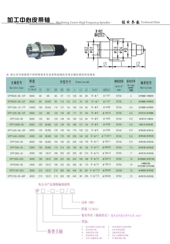

Ok Just had an update and i think we are getting a little closer...
" Hi Rick Pls check the attached, my quotation as below,
SPP1030-10-17F: FOB Dongguan US$1,142.00 in each.
Its max revolution is 10,000rpm, but if you insist 12,000rpm, price will be US$1,586.00, as we need to adopt Germany ceramics bearings, its cost is much higher than our standard bearings (NSK brand, made in Japan)
Any question, pls let me know.
Regards Sam
Ive Now asked for shipping and unit discount for 5..
so fingers crossed ...
Attachment 6180

First of all i dont really need 18k and None of the links you put on there are quotes, but just guide prices, get some quotes and see what you get, the item i have posted is without motor, i am awaiting updated paperwork for that, and is new unlike some of the links you have provided, they are used/refurbished items and as such very overpriced, i want BT30 ATC 12k rpm max (just for flexability) so if you can go cheaper price new not used, then post the quotes and i will contact them and may even buy one..or more
Rick
To Beat we have
12k rpm spindle cartridge
BT30 ATC
$1522 = £976.52
Oh just noticed three of your links are for Ms Xing....lol dont believe all you read will you

As i stated earlier in the thread i want as much flexability as possible which meant buying a seperate motor, 9k is to high for the lower limit. As you stated earlier the motors have no power at the lower speed, I will be gearing down to 2k on spindle with an approx 0-6k motor and up to 10k if need be i will be using pulleys for this, with a little left in reserve.
take a look at the pictures you cant miss it.. when i asked her if they were "used" she just said "some" Its all too easy to blag and blame the language barrier when in fact every word is understood perfectly..

I've had a thought. We discounted making these spindles as it would be too much hassle making a one off. But i want two, and overall we're looking at five so maybe we can get this sorted and get 5 universal bt30 spindle sections made, and configure the case and bearings to suit our own requirements. This way we all get what we want and the expensive ground spindle can be made for us.
anybody else want to jump on

Still too much to spend for me to only get 6000rpm...
got the spindles back from the grinder and a bt30 hoder rings quite well into them. I'm in two minds now whether to leave the motor/pulley arrangement as is (bridgeport), or remove the pulley section and mount the motor directly on top of the spindle with a drawbar through the motor.
Well I got there in the end but via a different route. I ended up buying two HSD router spindles which have a 30 taper and air powered atc. They are 6.8kw and 24000 rpm, and should have a fair bit of power run at slower speeds.
